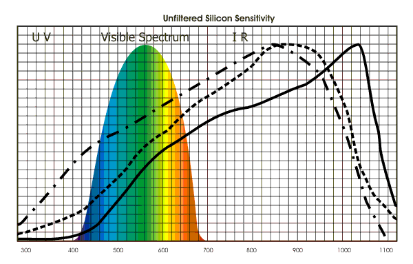

Of course you can. All they have to do is leave the IR filter out and turn the color processing off. Most image sensors today, at least the CMOS stuff, has full on board image processing but it can be controlled in a lot of ways including having a B&W mode either through a serial control bus or pin programming for the common stuff and usually color or B&W mode is one of them. Here's one. It's an IP or ethernet camera with IR illumination LEDs and it's 3 megapixel High Definition camera so has useable definition. You could add more illumination to extend the range even further. You could probably find someone who will take the filter out and permanently set it to B&W mode.
