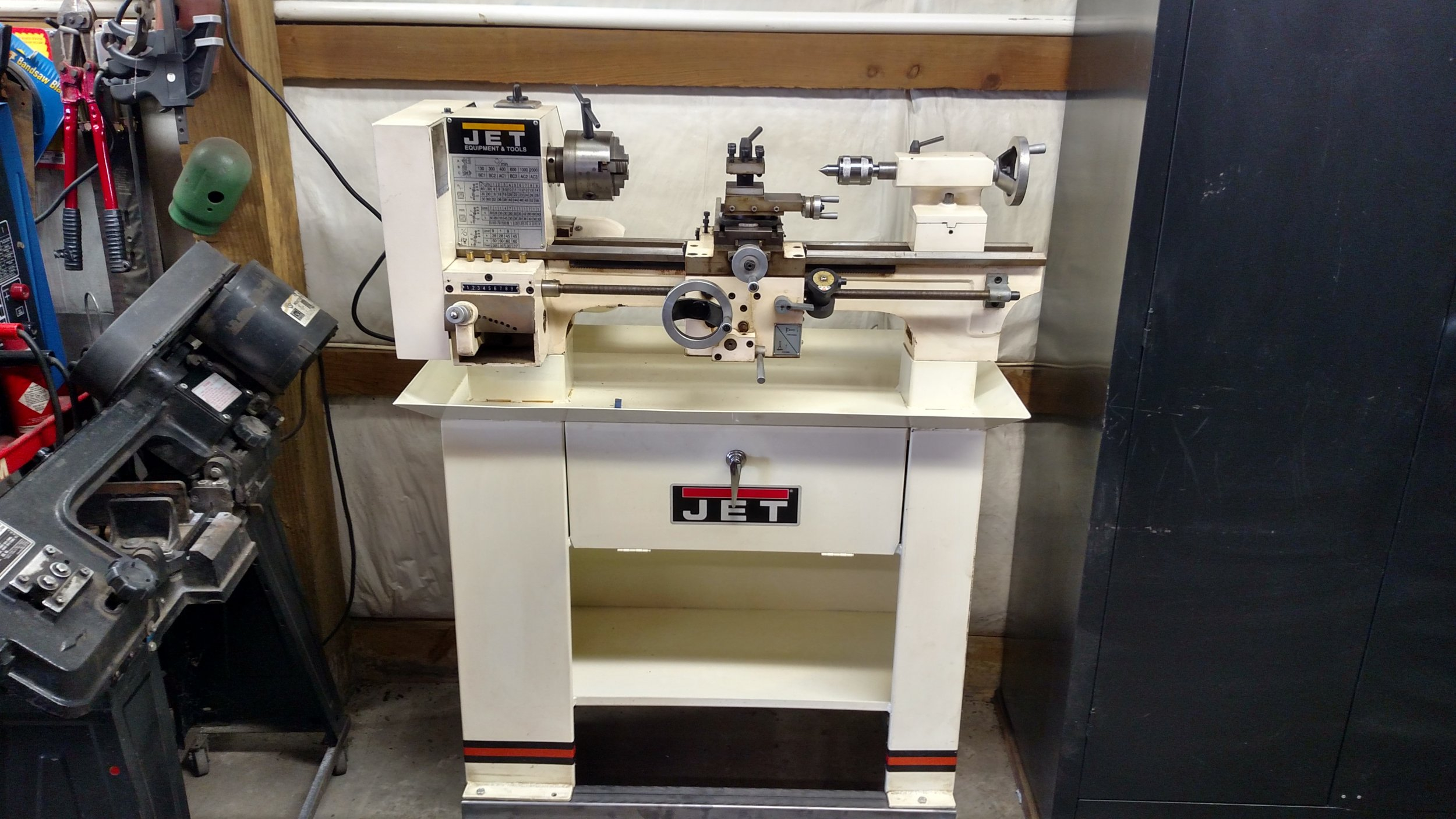

Even a small lathe is very useful. I bought mine used 15 years ago after a guy realized it was too small for what he wanted to do. It was 2 months old. A Jet 9x20. Paid $750 for it with a bit of tooling. A new one will likely be $3000+ now.
Figure out what 95% of the jobs you need to do require and make that your minimum size.
If you can be patient, I think quite a few will be available the used with companies in trouble and hobbyists dying off.

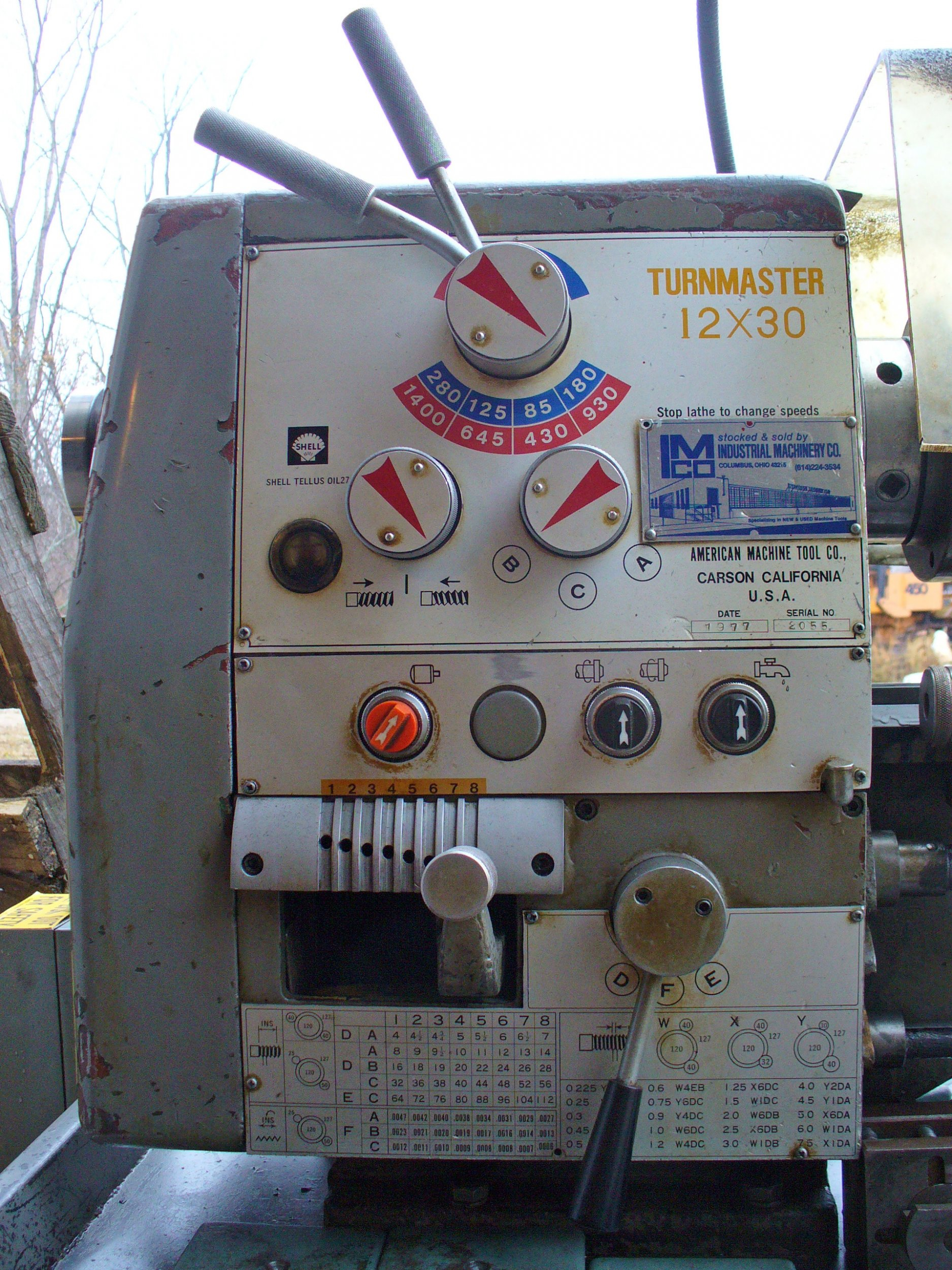

I got my lathe in trade for milling some logs for a guy,
It's a European made, Turn Master 12 X 30 gear drive.
It's in great shape...

Nice! Any issue adapting to cut UN threads on that, or is that not something you're doing?

If that question was aimed at me, I only use the lathe occasionally, and I haven't used it to cut any threads....yet.
I'm really just a wanna-b machinist, my dad was the real machinist.

Looks like you could still do UN threading on that SR, eg. DB4 for 1/4-20. Not sure I follow the W X Y for what appears to be metric pitches, but no matter. Very cool!

The symbols around the WXY as well as on the UN thread pitches appear to correlate to changeable gearing inside the headstock

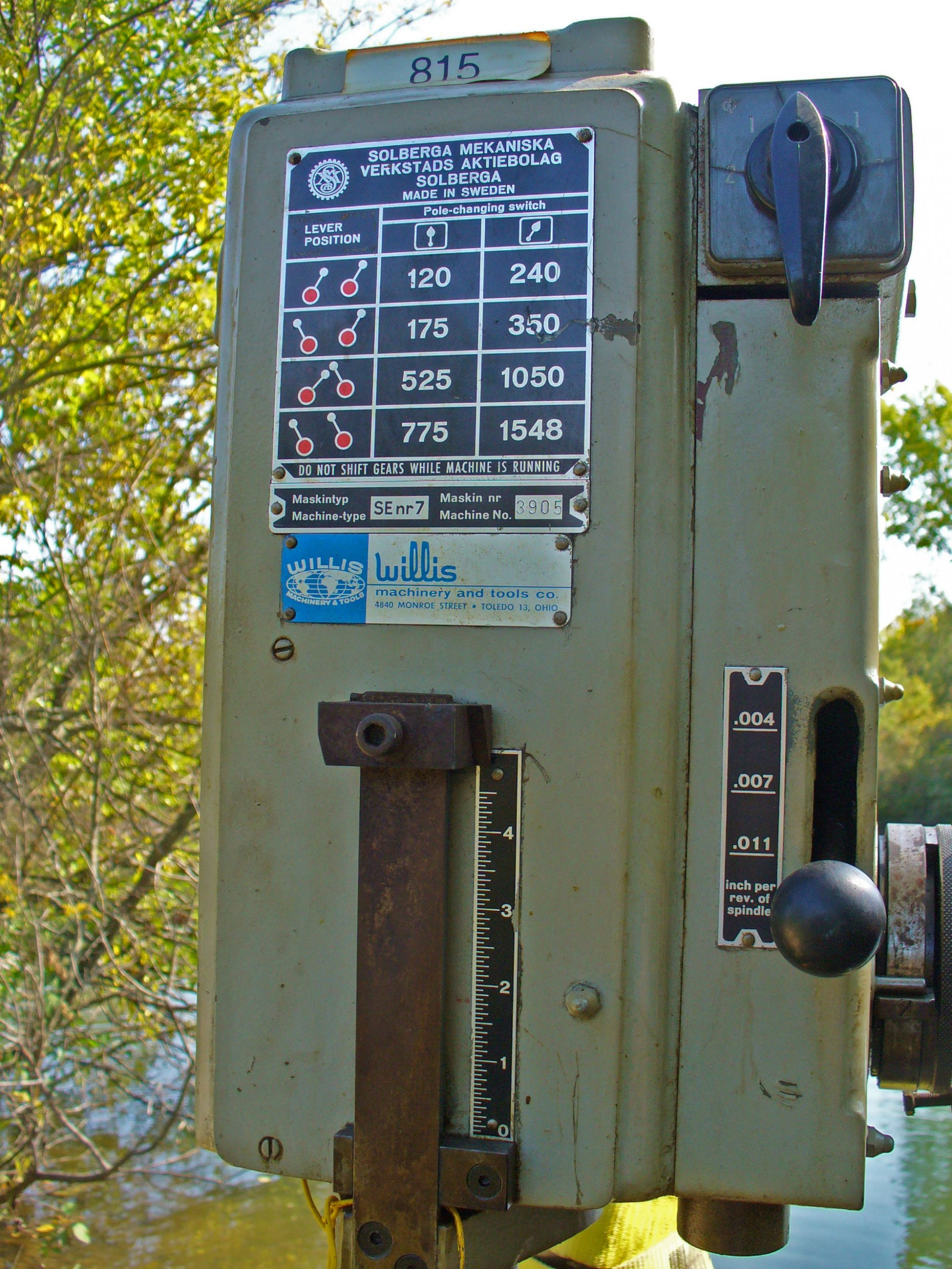

I really should learn how to run it better; I just don't seem to take the time to do so. I have about $600.00 into it...
I also got my Solberga drill press from him too,
Another trade for milling lumber... I use it when I need to do some serious drilling!

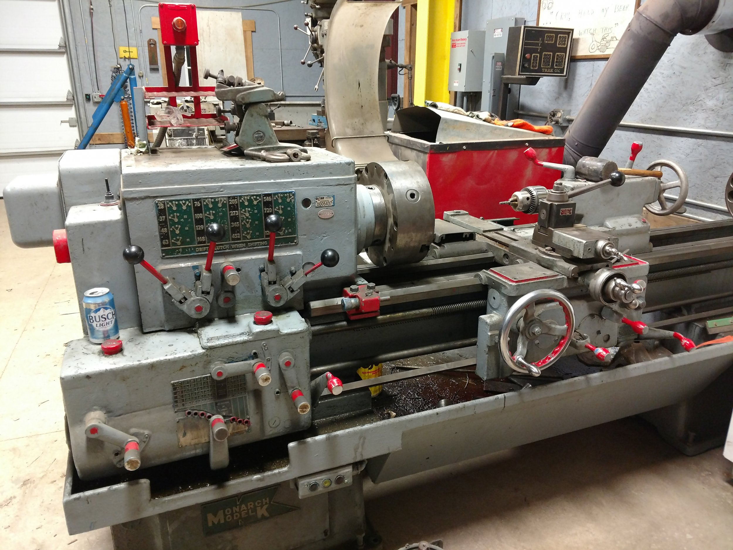

I have a monarch model k. 16x54. Weighs about 4200#. I consider it about the perfect size for doing odd tractor pins and bushings and what not.
Way back in senior year, we got to tour Monarch in Sidney, Ohio. The floor was interesting, 4x4's on end. You could see where a casting was dropped, and new 4x4's were put in. Good machines, to bad they shut the doors.
