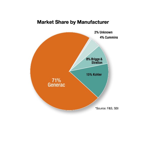

When you have the largest share of the market,you also have the largest number of complaints. Generac would have to have 18 times more complaints than Cummins to be worse!
