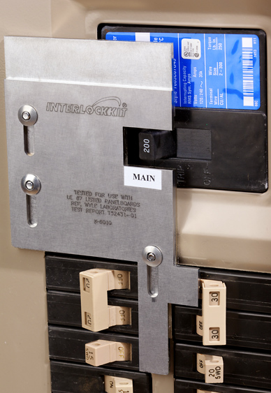

Yes you need to protect the line workers. There is little excuse to ever back feed your panel without protection. ,,,,, If the point is to protect line workers from death, a manual interlock plate that prevents the main from being connected while the generator is on can be accomplished by a $50 interlock plate.
Very good info, thanks for this! Here is a pic of www.interlock.com 's manual interlock plate. Haven't seen or heard of this before but two details noted:
1) This one requires that your feed comes in on the upper-right breaker. The breaker position has to be configured match the interlock device.
2) It also requires that the upper right breaker is dedicated to generator feed ONLY. For example, you can't use your "garage subpanel" or pool house as a feed if employing this Manual Interlock device. Because then with line power "ON", your subpanel is "OFF".

I use an interlock in the main panel, it's a GE part specifically made for their panels. It toggles between the 200A main breaker (to grid) and the 100A back feed breaker (to generator). It's impossible to have them both turned on at the same time -- only one or the other. Very effective and simple approach in cases where you can run a whole house on the generator.
