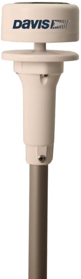

For those with Davis weather stations, don't be tempted to buy their "new" sonic anemometer:
At $600, it should have been better designed. Insect nests & webs skew the readings and it doesn't work in driving rain at all.
   / Home weather station suggestions #113
It looks like the Tempest. The Tempest works pretty good.
   / Home weather station suggestions #114
I have one & it works good for me. It is much more accurate reading short wind gusts.
Mine only updates every 15 seconds +/- so unless the gusts time it just right a lot of them get missed.

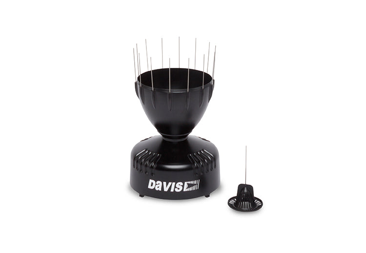

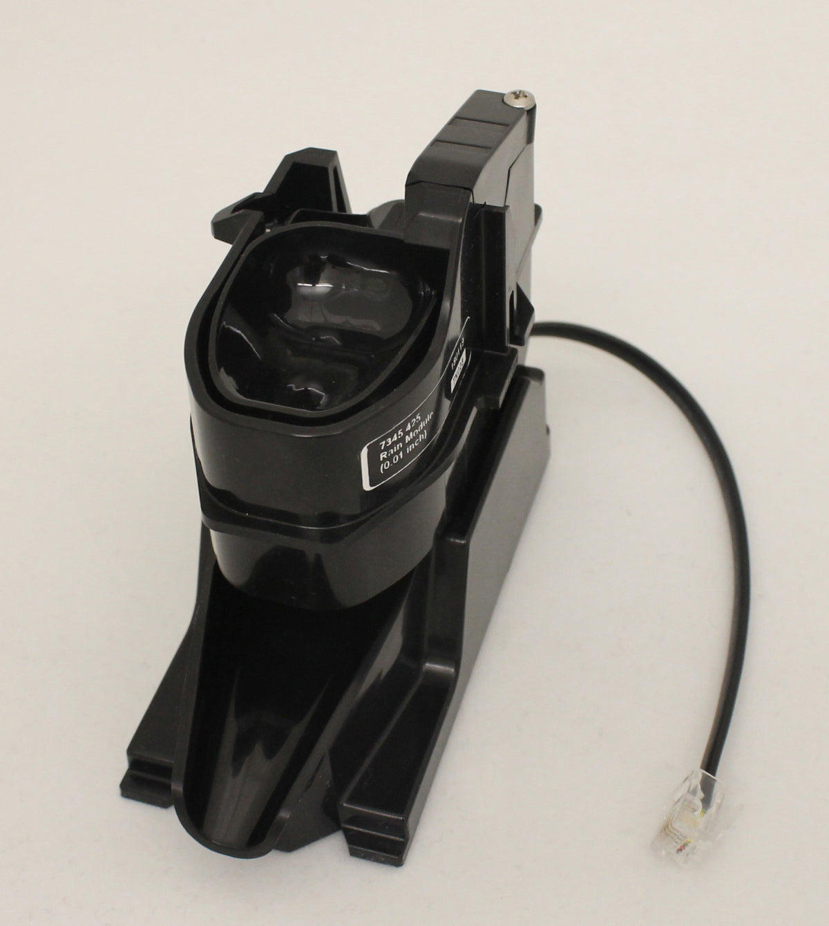

Low precip readings are common on these lower end units. It's just inherent to how the tipping spoons are designed. That's why research organizations like CoCoRaHS that monitor rainfall nationwide require volunteers to use standard tube rain gauges. No household automated stations are allowed. One of the many nice things about the Davis stations is that there is a mechanical calibration you can easily do to bring them very very close to reading correctly.
If you haven't already done so, there are two upgrades that improve the accuracy of the Davis rain gauge:
and
I use both and it did indeed improve the accuracy, compared to an analog gauge. Still not exact, but very close.

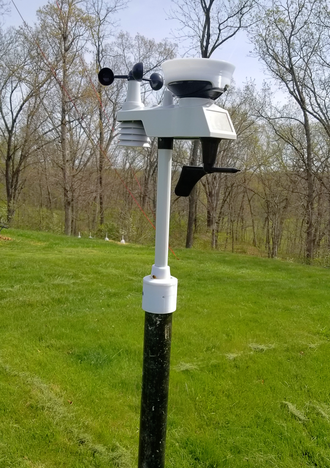

I had thought about redesigning the spoons to improve accuracy of the rain gauge. but thought that wider funnel was an easier solution to implement.
Used to have it in a pasture about 80 yards from the house. at about 14' It worked generally but the steel sided house acts like a Faraday cage attenuating the signals. Our cell phone doesn't work indoors either. Our woods are about 50-70' tall all around and we realized that that the anemometer was never going to be in clear wind anyway. Right now it is about 20 yards out in front of the house.
The rain gauge was enlarged with the white funnel attached to the standard funnel. I custom printed it. In trials the standard cylindrical gauges are now matching this unit to within 1%.
The barometer we calibrated a bit to generally read the NWS station about 7 miles away.
Instead of a screw in flat mount I printed an adapter to fit on top of a standard 2" pvc pipe. Currently it is at about 8'
Cost was $80.
No idea about battery life, it is coming up to one year old.
