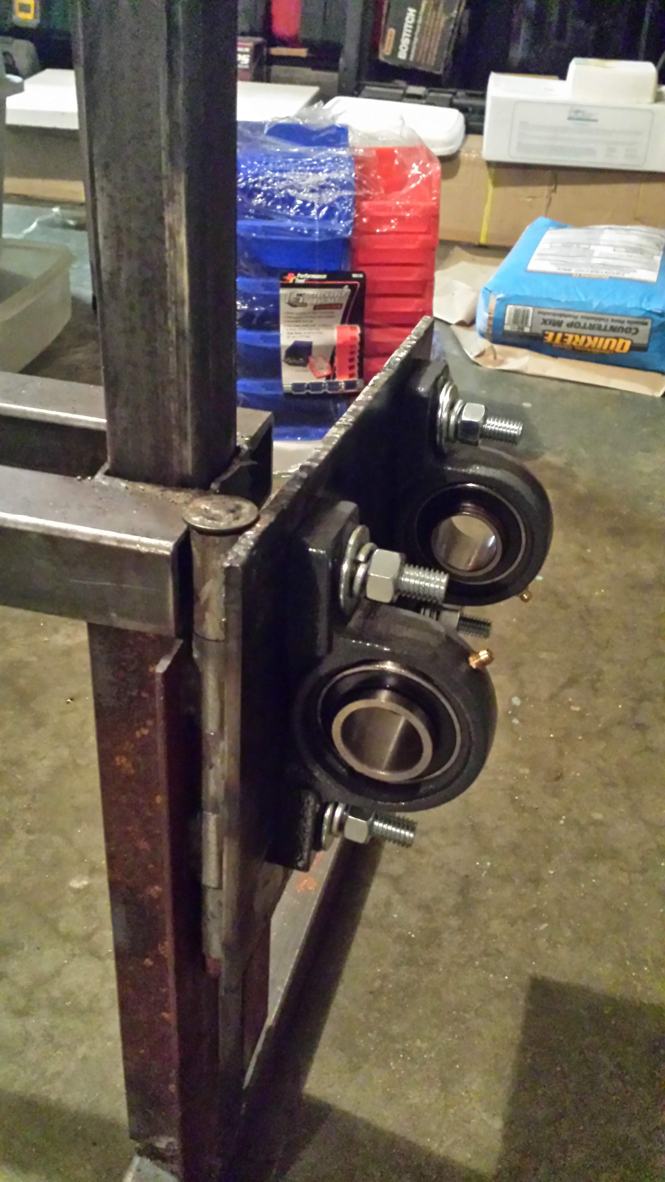

Good video on inserting the bearings in the pillow block. I've never done it like that, I've always got them with the bearings already mounted. I was going to find someone with a press, but a couple of light taps with a punch and they lined right up. I wouldn't have been as concerned about it had I seen your video first.

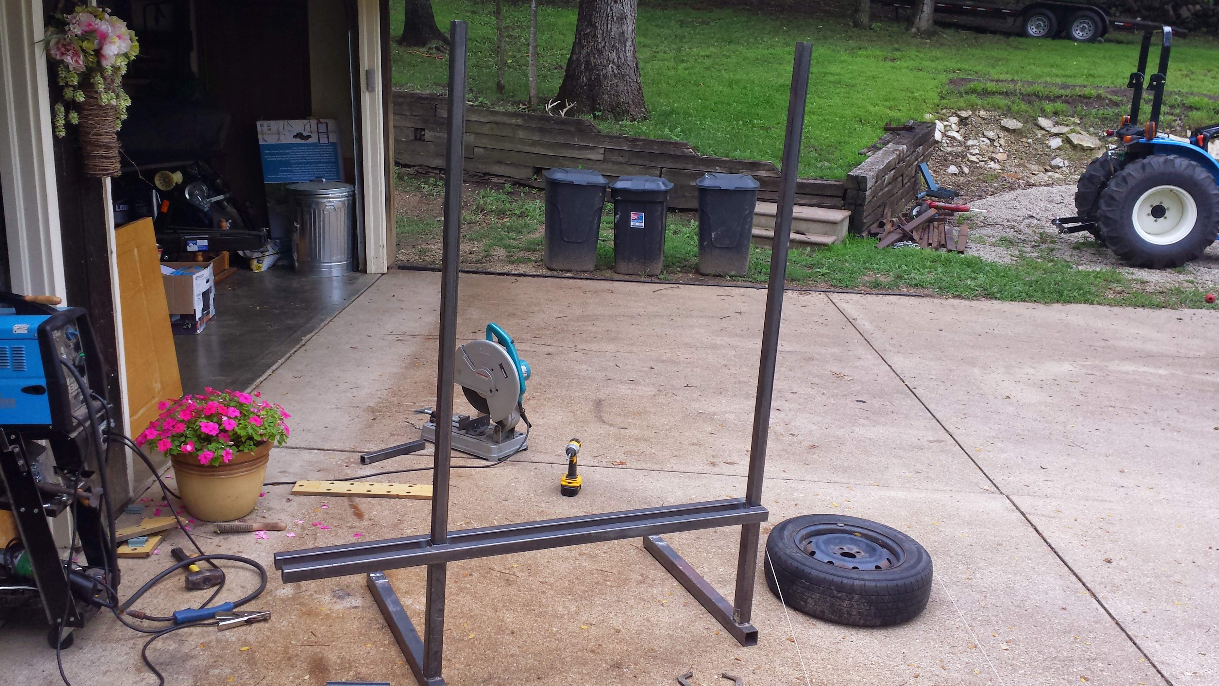

As promised, here are some pics of the build.
How I figured out how long the blade needed to be for the size I wanted to be able to cut.
Built the frame

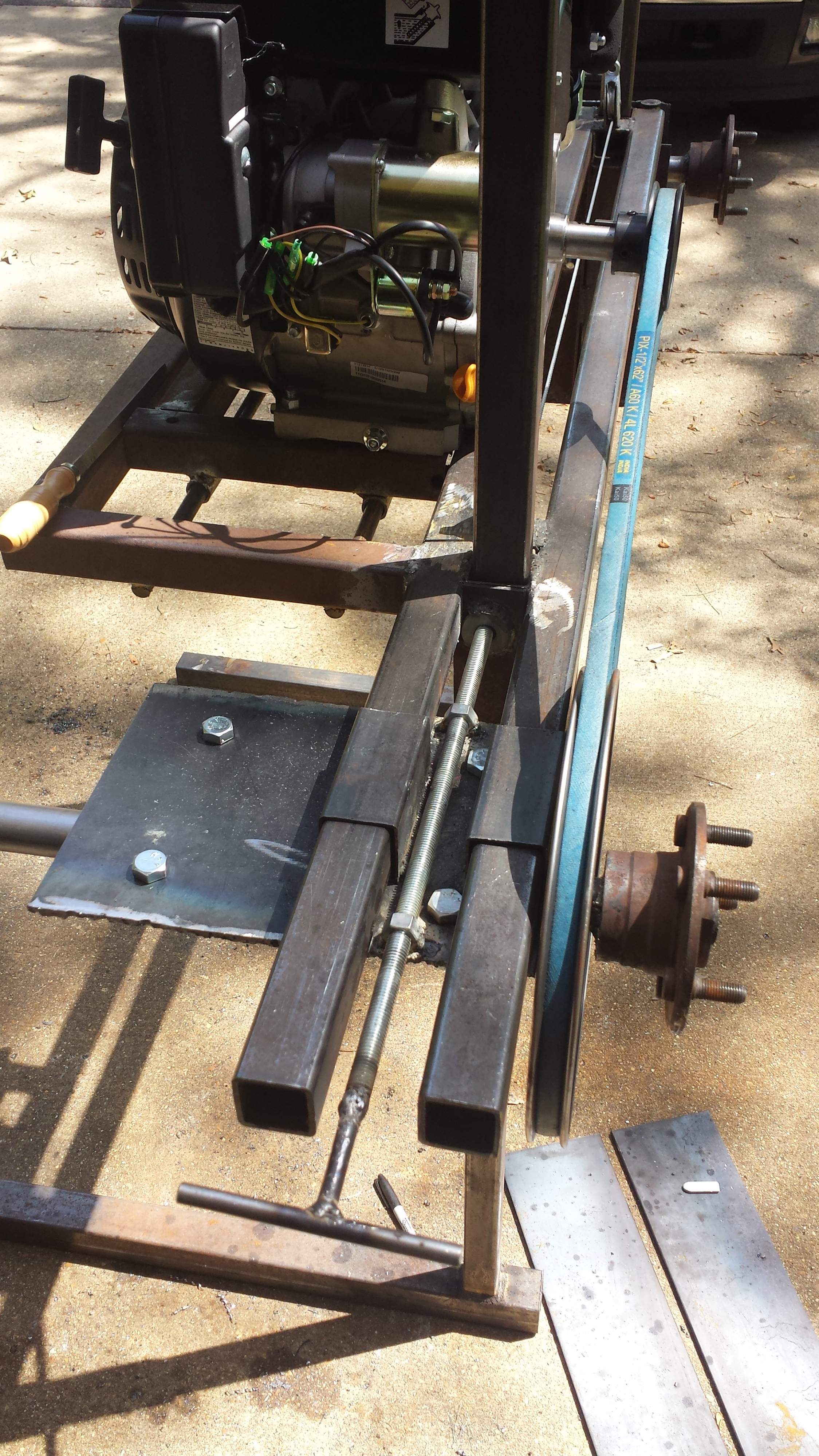

Tracking adjustment

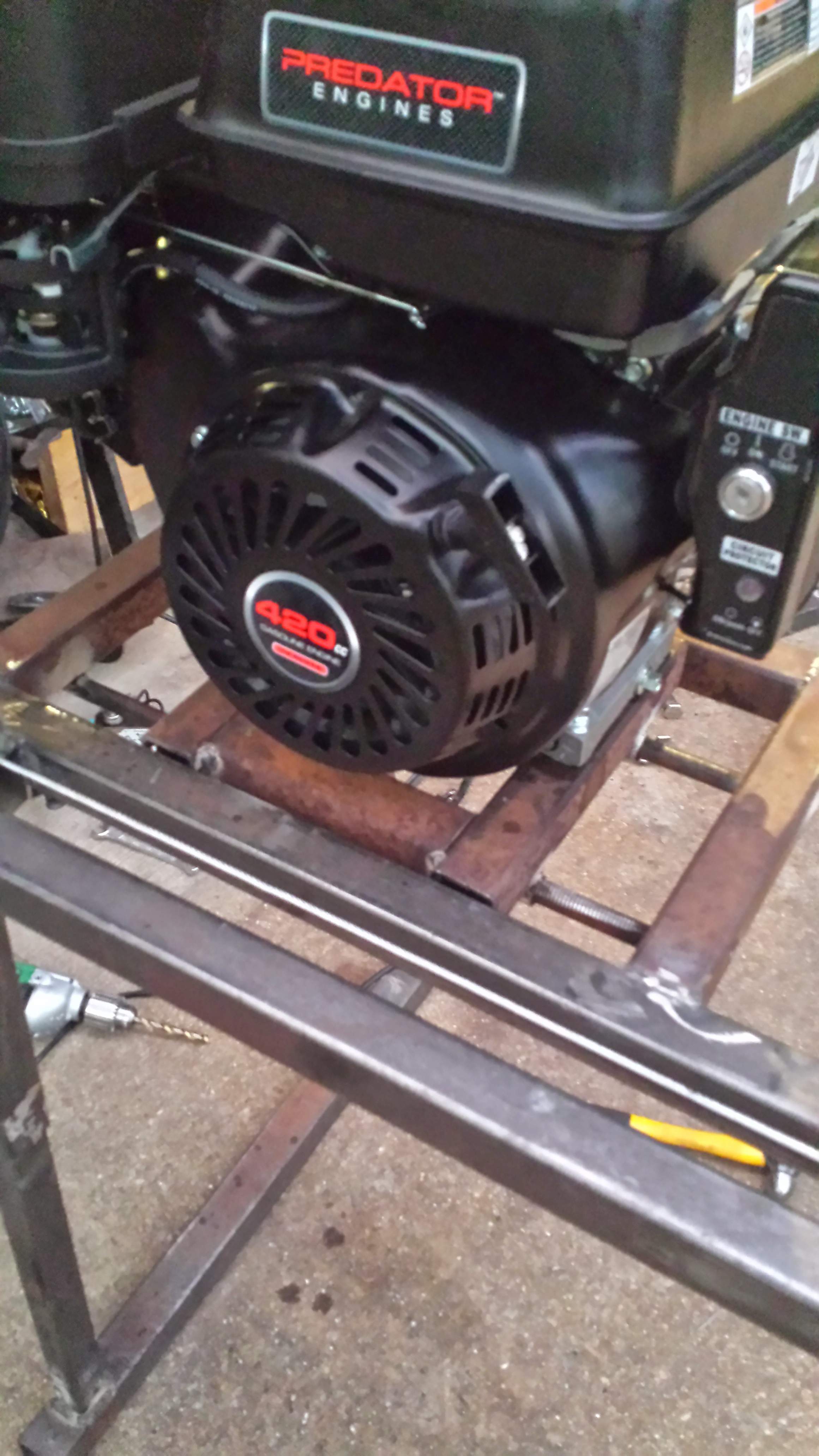

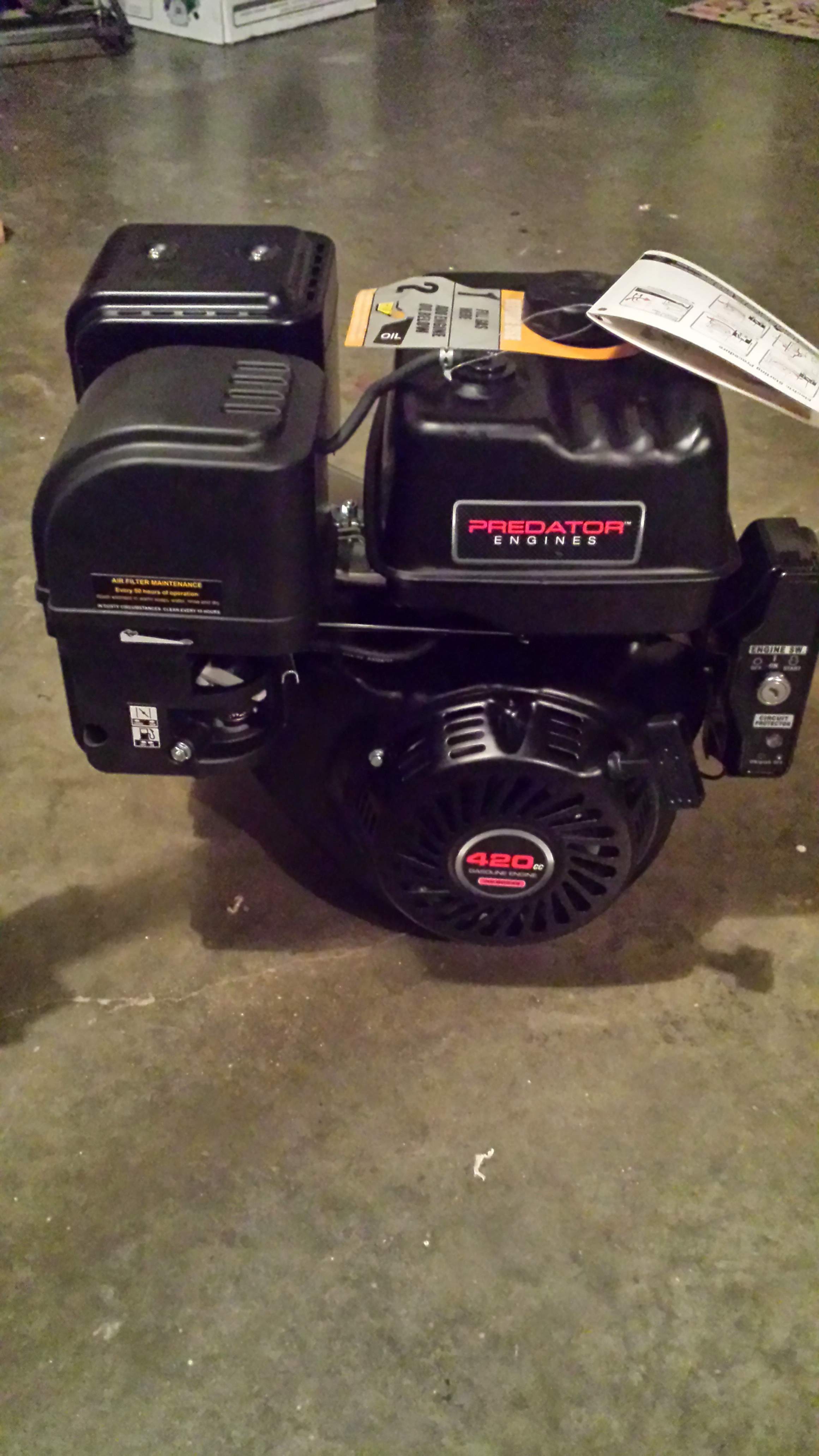

Decided to upgrade from the 9hp subaru to this 13HP harborfreight job. (I have one (6.5hp) I put on a mud motor I and never had to pull more than twice even in sub 0 temps)
Motor mounted on a sliding mount. Not pictured here, I put a threaded rod with a T handle so I can adjust the belt.

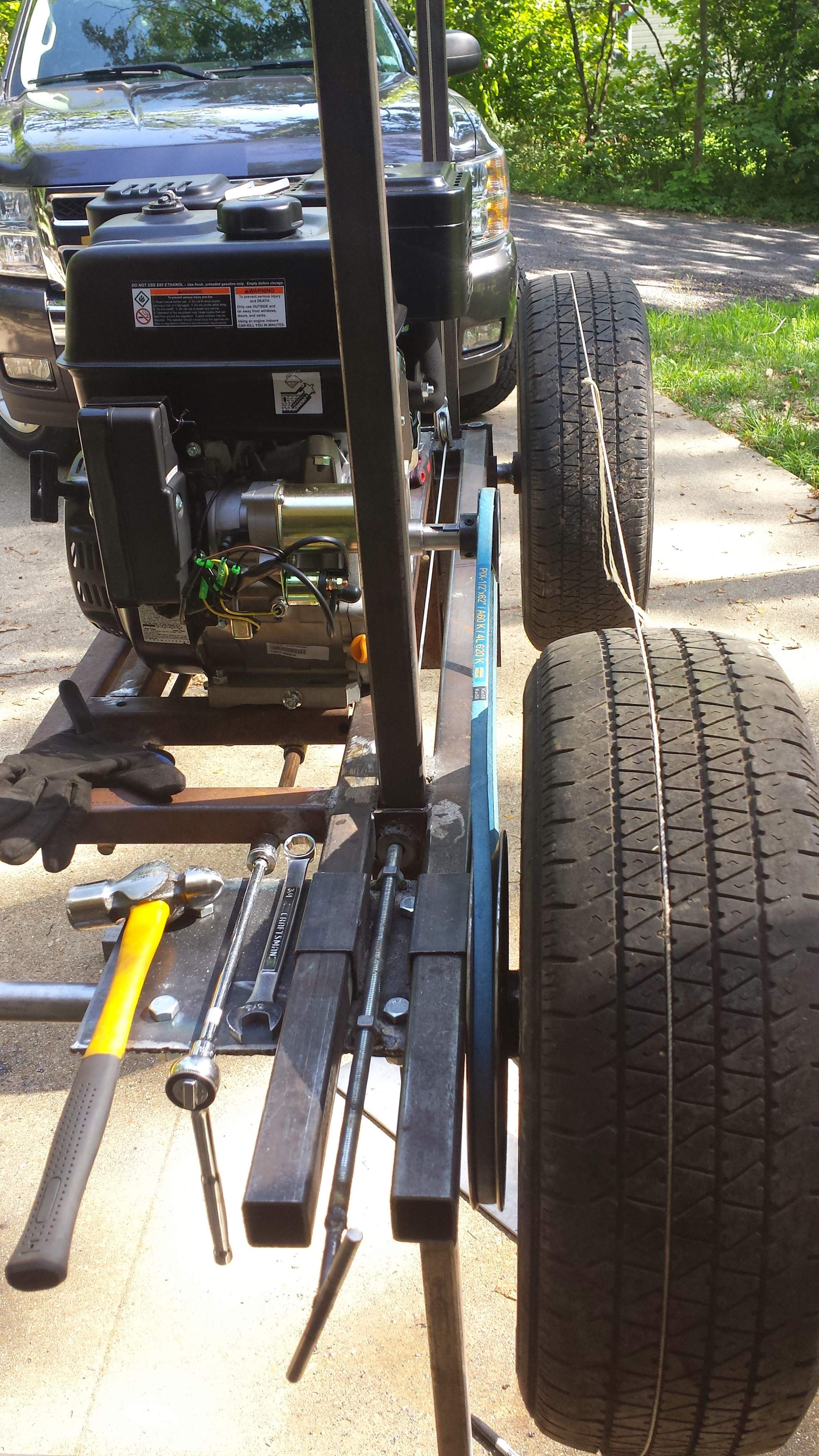

Blade tension/blade size adjustment. Also, notice, turned the motor around. I wanted the blade turning in the other direction, I also didn't want to have to stand directly in front of the blade to start and stop the motor, that kind of thing. I also wanted the force of the belt closer to the pillow block.
So, here's s screw up that I couldn't fix, and didn't need to as these wheels center on the hubs and not the lug nuts. Plust, it works out well since all of the forces are pretty close together and well supported.

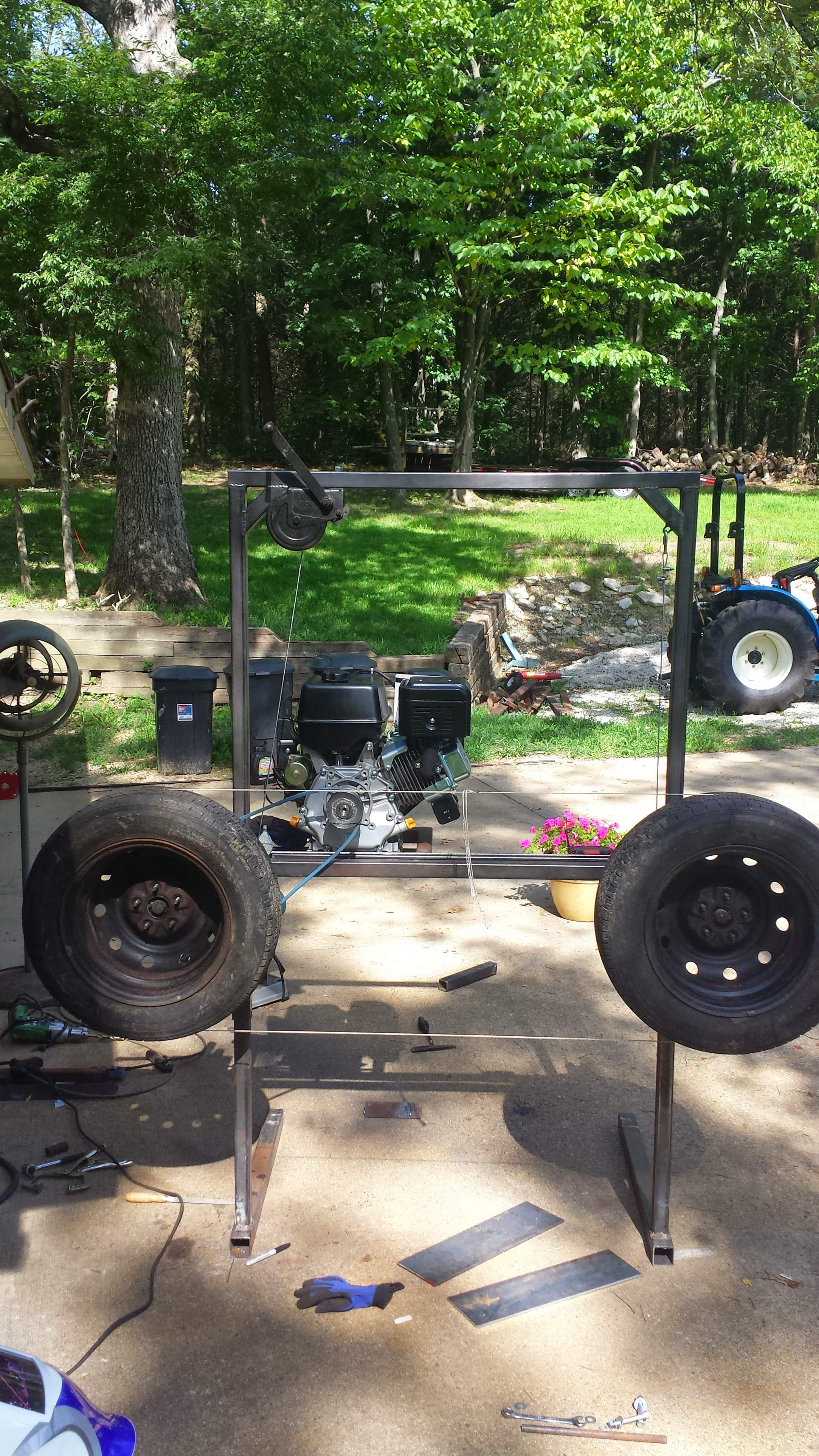

Here it is put together more or less.
I still need to build the blade guides and put an idler pully on to engage/disengage the belt and if it all seems to work well, then some blade guards.
** Note to anyone using my method of determining the blade length. Nylon string stretches....a lot.
