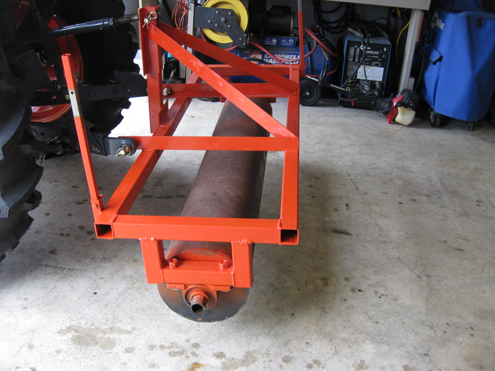

My dunham packer is liely from back in the 50's....its over 7' wide and the shaft is still true. The shaft diameter is going to determine its ability here...but if its solid I think it's good to go.
On the bearings....I think the flange bearings are lower cost and easier aligned. :confused:
As far as bearings on a cultipacker go.....the "wheels" all turn independantly on the shaft and the shaft turns sometimes on the packer I have. Its free....but the wheels tend to roll on the shaft about as much as the shaft spins IMO. I doubt that the bearing type matters much unless your pulling it ALLOT.
The thought I have with pillow block vs flange is that the 2 pillow block bearings are holding all that weight of the wheels and axle when you pick it up with the 3pt.. Going to and from the food plots bouncing around? The flange is basically bolted to metal with a hole thru it.. Might be it doesnt matter and good pillow block bearings will hold the weight?? You see alot of the new ones with pillow block so they cant be all bad- just wondering :) With pillow blocks I can use square tubing and bolt to-- flange I need plate steel which is costly? I played around last year with a solid roller- see below-- and it worked fine. Do see the need for packer wheels vs solid roller.. I solid this pretty easy.. Now I am looking to build another...:D

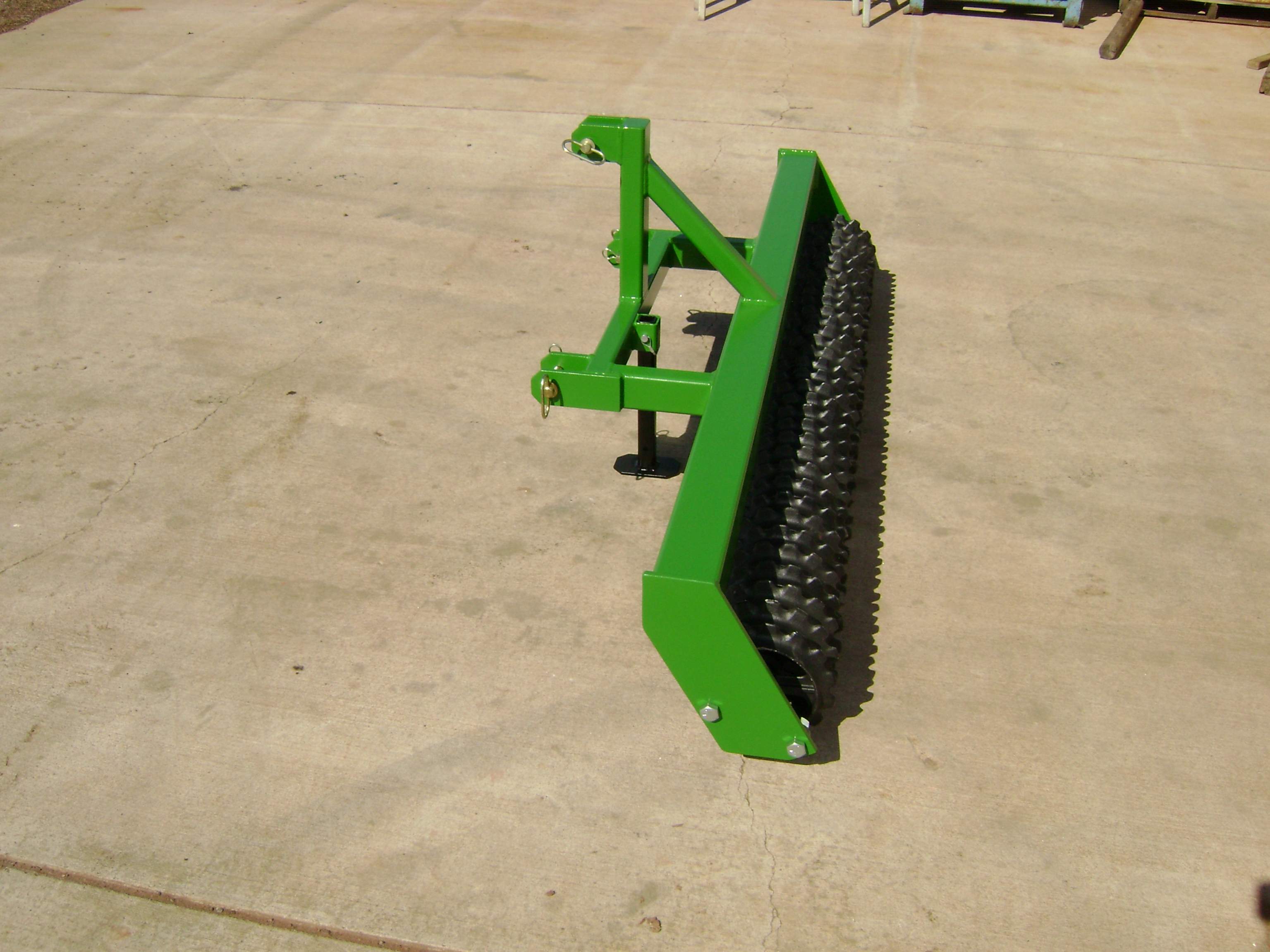

Packer wheels are shimmed and secured with split locking collars on both of the bearing ends. ( to keep wheels snug and secure from sliding on the axle )
On this particular model pictured I used 2 bolt flange bearing over pillow block bearings for the simple fact I feel they are better supported for side load.
( when the shaft is pulled sideways from the bearing )
I also think the flange bearing is better protected from rocks by being enclosed it the frame. ( this also captivates the axle and keeps it from sliding out of the framework if the setscrews would ever loosen up )
The packer wheels are also placed behind the main tube to give it a " better " pulling action. ( this also keeps the roller from tipping over when unhooked )
We also use use a solid 1 3/4" grade 1045 cold rolled axle.
I was raised on a dairy farm and I know first hand about all the potential problems when it comes to machinery.
So my theory is this, build all potential problems " out " of the machine so they can be avoided all together.

Side view.

compact the surface and break up any clods. It will make the top of the soilds around here like powder and works the air out. Good looking build. I rehab about 5-6 of these a year and conver them to 3 point or flip style to be used with a hitch. the biggest issue we have found in rehabing a unit that was never ment to be picked up is middle support. I started making a 3/8 plate with a somewhat loose fitting brass bushing in it. The rods are never a consistant size end to end because as mentioned before the rollers roll on the shaft sometimes nad sometimes the shaft rolls.
Good looking cultipacker. I hvae never concidered making one from scratch. What do you get for them?

I can see where the flange bearings are well-suited for this purpose...for the reasons stated above. Also, you see allot of discs with these bearings and they have lots of the same requirements. :thumbsup:
FWIW.....I can remember back into the 50's when these bearings were pretty new....and folks questioned the durability back then for a snow plow application we had. They are pretty tough! SSDD ;) :)
   / Homemade Cultipacker #19
Nice. That's the way I'd build a 3pt cultipacker.
For your next project, build a towed cultipacker with hydraulically raised/lowered wheels/tires for transporting. IMHO, towed cultipackers are superior to the 3pt type. I'd be interested to see what you come up with.
