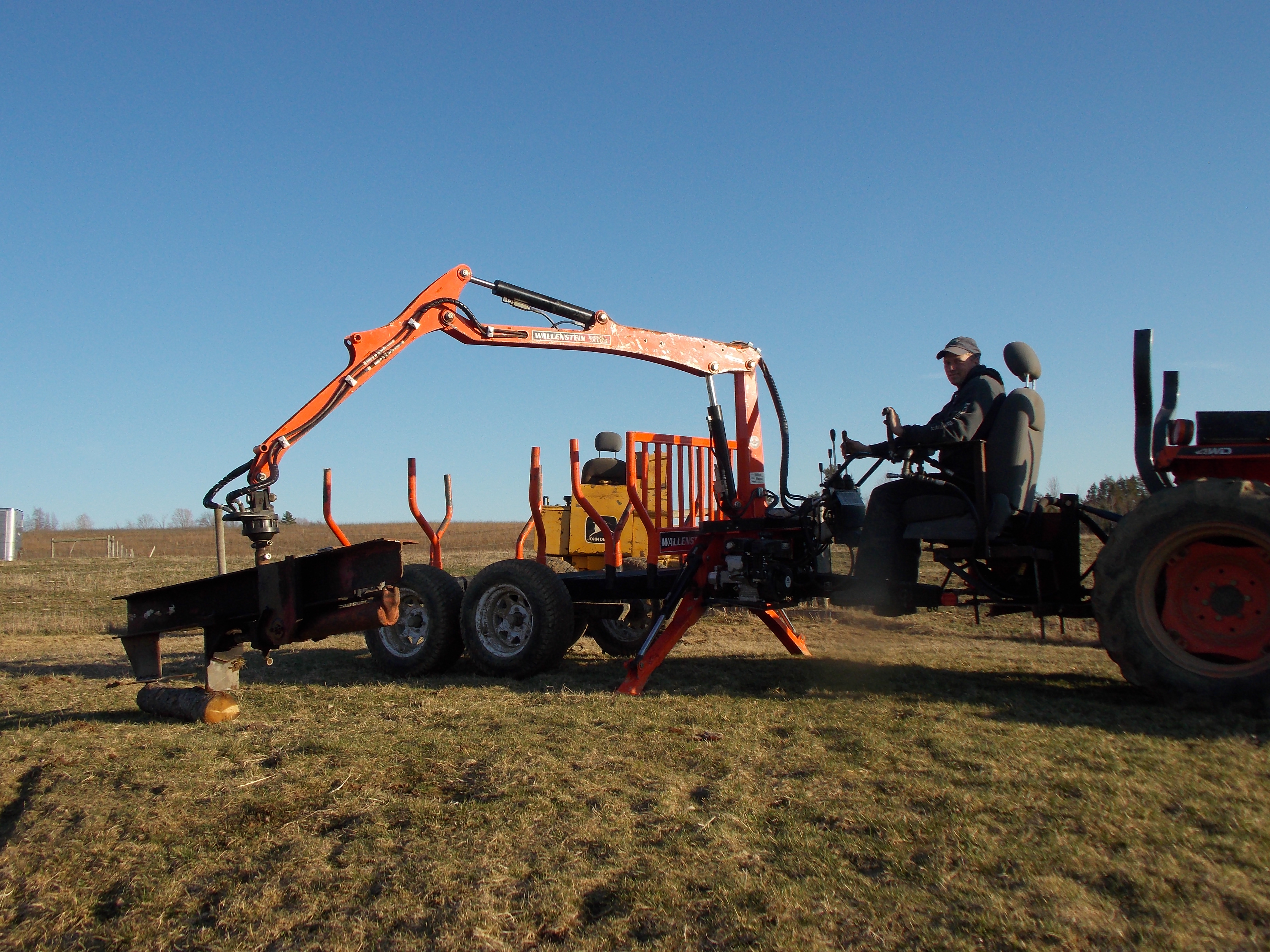

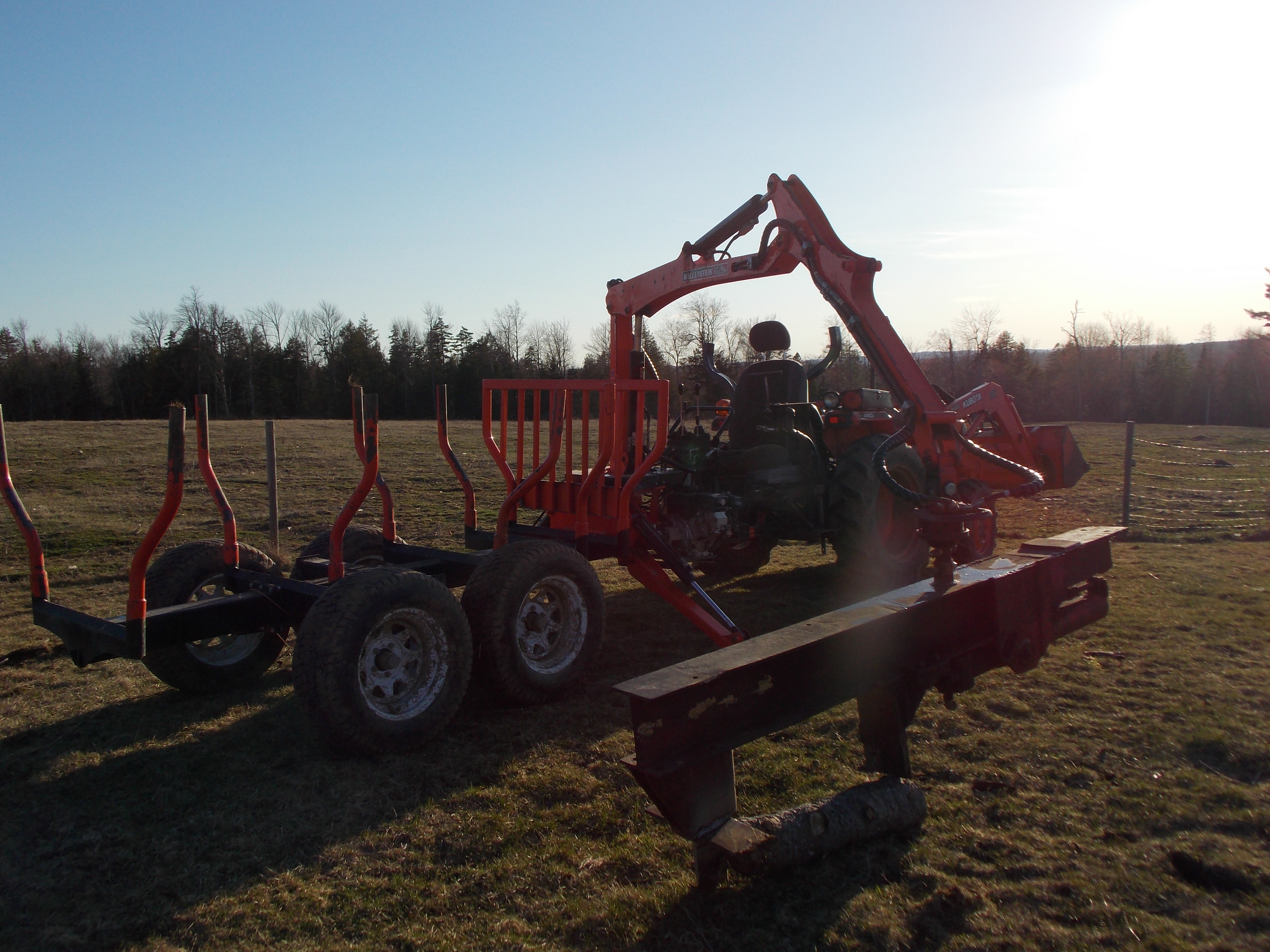

I do have other options, like having a "carrier" as I call it that I built for my upside down woodsplitter. That houses and PTO pump, hydraulic reservoir, seat and hitch for my trailer so that I could power my woodsplitter ram with more hydraulic flow. It also gave me control with the splitter valve on my left armrest. (The right one has the cup holder...yes I know how to build things). I could press that into service and go with a hotsaw or a shear, but for now it works with the chainsaw. I would have to mount the "carrier" to my tractor's 3 point hitch however, and attach the trailer to it if I used that as a extra hydraulic power source. Not a big deal, but more to do on hooking everything up.
Here is that "carrier" and upside down woodsplitter so you can see what I am talking about.

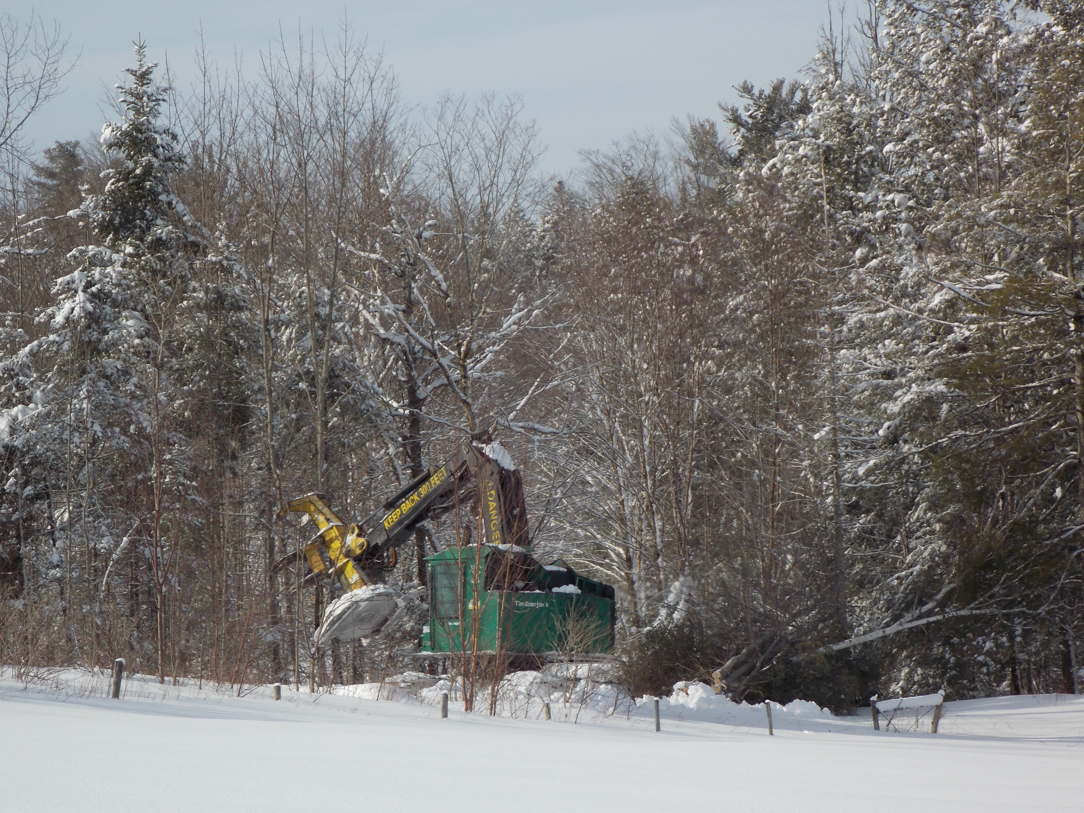

It does not matter if it is a home-made feller-buncher, or a $250,000 Timbco; the tree should always be grabbed as close to the machine as possible, otherwise the weight of the tree causes the machine to tip forward and pinch the saw. This can bend the bar on my feller-buncher, but on a real feller-buncher, it can cause spider cracks in the saw head. It actually takes a fair amount of skill to operate a feller-buncher, you cannot just put anyone in one.
