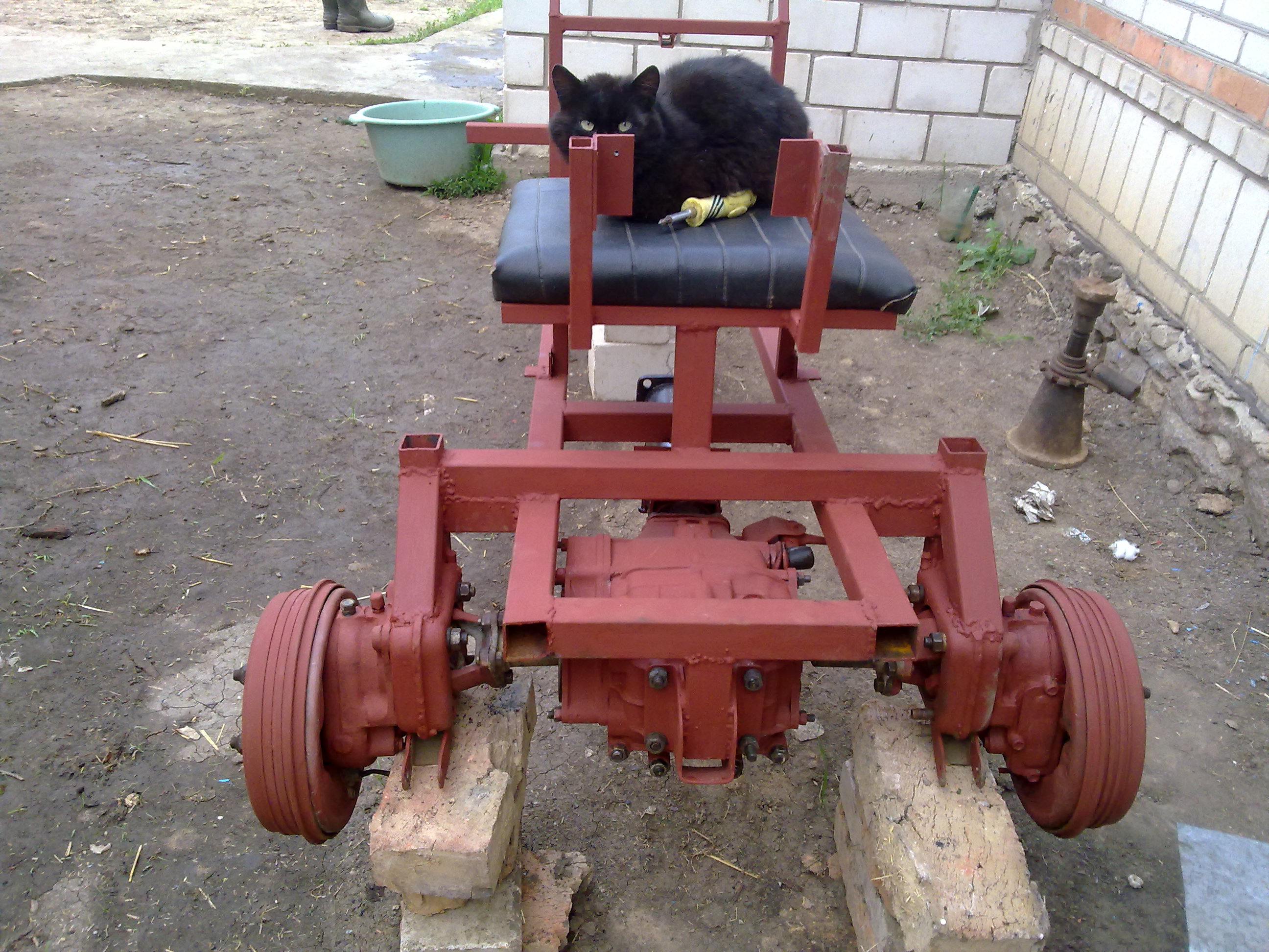

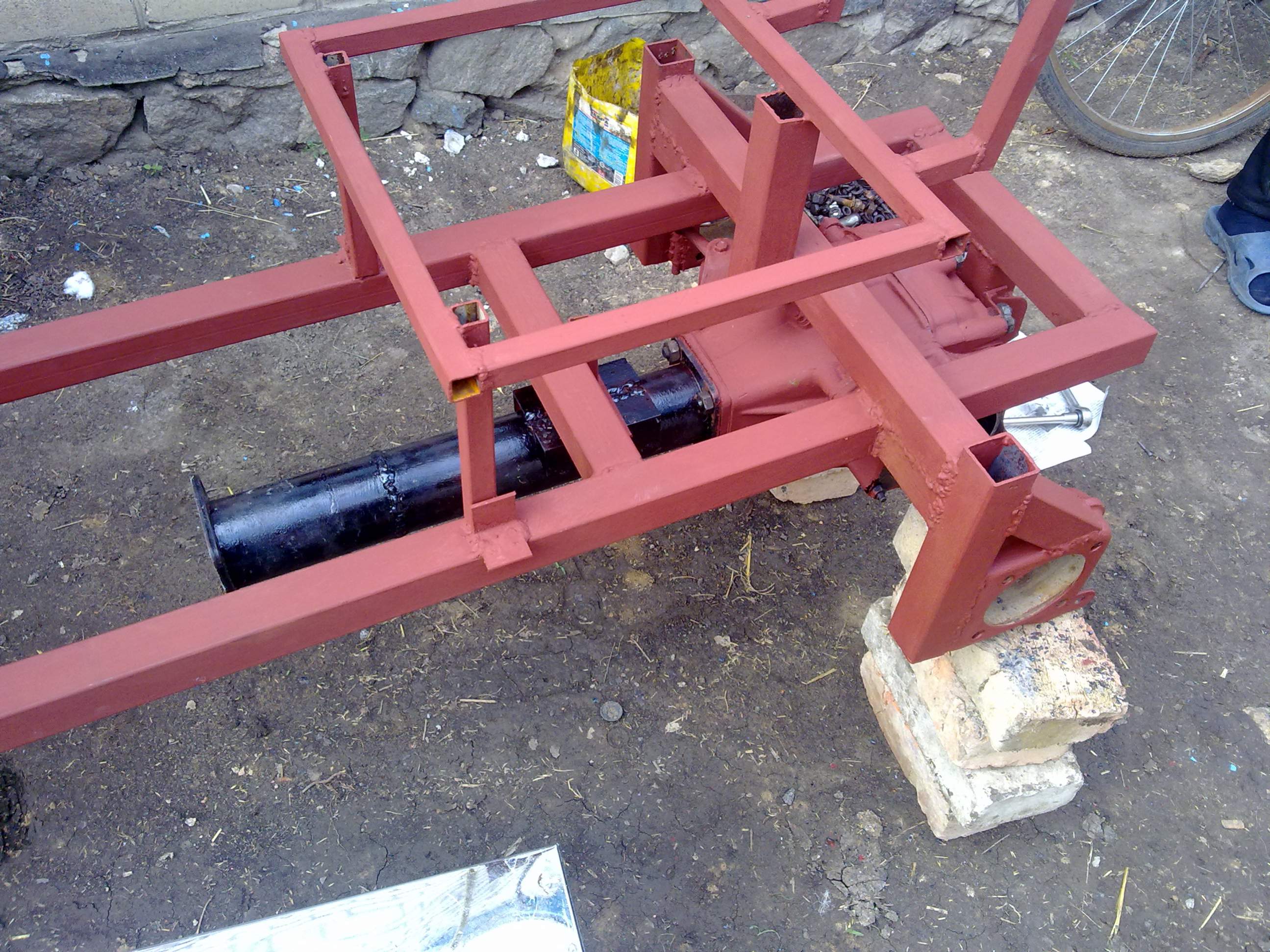

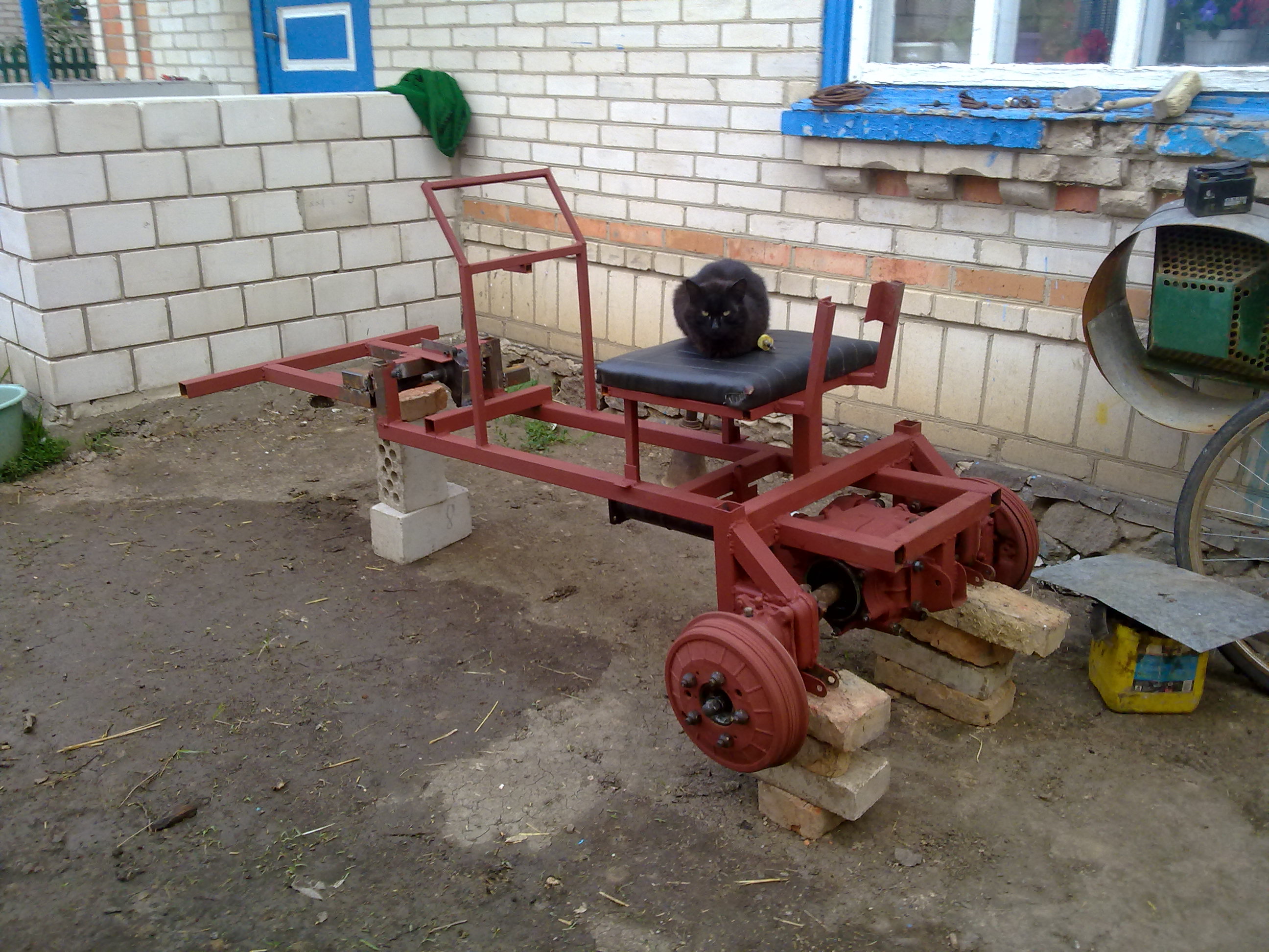

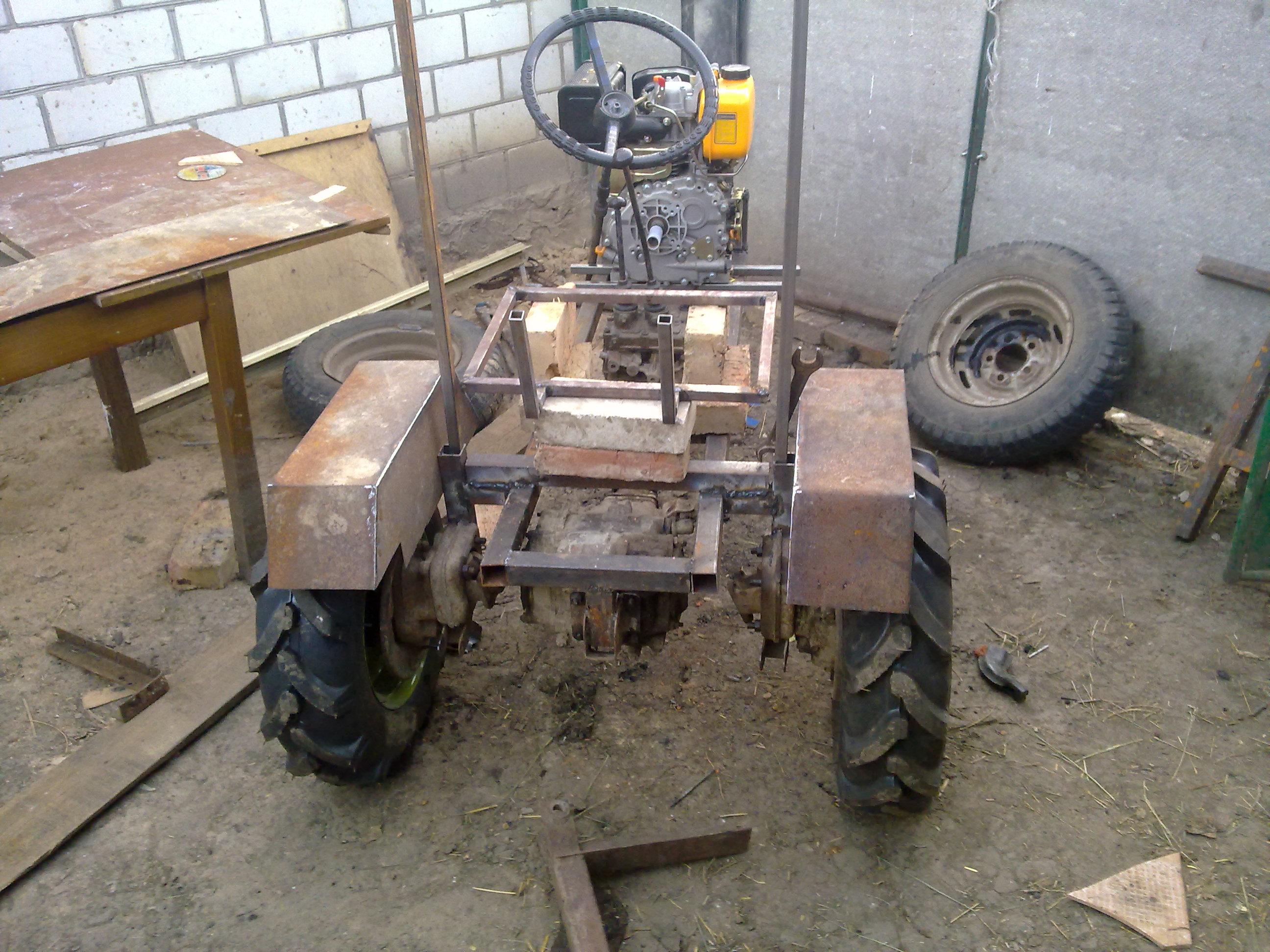

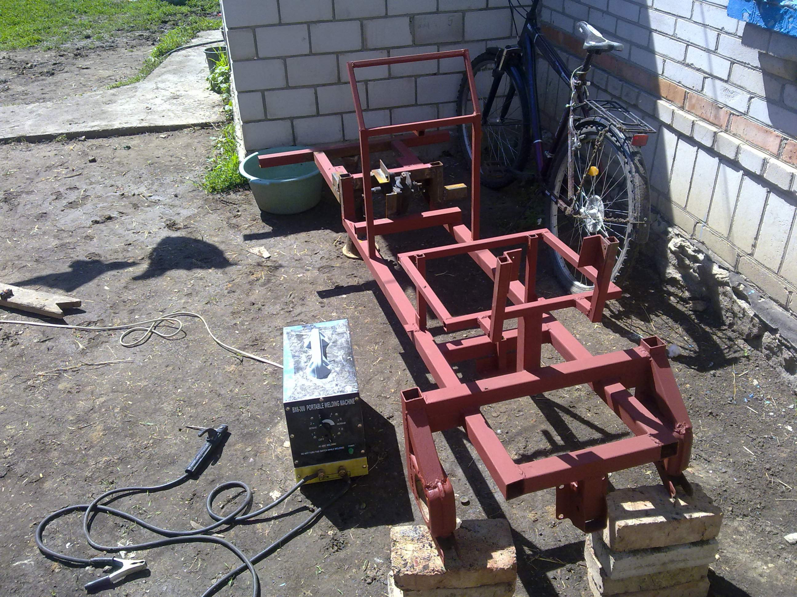

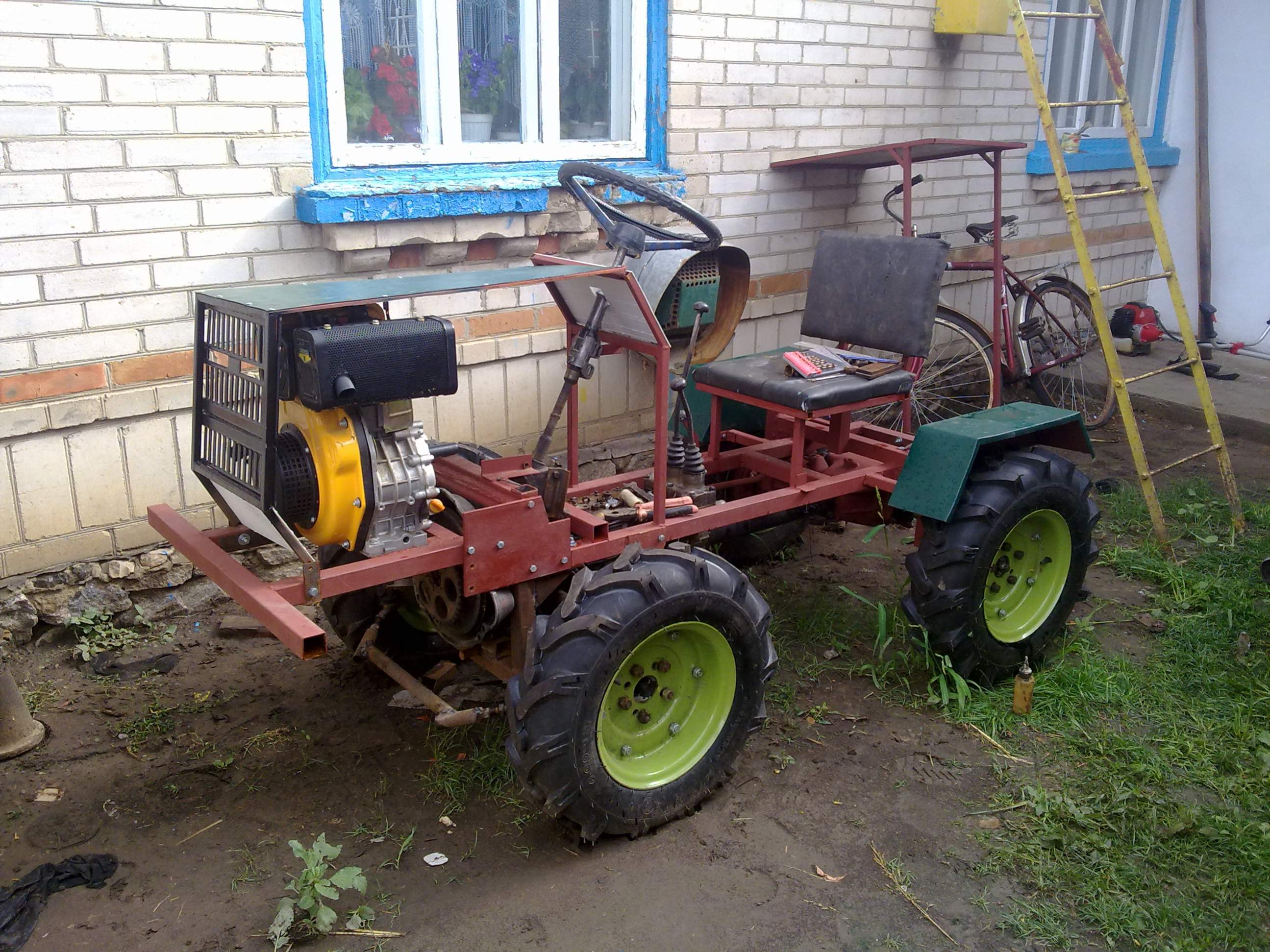

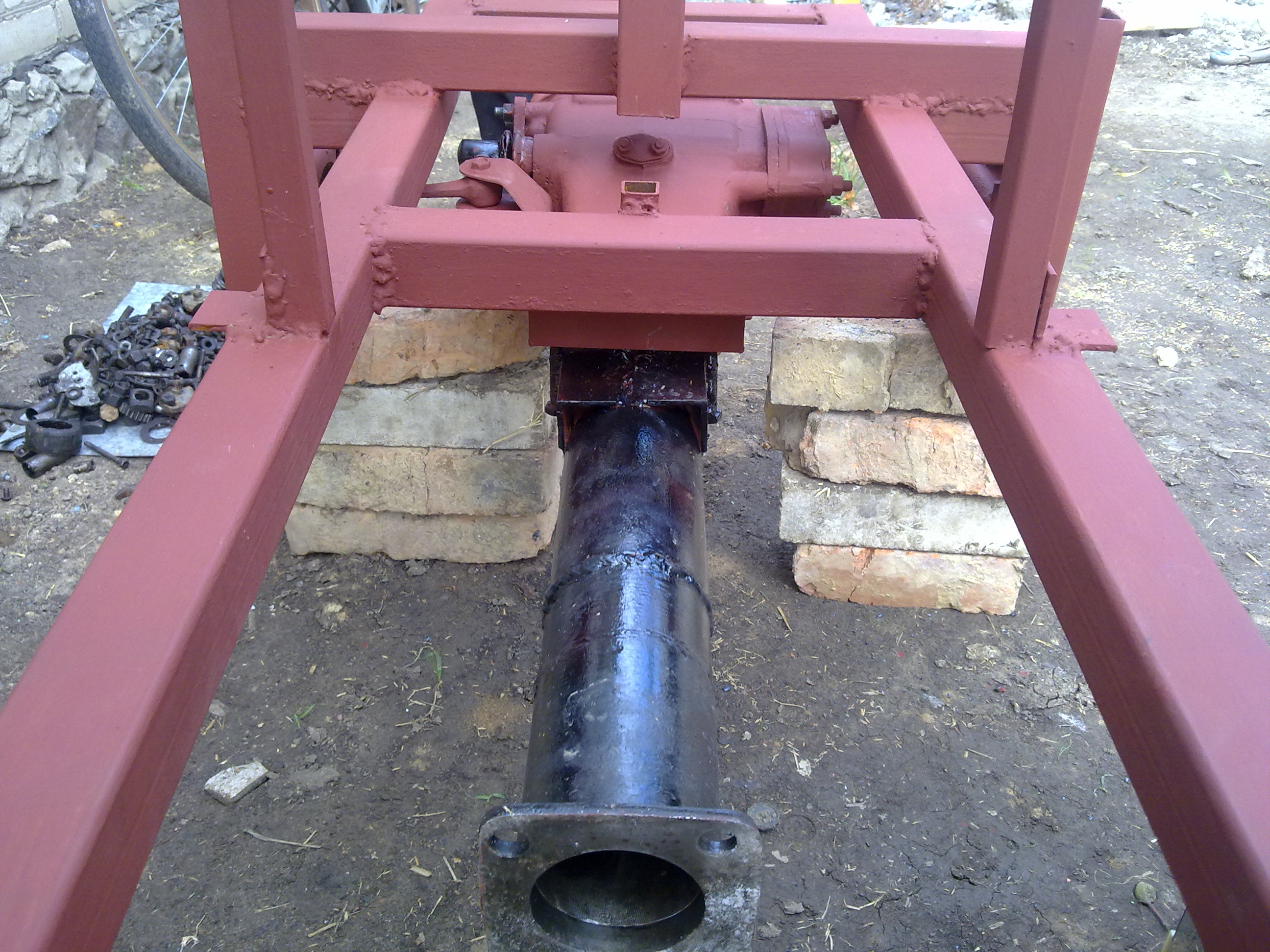

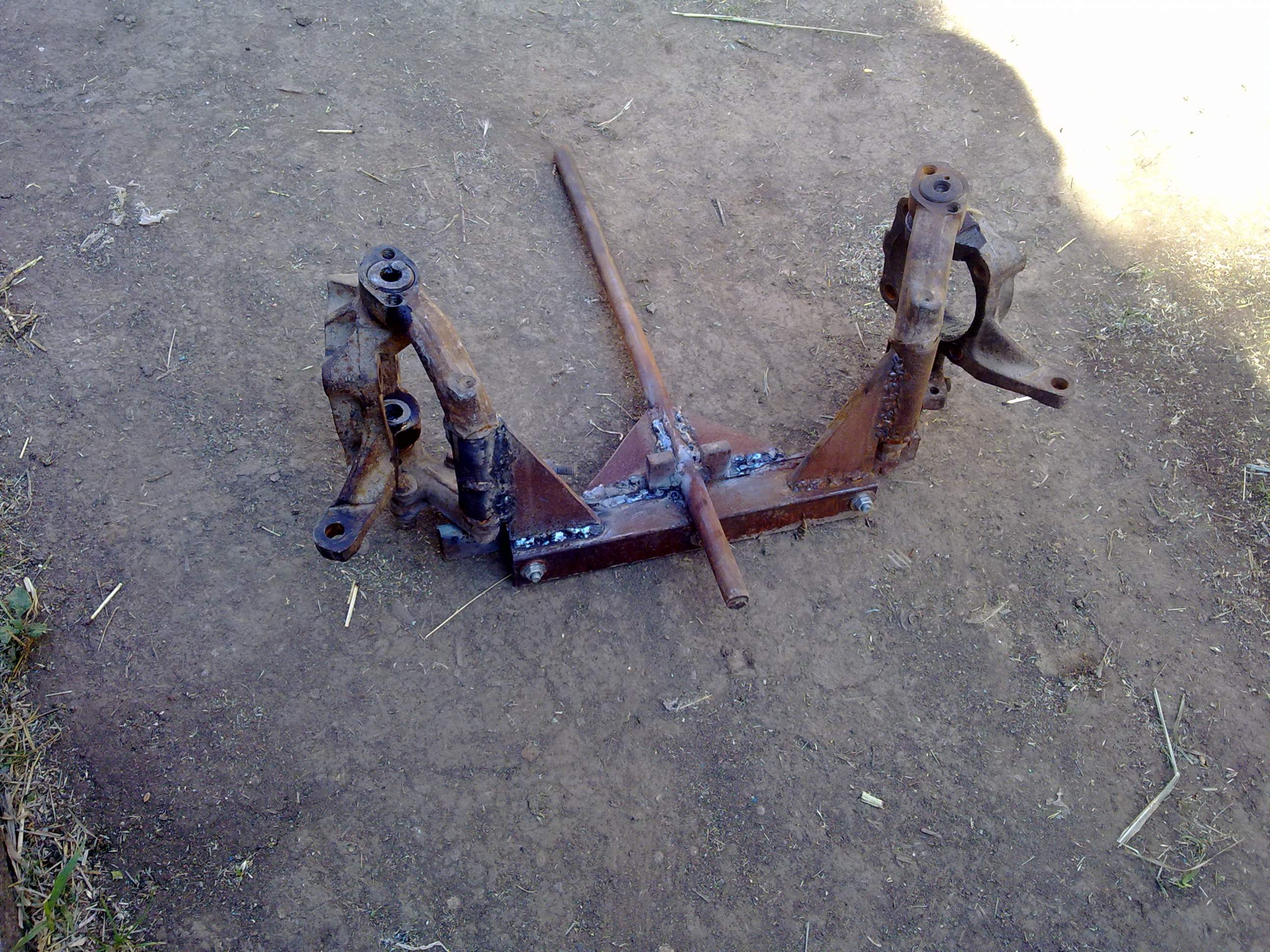

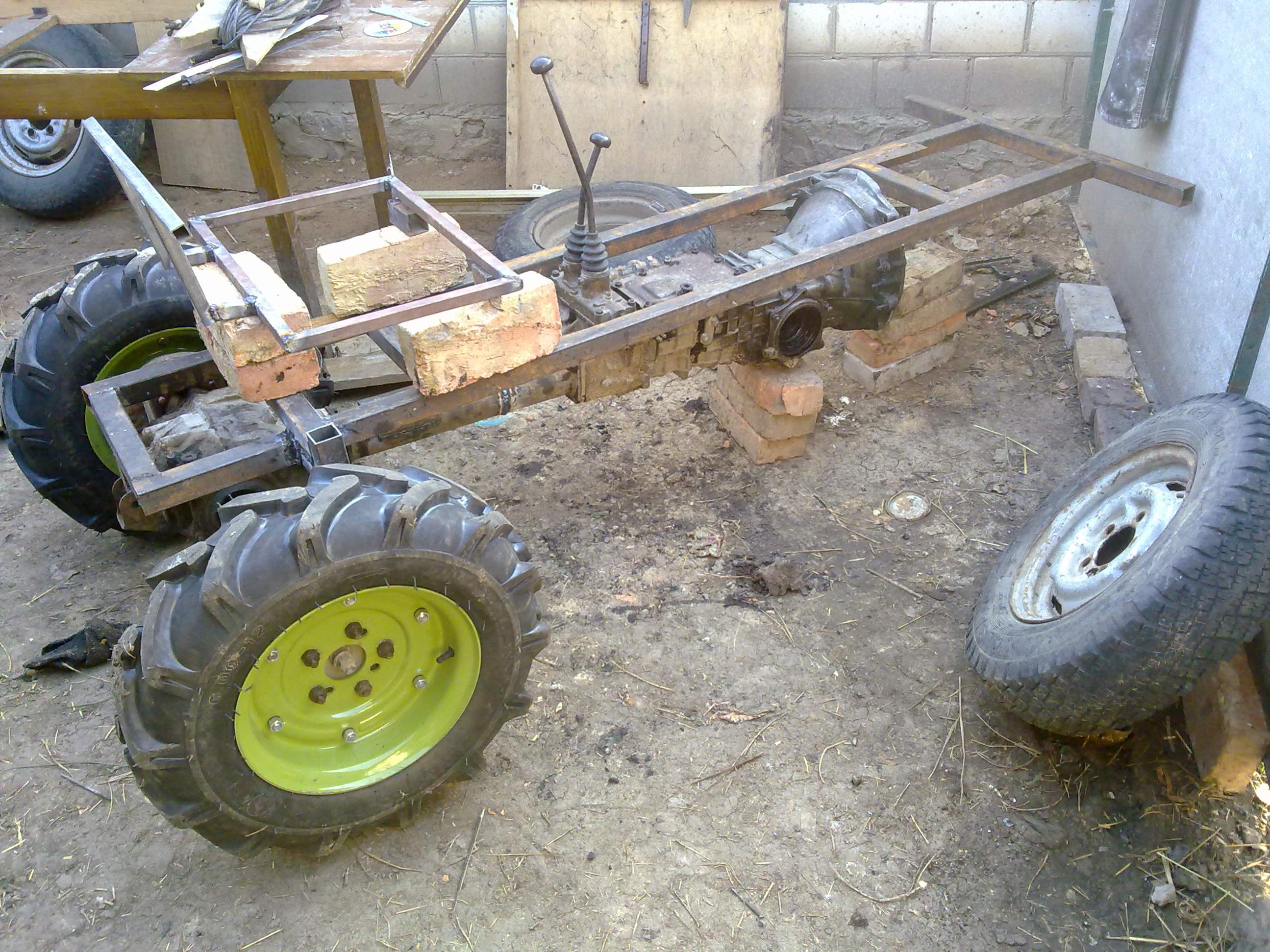

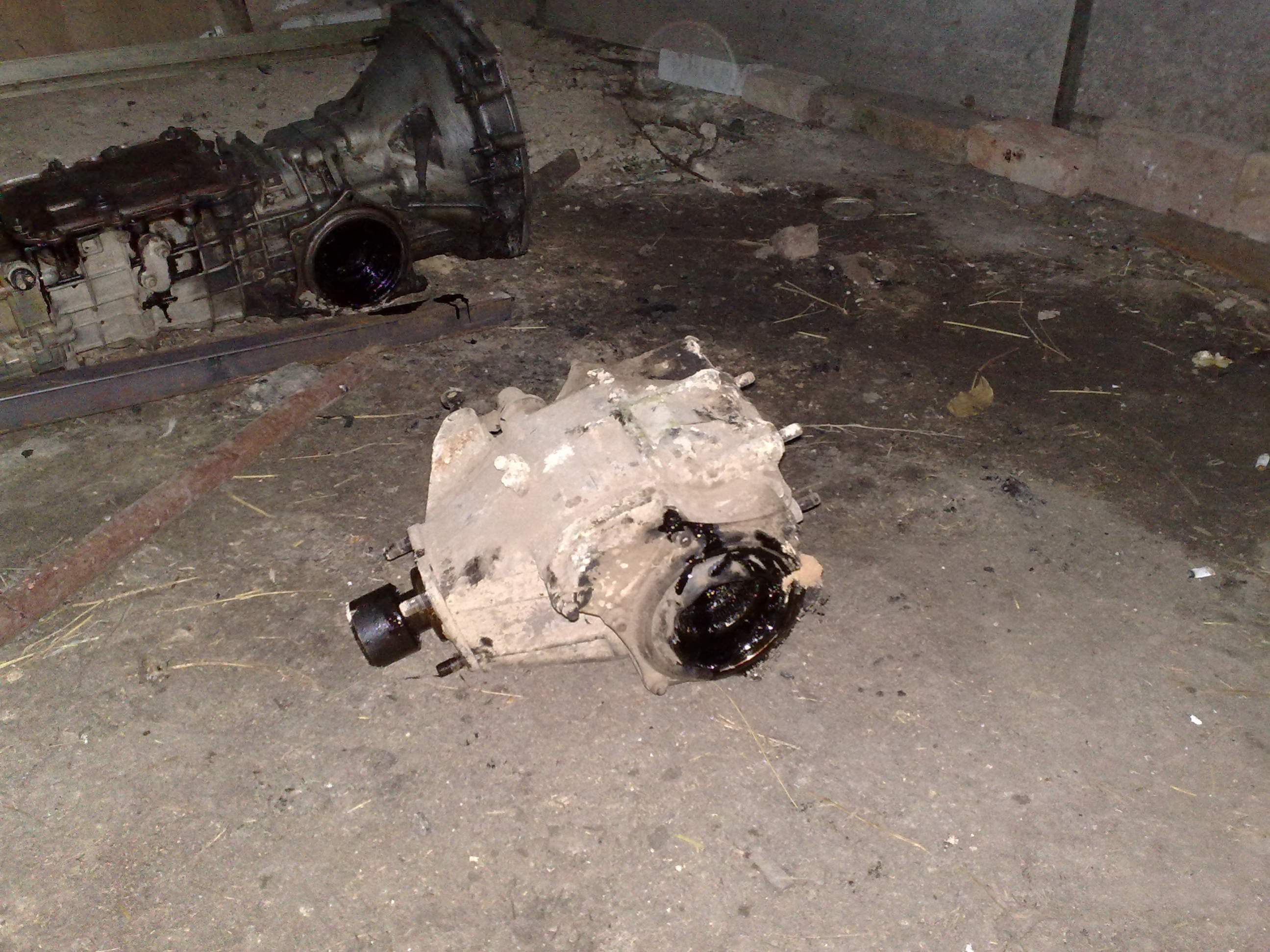

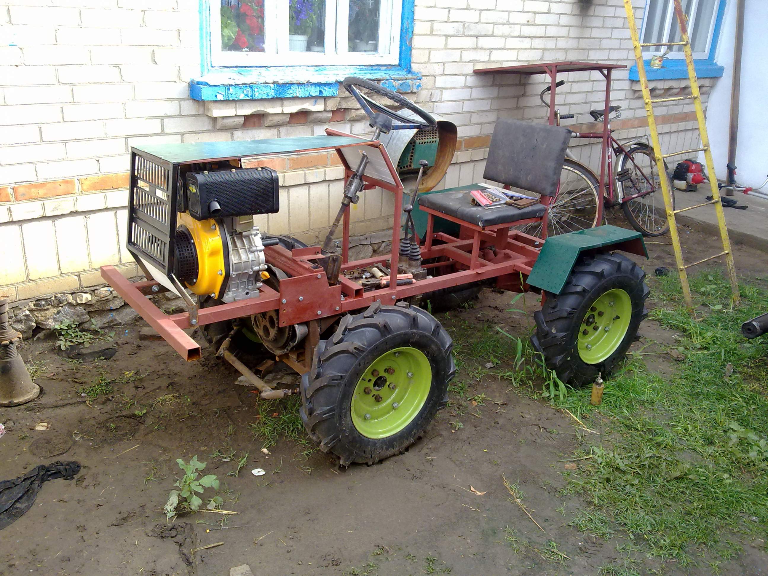

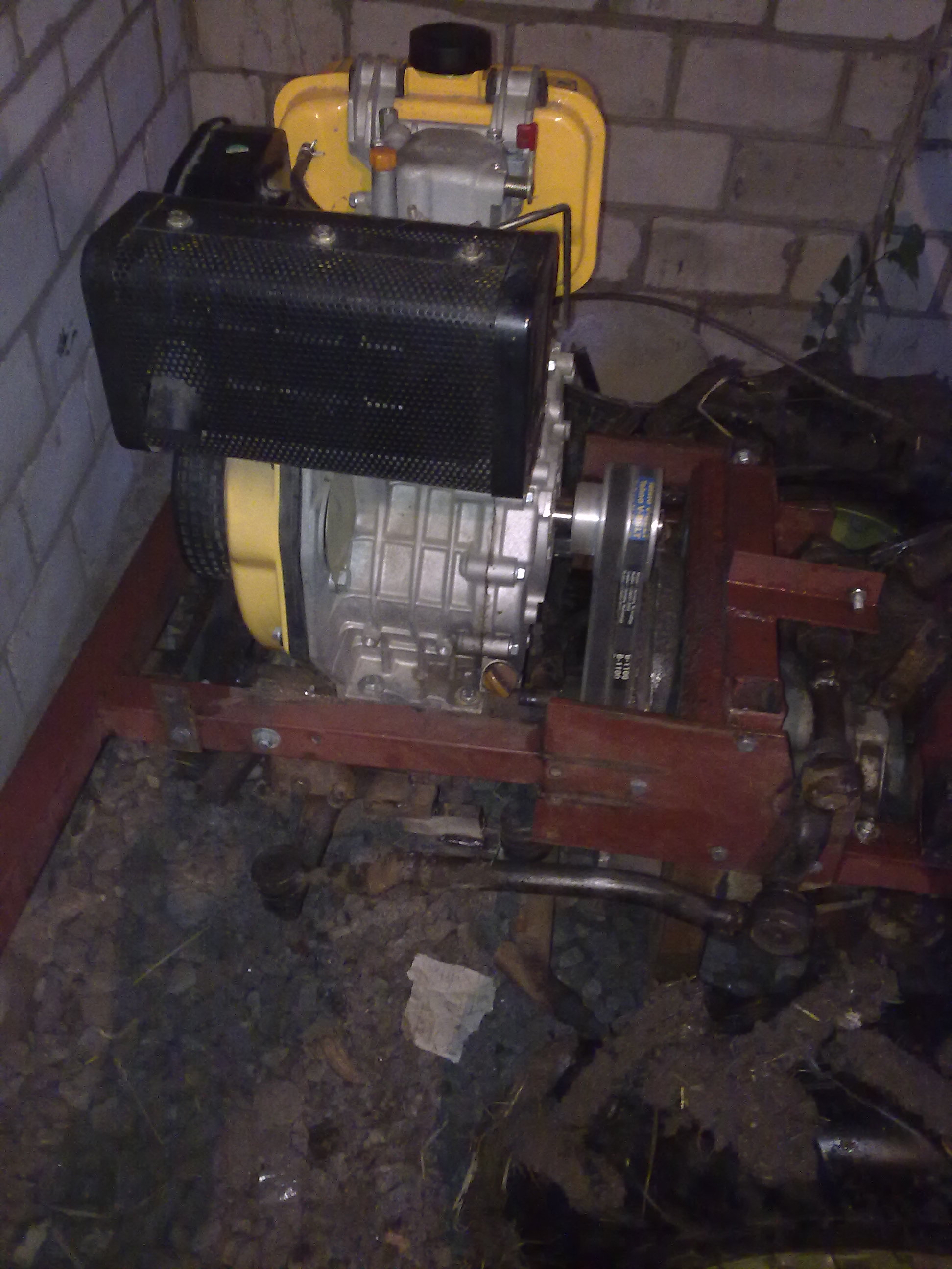

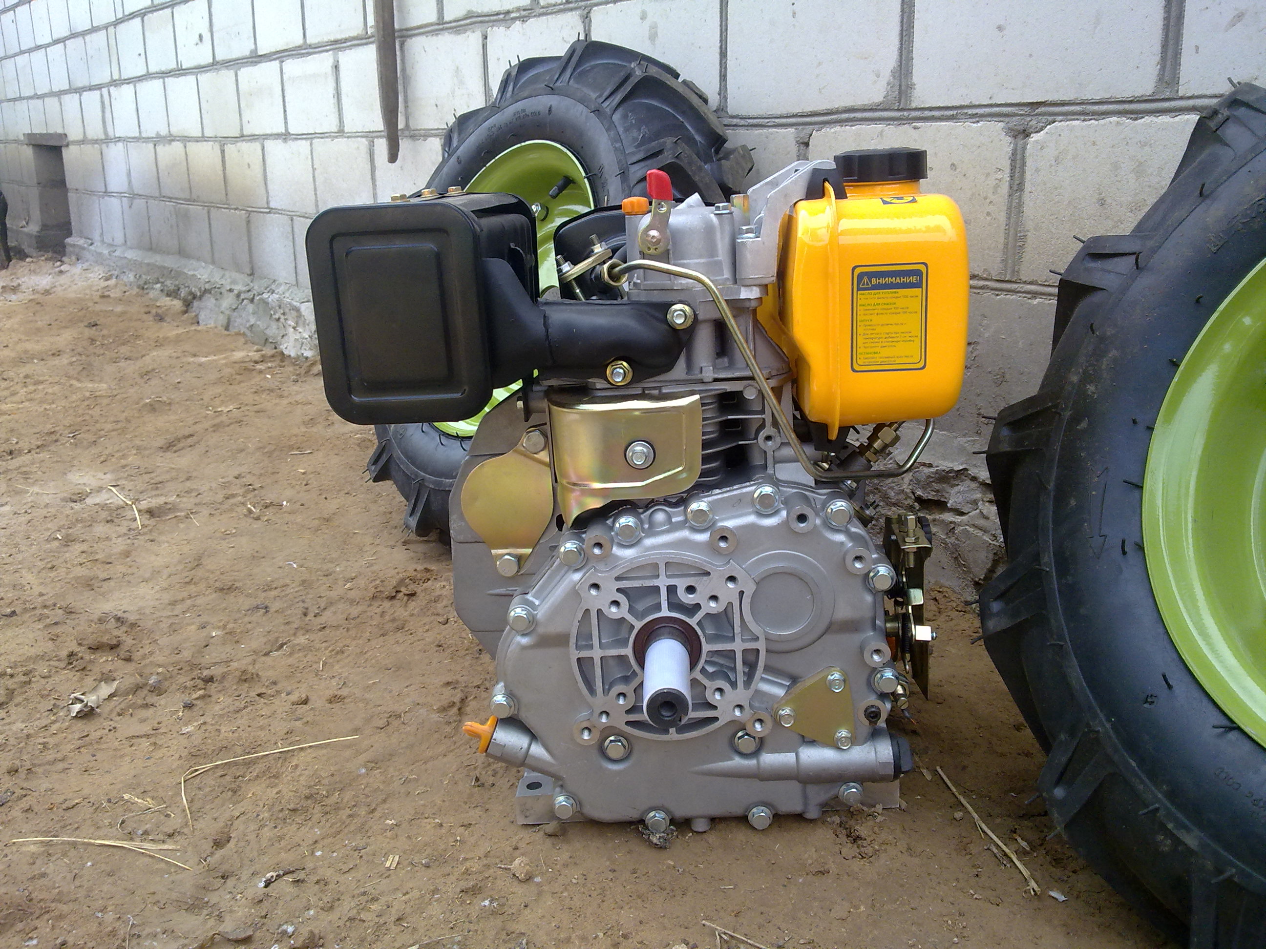

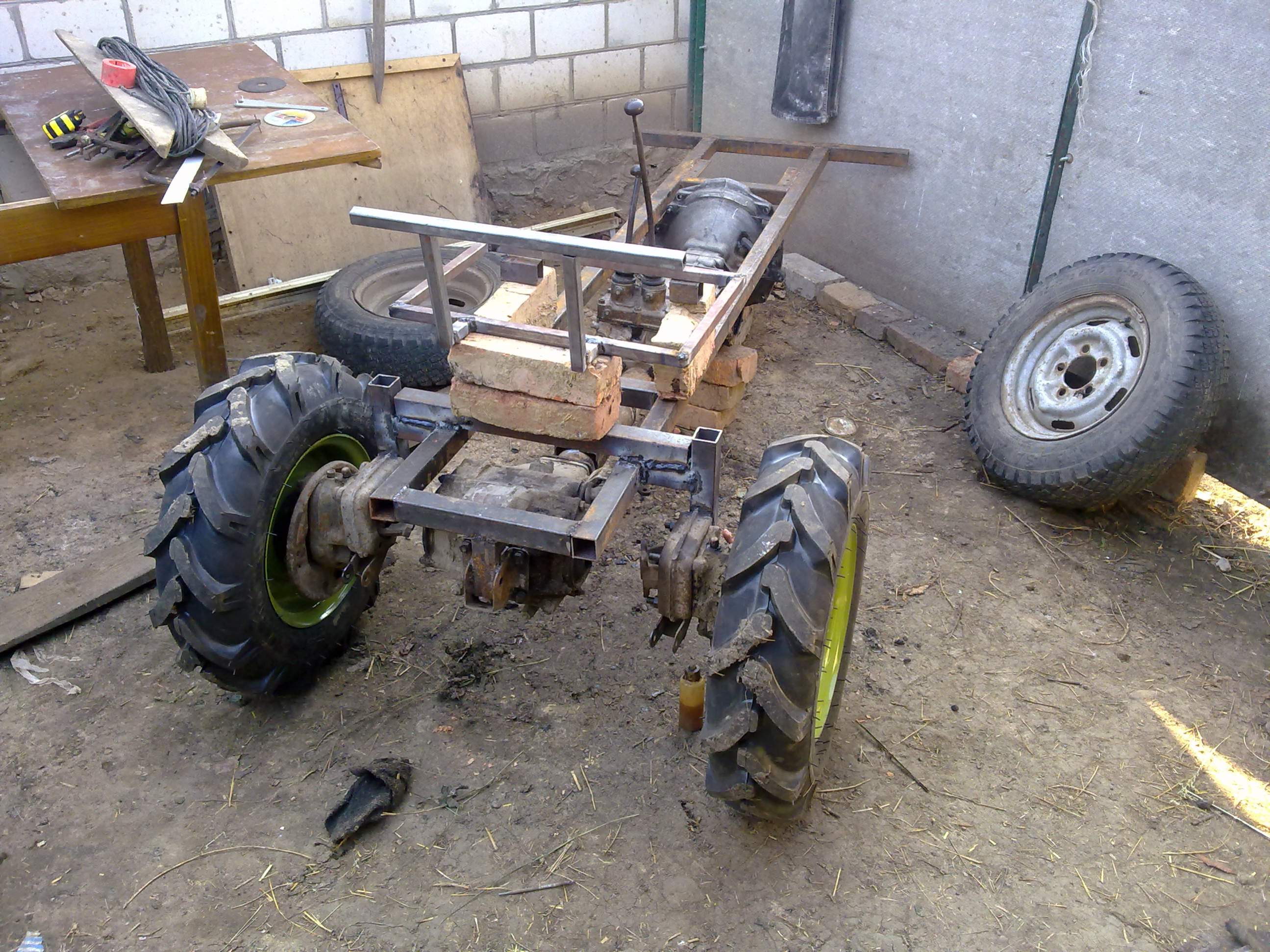

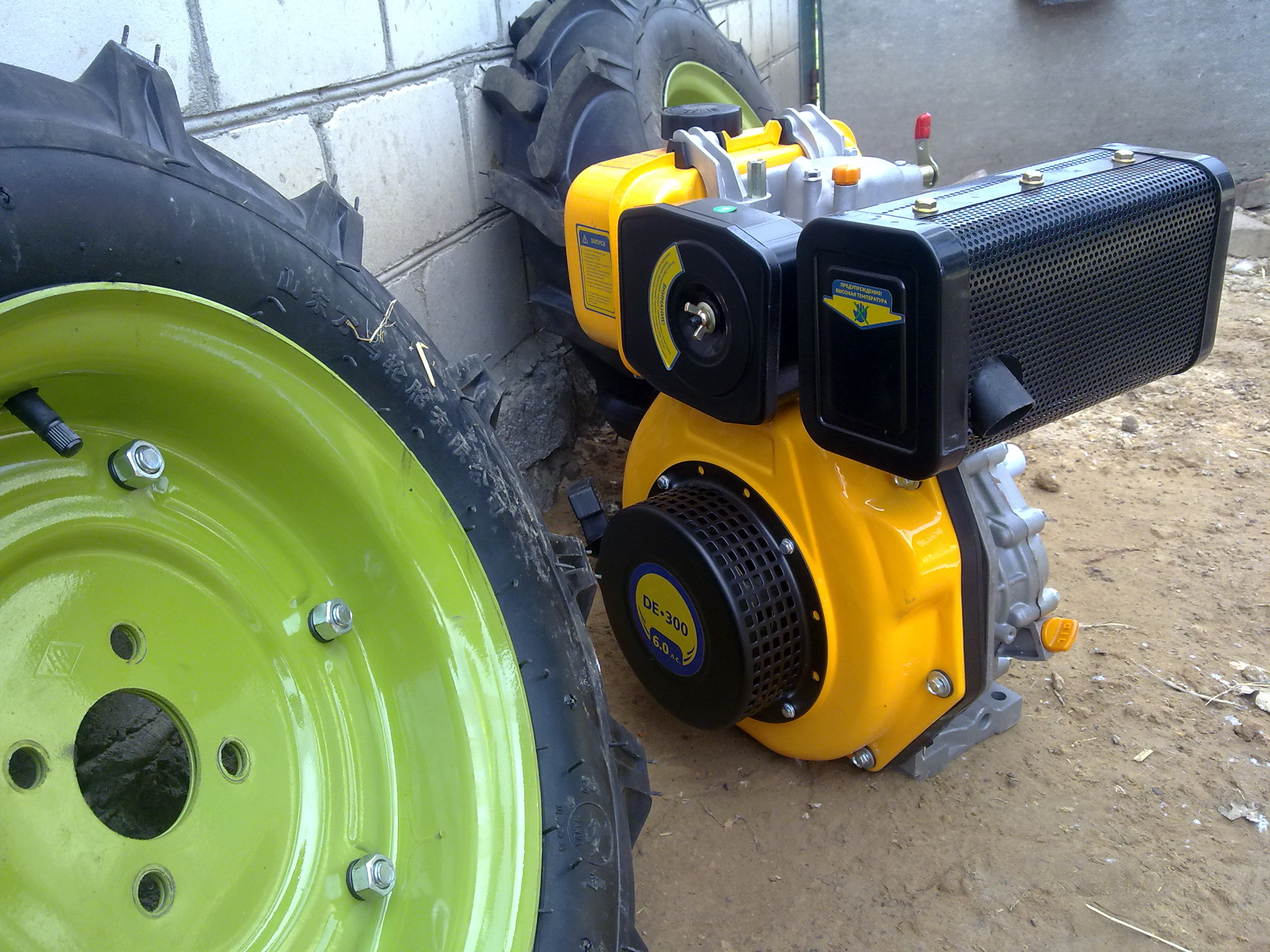

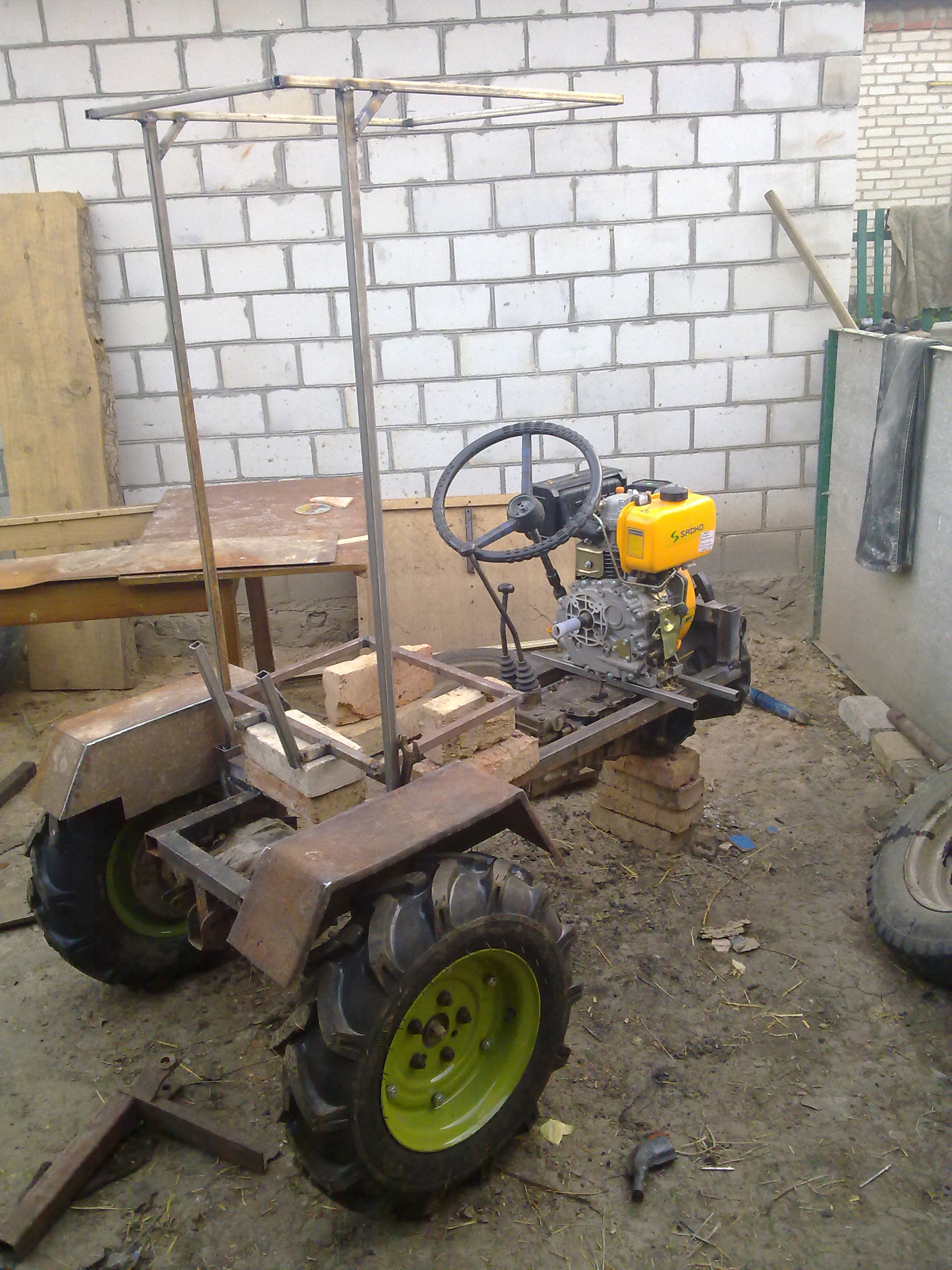

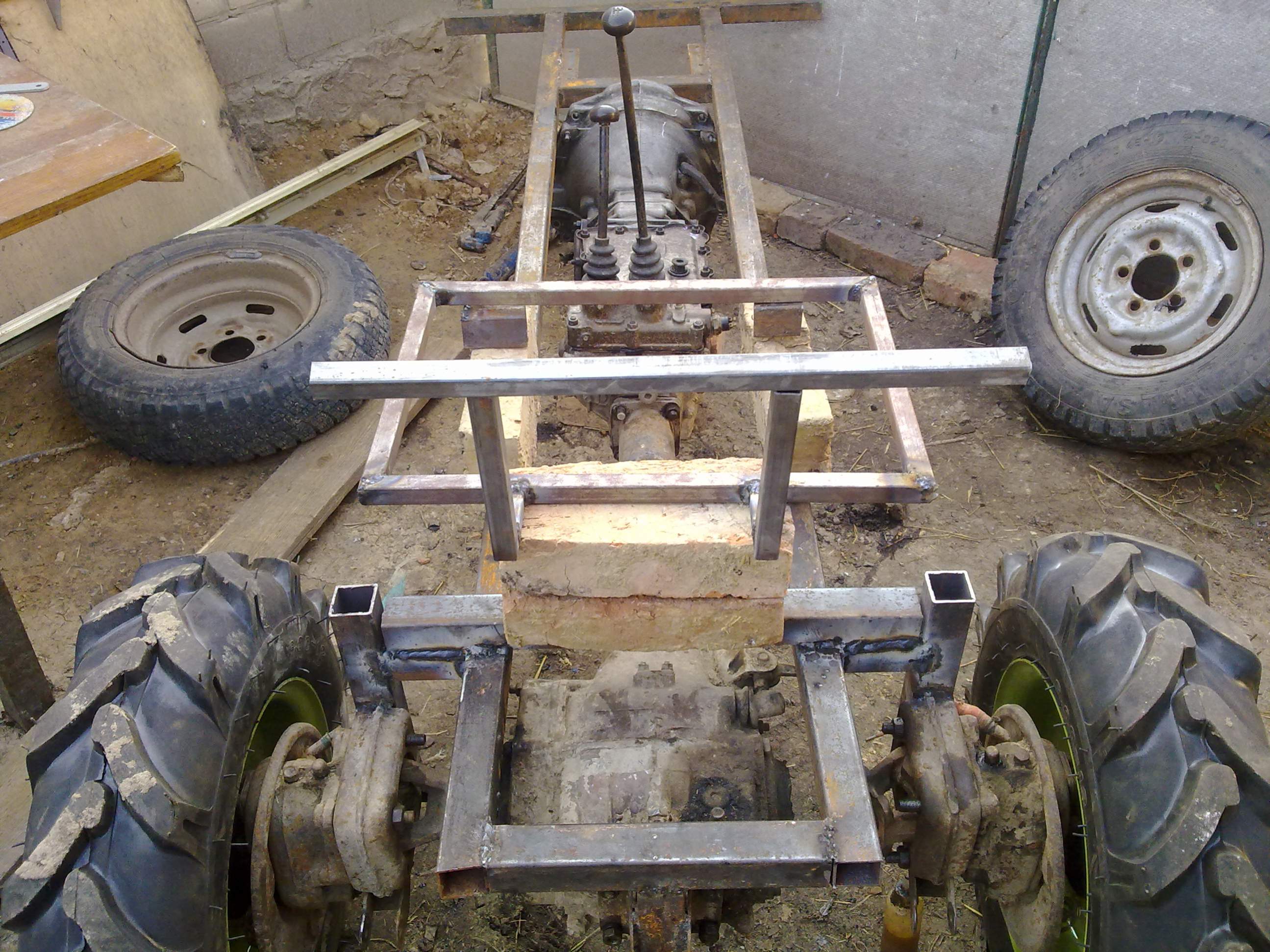

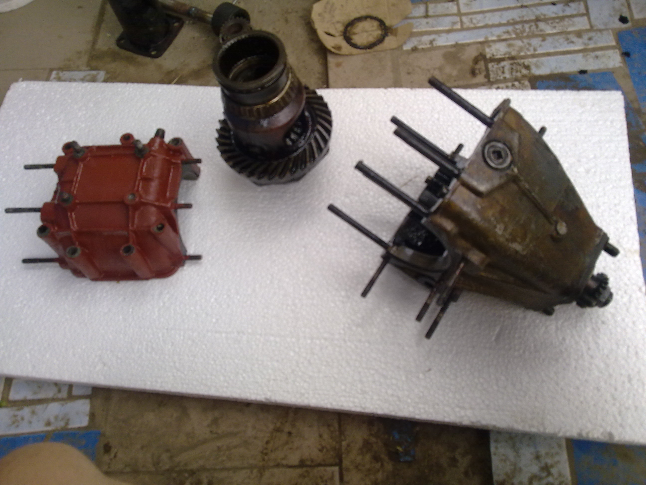

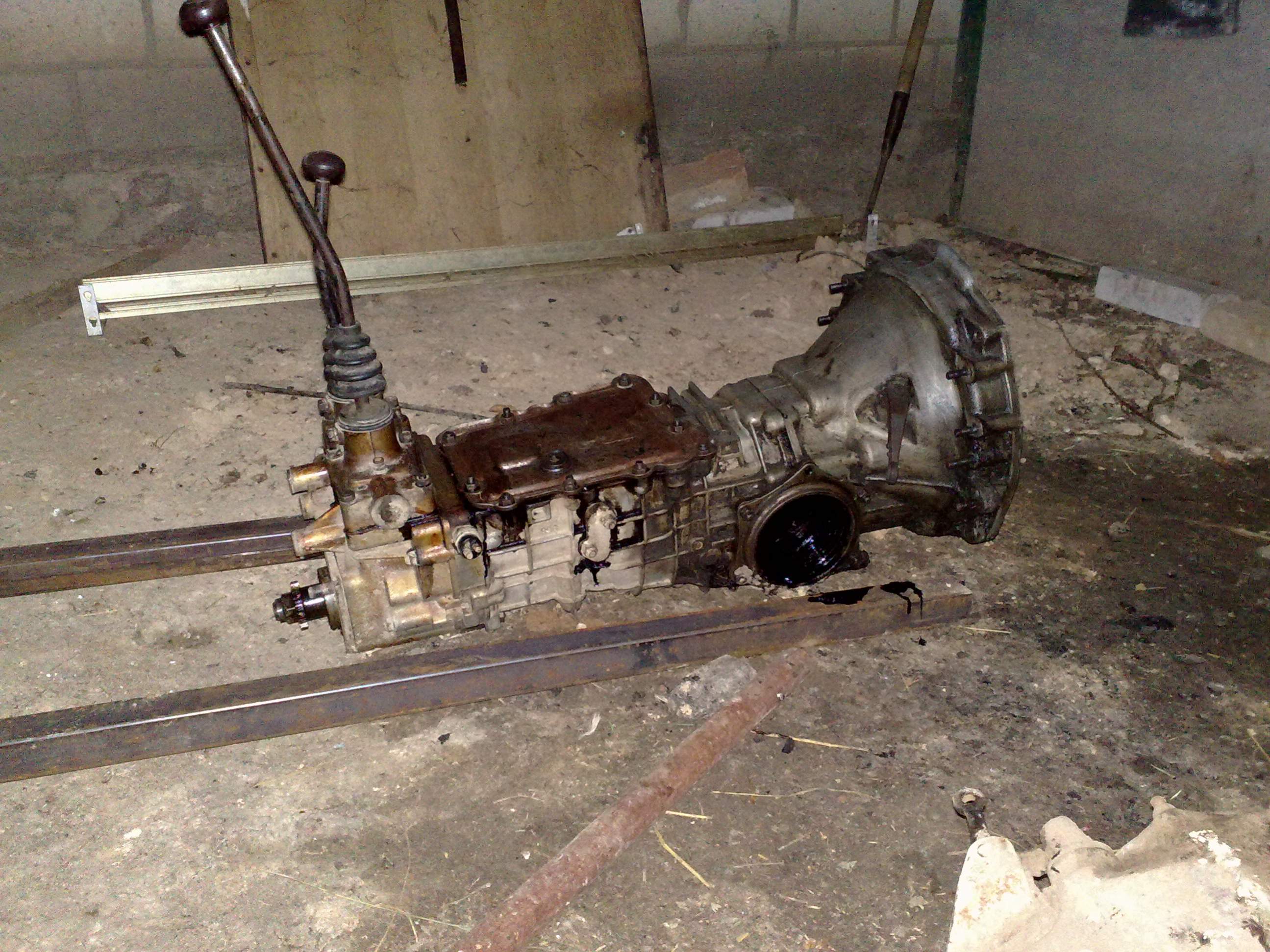

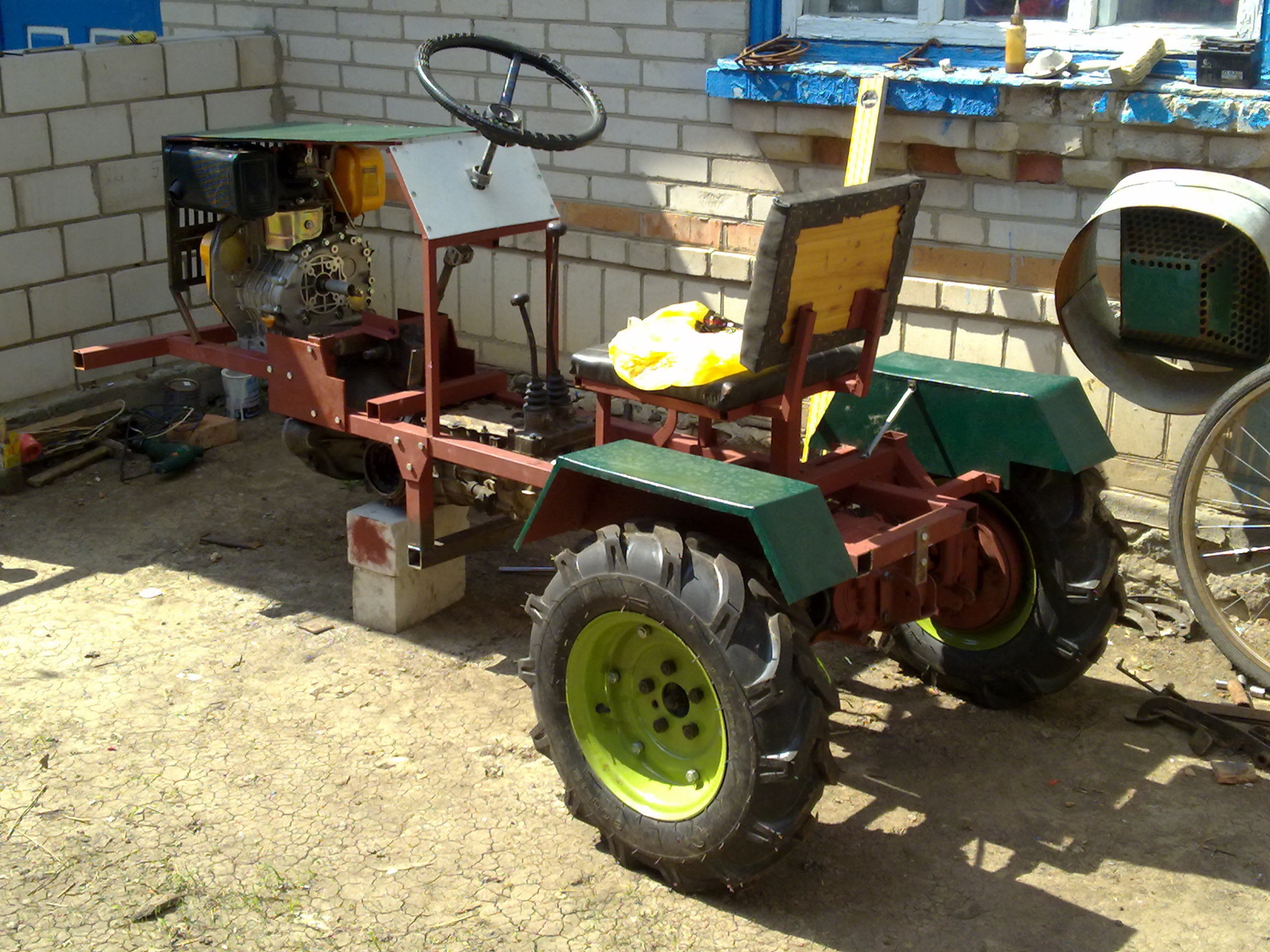

As donor parts I chose LuAZ 969m. Axles and gearbox , rear and front axle, side gear. Rear differential can be locked by desires.

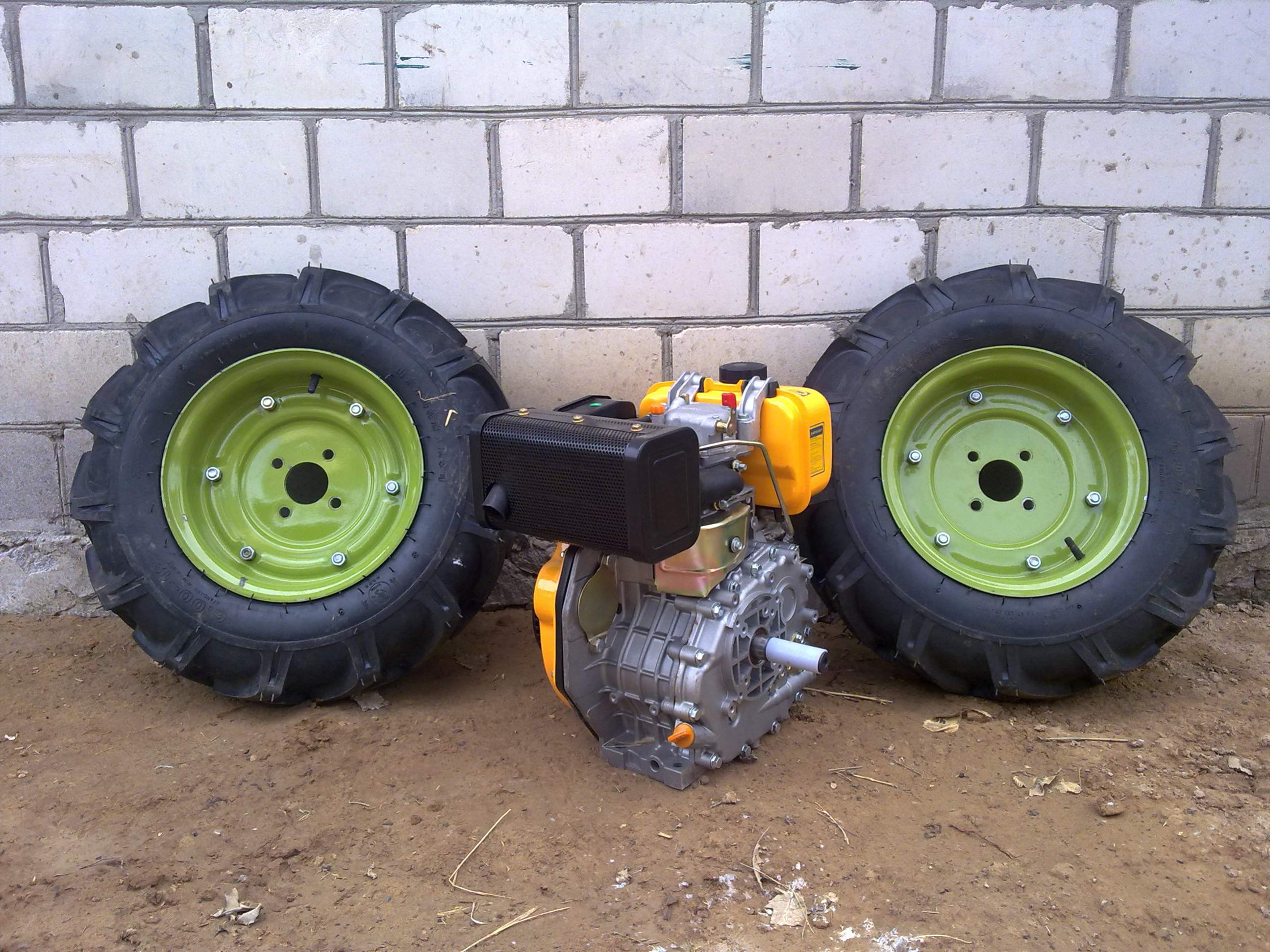

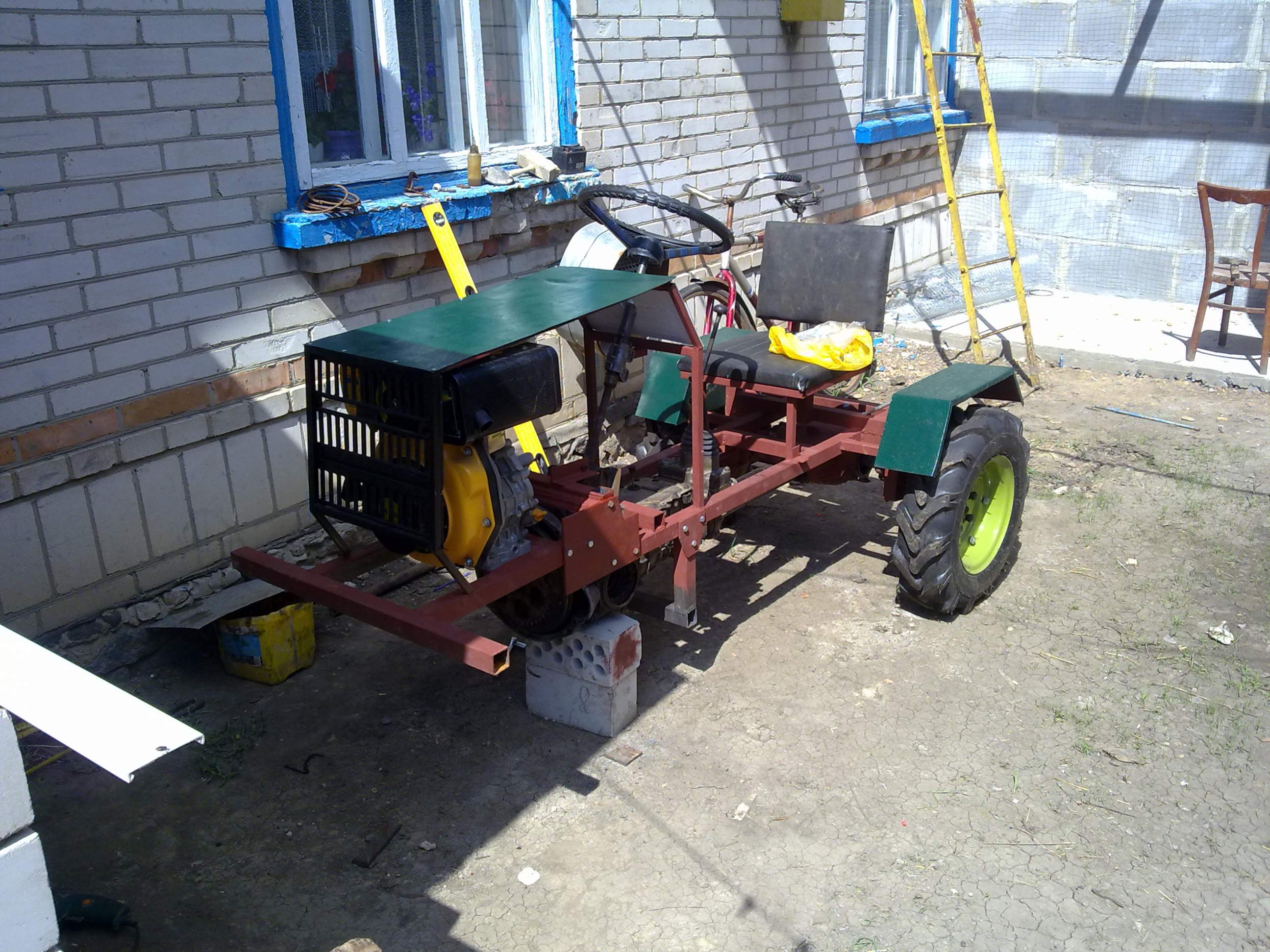

The frame is made of profile tractor 40x40. Wheels of motoblock, size 6x12

That's awesome! I love to see the creative work that people do, especially from a different culture. We are all similar, yet different too, and seeing the end result of another persons thought processes is fascinating! Thank you for sharing, and if you have time, take some video and post it! I would love to hear it run and see it in action!
