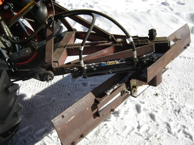

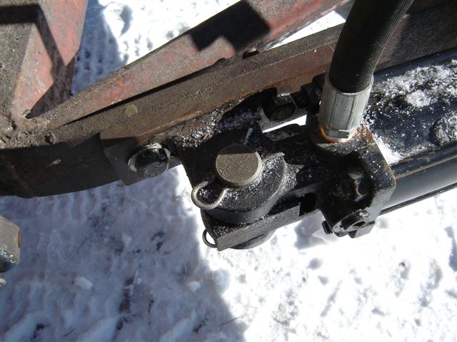

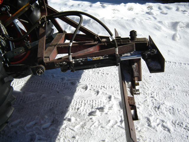

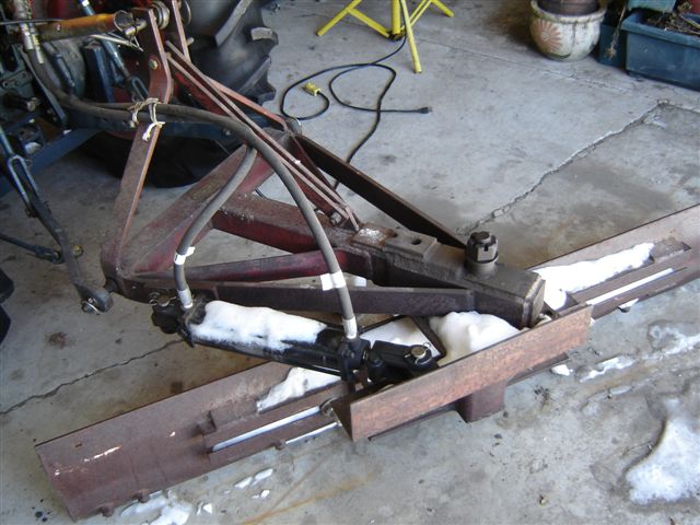

Gentlemen
I put a 2 1/2" x 12" tierod cylinder on an older rear blade. This is the best addition I made with the least work. It has been used for 3 seasons and only once did the plate bolts loosen. When you are plowing there is nothing like being able to feather the 45 degrees right or left. There are changes I would like to make but it works just fine.

Nice setup, beats the heck of jumping up and down off the tractor to change the angle.

With the interest in this post I took a few more photos of the blade without the snow. I also measured my own work and the cylinder is a 10" stroke not 12" stroke. Photos are still in the camera. There is a lot of strain when you a pulling hard and hit something. I did see a real Road Grader that can turn its blade 360 degrees with 1 cylinder through a cog gear and a rotary valve
