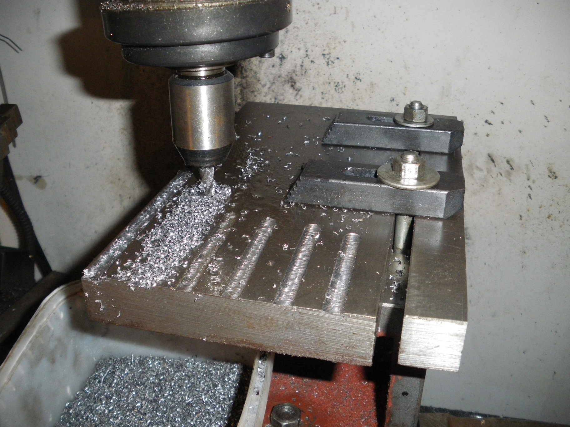

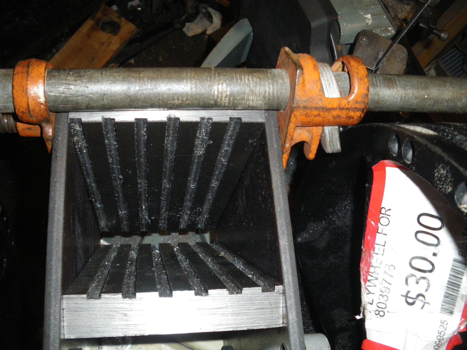

The Jaw plates will have weld beads along each ridge and ground into some form of a point.
Welding on the compressed side isnt much of an issue, if a crack appears, it will be pushed closed at every load cycle. Welds on the back side, the tension side, are nastier because they are pulled further open at every tension cycle.

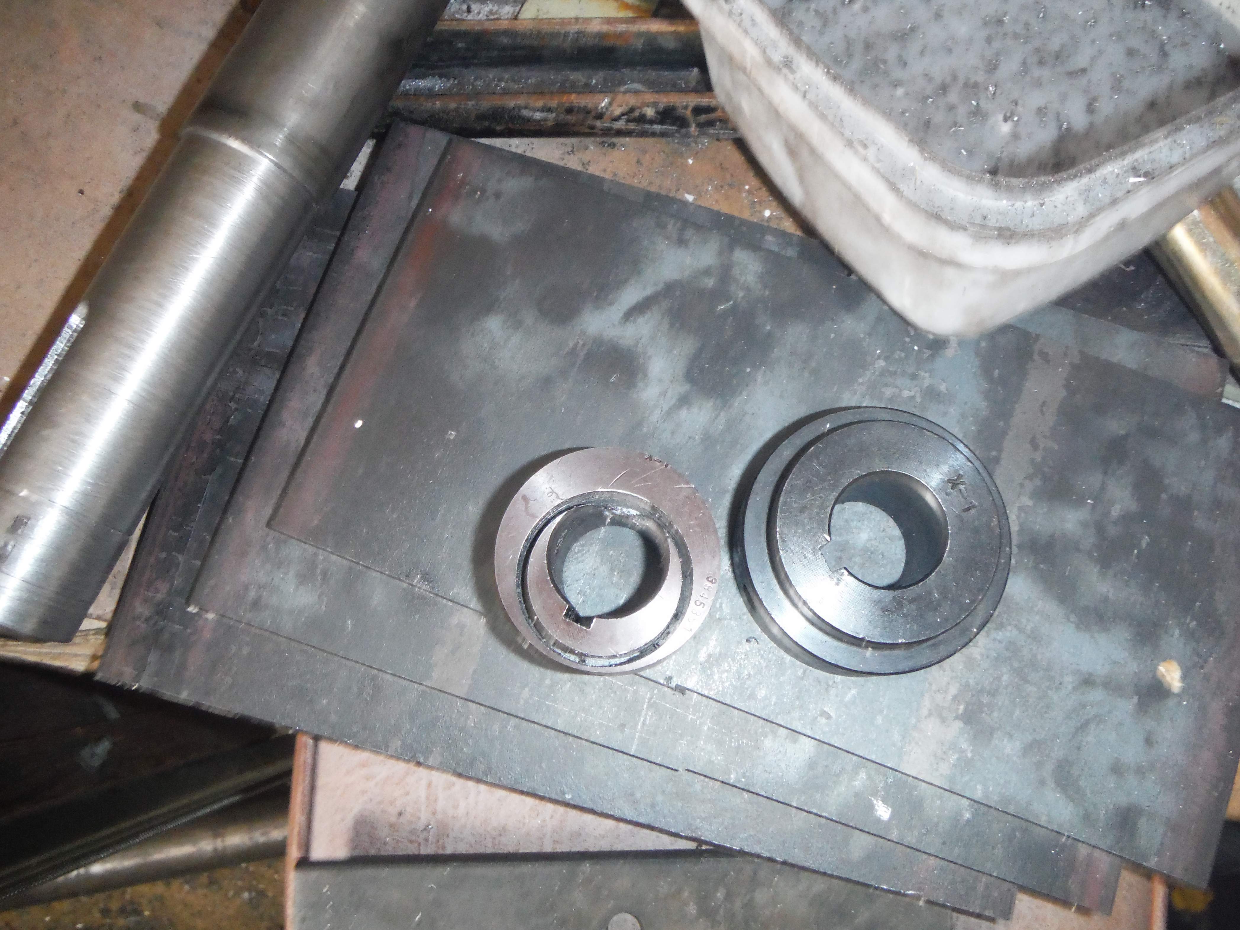

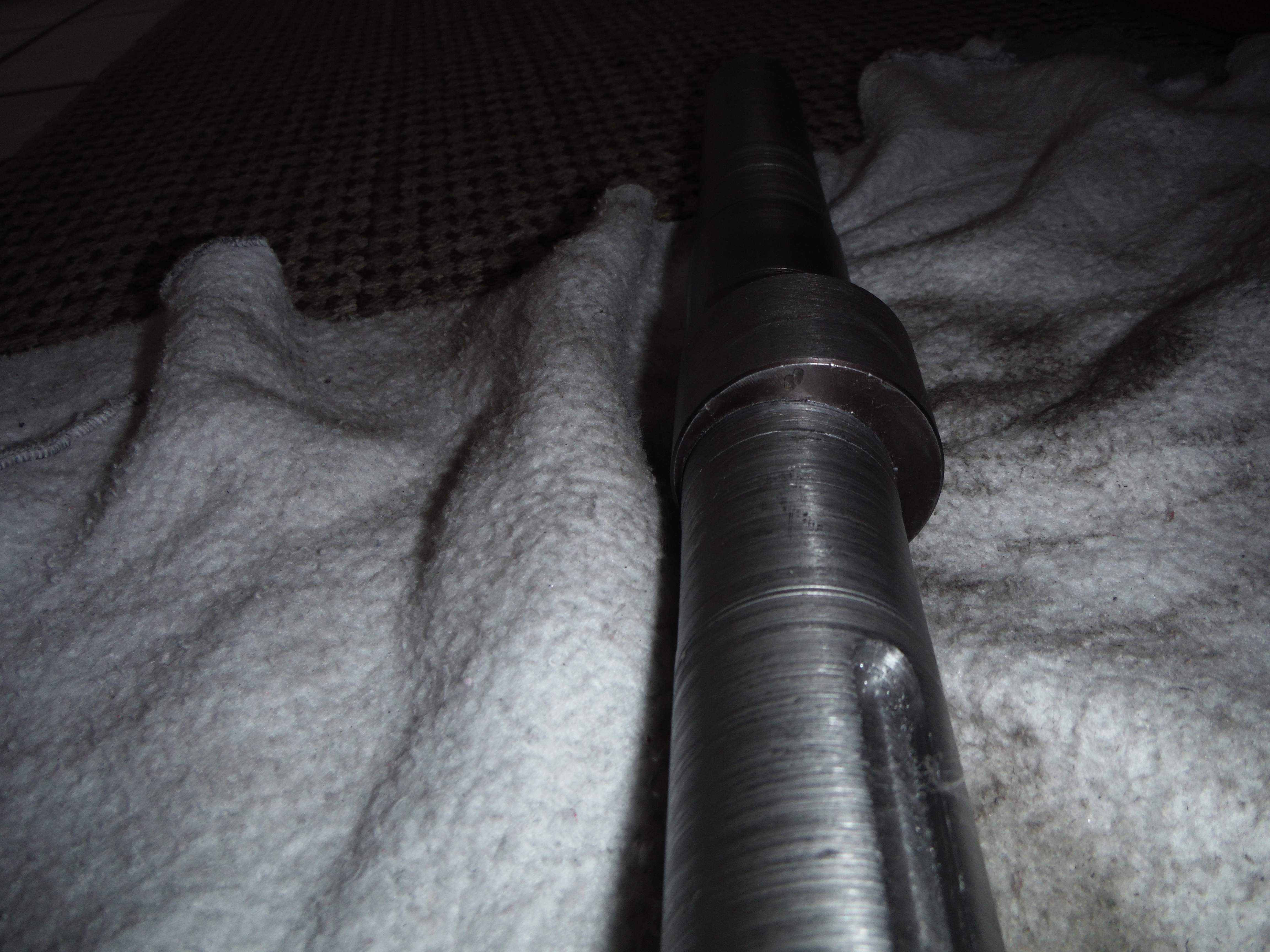

This was my idea for a CAM lobe. Took an X Series Hub, used a hole saw to cut a hole the size of the shaft. Then turned the outside of the hub to the Bearing ID. Then I will weld two of these to the shaft. This will give me about 3/4 inch stroke.
/ Homemade Jaw Crusher.
#24
This is one of two cam lobes pressed onto the axle. I will add some weld to the side to hold it in place.

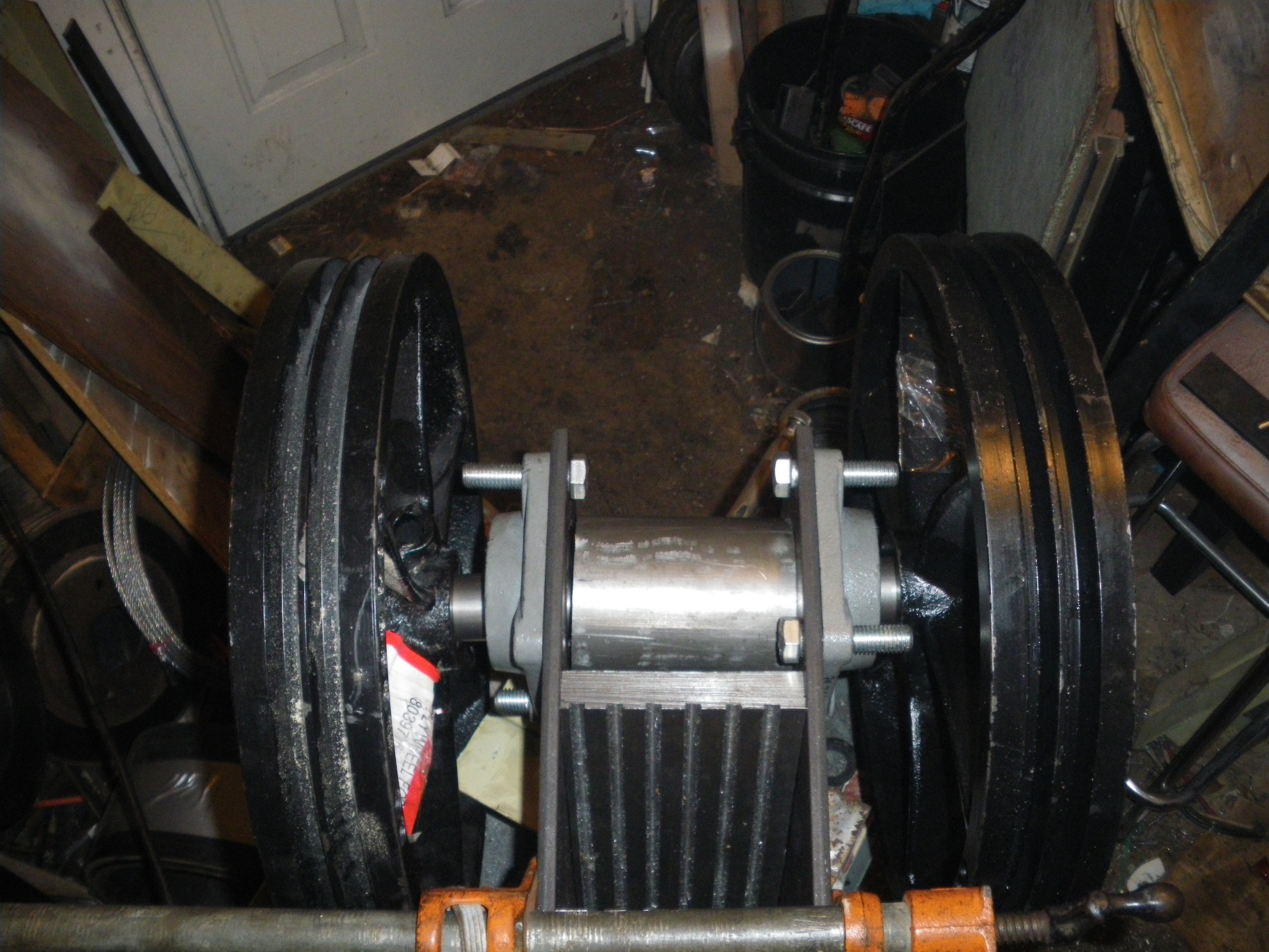

#25
Two cam lobes cut and pressed on. Mocked up the housing and bearings that the Jaw plate frame will be welded to. I am a bit concerned that the stroke will be too Small at under 1/2 inch. I will likely try it out before rethinking things as bearing size limits the cam lobe which means $$ more on bigger bearings etc.

It's just a notion, but I'd be tempted to keep the stroke modest to amplify the crushing power.
You're very wise to leave this variable as something you can adjust.
I suspect the secret is to start a crack on the first stroke; not shatter the stone outright.
The second stroke should finish breaking the stone and let the fragments drop down for another cycle or right thru if they're small enough.

I think you'll end up lathing an eccentric shaft out of solid... But lets see how it turns out !! :)

I would have to look for a 4 jaw chuck for my chinese lathe in order to machine a cam from a single piece of steel. At least I can't figure out how to offset the the shaft on my 3 jaw. It would take me three days to cut down a 2" shaft anyway. BHD the flywheels are for inertia. The bigger the flywheel, the smaller engine required. Hoping to start welding tomorrow, though its extremely cold and I have no heater in the garage. As far as strain and everything, there is a site where a company rebuilds broken Jaw Crushers. Really big machines that eventually broke. Like 5 inch thick Steel cracking. Then there are ones still in use that are 100 years old.

A flywheel as close as possible to the end user of intermittent power peaks, saves the driveline before it.The driveline behind the flywheel has to be designed for the peak loads, the driveline before the flywheel can be designed for the average load. (thats why im afraid the cam lobe on Davids eccentric shaft gets sheared off, its a high fatigue load, and empirical studies show that welds are 6 to 8 times more prone to fatigue than the base material)
Nevermind, i'd get that crusher working first, before getting into means of lathing the shaft out of solid bar... :)

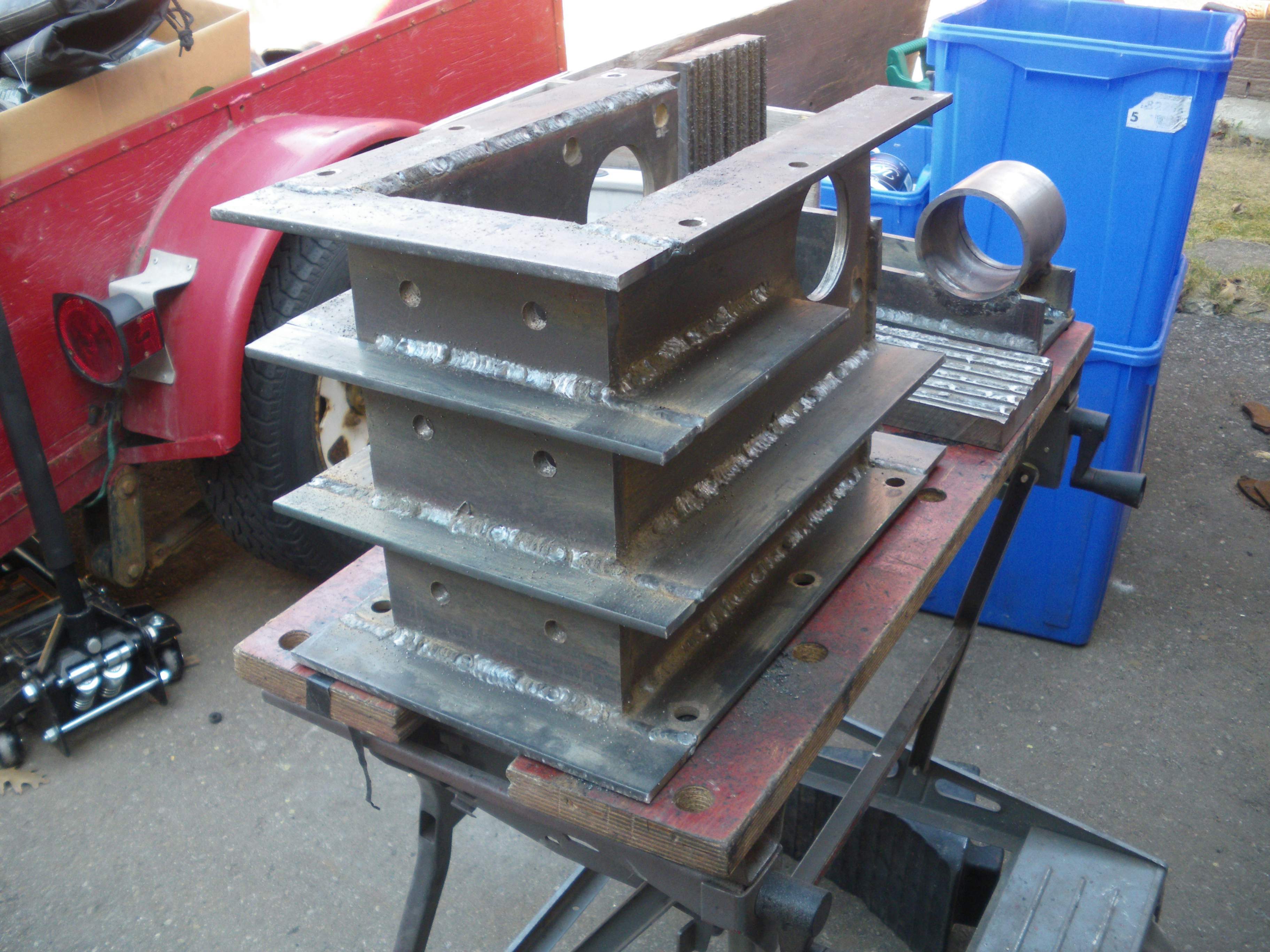

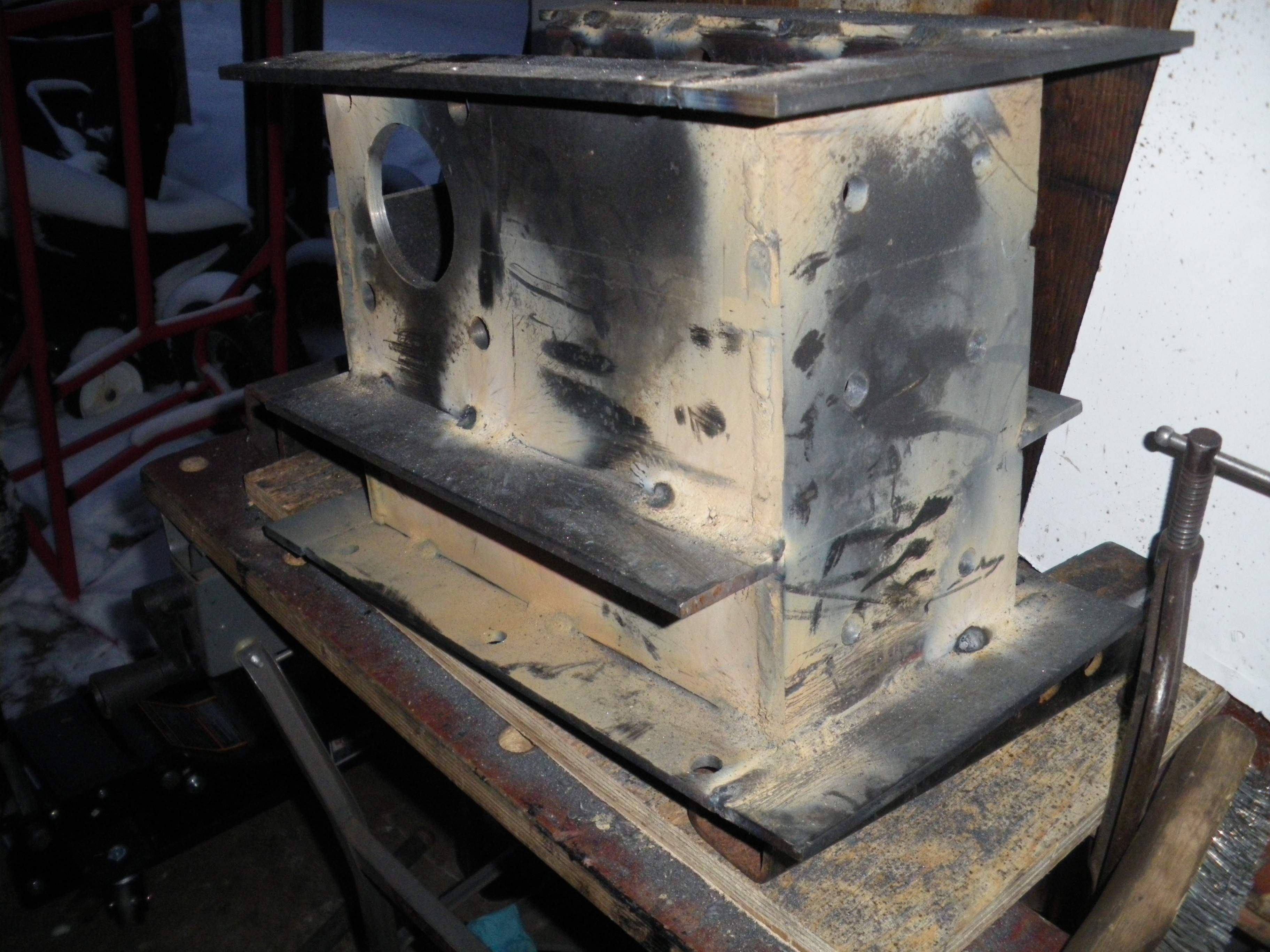

Working on the case. It will be at least three weeks before I get another chance to work on the Jaw Crusher.

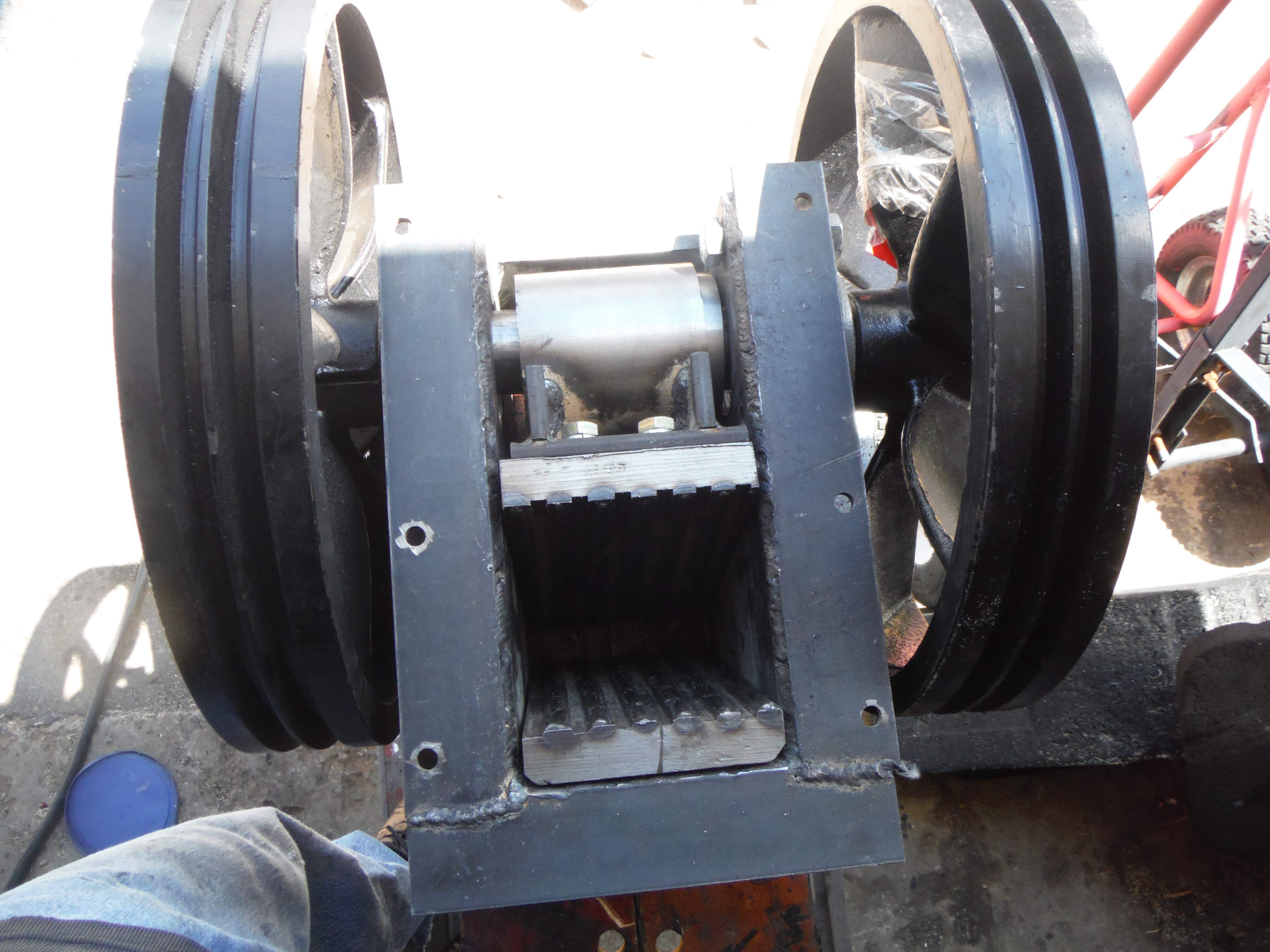

Getting over the worst cold I ever had. So many projects on the go. I managed to put in about 6 hours of welding this weekend on the Jaw Crusher.

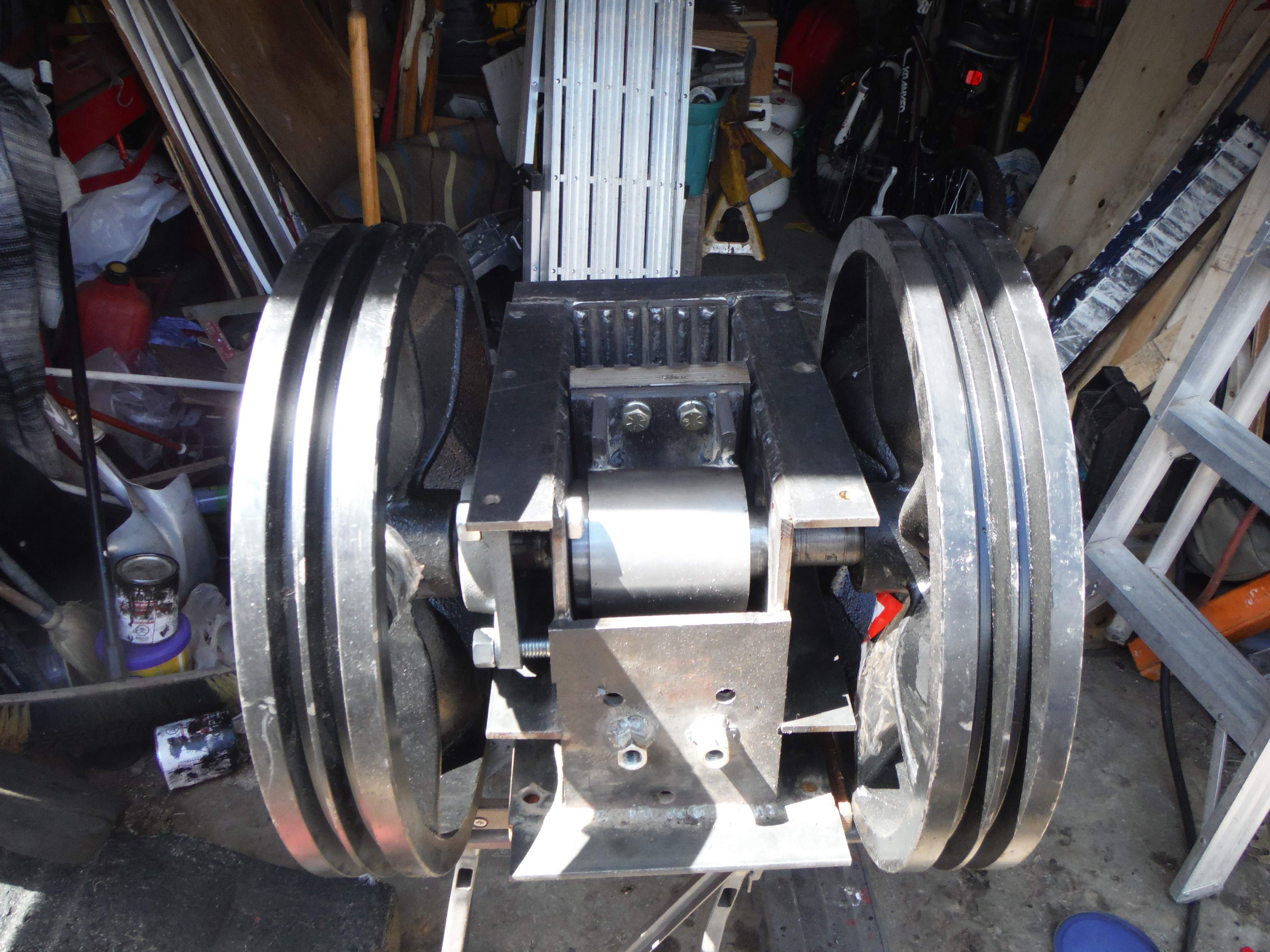

Spent another 10-12 hours on the crusher in the past week or so. Mocking things up to ensure it will come together. Last thing before building a support for the crusher and motor is to build a adjustment mechanism.
