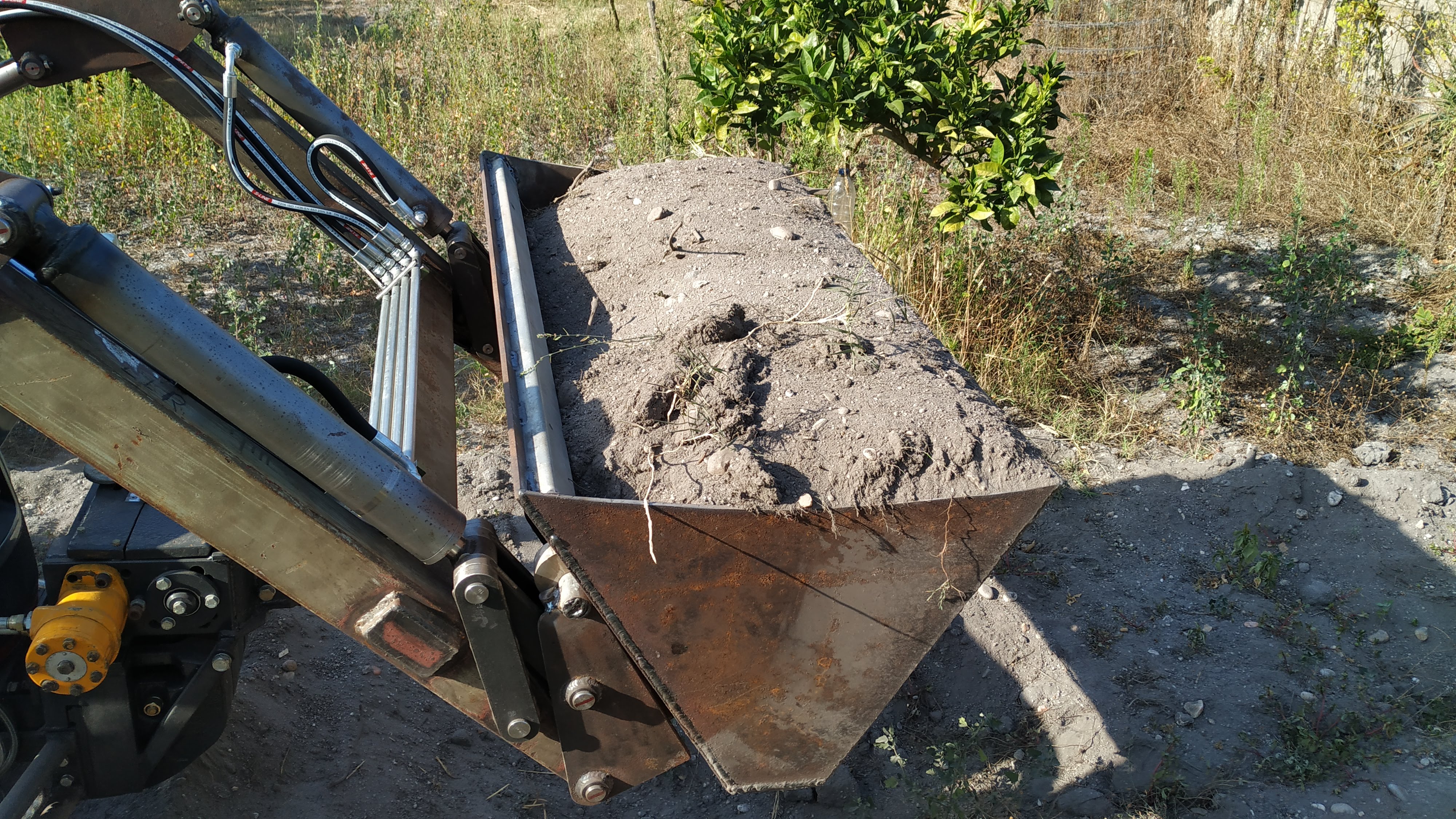

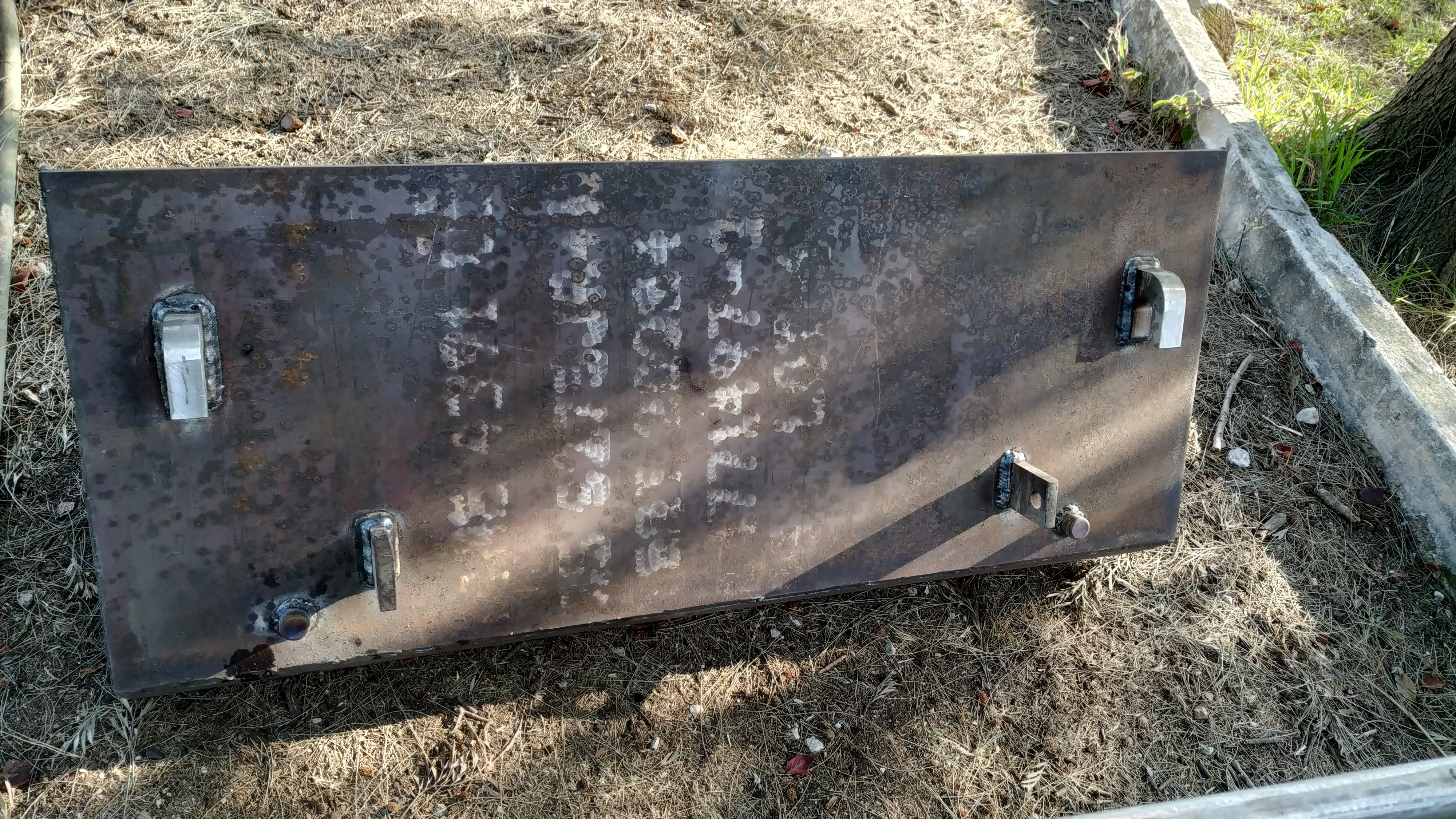

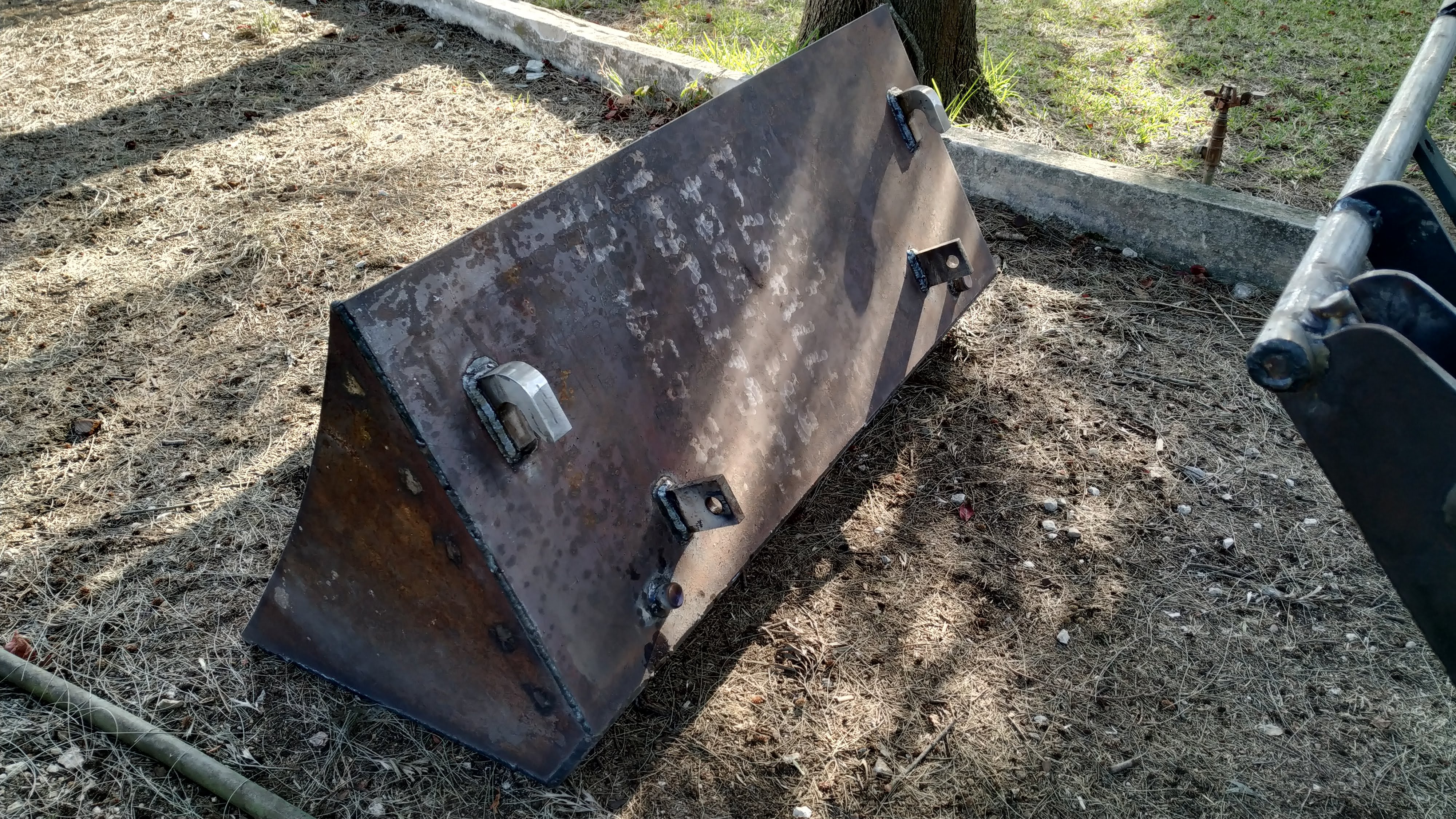

So the next thing to do was the bucket. I don't have that many pictures of the fabrication.
The sheet metal I used it's all 5/16" thick. A bit on the thick side but got it at a good price on the scrapyard.
I do need to add some sort of cutting edge and maybe a reinforcement web in the middle of the bucket.

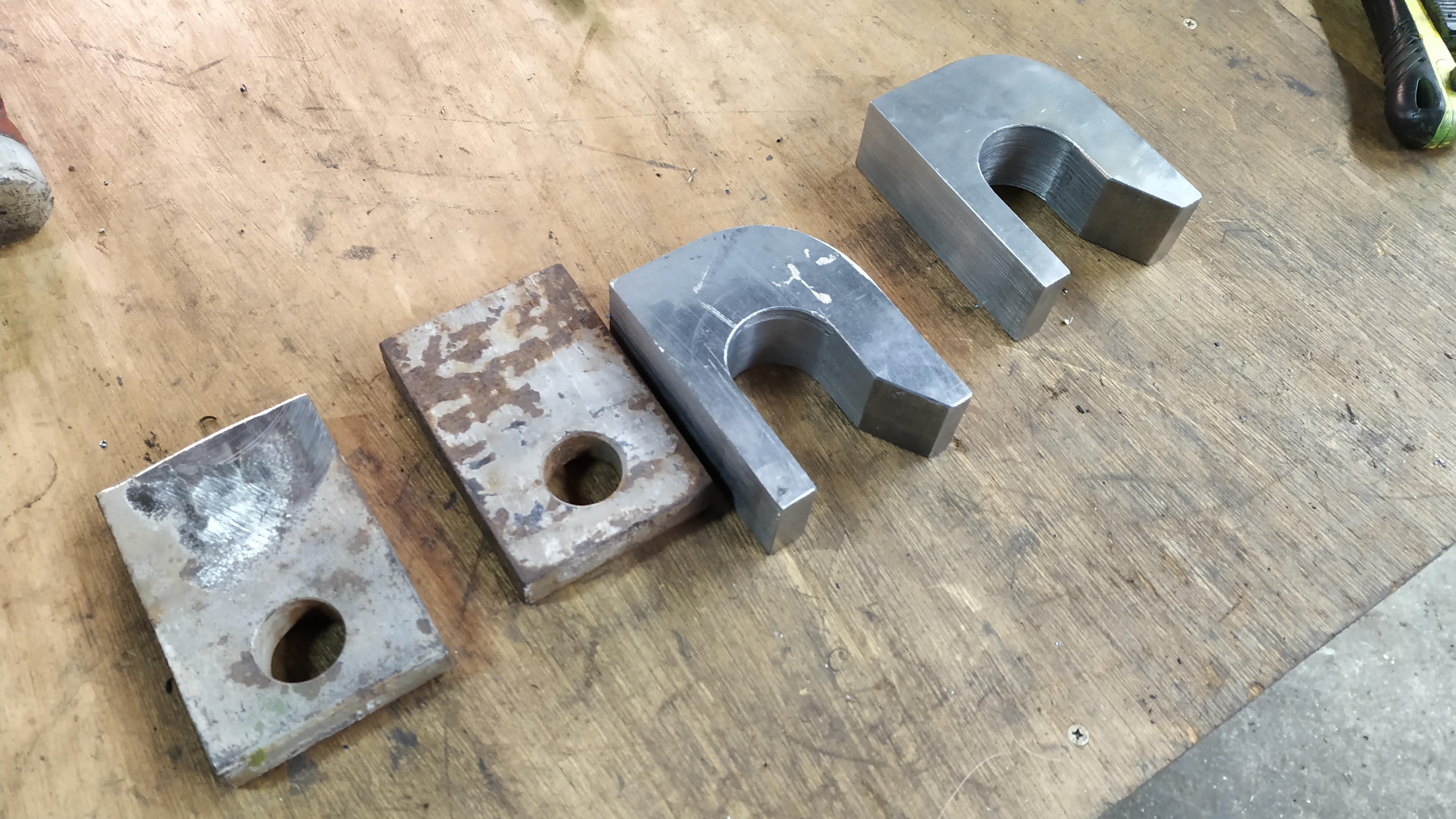

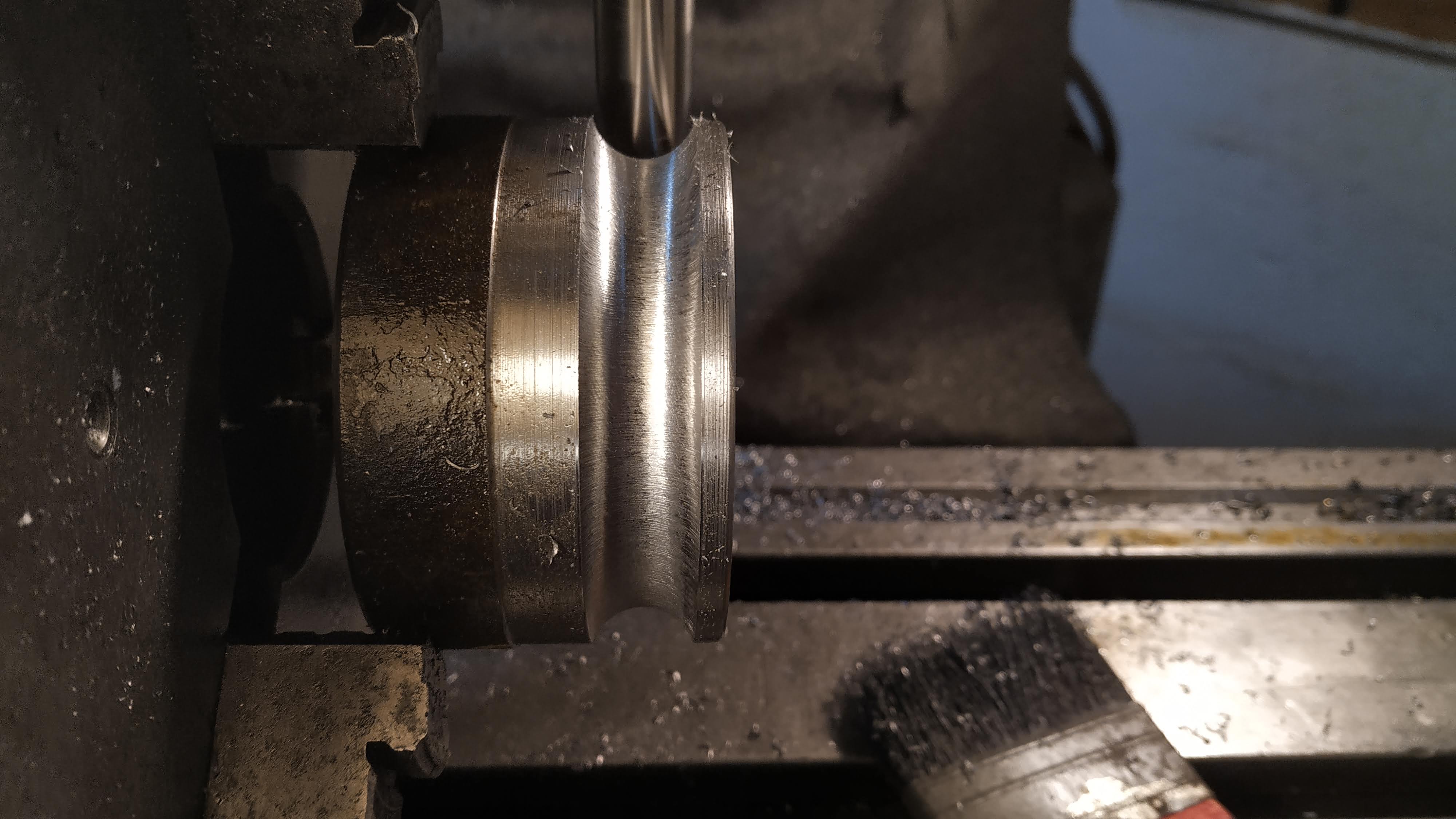

Then I bought the hydraulic tubing. I needed a way to bend the tubing, so I made a tube bender. Fun fact on this. The only part I actually had to make, was the die. Everything else was stuff of the shelf (My shelf :laughing:) just cobbled together. It's not pretty but works awesome.
To make the die, I used my homemade rotary table/indexing head on the mill, to create the necessary radius. As the part rotates, the end mill is cutting the radius.

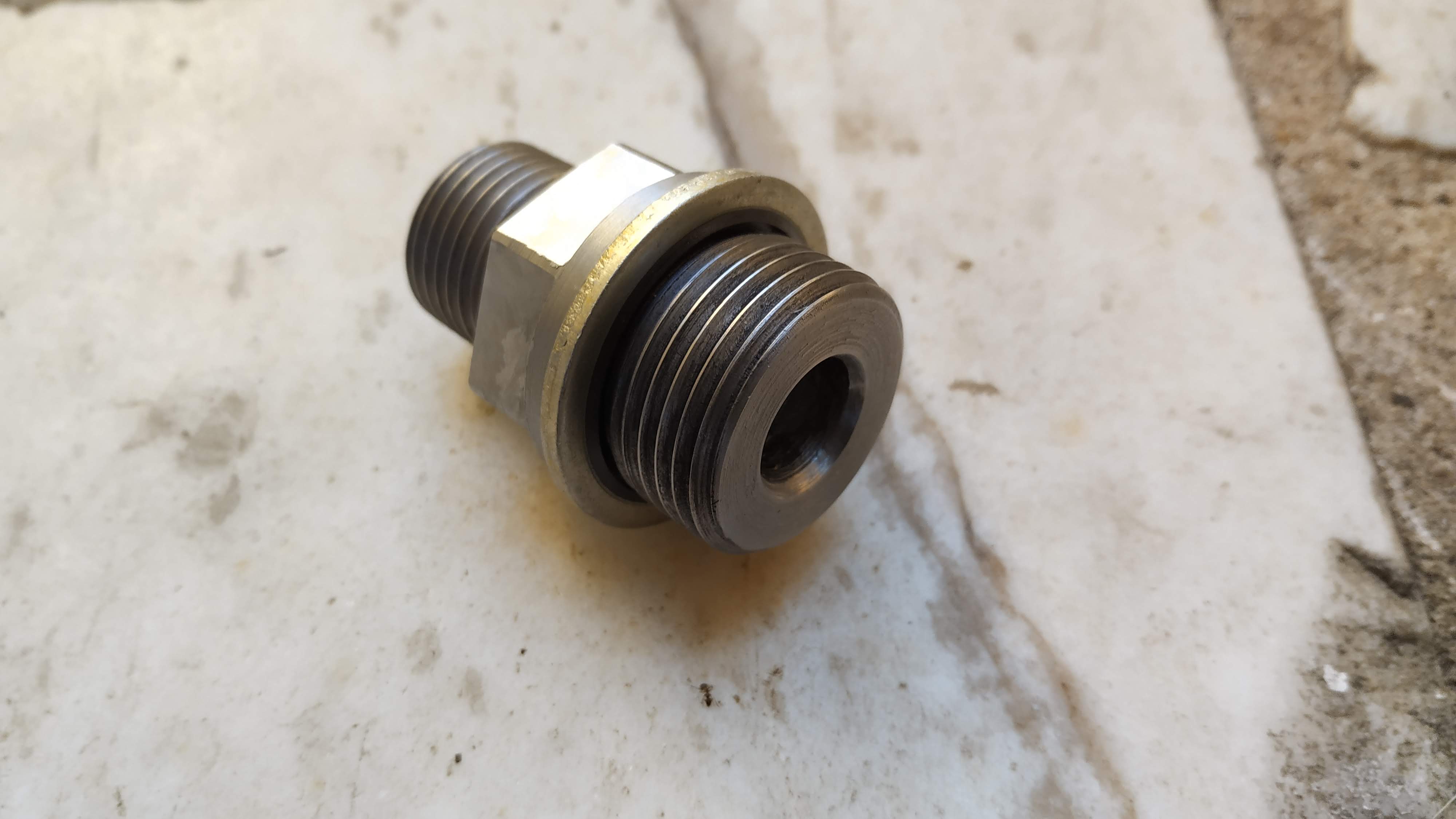

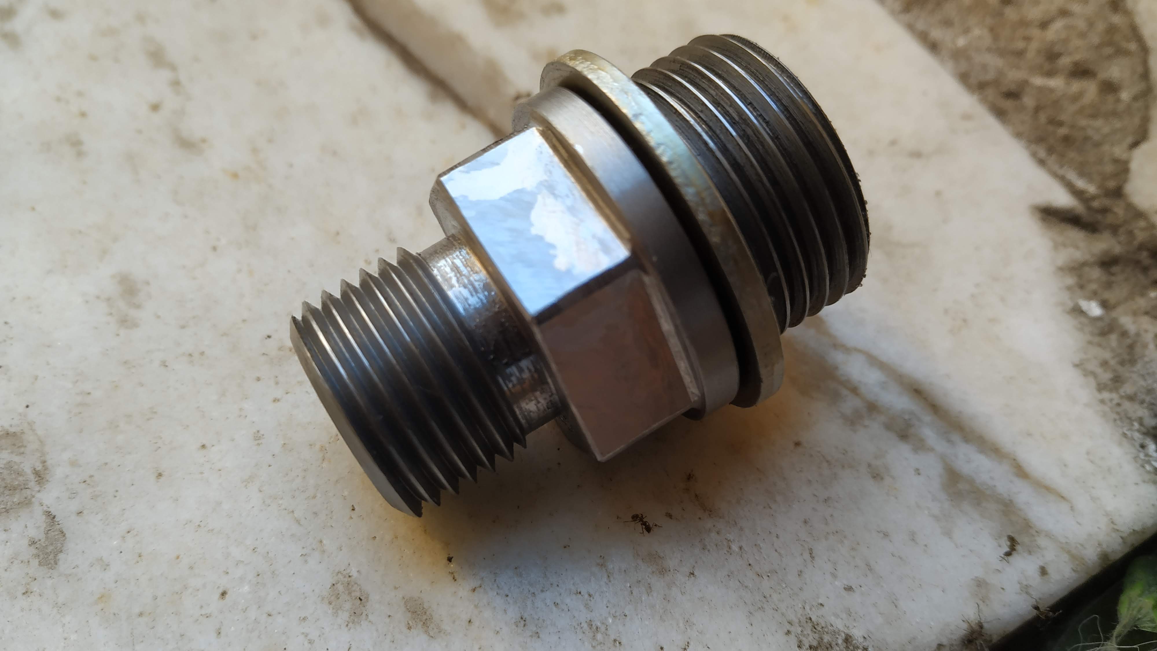

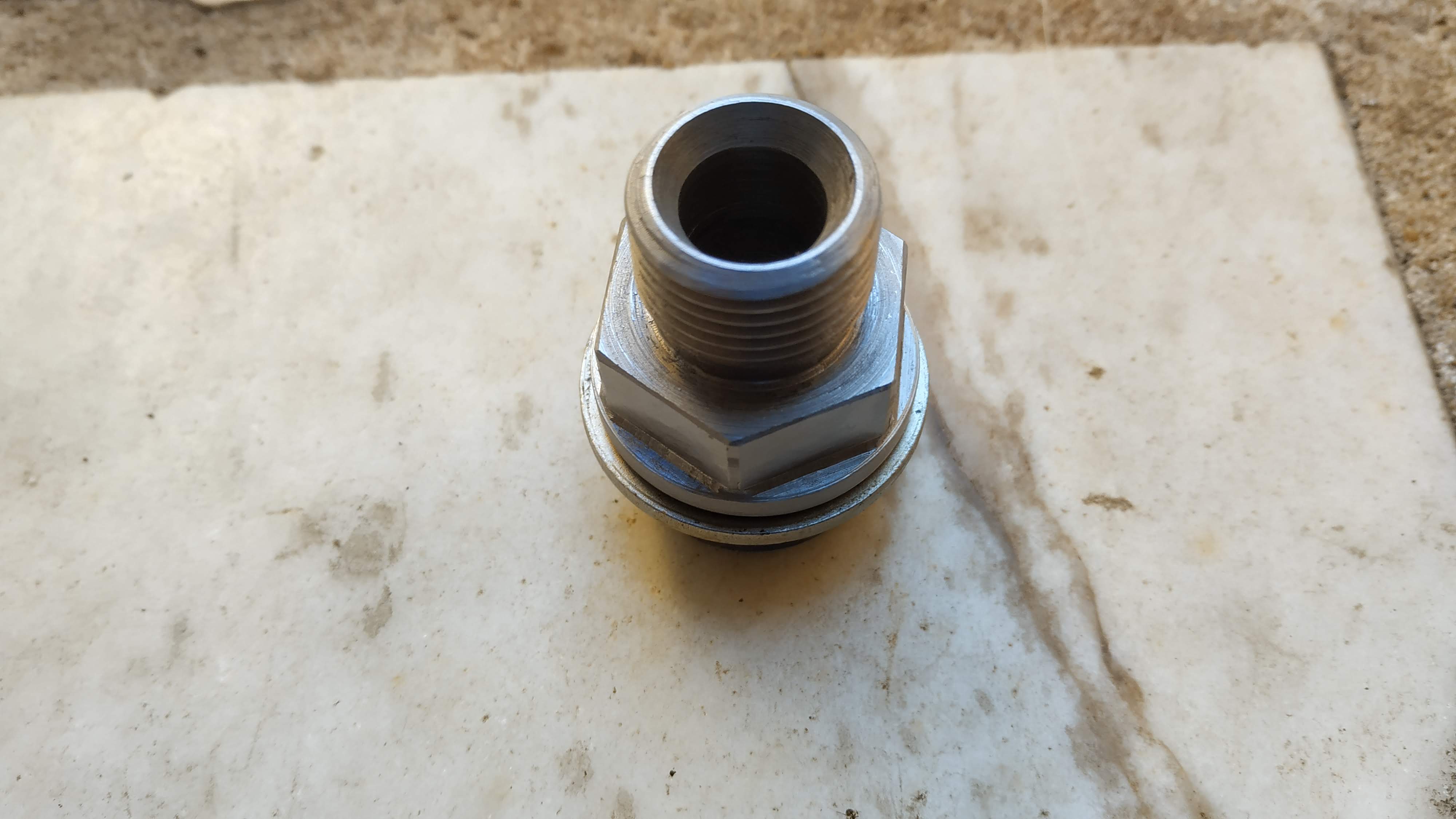

I also had to make a special/odd hydraulic fitting for my valve. It's an adapter from M27x2 to 1/2" BSP. I would have cost me close to 30$. So being cheap as I am, I just machined one. Took me 30 minutes.

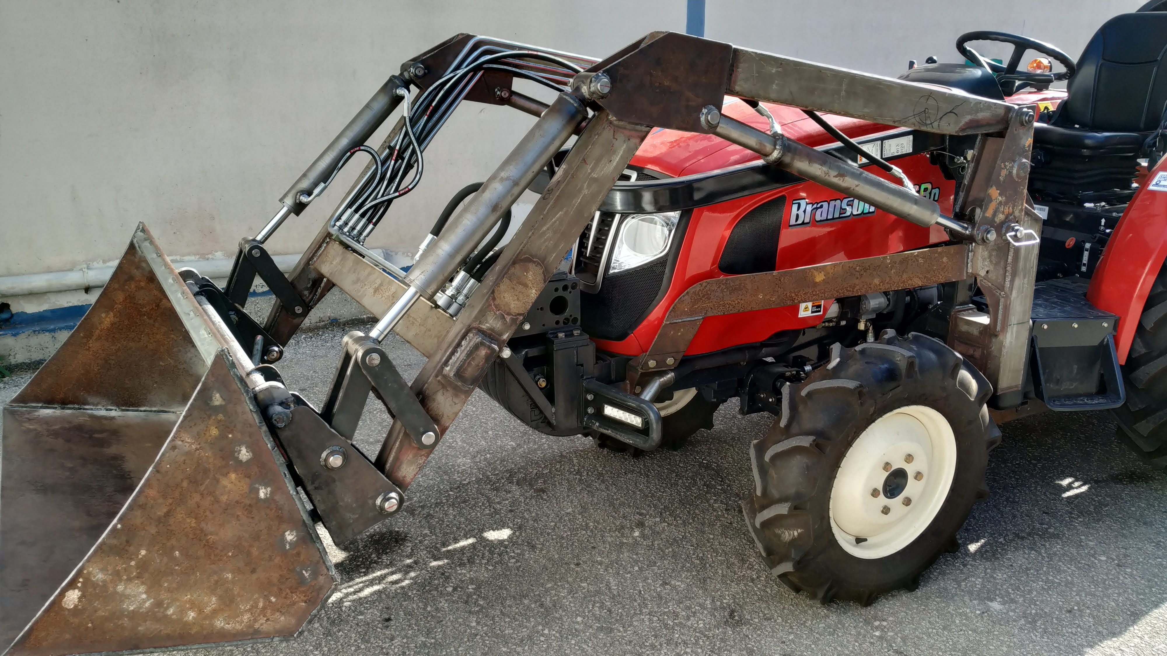

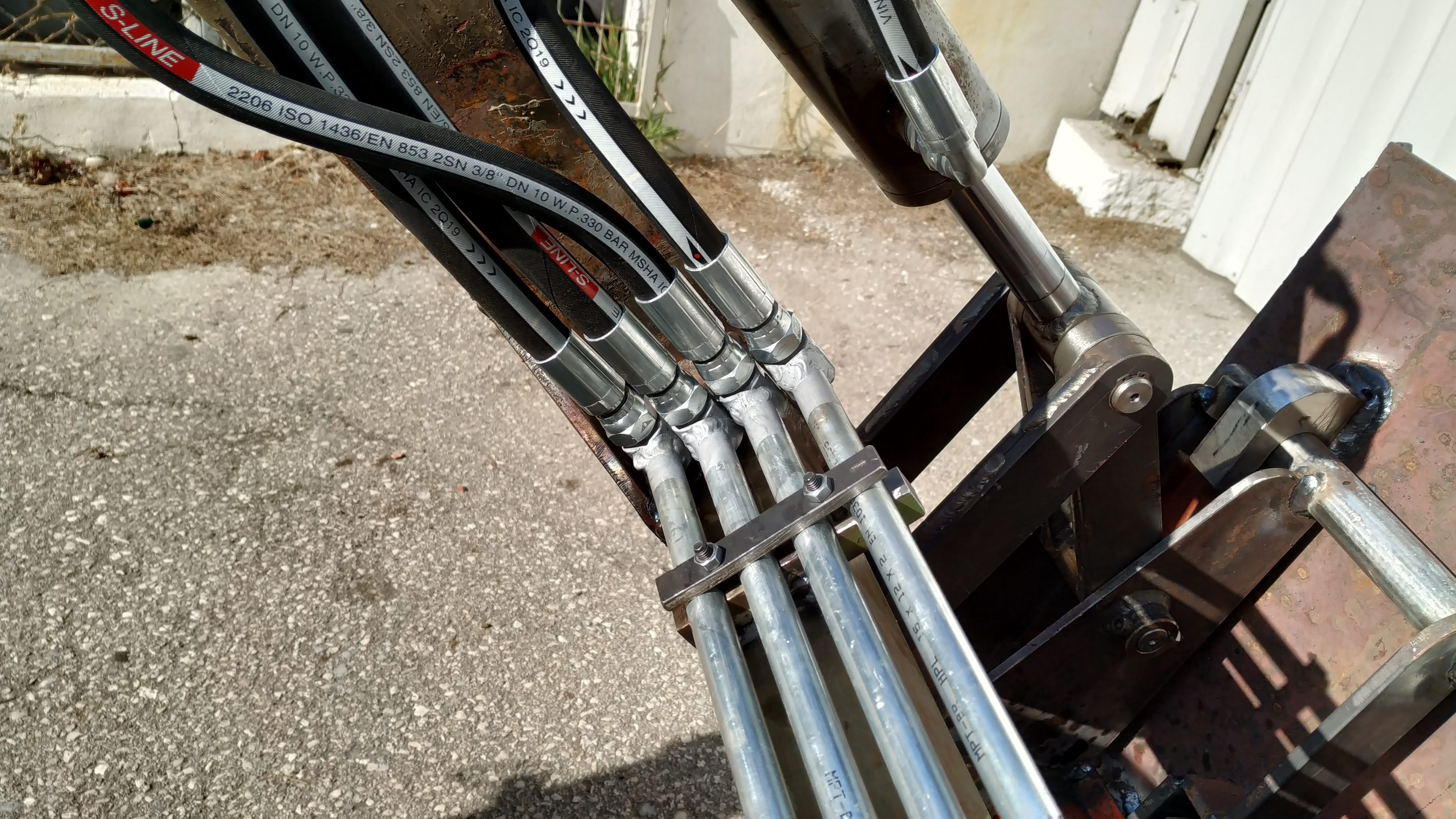

After I got the tube bender done, I could finally bend the hydraulic tubing. It worked very nice and had only one little mistake on the last bend which is not that big for a deal. A few days later, I also received my order of hoses, fittings and quick disconnects, so I could finally try the loader.
I machined and welded the fittings in place on the hydraulic tubes. I only have a stick welder and turned out that I only had 2 tiny and small leaks on the welded fittings.

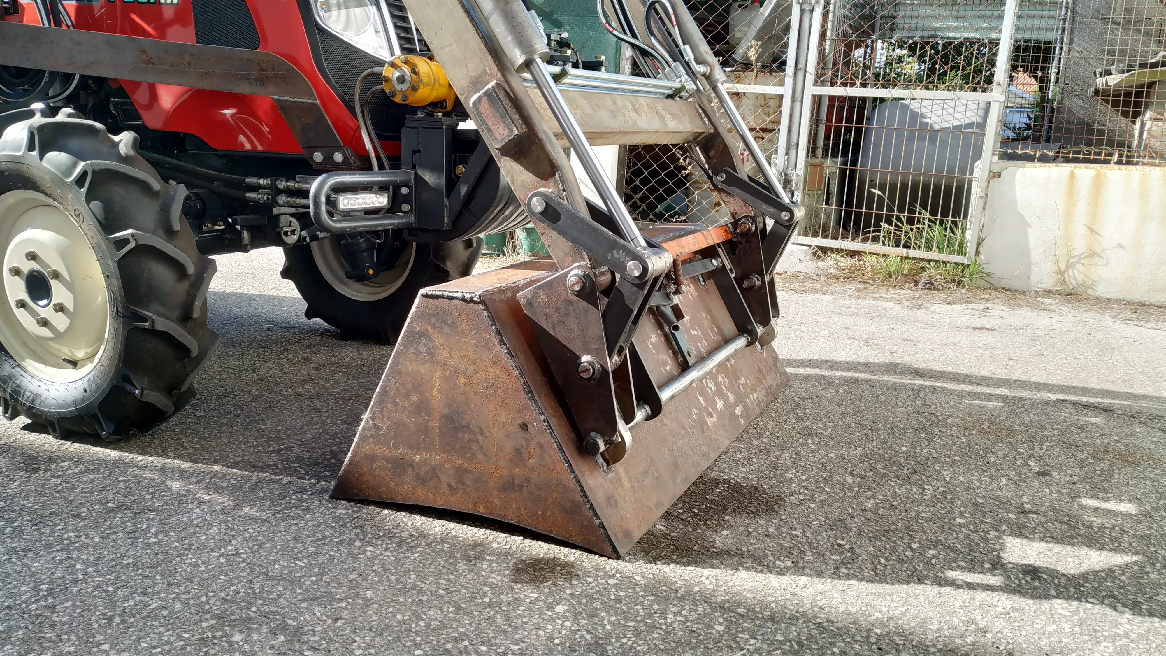

Some more pictures of the loader moving on it's own power.
IMG_20190920_174724.jpgIMG_20190917_170302.jpgIMG_20190917_165453.jpgIMG_20190917_164813.jpg
I did run a leak down test and got about 4 mm over 2 hours. Or about 5/32" over 2 hours in Freedom units. I think it's pretty nice for a first time making cylinders, although the leak down shown is most likely coming from the used valve I have. I believe it came of a Case 580 Backhoe, so who knows how many hours that thing have. But does come with some nice features like float, load check valves, port relief valves and anti-cavitation valves.
