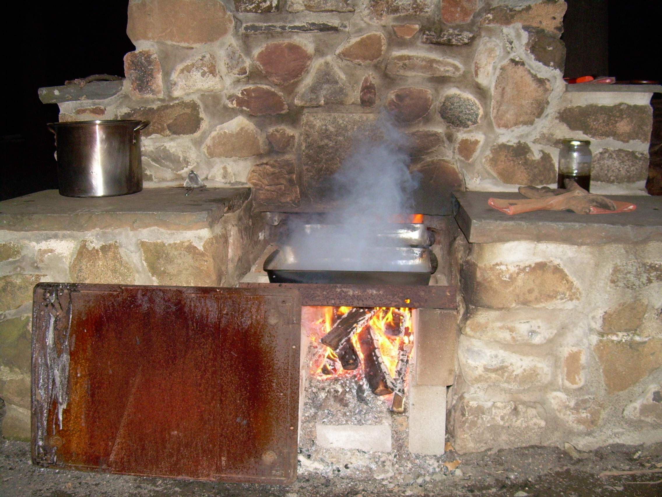

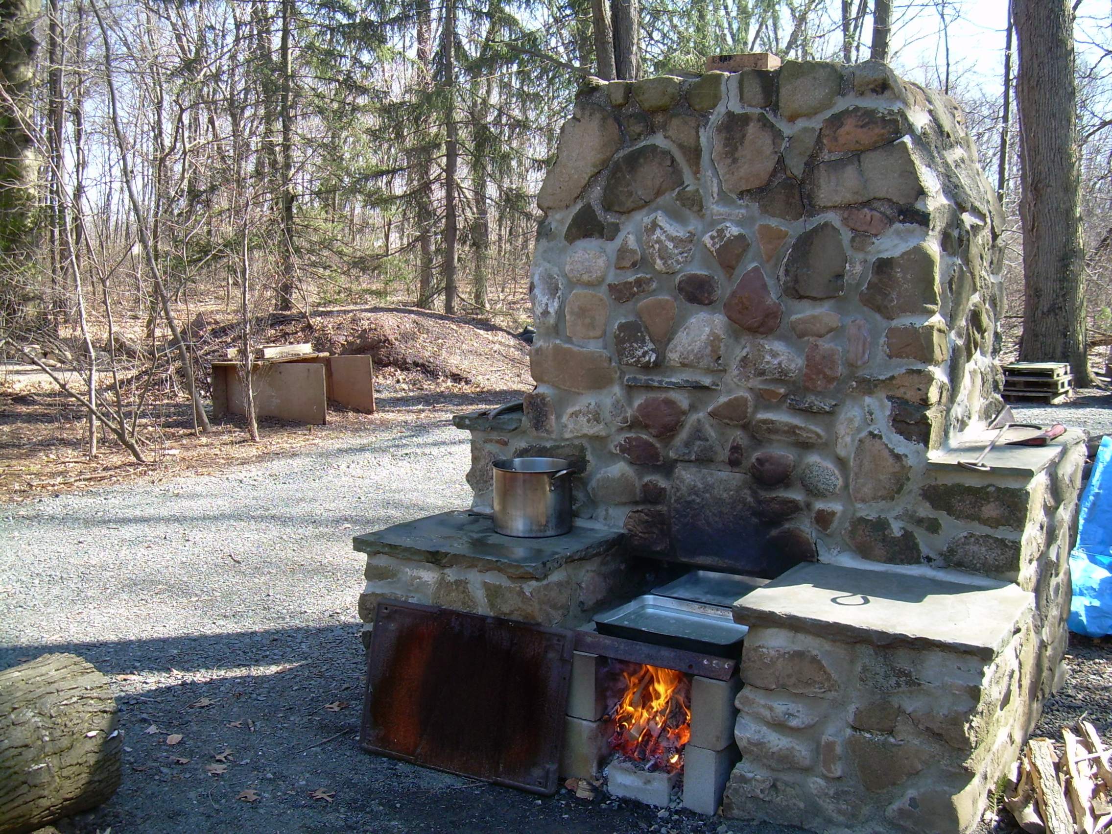

Almost ready to tap My one maple, last year did it for the first time and was filling 3 buckets a day of sap so at least this tree is a good producer.
Trouble is storing the sap all week before I can cook it in my little pan on the week end, Only made about 3 qts last year, hope to get a whole gallon, been saving the empty syrup containers all year in anticipation.
Those are some sweet:) looking home made pans here you guys are using, some one had a nice small one on craigslist for $350. but I couldn't justify it with my small production.
We do love Maple syrup :) Up to $50. a Gallon though:( !!!
JB.

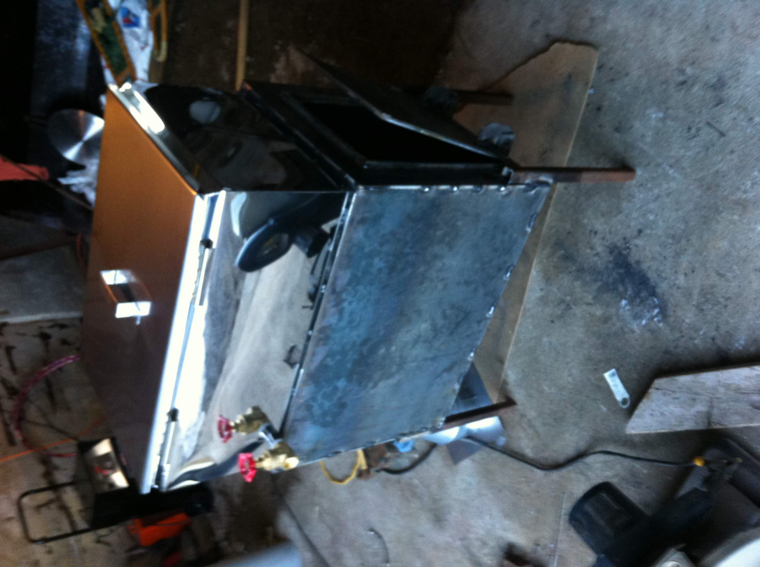

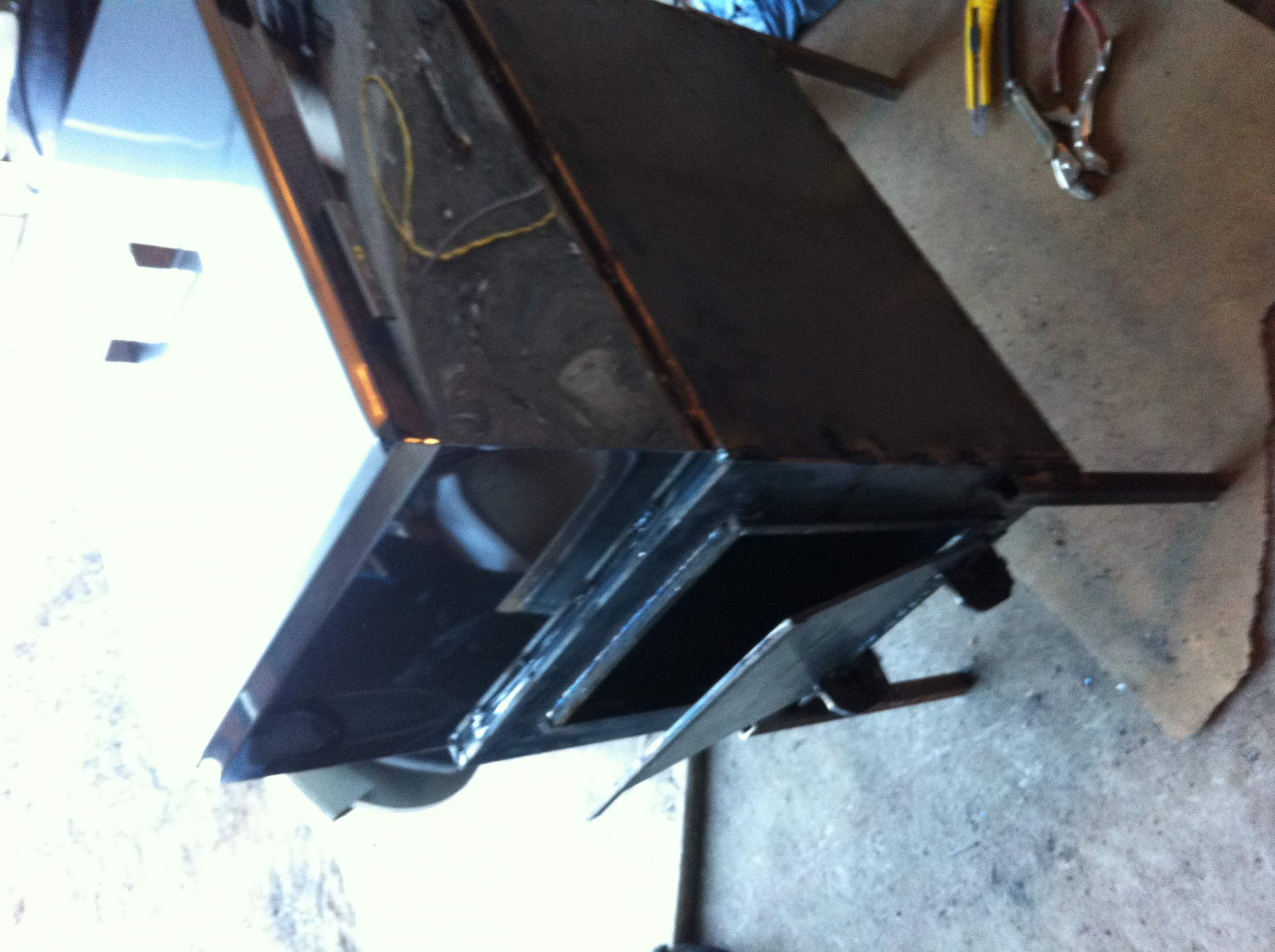

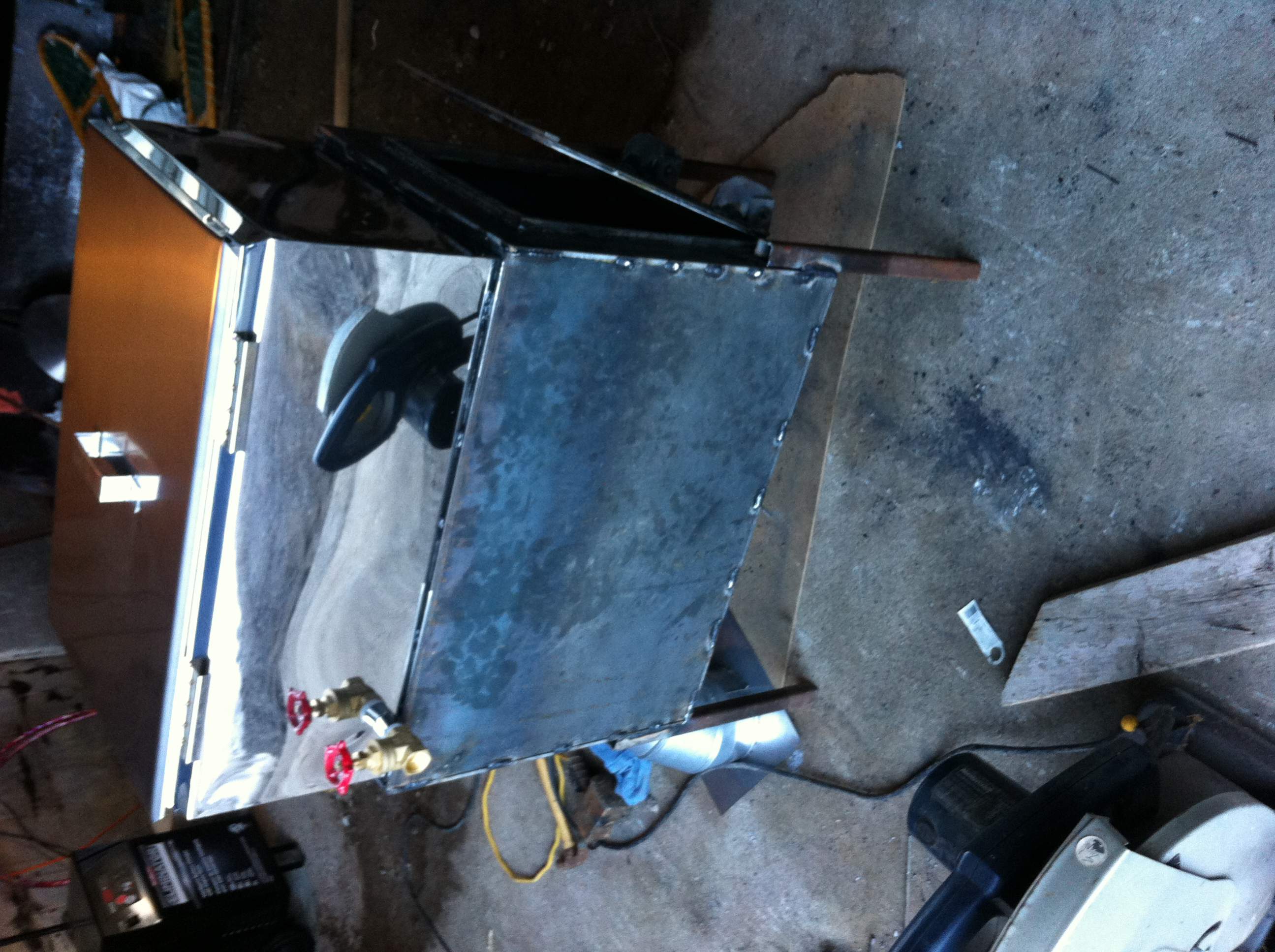

HI EVERY BODY, I STARTED BUILDING AN EVAPORATOR HERE ARE SOME PICS
BEST REGARDS FROM CANADA

That's looking nice, Yoseph.
