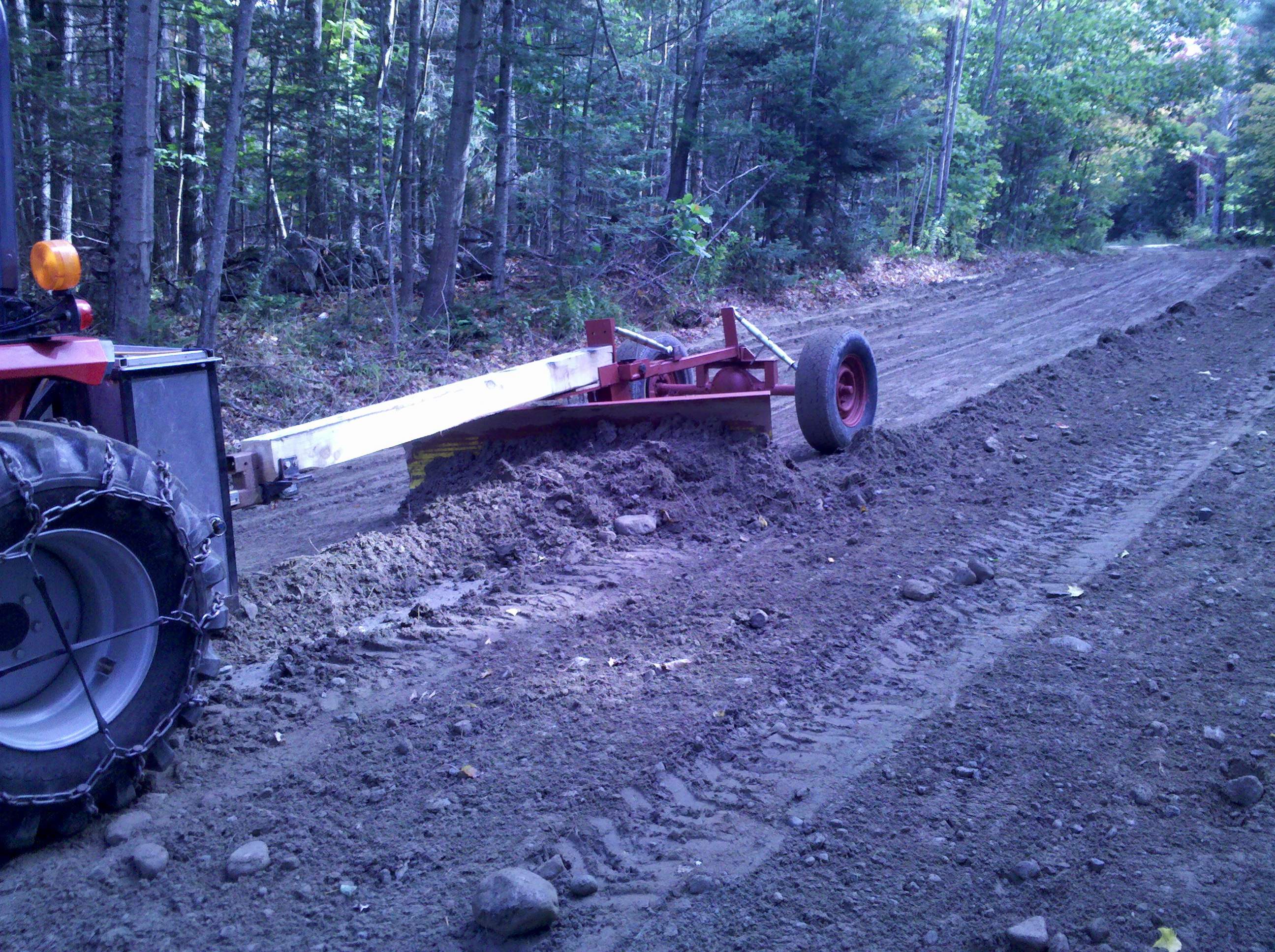

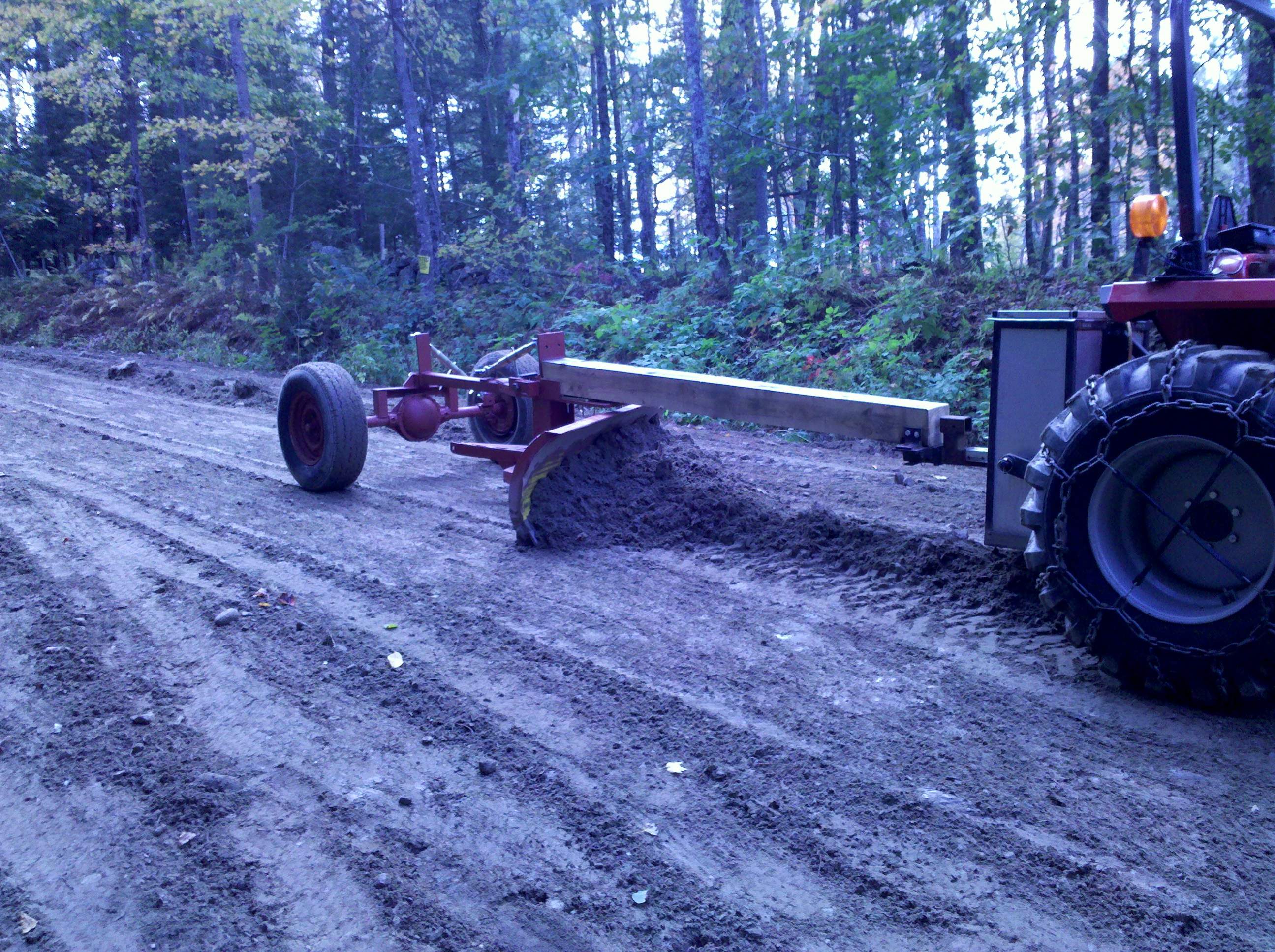

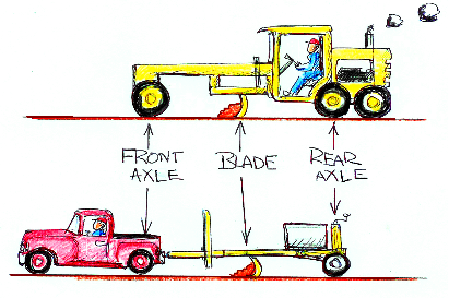

The closer the scraper wheels are to the blade, the less the blade moves when the tractor dips/rises. Generally, the tractor wheels are on the uneven ground, and the scraper wheels are on smooth ground. If the blade is 1/2 way back, it dips 1/2 of what the tractor dips. If the blade is 7/8 way back, it dips 1/8 of what the tractor dips.
Wheels way back for leveling:
images
Wheels close for smoothing:

I am pretty amazed that you can carry that much on the blade without sliding sideways, but apparently you've got more weight there than it looks.
Lookin good.
Smiley
The angle is only 30 degrees, so the lateral force would be roughly 50% of the traction the tractor delivers. If you move the same amount of soil sideways at 45 degrees, the side force would be equal to the tractor draft force, but because the dirt moves sideways faster, there is less dirt dragged along so the draft force is reduced.
If the blade has offset as well, you can offset the blade to the roadside when crowning: Then the offset wants to pull the blade to the middle of the road, where the blade angle wants to pull it to the side: this way you can pretty much balance the lateral forces.
