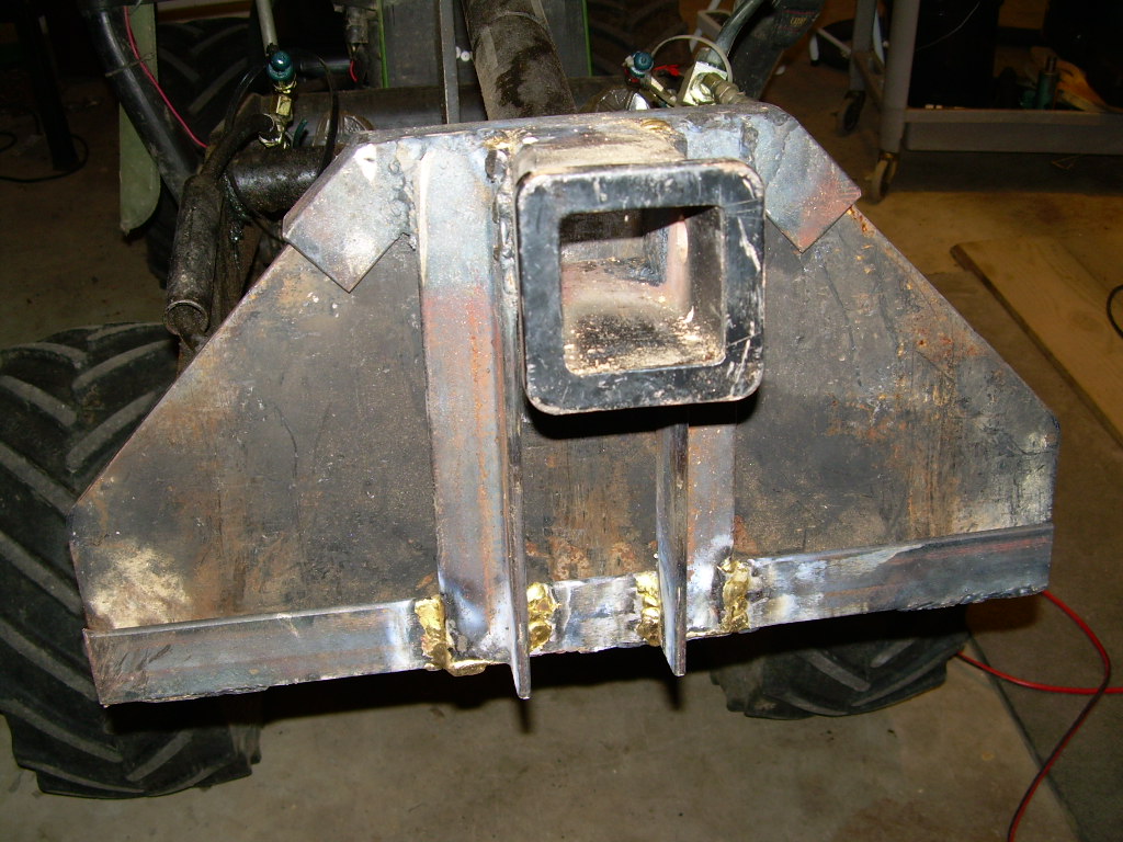

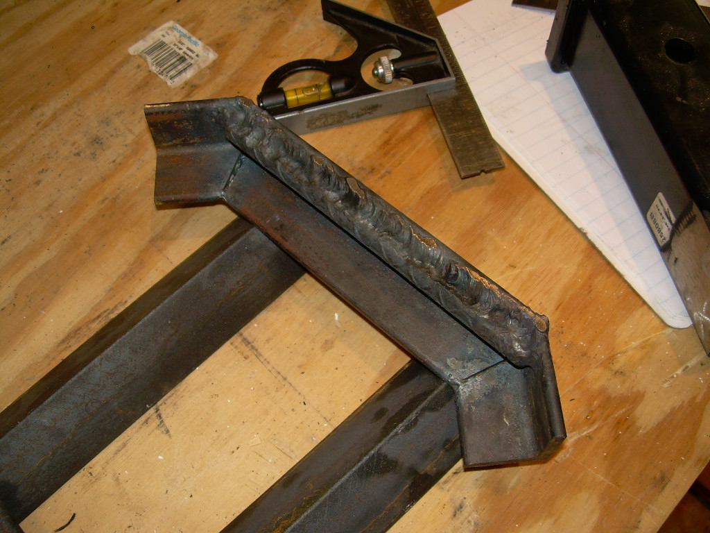

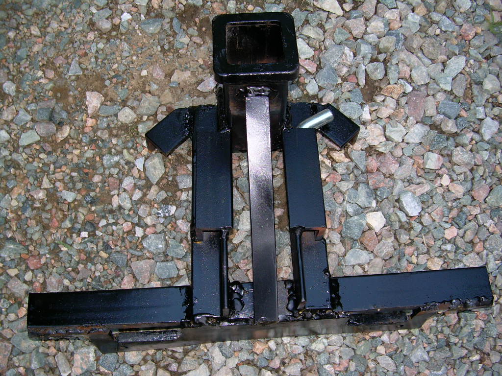

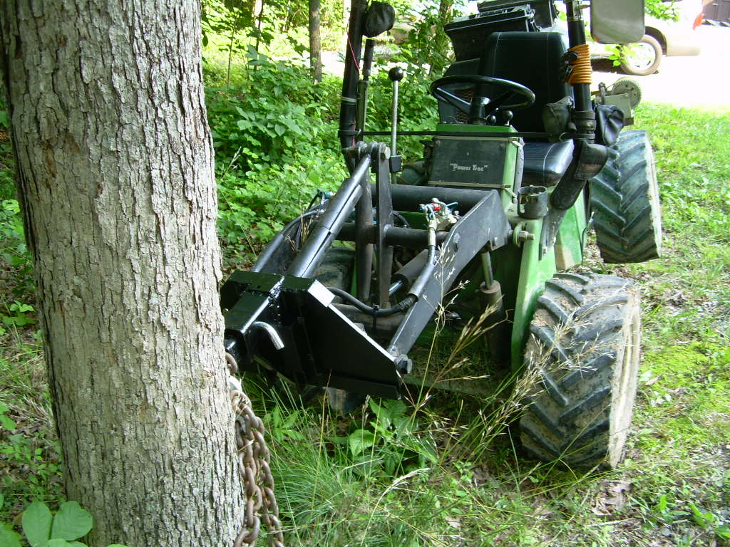

/ Homemade Quick Attach Plate #3
I made a few. Here is one with a 2 inch receiver on it. I consider this a medium duty version, but I have had no issues with it. I did use angle iron. I have posted this here before.
I have more pictures if you need them.
I used a piece of rebar as the front lip to go over the PT quick attach front plate.

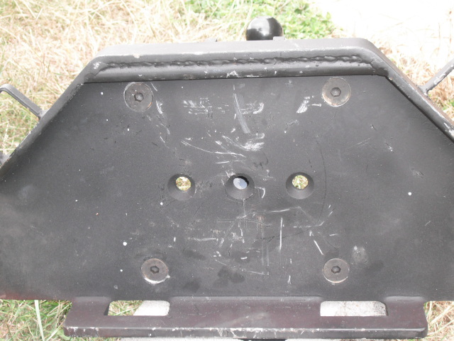

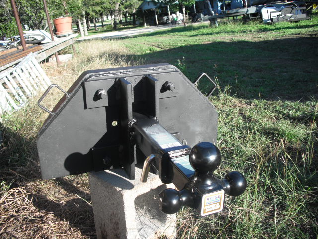

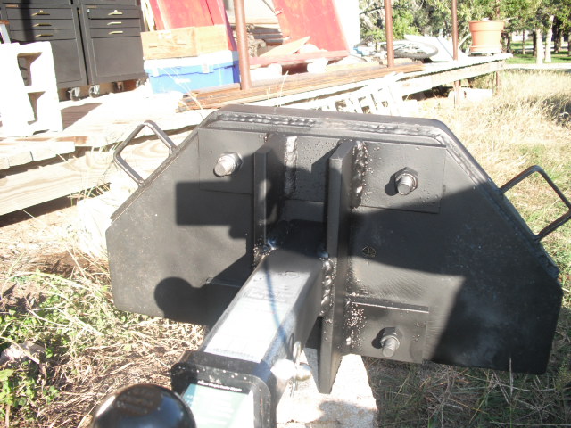

Well, I bought a new reciever & ball hitch, I had some 1/2"Flat bar and used that to fabricate the bolt on attachment.
Pklease see the pics attached (if I got it to work)
Flat black paint is the welders friend.
The four bolts come off easy and when I need to use the trencher, I'll swap the plate back.
Tim

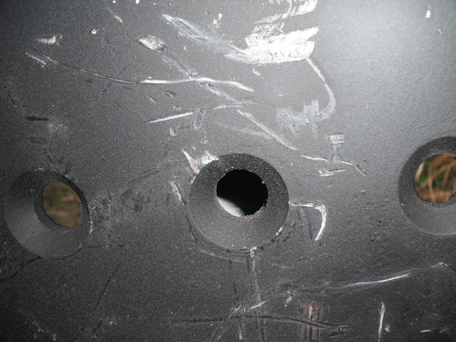

Not to get off track but, How are the bolts attached to the plate. welded, threaded or is their a recess in the back of the plate for the head of the bolts? I can see where a bolt up qa plate would be handy for someone with out a welder.
#9
Not off track at all,
The bolts are counter sunk flat head allen hex bolts that pass thru.
I took the plate off my trencher attachment. However I have a couple other attachments that bolt on as well, just not as easy to get to. From what I see, all the Quick Attach plates are drilled with a standard bolt hole pattern. These are new attachments (08-09), I can't say if older plates are so drilled.
Rgds,
tim

#12
Here are some pics of the quick attach plate
one shows the hole pattern
one shows the countersunk hole
one shows the bolt in the hole
Brgds
tim
