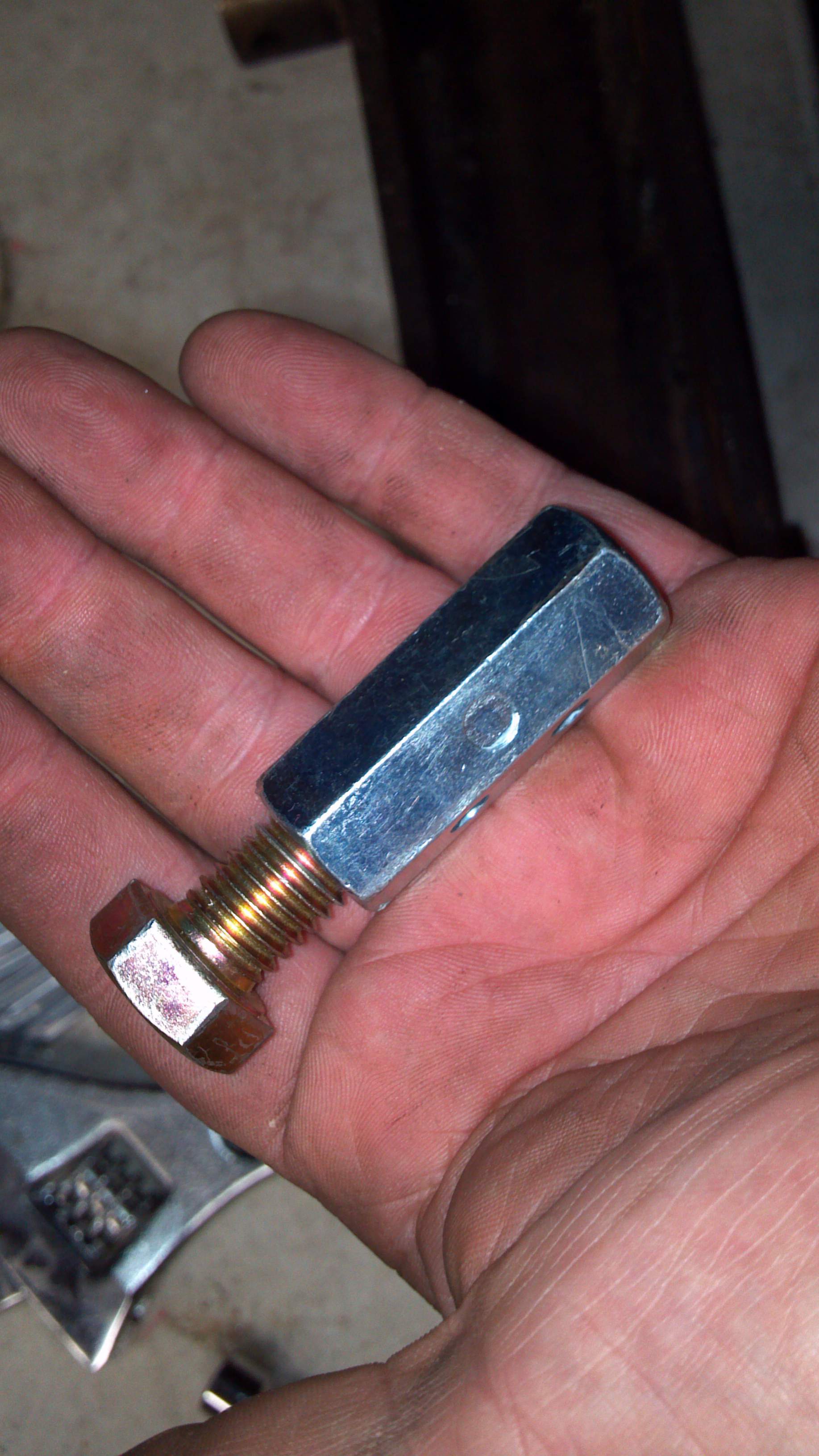

Well, folks, I have hit what, for me, is currently a showstopper. Here's the situation. I realized that, in order to get the bucket side of the adapter narrow enough to fit within the ears, I was going to have to put a plate across the front of the loader-side. If you look at the factory adapter, you'll see they just do a dog-leg bend to bring the bucket side in, but of course that's not an option for me. So I put a plate across the front, making the loader-side of the bracket into a U, and no matter how carefully I did it, the way the weld pulled on the joint when it cooled pulled the bushings out of alignment with each other. It's not very much out of alignment--if I get two big adjustable wrenches and pull hard, the pin just slips right through. But it's far enough that I don't consider it workable.
The way I see it, there are at least three approaches. 1) heat the joint with a torch and bend it. Problem: I don't have a torch. 2) Run a reamer through the bushings to open them up and put them back in alignment. Problem: I don't have a reamer and I'm concerned that the amount I would have to open them up to bring them back into alignment would make the pins too sloppy. 3) drive the pins in with a hammer and never take the QA adapter off the tractor again. Hmmm... tempting, but obviously unacceptable. I tried going hot and welding up the outside of the joint, to try to pull the pieces back into alignment, and it made a tiny bit of difference, but not enough.
Any thoughts? I wish I could just get a great long lever and bend the thing, but it's got enough flex that it always pops back the way it was. At the moment, I'm at a dead stop until I solve this.

I had the same issues. I had a torch though and was able to bend what i needed back into position, hence why I said way back when using a press brake would be the ideal way to do this as the heat distorts everything it seems. It took a little adjusting to get it where I wanted it.
   / Homemade quick attach #156
So right now you have just the U for the tractor side without the bucket pieces? Set it with the ears of the U down on something very solid and hit it with a BFH in the center of the U and you'd be surprised how much you will be able to bend it out. Ideally use the round of a ball-peen hammer. Hit solid and hard and check after every couple swings for pin fitment. Once you get them to fit, don't do any further welding without pins installed and only weld a bit at a time.
Is the binding just between the pin and the 2 sides of the U or does it bind on the loader/cyl mount also? If it only binds on the QA adapter, it's really not that big of a deal, you'll likely never take is back off again anyway.

If the two top ends of the 'U' are too close... try to drive something just slightly wider in between and then lay the bracket on its side, on something solid (I have a short piece of railroad rail just for this purpose) and hit it hard with a BFH all the way along the welds. You'll be surprised how much it will open up.
If the tops of the 'U' are too far apart, squeeze with a c-clamp and pound with the BFH as described above.
You could also go back to the machine shop... they likely have a hydraulic press that could 'massage' it slightly.

Per your suggestions, I rigged up a spreader by buying one of the couplers they make for all-thread and mating it with a bolt. I bought a grade 8 bolt because I wasn't sure how much pressure the threads would be under, and since I was just buying one, the price difference was negligible.
I applied pressure to the side-plates until the pin slid in as smoothly as possible, then I turned the bolt another half-turn or so until the pin bound. I figured taking it slightly past the desired point would be helpful. One of the pins had to be expanded, and the other had to be compressed (I used a C-clamp). Then I beat on it with a 4-lb mallet. Shortly thereafter, the bushings were as aligned as they were going to be.
In retrospect, this could all have been avoided if I had drilled the holes, then built the adapter, then aligned and welded in the bushings. However, this would have prevented me from welding up the back side of the bushings, which is one reason I did it the way I did. I'm not sure which would be more desirable: easily aligning the bushings or having full-pen welds. Because the bushing holes were drilled oversized, not welding up the back side would leave an ugly gap. Only I would know it was there, but I'd know.
