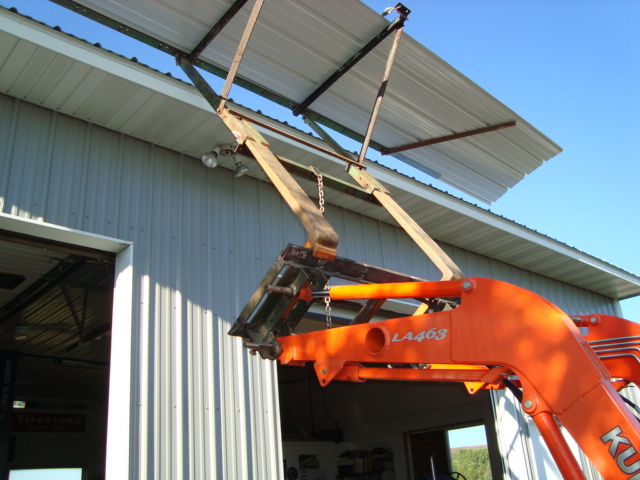

I am thinking of building one of these for my tractor. Can anybody help me understand the need for the cross-bar between the two pieces? Obviously, it adds rigidity, but I'm not sure why it's necessary, given that the two pieces will be attached to the bucket, which should provide all the rigidity that is needed--no? And, of course, when the bucket is off, there is no stress at all on the QA pieces.
/ Homemade quick attach #64
Joshua, I think it is to prevent twisting..as in torque tube. They do twist sometimes anyway, but I believe that is the purpose, to help keep them in alignment.
You need something to straddle both connection points because the hydraulics wont be synchronized, the hyd. pressure doesnt care where it goes it takes the easiest path it wants to. The arm with the least resistance will move and the other will stay staitionary untill you hit it up against the bucket or something solid, then the other will move, defeats the purpose all together of doing something like this. You dont need much of a piece of metal in there to do this, its not a real supporting member in the build, I just used 1 1/4 square tube because it just looks better. As you said once the bucket is hooked up it does the same thing and takes the strain. All the piece does is keep the two curl cylinder at the same extention untill the bucket is hooked, after that its pretty much just there, but you really need it before you hook the bucket unless you're arms curl and dump evenly which I doubt they will at all times.
Think of hydraulic brakes, if you blow a brake line in the front left, the front right isnt going to apply, thank god they split the hydraulic systems so at least the rear brakes were to work in this situation.
/ Homemade quick attach #66
The torqe tube keeps the cylinders syncronized when the bucket is detached.
Without the torge tube in place, the cylinders will be uneven when trying to re-attach the next implement. Making hookup very difficult
/ Homemade quick attach #67
Got it. I understand the reason for the cross-bar now. So, really, pretty much any tubing should be okay--it doesn't have to be particularly strong? Just strong enough to equalize the pressure in the hydraulic system. 1/8" thick by 1" or something?
As I'm thinking about a shopping list for the scrap yard, here's what I've got so far:
1/4" thick by... I don't know... 2" wide flat stock, 8 pieces approx. 12" long each for the side-plates (four for the loader, four for the bucket), plus maybe another 24" at most for the walls of the upper "U" section, so maybe 10' total length.
DOM tubing, 1" ID (or whatever closely matches the pins on the loader), maybe 6" each, x4 on the loader and 4 on the bucket, so total length 48". I see that Steve used 3/8" thickness pipe. Should I then use 3/8" thickness flat stock for the walls of the upper U section on the loader bracket? Is 3/8" a recommended size, or is that just what Steve had laying around? In short, what thickness DOM tubing to use, and should the flat stock on the walls of the upper U section match that thickness?
Ultimately, I will need to get either pins or grade 8 bolts for the bucket, but I'm okay with putting that off for now.
Is that it? Just some flat stock and DOM tubing? Seems like I must be forgetting something. Oh right--the cross-tube. So, maybe 1/8" thick by 1" or 2" diameter square or round tube?

Just about all the cross bar does is that, once the bucket is hooked up it becomes the structural piece. A hefty piece isnt necessary. 1/8 x 1" flatstock might be a little flimsy because the distance between loader arms is pretty substantial. I'd go with round tubing or square.
The metal I used was 1/4 flat plate ( had a large plate sitting around, probably 4 sqft)
3' of DOM tubing (ID size the matched my pins, great fit BTW. 1/4 wall thickness PLENTY heavy!) Have like 12" left of this stuff for future use.
The cross tube was 1 1/2? square tubing.
That was about it..
To make the hook shape I did what steve suggested and cut a piece of DOM tubing in half and that made my two cradle pieces, one for each side. I tacked that in place and then just made custom filler pieces that matched the wall thickness of DOM tubing, which happened to be 1/4" which the whole project is made from. I welded it all up and ground it down to make it nice and smooth and easy to catch the bucket pins. I ended up beveling the edges of the hole for the hook shape to guide the pin down into the DOM cradle piece. I found the DOM is held to pretty good standards and my pins fit great as long as all the edges you cut are chamfered after. If you dont chamfer them, the pin isnt going in! Grade 8 bolts that size sound expensive. I used cat 3 3-point top link pins for my upper pins (1.25 inch diameter) and the lower ones I just found in the store.
Btw- I did this project because:
A) converting my tractor to a SSQA was quite pricey (800$ for the QA adaptor and then 100$ per plate, I'd have 1000$ in making it a quick attach)
B) I'd have to convert 2 buckets over to the quick attach plate, again more time for me to cut up my new bucket and older one.
C) Im only adding pallet forks as my last attachment so the whole SSQA thing didnt make sense to me after this point. SSQA isnt saving me money in the end.
If you can get yours setup for the SSQA relatively cheap then that would definatly be the way to go, it just wasnt in the cards for me, so this project will suffice for sure. Takes me about 45-50 seconds to drop a bucket, not really any slower than an SSQA, just dont have the attachment options.

Joshuabardwell,
I used 1/4 by 2-1/2 flat bar and that gave me about a 3/8" or so over lap for a good weld area, I think 2" would be too narrow. I bought a section of heavy wall pipe (I think about 3/8 thick) for the lower pin pivots. I would have used 1/4" if the machine shop that I got from would have had it in stock. Called DOM??? Normal pipe wont work as its measured OD, not ID, which is what you need to match your pin size.For the upper pin locations, I took one piece of the DOM, cut it to length and then cut it down the middle so that I had two "U" shaped pieces. These were then used as the bottom part of the 2 upper "Cradels" so to speak. I wish that I had taken more pix durring the build, but didnt. Does this help any?
Steve

Also when you weld do it in short areas, dont concentrate too much heat into that 1/4 as mine warped 7 ways to ****. Luckily it wasnt that bad and I got it back into shape.
That helps a lot, Steve. I will try to source 1/4" thick tubing. Your idea of cutting the tubing in half to make the cradles is a real lifesaver for me on this project, as I don't have a brake or anything like that to bend flat stock.

Regarding the torque tube: I agree with what has been said for the pupose of it. It is to keep the bucket cylinders tied together, moving in unison when no bucket is attached. But there are stresses applied to it when it is attached and needs to be able to withstand the stress and/or spring back into place.
Example: Without a QA (normal pin on bucket) you go into a dirt pile and unknowingly hook right front corner of bucket under a heavy rock or tree root. Try to curl the bucket. The right side will stall first while the left cylinder still moves some applying some twist to the bucket. The bucket is built to flex some and spring back into shape when this happens. Now picture a tube tying the cylinders together, the same twist pressure is being applied so the torque tube either has to be strong enough to stop the twist or be able to spring back to oringinal shape.

I could see how it happened. Say, for instance, you attach a bucket, but one of the QA sides doesn't latch securely. Then you go pick up a load in the bucket. The loose QA side releases, so only one cylinder is holding the load. The uneven loading twists the torque "ell" as the still attached side moves with the force of the cylinder. That's why I will go with a torque "tube" (closed section) of sufficient cross section, rather than an "ell" (open section), when I build mine. It's the polar moment of inertia of the torque member that's either you friend or enemy in this situation.
My real reason for wanting a QA bucket with a torque tube is that the first time I unpinned my pin-on bucket, I made the mistake of bumping the FEL joystick. This caused the cylinder with the least internal resistance to move, while the other one stayed put. Later, trying to pin the bucket back on, I couldn't align the holes on the FEL with the holes on the bucket. Took a lot of time and profane language to get those pins back in.

I guess I'm a little unclear now on just how strong and/or flexible the torque tube needs to be. If all it was going to do was keep the loader arms aligned when the bucket was off, then it would only need to be strong enough to equalize the pressure in the hydraulic system. But if it's going to have to flex while the bucket is working, that will probably involve more force. Also, I'm not really sure whether it should be something very stiff, or more springy, to flex and return to true. I know that one poster here used some 1" solid square stock, but I got the impression that was just what he had laying around, not that it is specifically recommended. What do y'all think I should use?
/ Homemade quick attach #76
Let me put it this way, there's not much that's going to stand up to a twisting motion driven by 2500 psi of hydraulic pressure applied to a 2" cylinder over a span of 40+ inches. So since it doesn't have to be super-strong, build it out of something reasonable, say 1.5 or 2 inch round or square tube with a minimum 1/8 wall thickness and you should be fine. The bucket or whatever implement you have will take all the stress anyway, and it's really only there to ensure the individual ends stay in sync when the implement is removed. Material that has some spring to it would be ideal, but mild steel will be fine too.
I'd use 2 inch square tube with 1/4 wall, but I tend to overbuild things.
If I remember correctly, when I removed my pin on bucket I could manually push in one curl cylinder and watch the other extend, so there's not a lot of opposing force there anyway.
