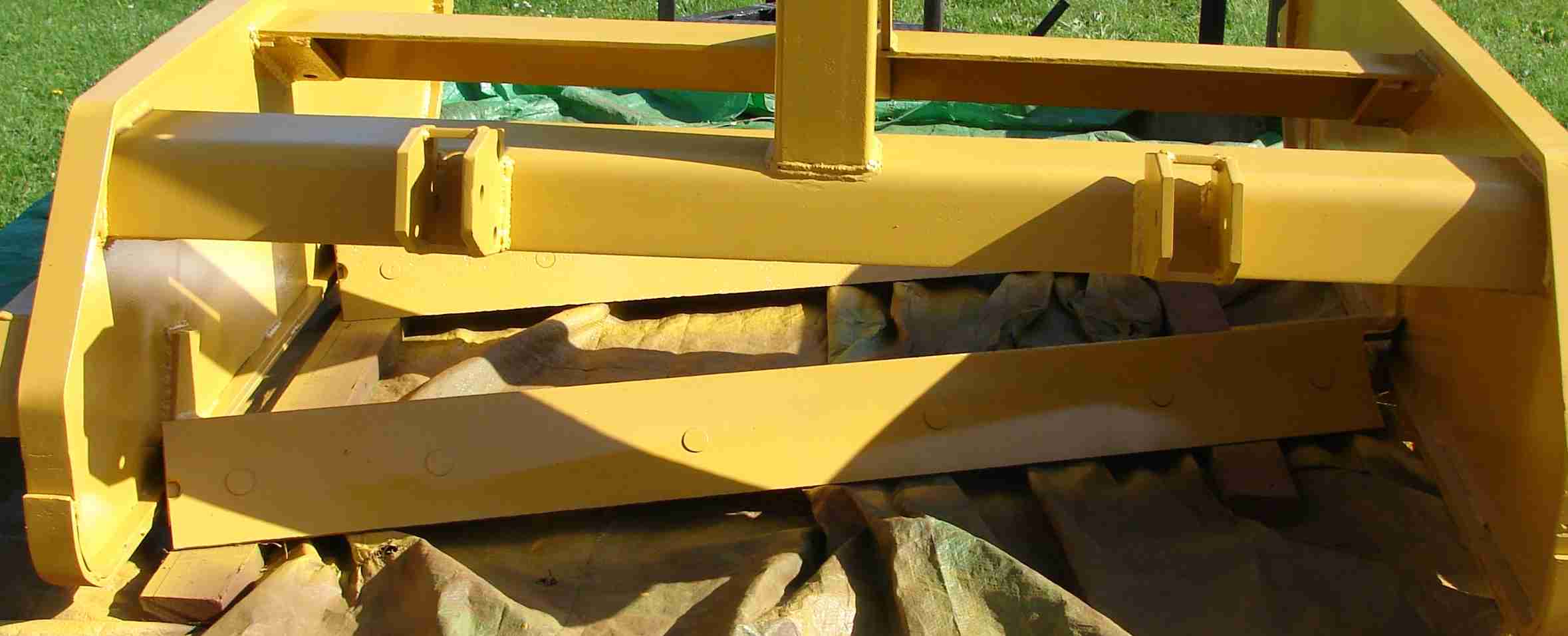

Yup. I like going to the recycling yard just to pick through the scrap pile. I got my two blades for the road grader from two bent up grader blades at the recycling yard. One was like brand new just bent like a pretzel. So that kept build costs way down.

Oops! I wasn't very clear. I didn't straighten it I used it for parts. When I was looking for the blades for the road grader the yard had two. One old rusty one bent up with all sorts of crap welded to it for support and one that was a beast but the three point and swivel pad was twisted beyond repair. I picked both for $60 bucks and used the 5 foot blade just as it was and cut down the other blade and recycled all the unused parts. I still have the heavy duty blade support off the second one. I don't know what I'll use it for but it sure looks nice :).

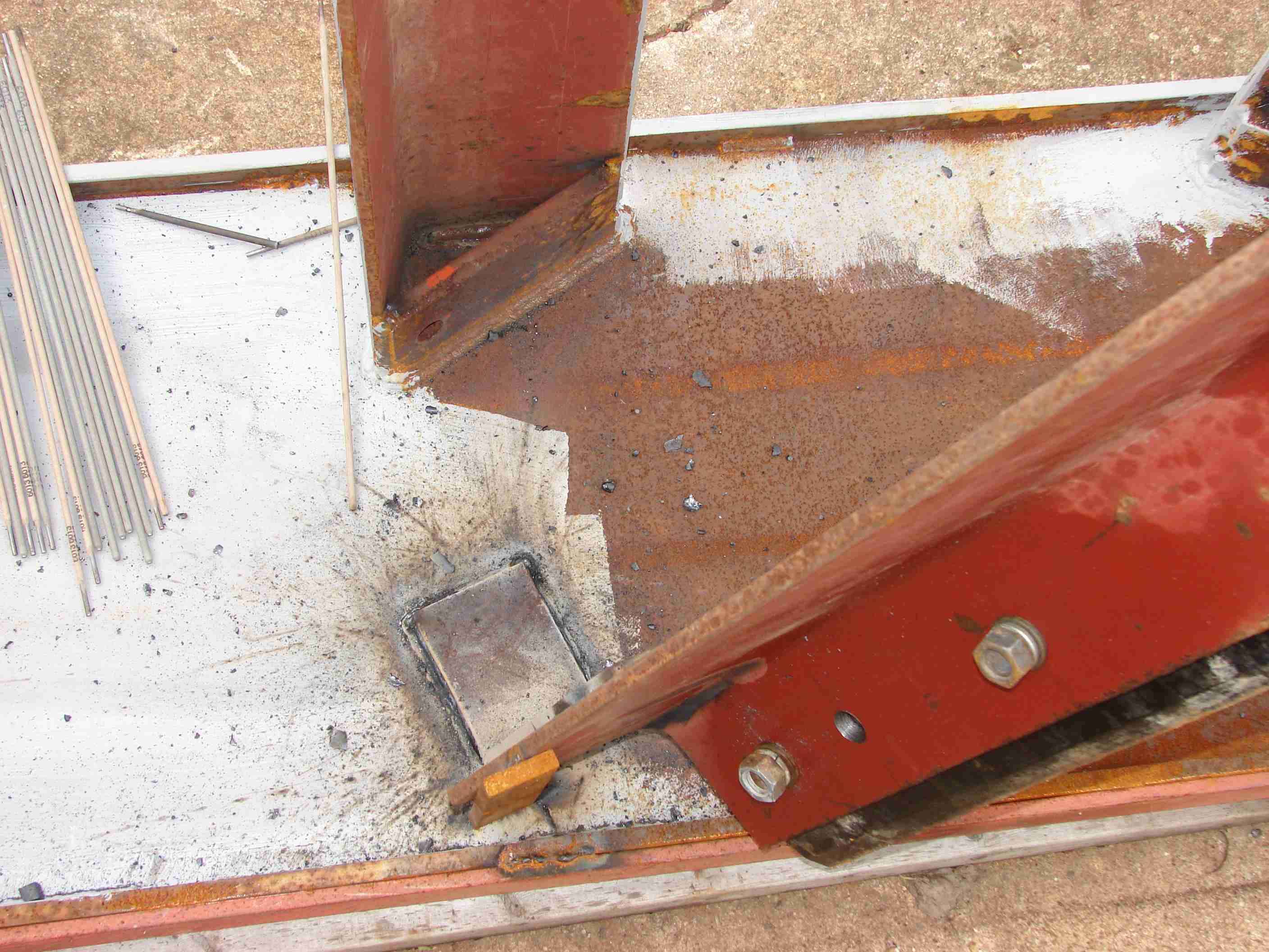

Love the build but I am confused. are the two little rods running across the bottom your blades? Or do you not have pix of the blades?
Sorry.... Great build, looking to copy it.
Carl
   / Homemade Road Grader #19
I think those are warp stoppers, while welding the top pieces.
Bruce
#20
I didn't realize I didn't post any pics of the blades. BCP is right when tacking it all together the welds will pull so we tack in braces to stop that from happening.
I'll post a pic of the blades.
