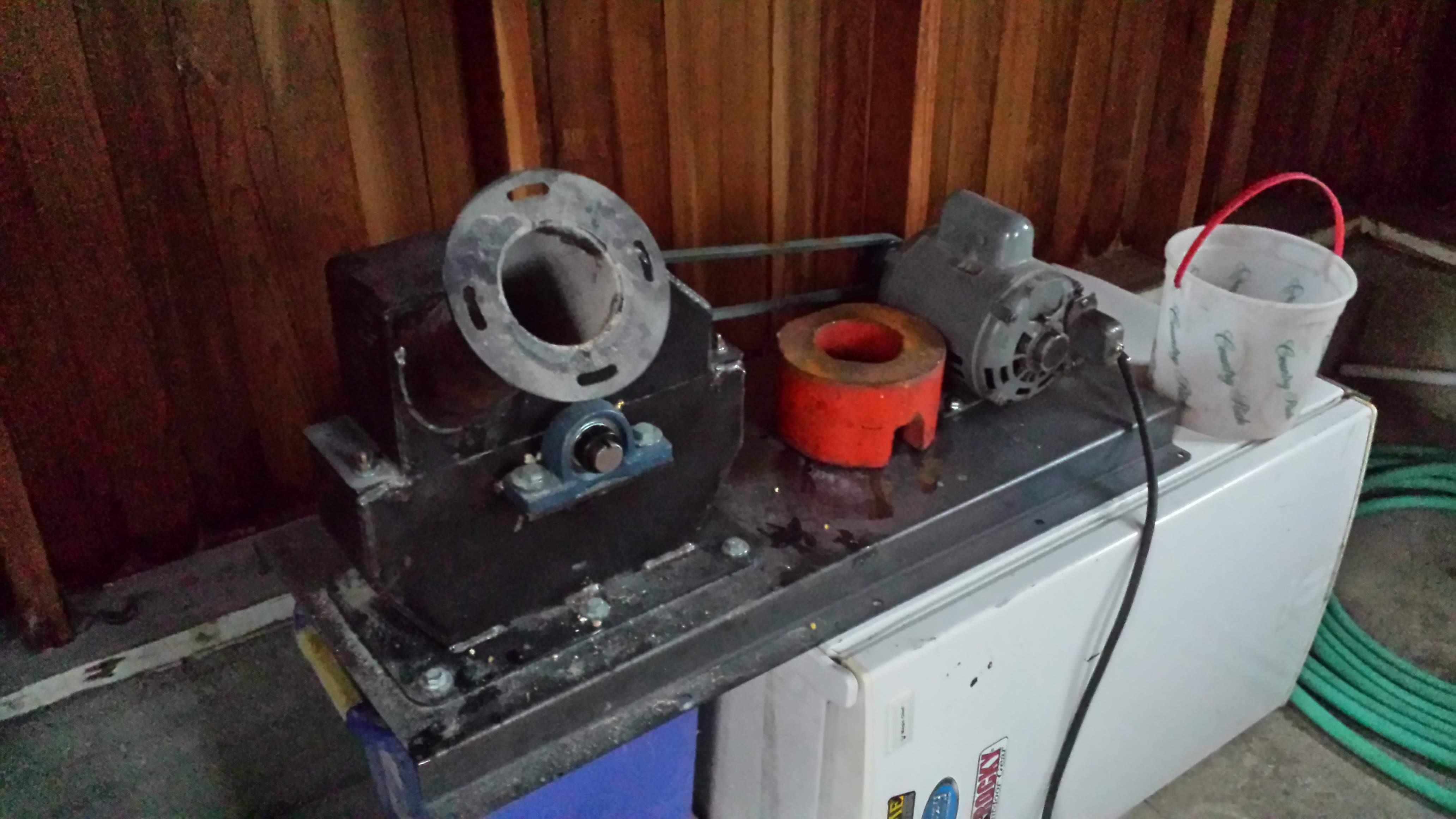

I still have to build a stand for it along with the funnel that catches the ground product out of the bottom.. I have it made just need to bolt it on.
Here is a picture of the little contraption, its not a very good picture, but it shows the overall size and what I have done so far. The motor is a 3/4 HP 120v that I borrowed off our hay elevator. The Blue tub is there to catch the ground feed.

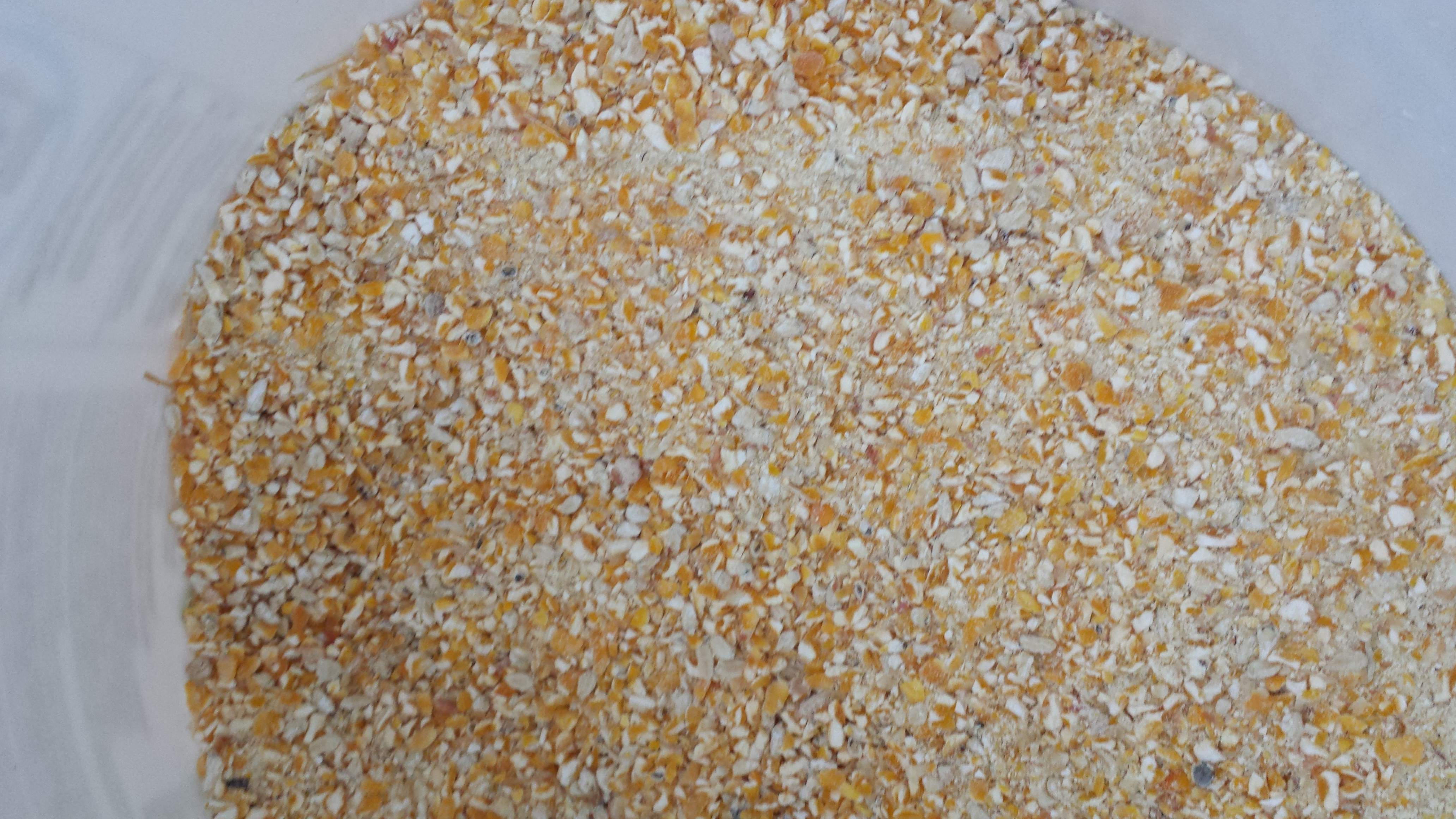

Here is a picture of shelled corn after I ran it thru. I find that the slower I feed it, the smaller it cracks it. But even while feeding it fast, it still works awesome!

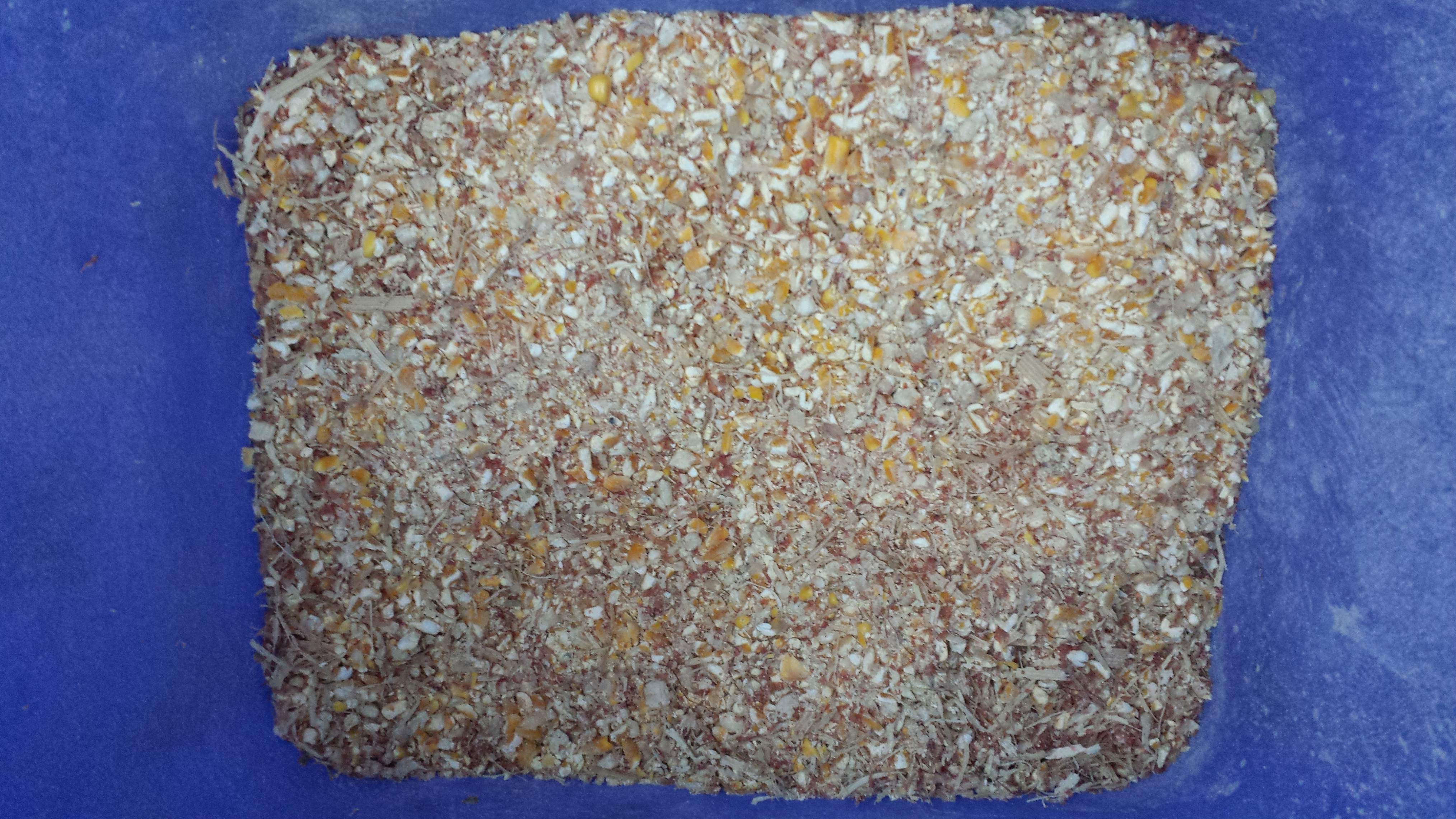

Here is a picture of some whole ear corn with husks still on it that I ran thru the mill. It took longer, but still did a good job and quick for the overall size and power of the hammer mill.

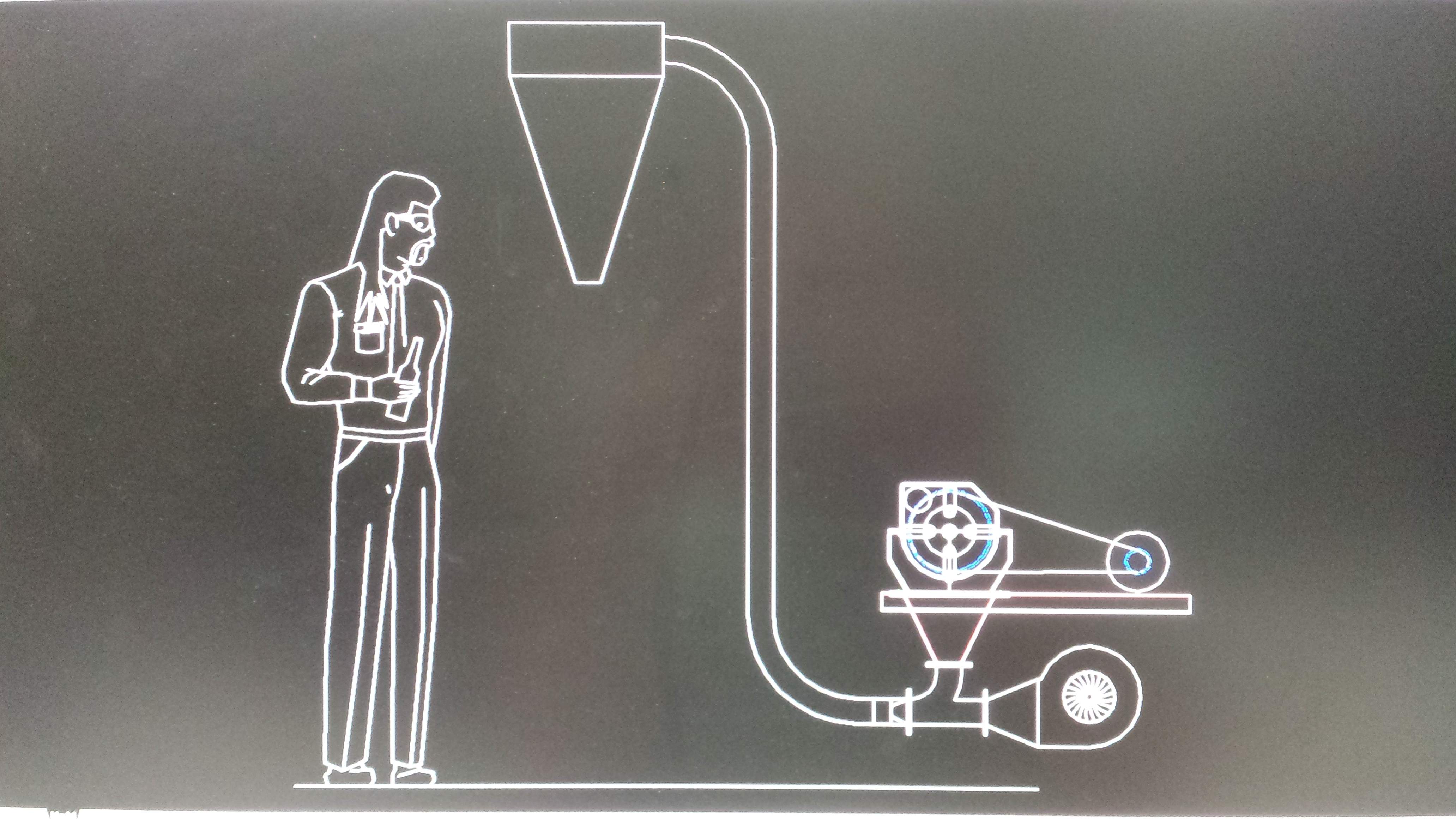

Finally, Here is a picture of my CAD drawing showing what I want to have as my final product. I plan on having a fan blow the product up to the cyclone then fall out the bottom of the cyclone. If I cant get or build a fan strong enough for that, I may build an auger to replace the fan and cyclone..
What do you all think?

most likely shop vac blowing for the fan, should work, and if all else fails just set over a trash can
if you want to seal it just put a vent in the cover,, it will just drop through the unit most likely. that is what I do with my burr mill I made,

I think it's awesome! Can't wait for the video. I also noticed you're holding a long neck in the CAD drawing. Nice touch! ;)
Joe
Joe
Thanks!!
Haha.. That was a figure I drew up a few years ago to give a representation of actual size. The guy is exactly 6 foot tall. I modified the drawing of the guy when I was bored one day lol. I sent a small bucket of ground corn with my grandpa to take home and show off to his old farmer friends. The guy that runs the elevator/co-op in his town was amazed at how good of a job it did.. and asked me to quote grinding some corn for him for chicken feed(that elevator doesn't have a feed portion like most do). I need to figure out my capacity now, hopefully this week I can get that done still and ill post my results here.
