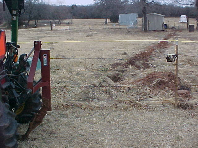

OkieG,
Enjoyed looking at your project. Since there's not much weight to help penetration, you need a geometry that will dive once is started. One thing that may resist diving is the very end of your 1.5 inch square tooth. Looks like you cut it off at an angle but the resulting surface is parallel with the ground in the fully raised position. It needs a clearance angle so the leading edge is lower than the trailing edge. The more clearance, the faster it will penetrate, all other things being equal.
That geometry gets worse as the implement rotates down because the bottom surface will rotate, causing the trailing edge to become lower than the leading edge, giving it some lift.
Of course if the ground is soft enough, it won't matter.
John

   / Homemade Subsoiler Ripper for MiddleBuster
#15
The problem with the TSC Middlebuster frame is that the main vertical flat bar is short. Using the method you've illustrated would allow the tooth to penetrate ground about 4-6" when used on my small tractor. 4-6" is a guess on my part. I can measure tomorrow and get a better figure.
On the other hand, if the tip of the tooth is only a couple inches off the ground with the 3PH in the "full up" position, you know you can trench about the maximum depth possible.
Made some trial runs along the old water line at my friend's property. My contraption trenched between 12 to 14". It took 3 to 4 passes to get that deep, and a little extra work in a few places that would stop the tractor and make the tires spin. But it's still much, much faster than a backhoe, or, heaven forbid, a shovel!!
The next step will be to find a gentle bend (metal?) elbow to attach to the subsoiler to feed the pipe through. Still not sure where to find one of those.
OkieG

   / Homemade Subsoiler Ripper for MiddleBuster #16
Nice Job - Looks like it works well.
Have you thought about just welding a bit of chain to the rear of the blade and pulling the pipe through? What kind of pipe do you plan to use? I've seen irrigation poly pipe up to 1.5 inches pulled this way for 150-200 feet. Of course, they also have a "bullet" on the leading edge to open up the soil a little more in the spot where the pipe will go through.

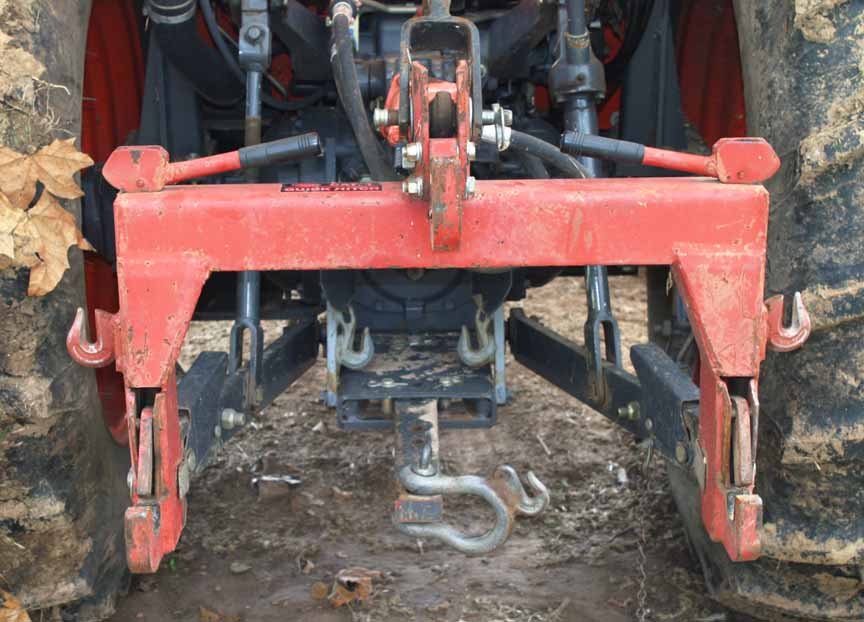

An electrical supply house will have large radius conduit. You can get galvanized. You could also go to an electricians shop and ask then to bend a piece of ridged conduit. They will have a hydraulic bender that will bend it like butter. This is what I would do, as you could get the ends as long as you like.
I you place the vertical blade further back from the 3pt then you can get more depth. One problem I have with tractor specs is that they generally leave off the 3pt lift heigth. They now make the arms short so the capacity is greater, but distance traveled is less. Older tractors tend to have longer arms that lift less but higher. It's a marketing game.
As you make your attachment consider if you ever plan to have a 3pt quick hitch like a Speeco or JD I-match. I have two and will never do without one. Consider making your subsoiler so it will work to the the quick hitch specification, as you someday might get educated and discover what you are missing.
Best of luck and post lots of pictures.
