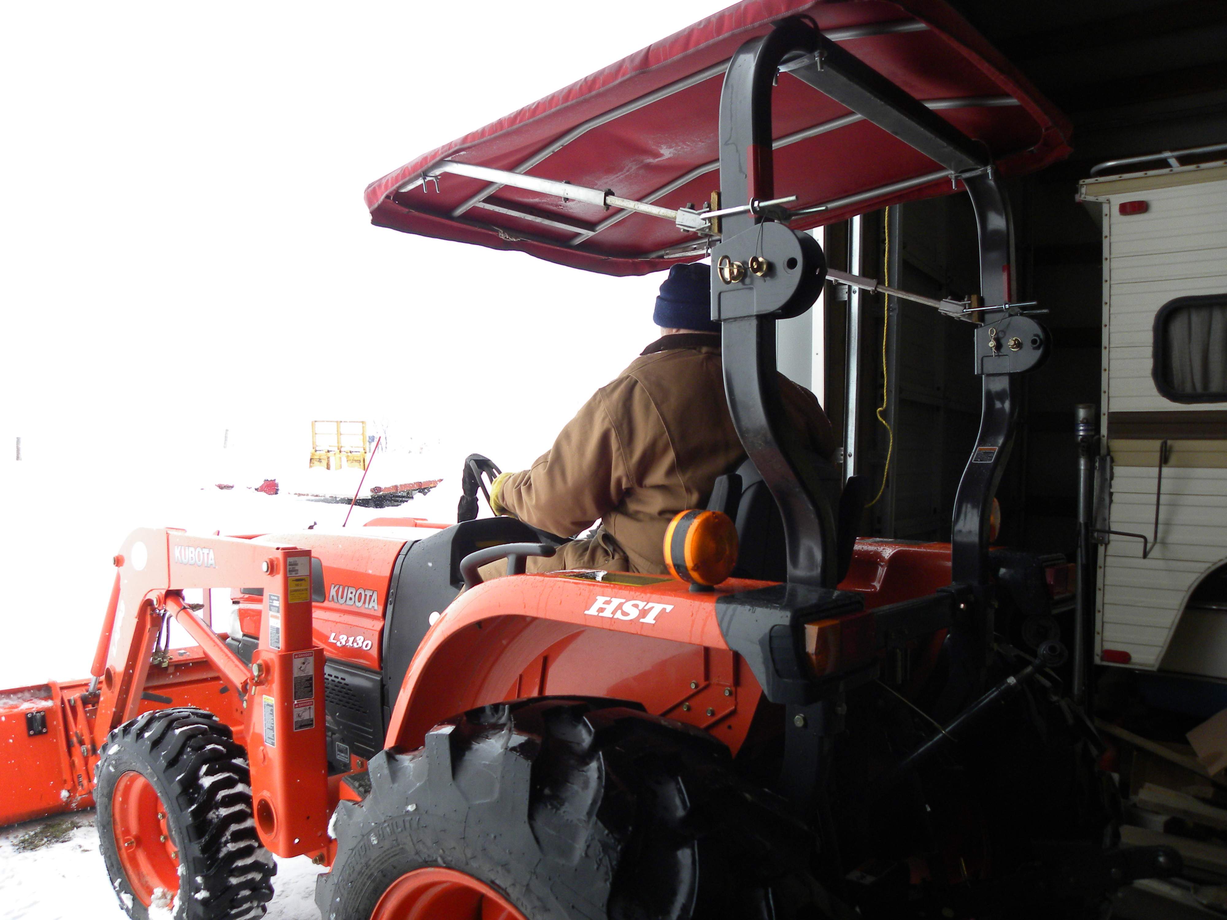

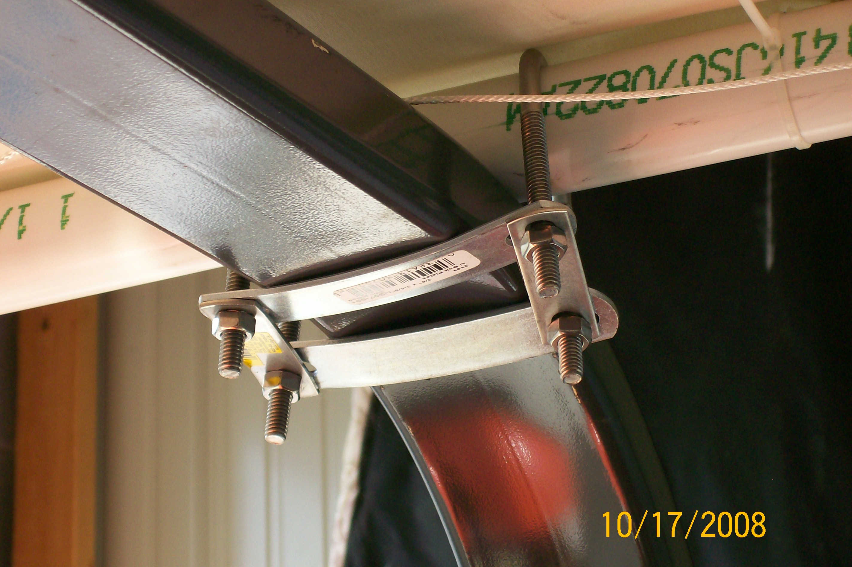

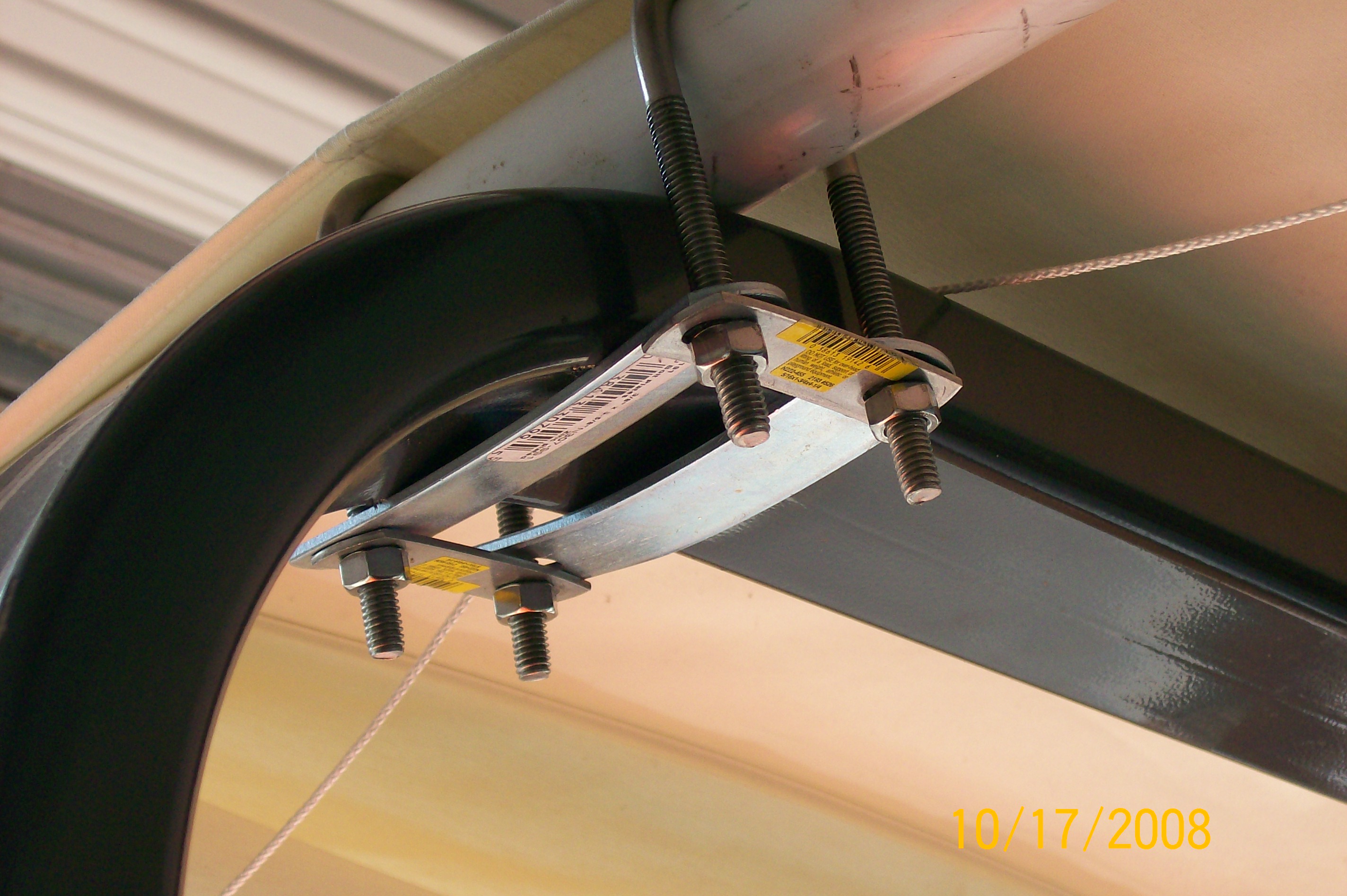

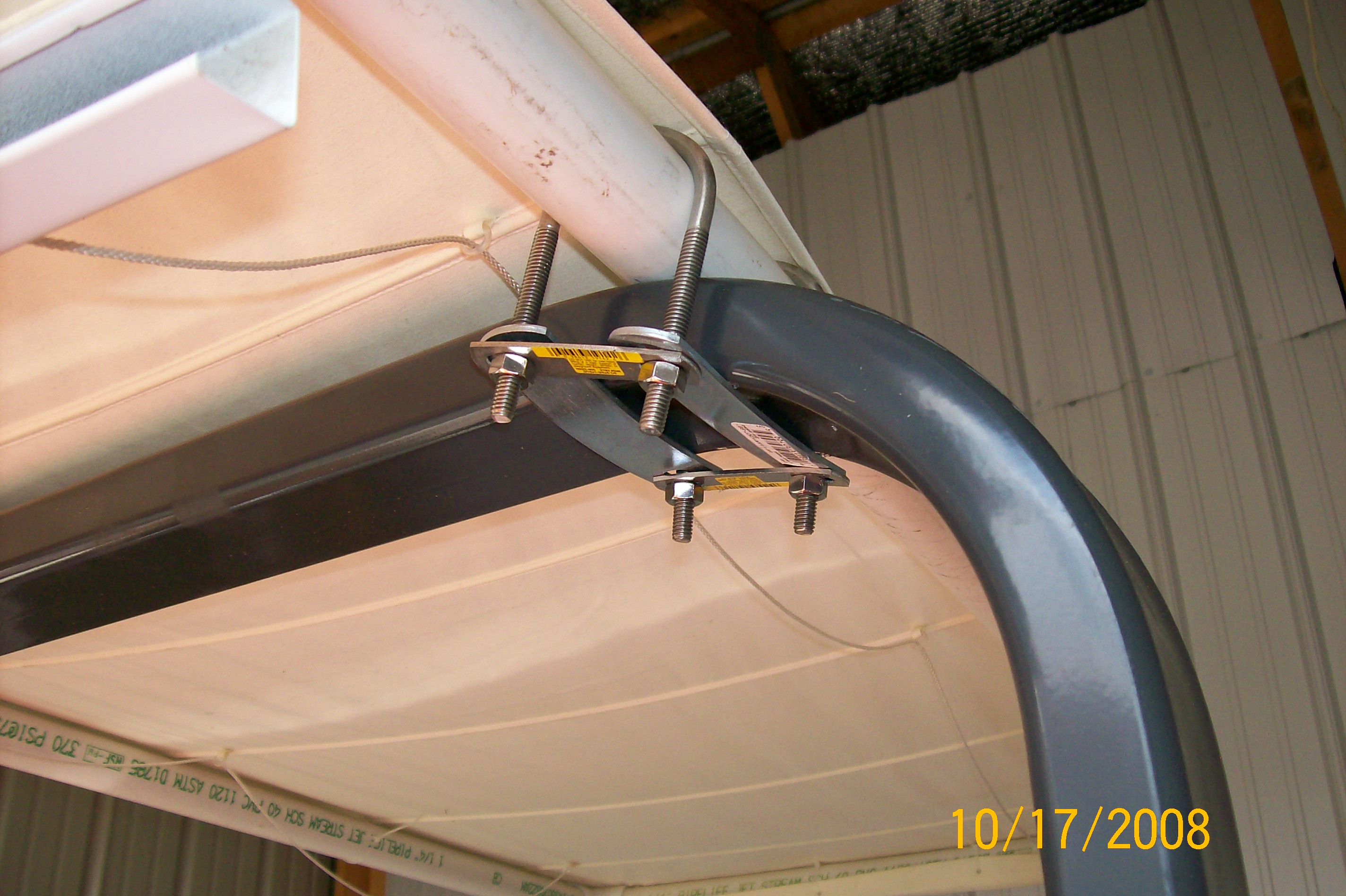

Made my own shades using PVC, stainless steel clamps and some canvas window shades I bought at a yard sale when coming thru Florence, SC.

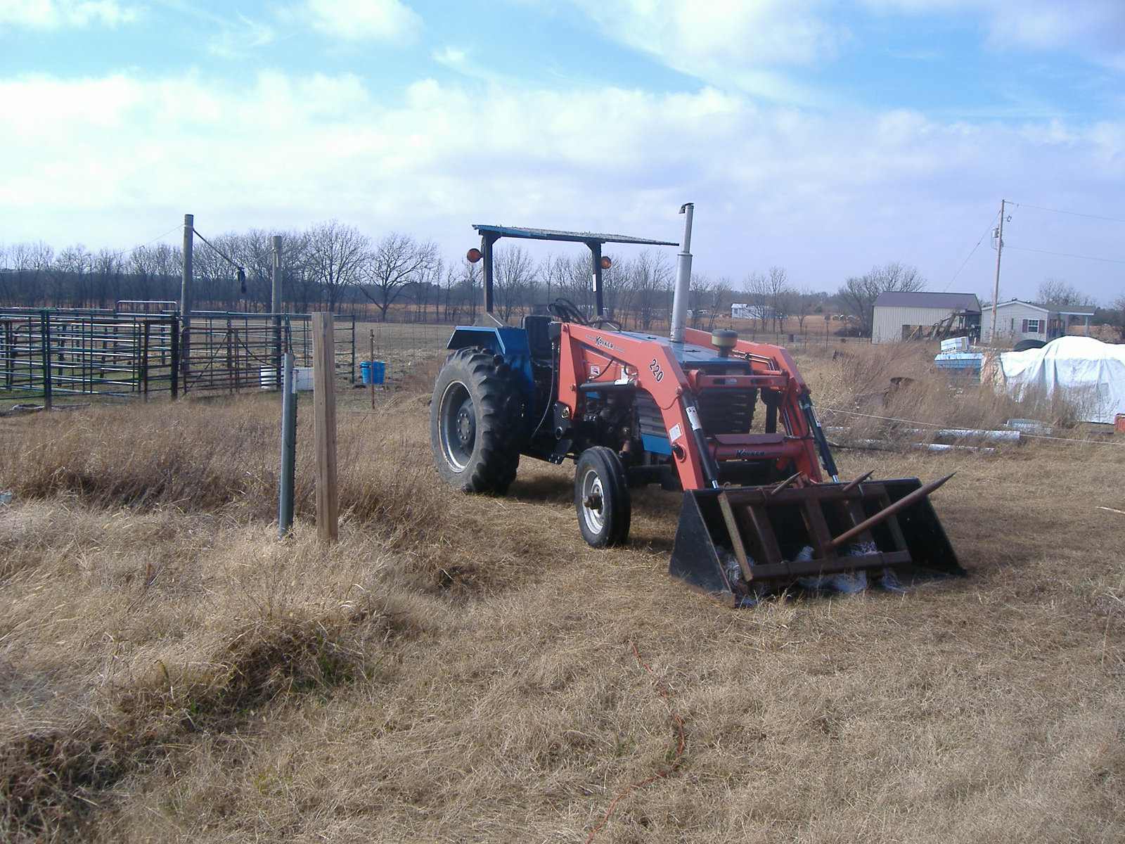

I'm thinking of making ROP for a ford 650, IF I can get other jobs finished 1st.
