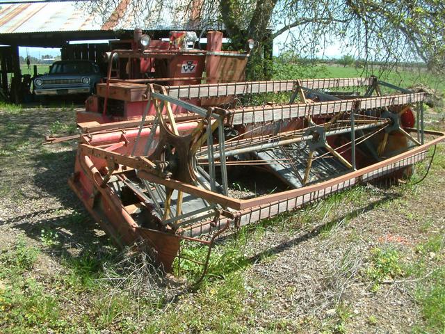

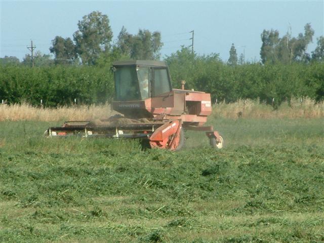

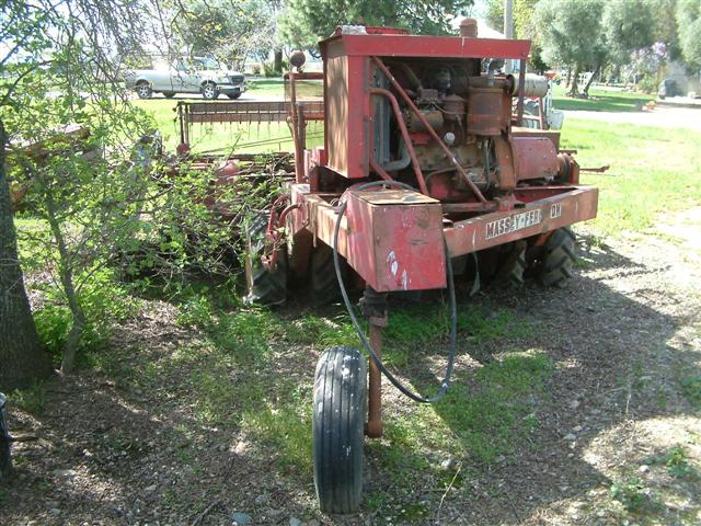

I'd start with an old windrower that has the auger or drapes already installed and then do the mods to replace the sicklebar mower with your disc mower.
One of my neighbors gave me this old MF44 windrower (drape type).
It has a Continental gas engine. I'll get around to it one of these days.
Another neighbor uses this Hesston swather on his 30 acre alfalfa field. It's diesel powered, sicklebar mower, auger swather.
You see this type on eBay pretty often.
Good luck

We used to have a heston windrower like that when I was young. I don't see them anymore and I wonder why? I would like to get one in the near future myself.
   / Homemade Swather (windrower) #9
Don't know why. Another neighbor uses one of these old Hesstons on his 200 acre hayfield (oats, beardless wheat). As I said before, these old swathers show up all the time on eBay and sell for a few thousand dollars. I'd expect that you'd have to put in another thousand or two to get one of these old gems running reliably.
