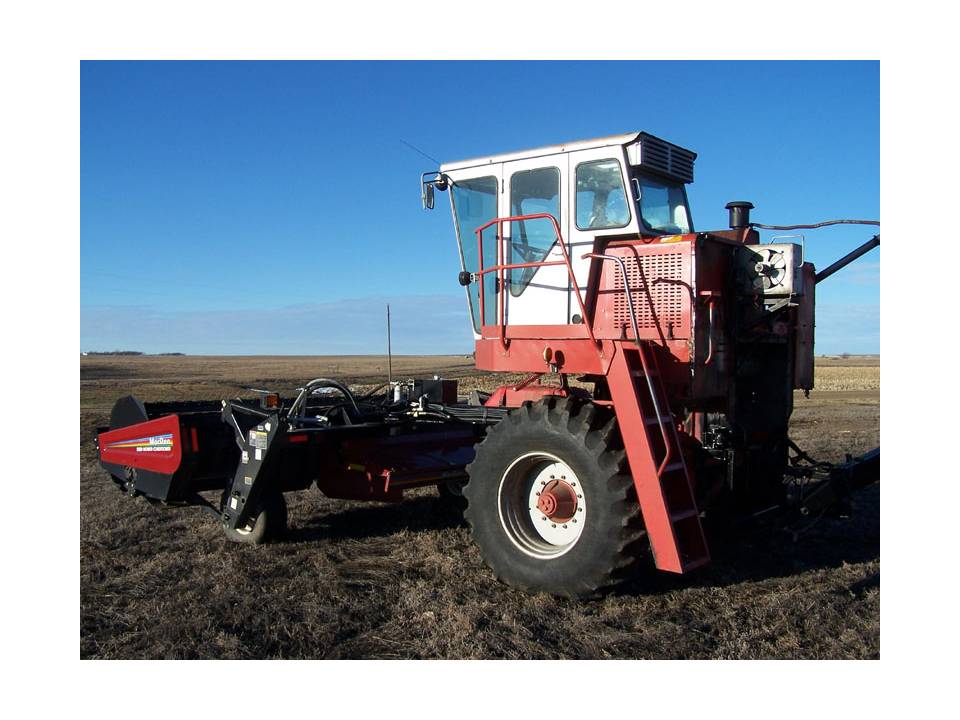

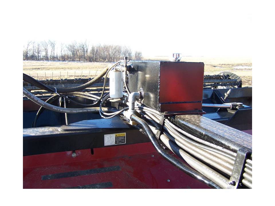

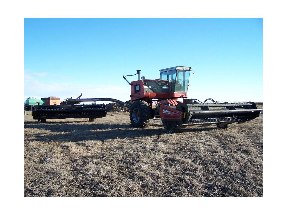

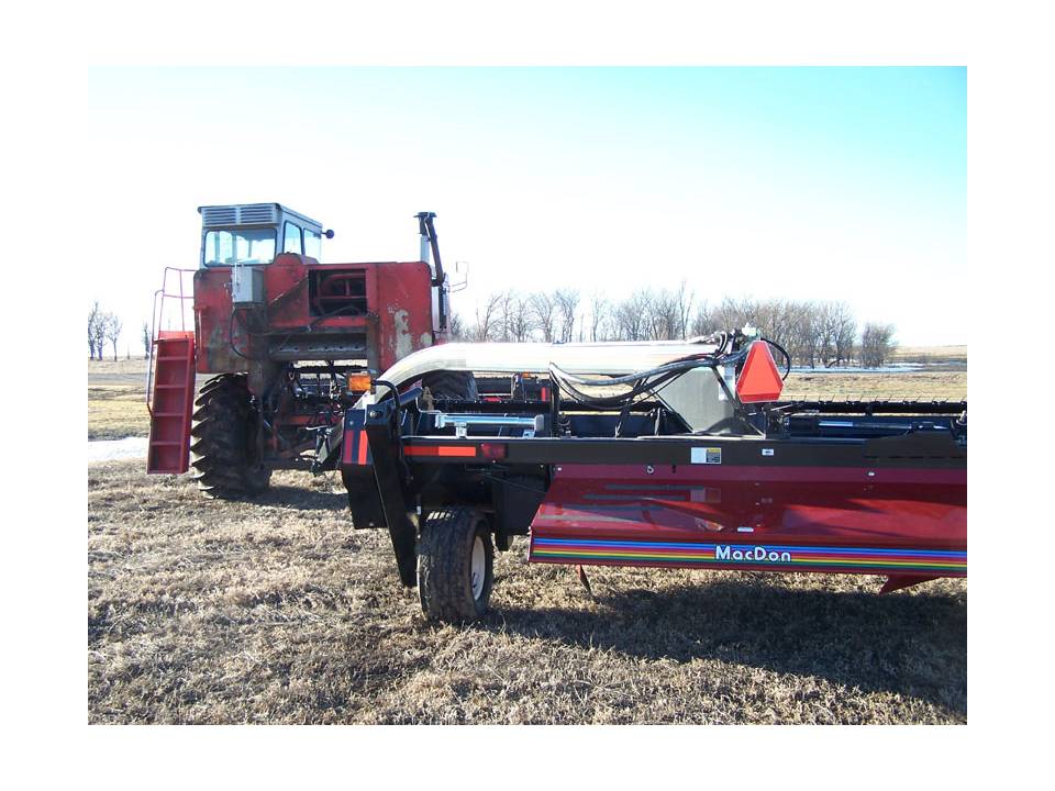

Here is a link to an article about a guy in South Dakota who built a windrower from an old combine. He can cut 32 feet in one pass.
FARM SHOW - "Articulated Double Windrower" Built Out Of Old Combine
Here are some pics of that unit or another just about like it.
With disc mower headers it would really be a cutting machine.
