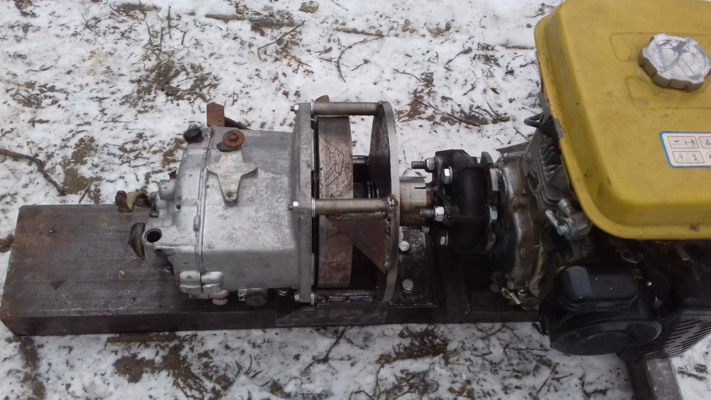

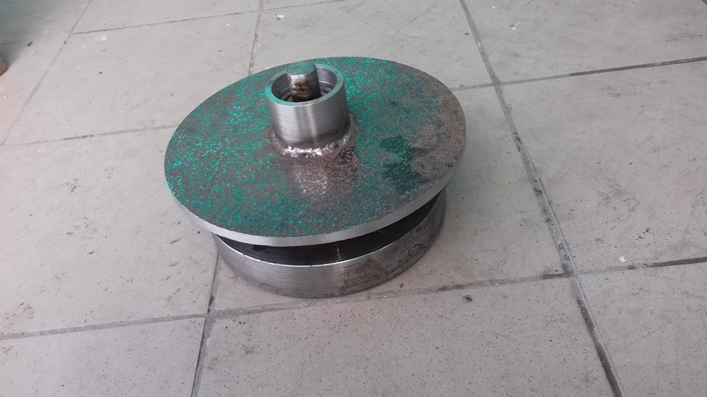

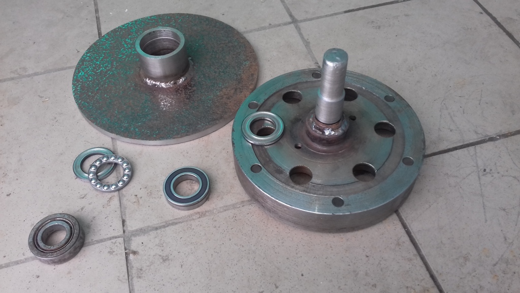

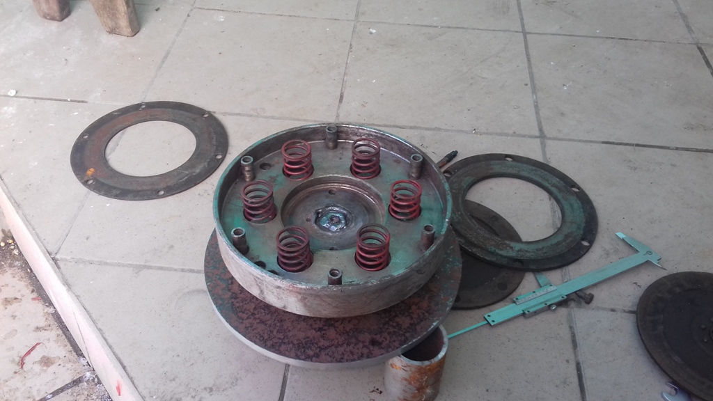

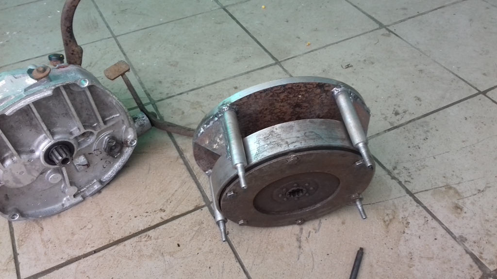

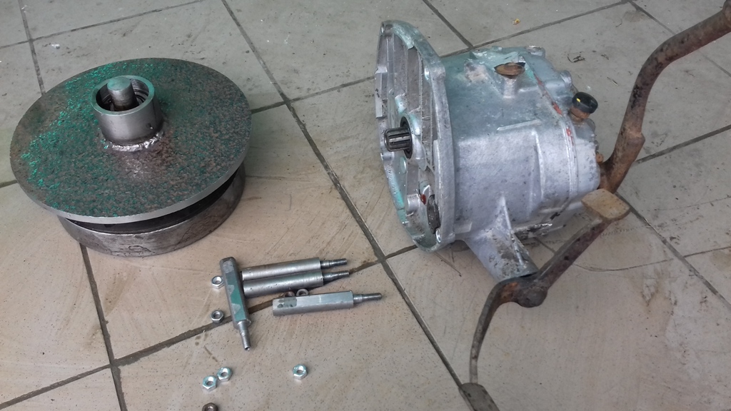

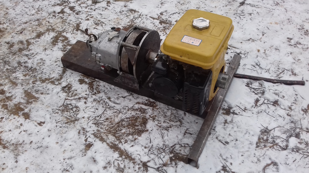

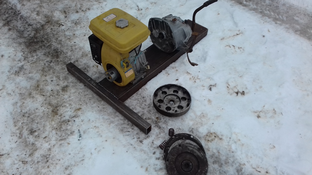

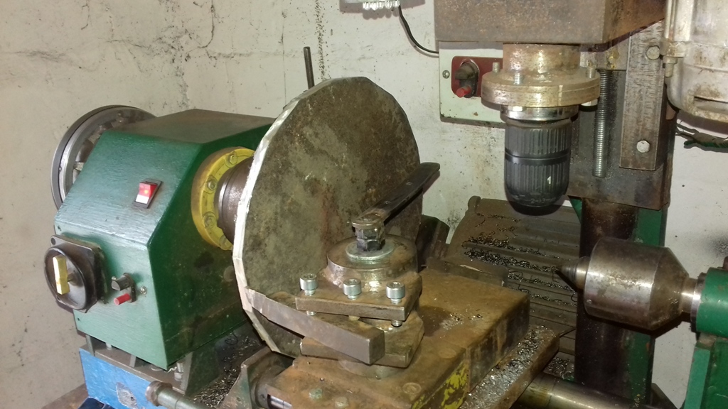

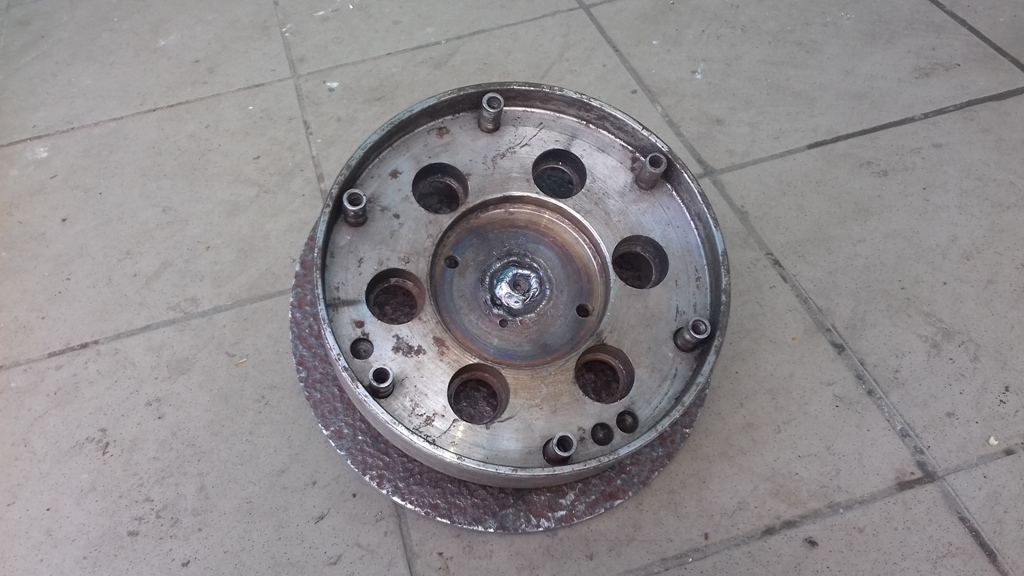

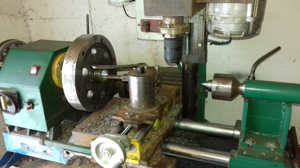

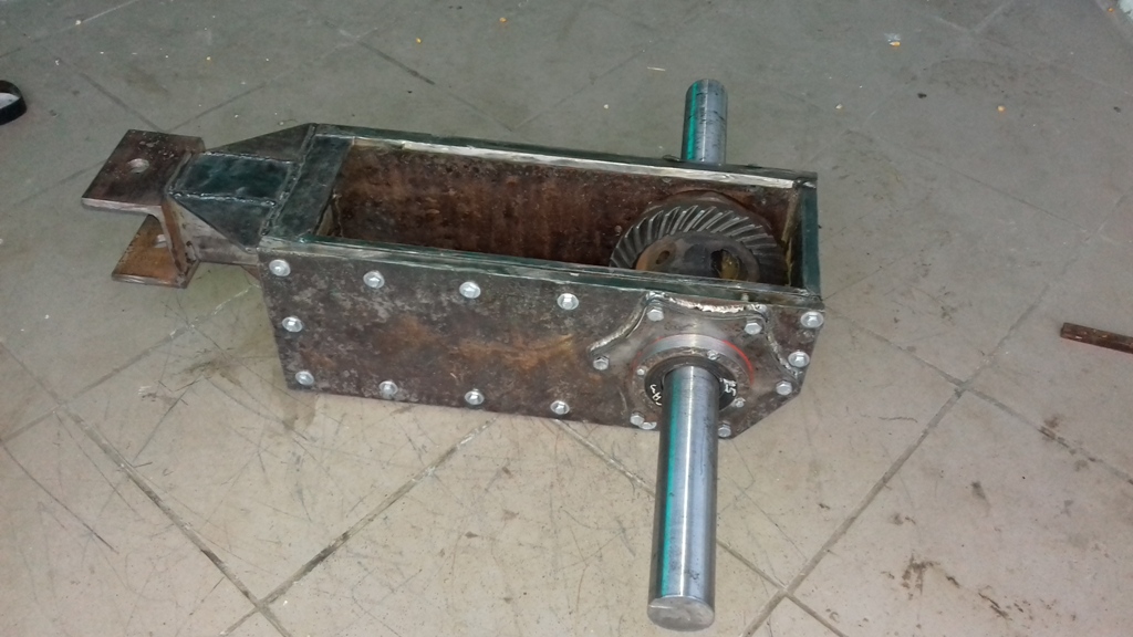

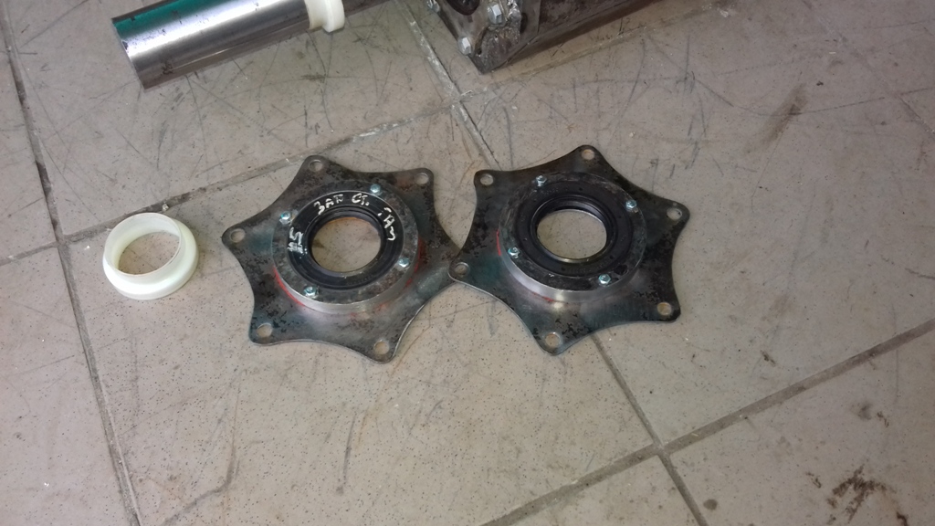

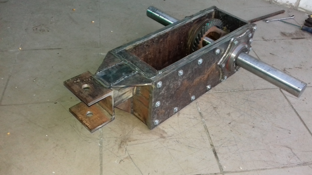

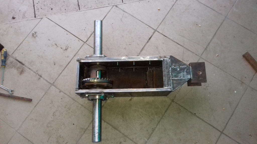

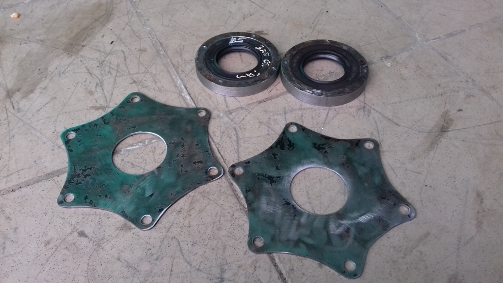

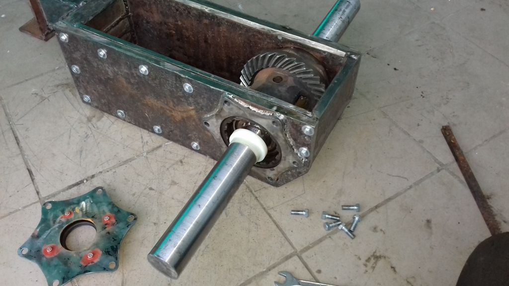

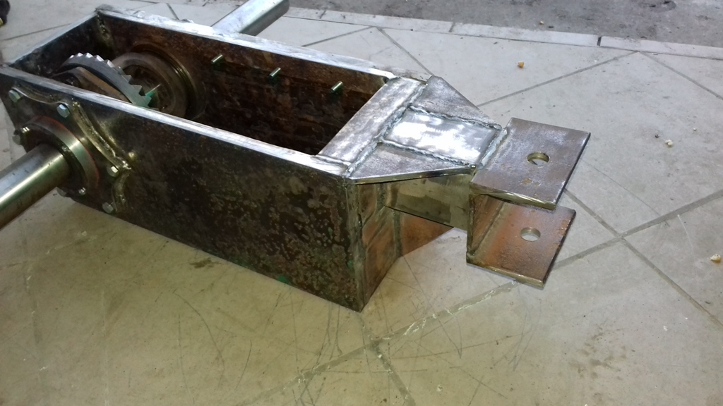

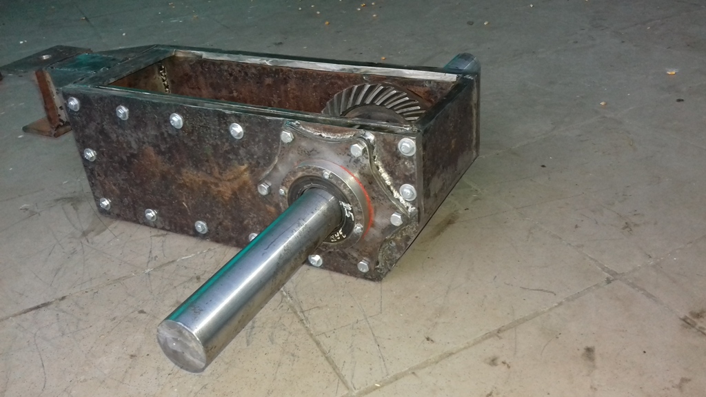

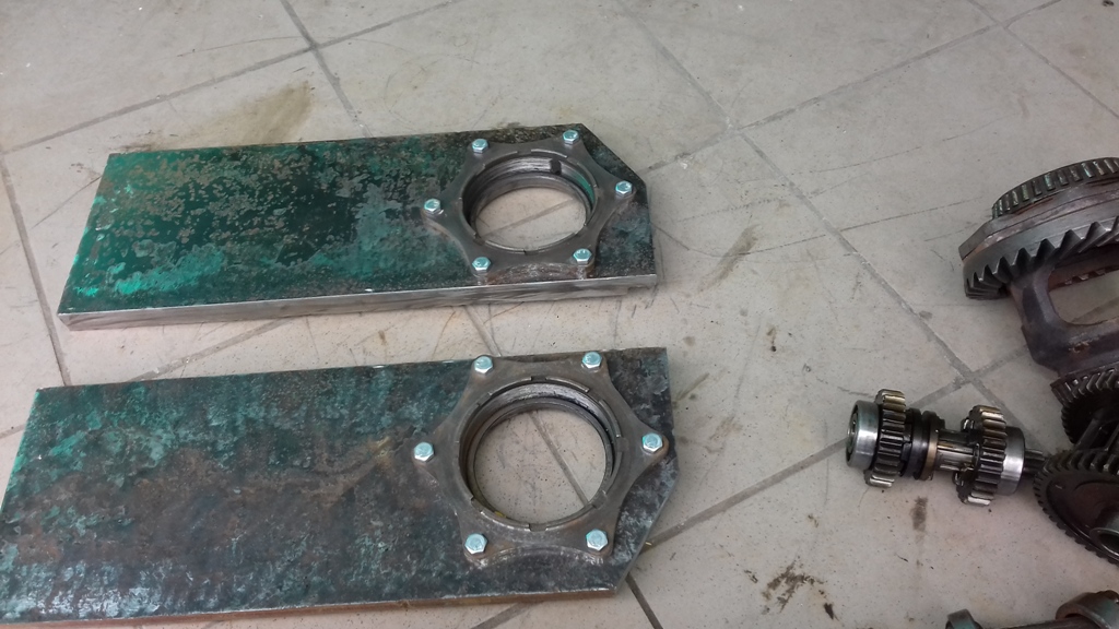

Hello. Began to build a two-wheeled tractor for work in the garden. 5.5-horsepower engine, gearbox and clutch from the Dniepr motorcycle. The axle and the lowering gearbox with a reverse and a shaft of power take-off will be homemade. The two wheel tractor will have 4 speeds forward and 4 backwards.

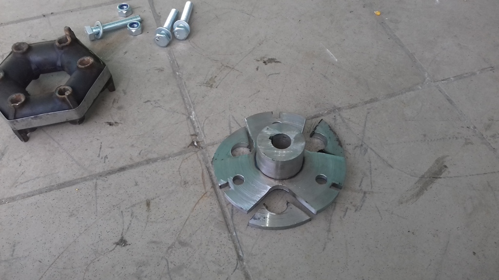

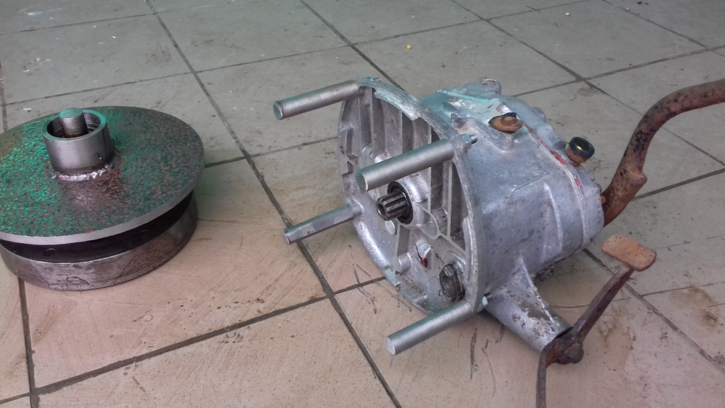

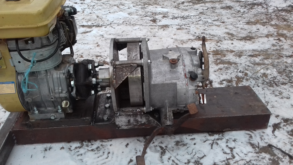

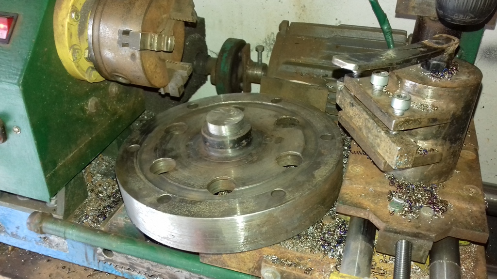

Photo report of the work performed
20181221_125320.jpg 20181221_133252.jpg 20181221_151917.jpg 20181221_154950.jpg 20190209_093833.jpg 20190209_095007.jpg 20190209_105157.jpg 20190209_113120.jpg

At one point I instinctively found myself reaching for my safety glasses.
