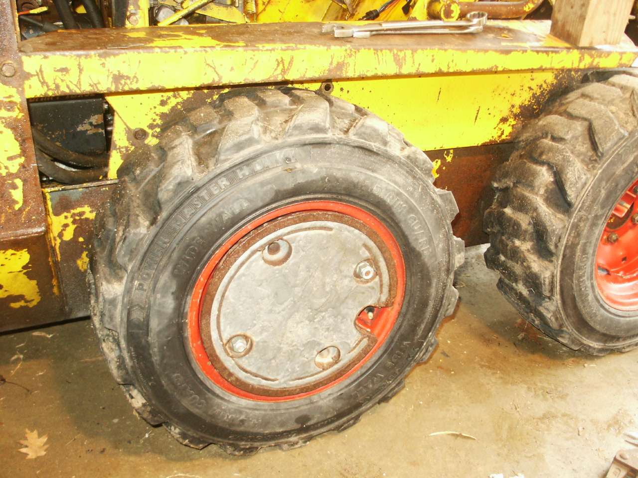

   / homemade weight for front of tractor #22
Here weights I made for my Rounder skid steer 12" wheel weights. The outer shied is from a old brake drum from a S-10 filled with lead I got free from a tire shop. Each are 85lbs that will fit in most lawn tractor with a 12" rim. I cut a grove out for the air valve and welded tubes to bolt on rim. I use a frying pan and LP burner to melt the lead. Then I made it so the nuts where counter sunk in the weight so nothing could hang up on anything.
