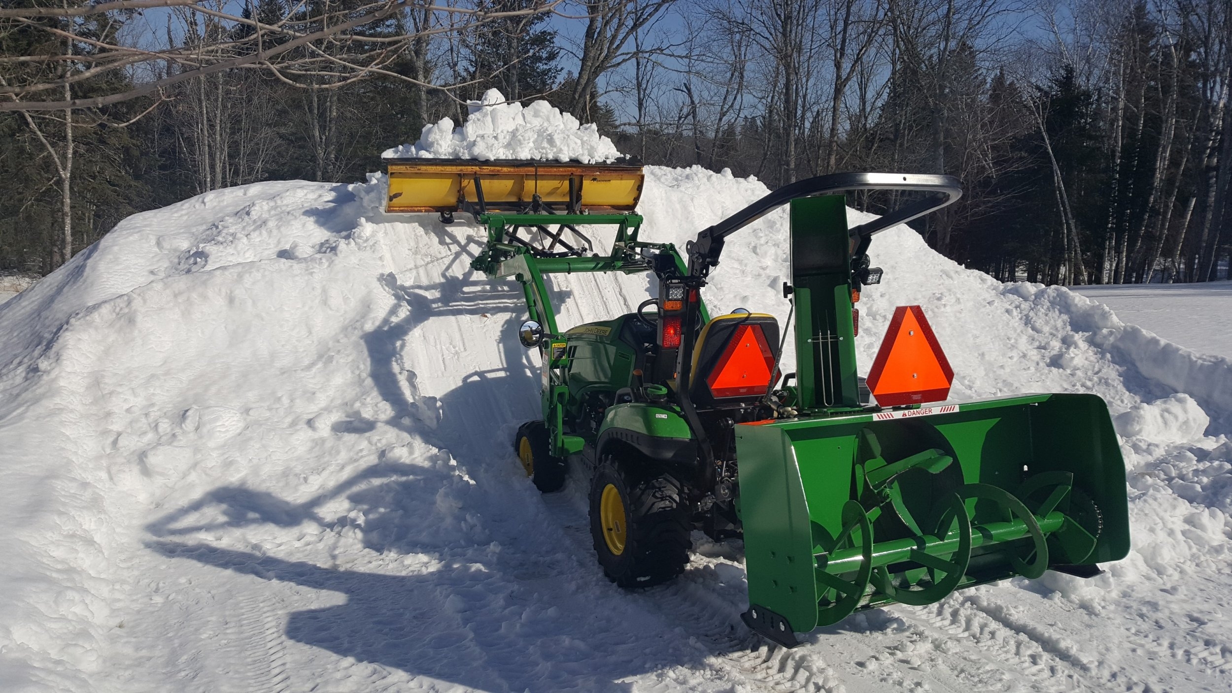

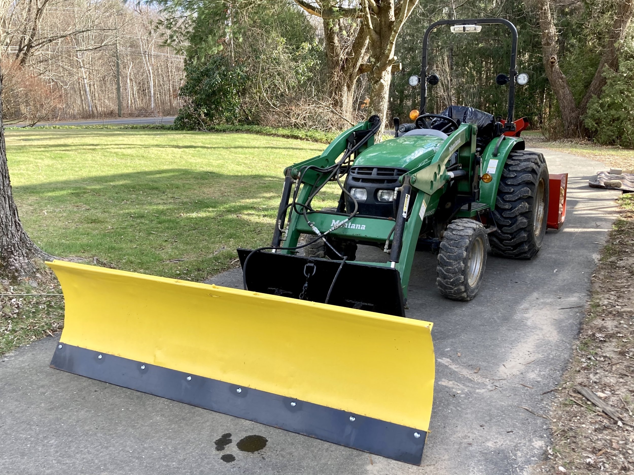

Just a cheap truck (electric winch) plow that I found for sale $150. Have to say I love the way it works, manual angle, but no complaints. Tried the blade mounted directly to the loader arms, wasn't happy with the float, this setup however works excellent.

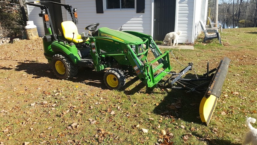

Plows take a lot of force. I don’t think a wooden plow would survive very long. I attached a 7.5’ plow to a SSQA plate. Has hydraulic blade angle adjustment. Plow hangs from a chain so it floats to follow the driveway nicely. Paid $100 for the plow. Painted it up and it looks and works great.
