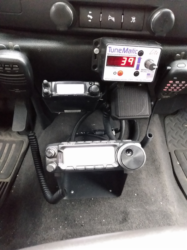

If you do intend to get into Amateur Radio, especially mobile, you will need to decide if your interest is local communications with VHF/UHF gear in your vehicle or into long range communication's with HF gear in your vehicle. I have both in my truck, and VHF only in the wifes minivan. As for the size of the gear, the good news is that all types of gear has been greatly reduced in size over the years.
I can tell you what I have in the Truck if you like. For VHF/UHF I have an old Yaesu FT90r super miniature 2 meter/70 cm rig. You can't buy this one anymore but mine is still working fine so it stays. If you are only interested in the local operation (think maybe 50 to 100 miles) then the VHF/UHF rigs will only require a technician class license to operate. So a very easy written test, 35 questions, multiple choice. no Morse Code anymore for any test. The antenna is a dual band Larson 270 mounted on the front cowl area of the truck. You can go to QRZ.com and enter my callsign to see pictures. Similar current rigs could be had for around $300-$400

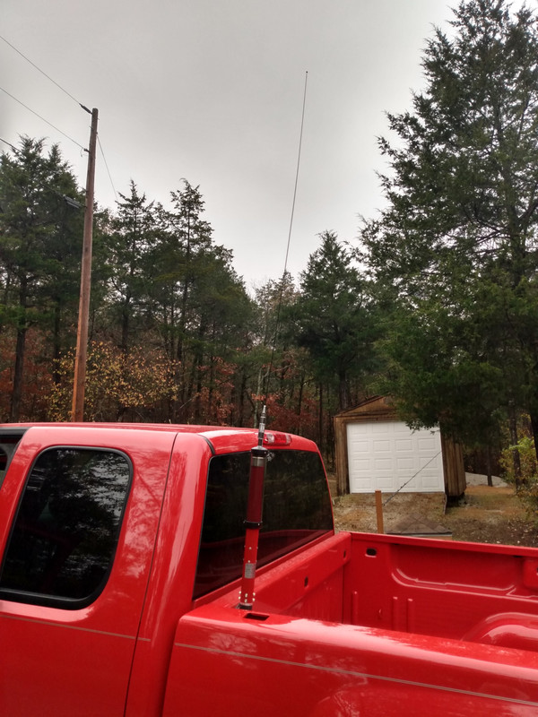

For HF worldwide communications I have the fairly new Yaesu FT891 100 watt HF rig. It is also very small considering what it is. The antenna is the Little Tarheel II mounted on a corner plate in the bed. This is a small but still fairly expensive (about $400) antenna. The Ft891 itself is about $600
The antenna is a motorized so called "screwdriver" antenna, if you are interested as to why it is called that is because the originals were "homebrewed" by a fella named Don Johnson and he used the motor out of a handheld electric screwdriver as he designed and built the originals. But the gist of it is a coil with sliding fingers moving up and down to adjust the inductance and driving the whip.
Here is a photo, you might notice that there is another device (about $139) called an antenna controller. While not strictly necessary for operation of the Little Tarheel II motorized HF antenna, it does make operation a little easier as it "remembers" the tuning settings of the antenna for each band or portion thereof. As you can tell operation of HF mobile is much more costly and much more involved than a VHF/UHF mobile install.
