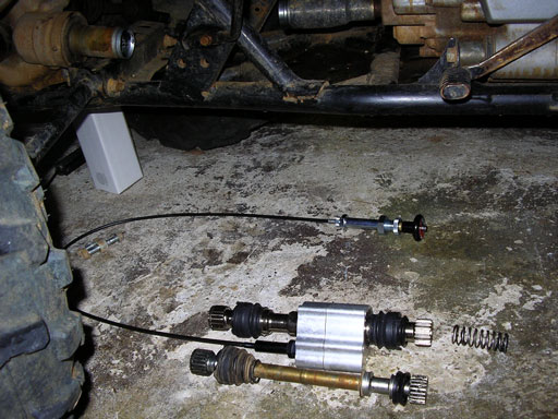

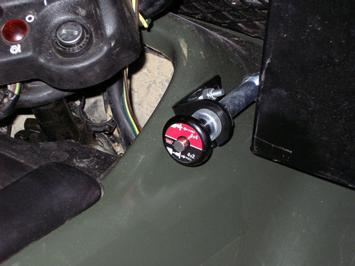

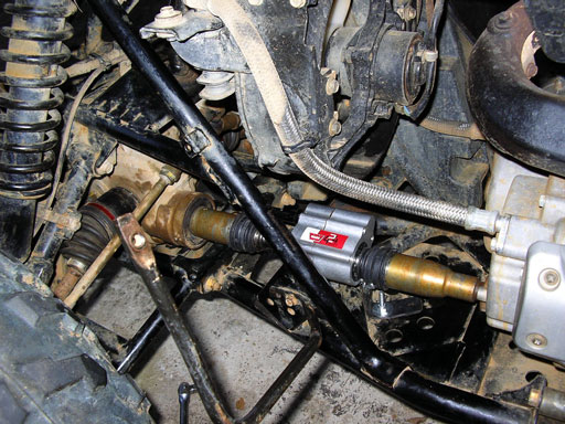

Keep in mind that most of the older hondas that are 4x4 are full time 4x4. But Warn (same winch people) came out with an add on part to disengauge the 4x4. It goes in place if the front drive shart and is operated via a pull cable. I do ride in 2x4 most of the time because it's easier to steer and more fun (you can kick the rear end sideways!). But 4x4 is always there. The 4x2 unit is about $225 off ebay.
Some pics....
More Rancher stuff at http://www.angelfire.com/tx6/rancher

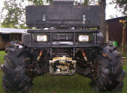

I have a 00 foreman 450 tuff as **** 1500 miles 500 hrs been treated pretty bad in the river most of the time:D the es didnt work when i got from my buddy i cleaned the cpu conectons and started working but then it only worked 98% of the time and two weeks ago at the river it quite again normaly when it quites i go play in the river for 10-15 minutes and its good to go.but from what ive heard no problems unless you dieclec grease them from the start when playing in the water. shes been under water a few times smokes now but still runs strong.
