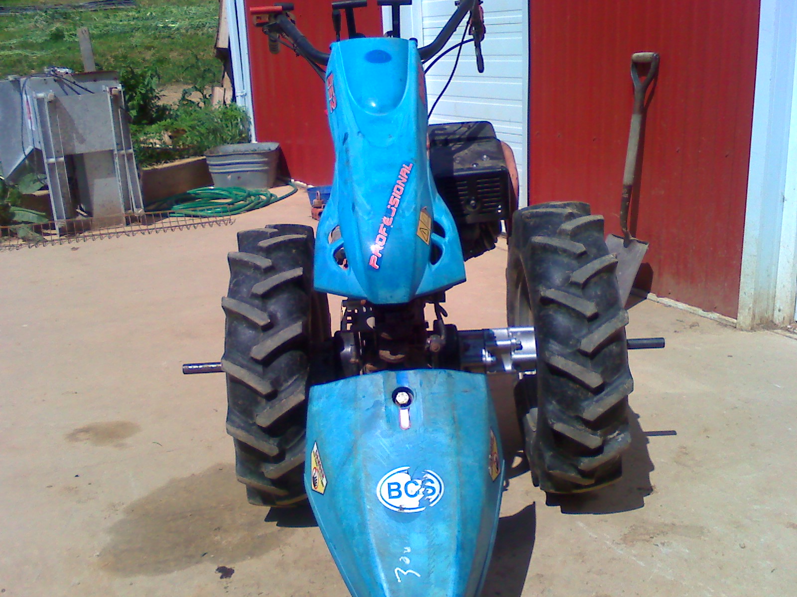

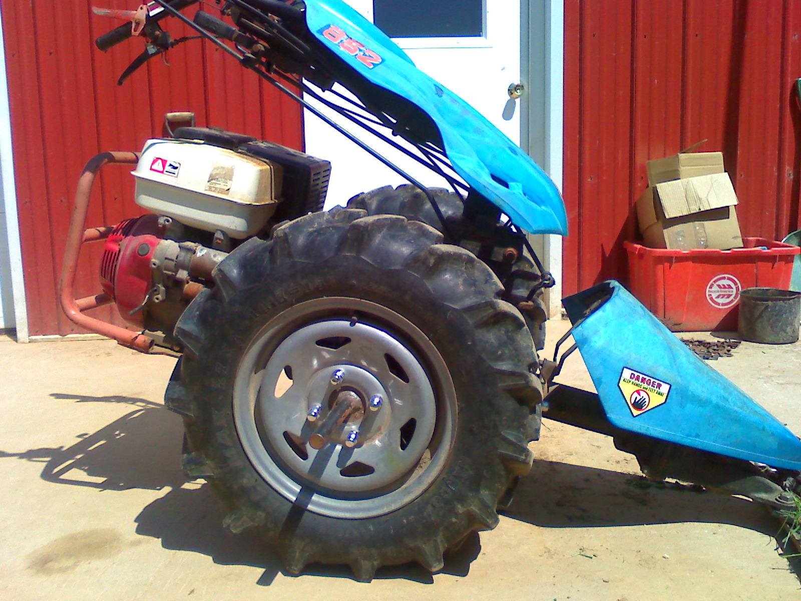

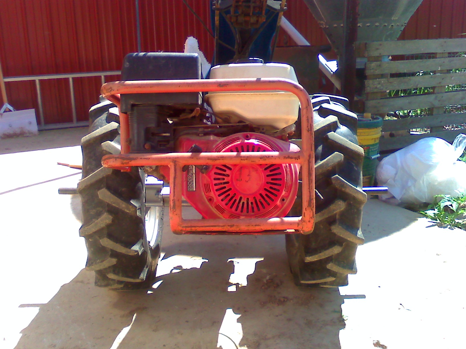

Hey All,
Gonna go help a friend cut some hay tonight and wanted to get the ol' gal dressed up for the occasion. He has an 853 Lombardini diesel with 40 inch drum mower, Molon rake, and Caeb baler, so he doesn't actually NEED my help. Still, two mowers will drop 8 acres nearly twice as fast, right? And one machine raking while the other is baling should really speed it up, too.
This is a recently acquired 2004 BCS 852. I still have the old early 80's 735 that's gonna meet a NOS Acme diesel courtesy of Paul Sullivan Jr, and the 850 Diesel of course, but this is the newest BCS I've had the pleasure of owning. I bought it to resell it, but now have too much money in it to sell it right away. I figure I'll get a summer of use out of it and sell it next spring rush. It had a hard life being married to a sweeper in the Twin Cities since new and required more than I expected to at least get it all working again. The fellow who sold it to me wants me to buy his other 7 machines as well, but I think I'll do it one at a time...
The tires are off a four wheeler. I can't remember the exact size and can't read it off the pic, but they're 14 inch rims, 27 inches total height, and 7 inches wide. Unfortunately, they don't clear the muffler without three 5 inch extensions. I plan on making up extensions that will keep it exactly as much as needed - about 6 inches.

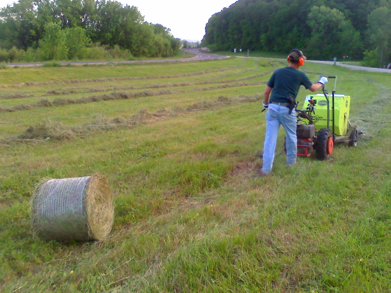

Here's a couple pics from last night baling. Two fields were road banks and the weather wasn't conducive to growing good hay - very warm in March, very cold in April, and not enough rain - so our yield was very poor for first crop. I figure we shoulda got 200 or so bales off 4 or so acres, but got 75. Still, being roadbank hay, it's free for the labor.... The other 8 acres was a field behind his barn and yielded 171 bales when we shoulda got 400 or so.

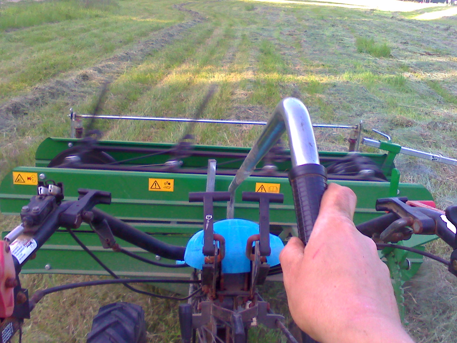

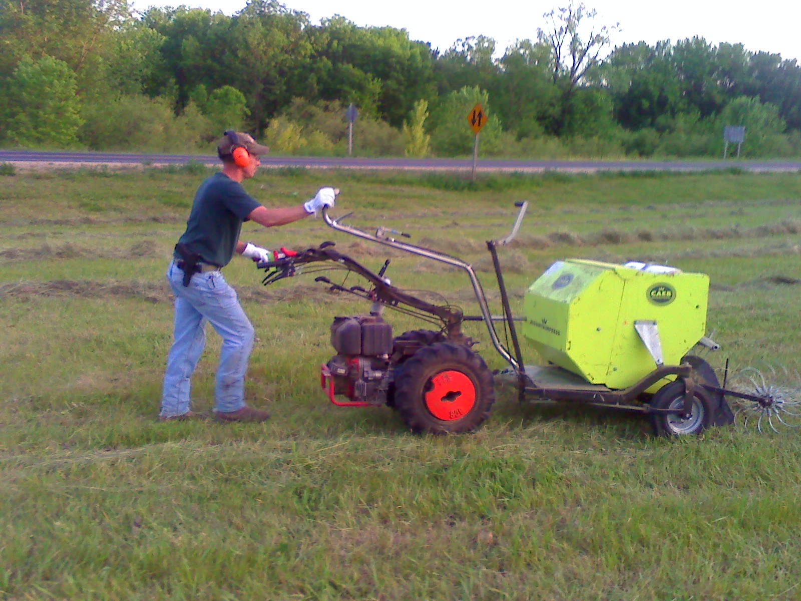

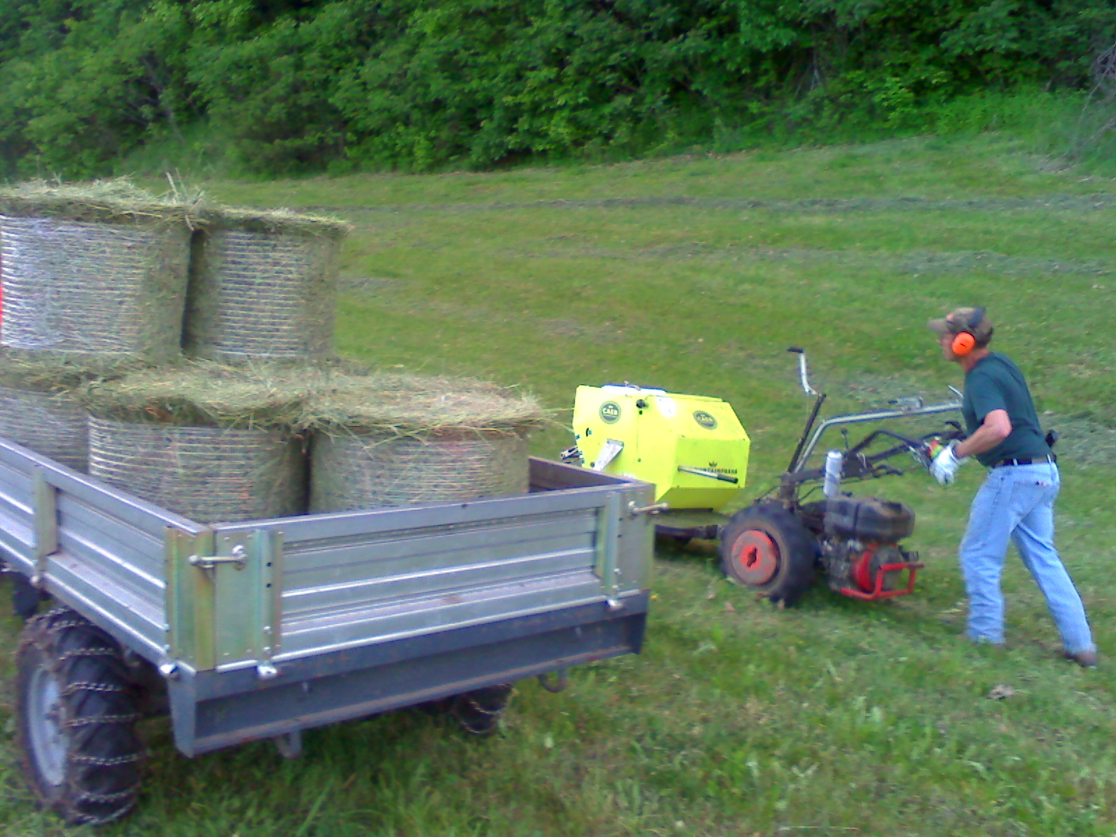

A little more about the powered wagon, rake, and baler -
The Molon rake takes a 5 foot swath and makes a 1 foot windrow. With a poor yield, you can rake in twice and out once to cover 15 feet of hay in one shot with the baler. The handle you see me holding as I am raking controls a pair of steering wheels up front - the tractor becomes a drive unit only and you don't have to hold the handlebars at all (OPC is unplugged). It's very easy to drive and does a fantastic job of getting all the hay.

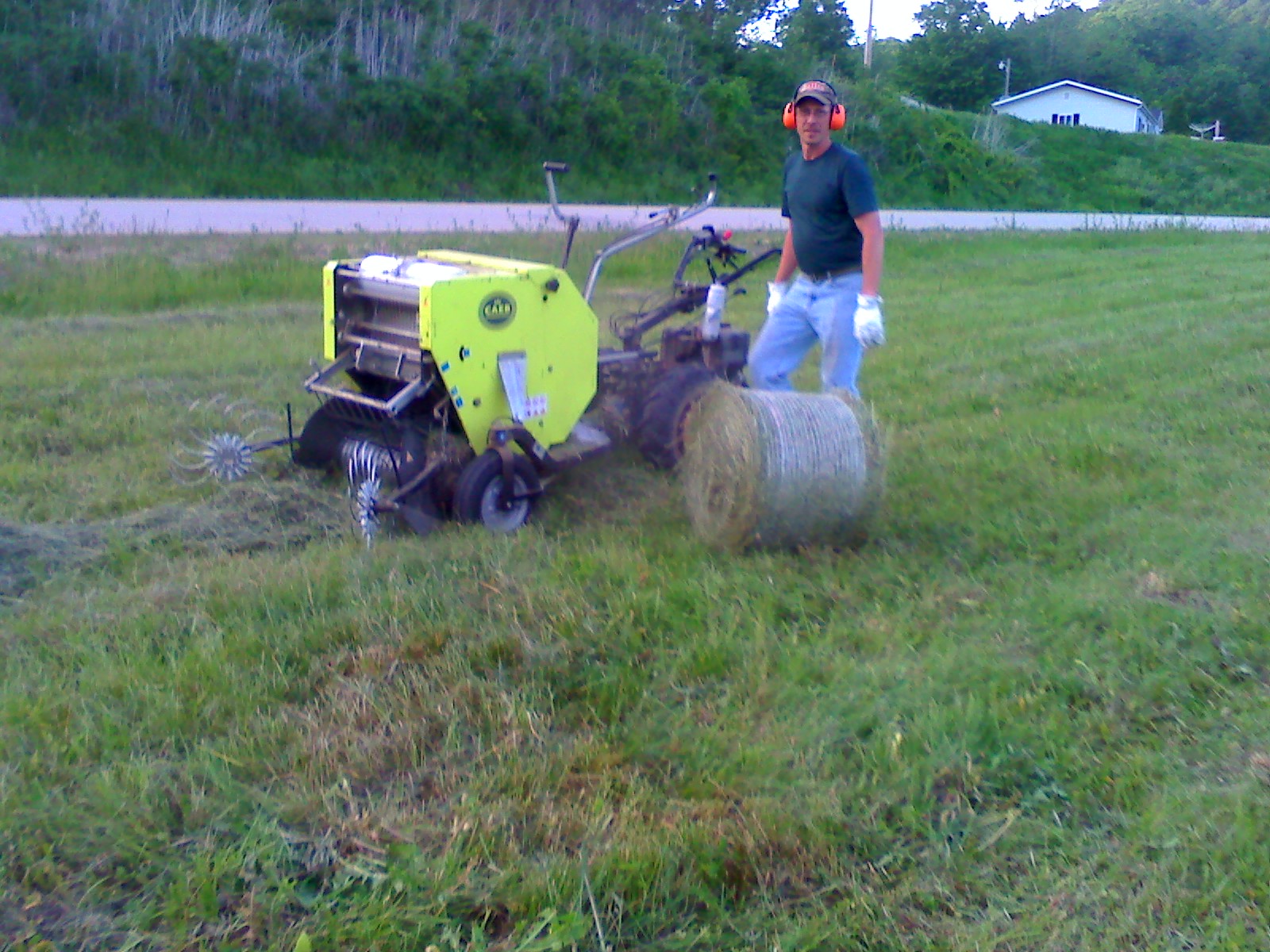

The baler is setup much the same way. I haven't run the baler because we were crunched for time to actually get the hay up and didn't need to slow the operation down by learning the baler (As it was, we didn't stop baling 'til considerably after dark). Basically, you drive the baler down the windrow until you see a knob on the side start spinning. Then, you disengage the transmission, walk to the baler, flip a lever to "wrap" and wait 'til the bale gets wrapped and the rear door pops open. The lever automatically goes back to "run". You then pull the bale out, shut the door, walk to the tractor, engage the transmission, and walk forward until the knob starts spinning again. I may not have this exact because I only watched and didn't run.
The trailer is the powered trailer Joel sells for the Grillo 131. This thing can climb a tree. It has a few drawbacks - Huge turning radius, controls aren't user friendly, slower than an ATV, a little hard on the eyes - but it is rated for hauling 2000 lbs can take that ton about ANYWHERE. With the rough terrain I could only reliably haul 17 bales with it, but could have hauled much more if it had sideracks.

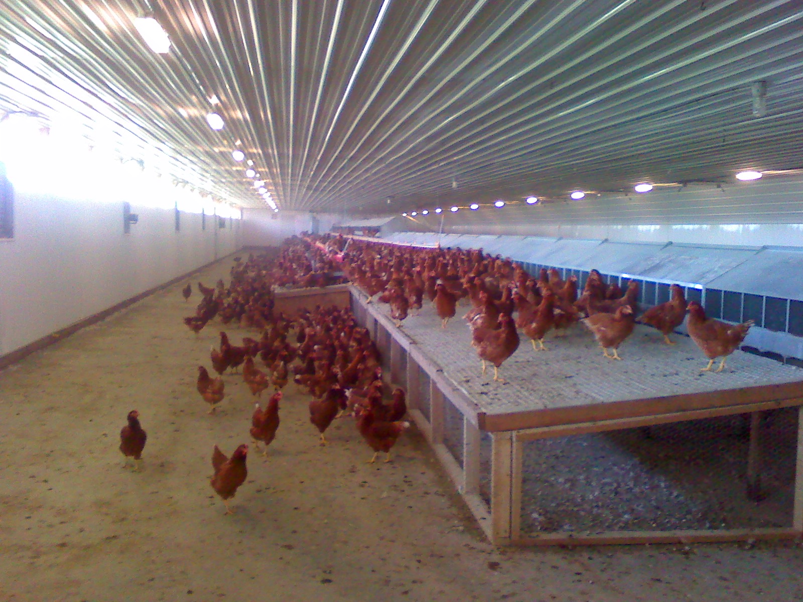

Oh, I couldn't resist. My new barn full of chickens that came Wednesday! 4800 little cluckers to make organic eggs for me to sell to Organic Valley....

The bailer can also be tripped by the first lever on the steering handle, one of us walks along and pulls the bails while the other is operation it.
We just got about 70 bales put up today. I like the wheel weights on it. Good to see ear protection, it is absolutely needed with that diesel wound up. I like to see the personal protection also. Neighbour asked my last year if I was expecting trouble, I told them if I was I'd be carrying a rifle ;)
I'm curious about a couple things: Does the rake ever throw the hay ahead of the 'fingers' that slide out to stop it? And does his bailer ever get touchy about pulling the wrapping into the chamber? Sometime the wrapper will wad up in the cutter area instead of getting pulled in.
