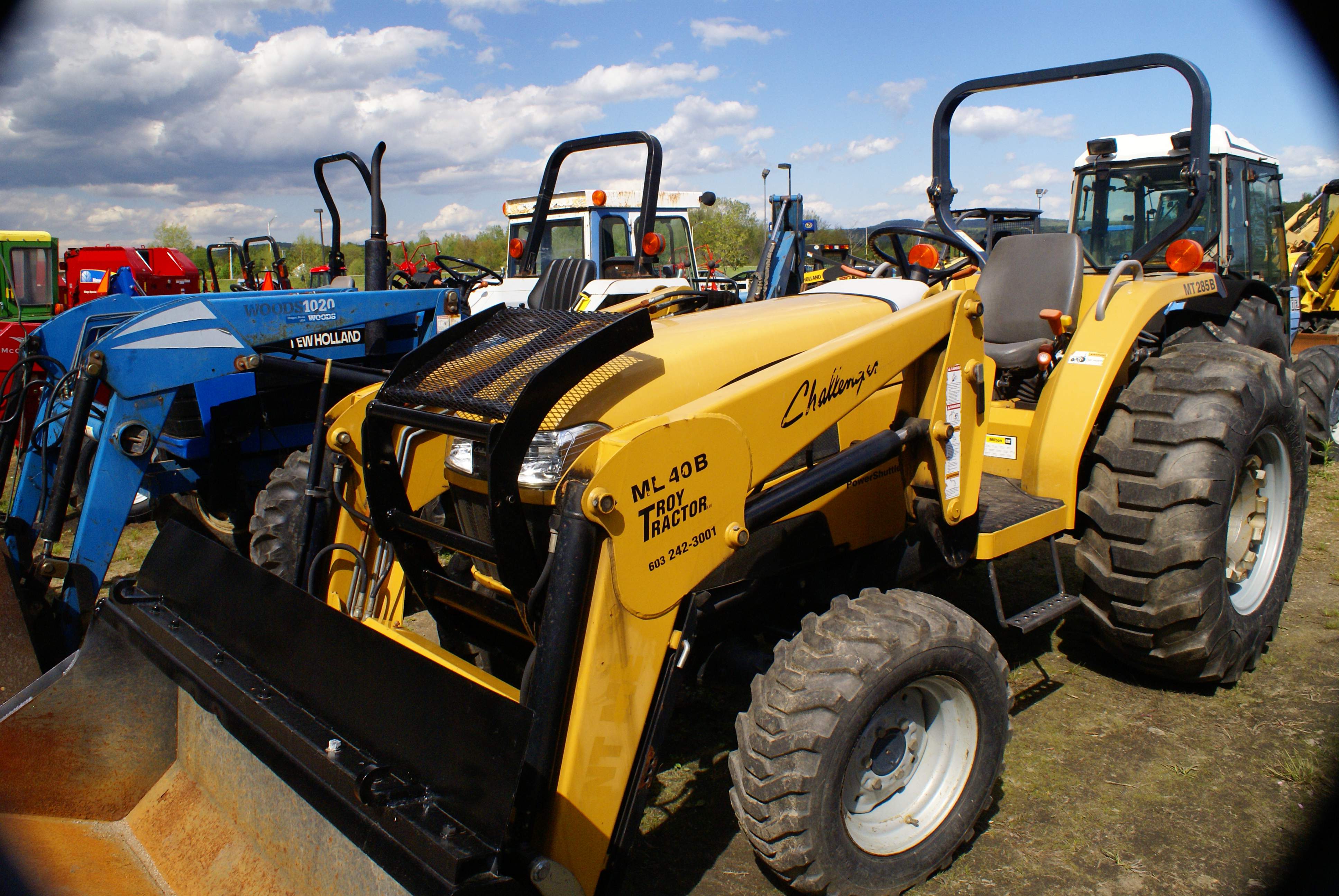

One of our tractors had been a rental in a previous life. With a real powerful loader that is not self leveling, rocks had been dumped on the hood on this tractor too. There is a hood guard attached to the grill guard that pivots forward to allow the hood to be opened. Also there is a piece of light metal on the bucket to decrease spillage back towards the operator. If you are paying attention none of these things are necessary. If they work I have attached photos to explain better.

I agree, "If you are paying attention none of these things are necessary."
Carry as low as possible, PAY ATTENTION when lifting to dump into a truck, or wherever.
I don't much care about the hoods, it is the chance of anything rolling back and hitting me in the lap (OK, in the CROTCH) that I am concerned about - concerned enough to just not DO that (-:

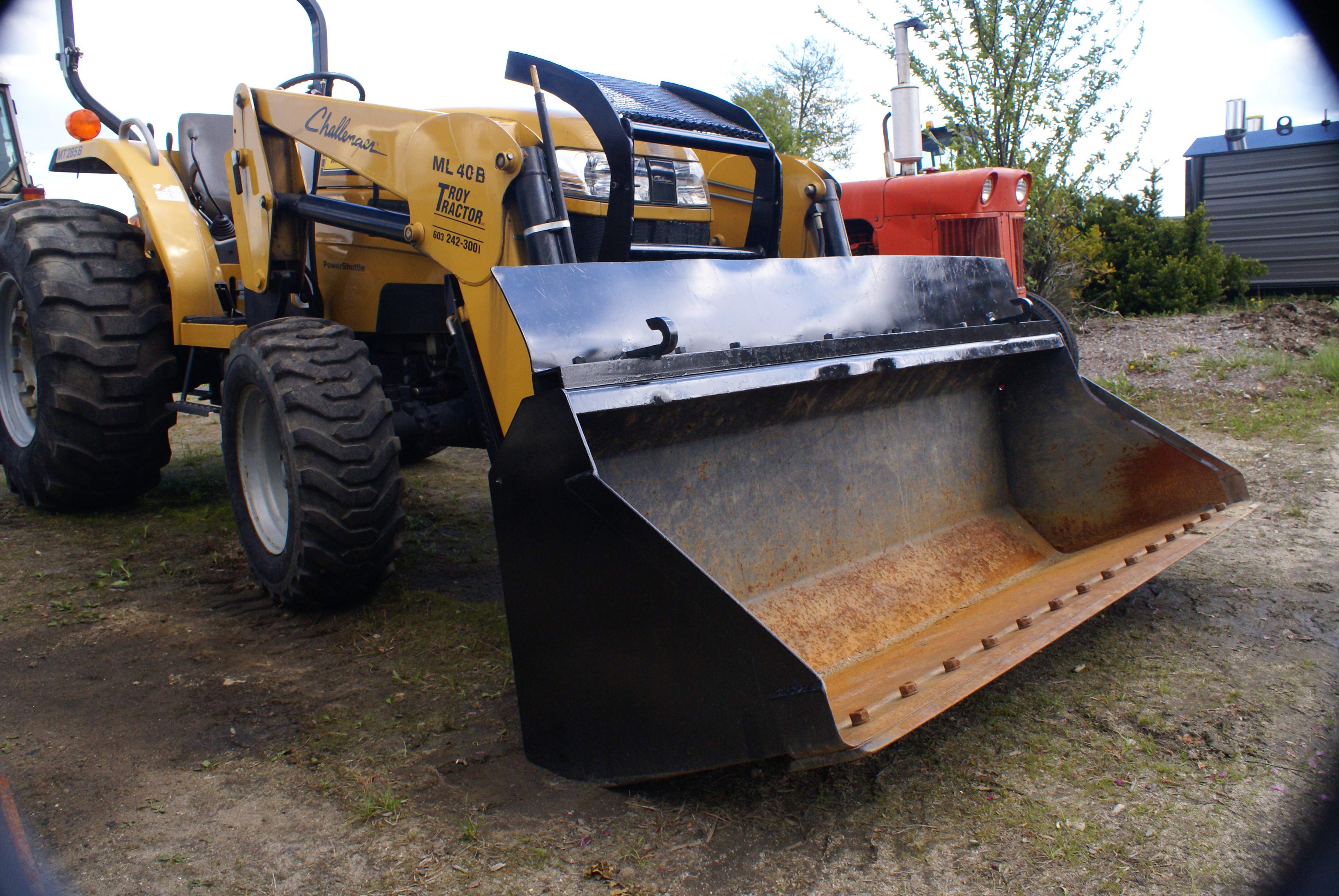

Here is one I built for my L3300. Hope this helps.
J.
Nice and simple with very clean lines. It looks like you're designing it to fold forward if need be. Good job!

Nice work, 4shorts!
Have you added an extra cutting edge under the bucket or is that factory?

Thanks! That's the factory optional edge on that bucket but when I did the mod on my snow bucket I put the cutting edge on that one. Here's the thread for that.
