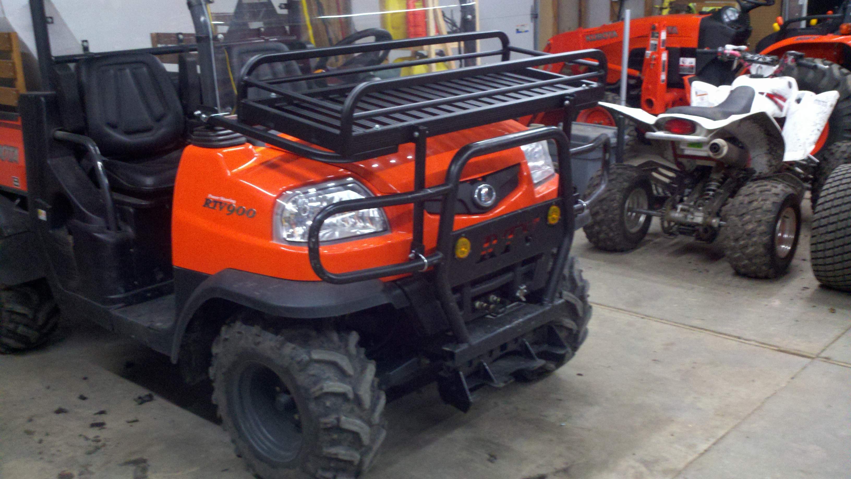

Nice pictures, good sir! Am waiting on delivery of our Kubota RTV 1140, and am shopping for accessories now, as the Kubota ones are $$$. Do you like your winch, and if so, what kind and mount did you use?
   / Hood rack for an RTV-900...
#13
That, good friend, is an el-cheapo Harbor Freight 3,000 lb winch. I worked my first one to death, and this is the replacement winch that I've had less than a week.
3000 lb. Electric ATV/UTV Winch with Automatic Load-Holding Brake
My 900 has a plate inside the grill for a winch, but I wanted the winch outside where it was easy to get my hands on it. I made an adapter plate to go between the Harbor Freight Universal Winch channel and the bumper. The hardest part was finding bits that could drill the metal that I used for the adapter plate (cobalt bits rock).
Harbor Freight used to sell a universal mounting channel for a winch, but no more :( Northern Tool has plates, but they have ridiculously high prices :mad:
You see steel cable on the winch in the photo since I had just finished installing it. I hate steel cable. It rips your hands up and is hard to handle. I had parted my synthetic line when the first winch passed away, and I'll be replacing the steel cable with a new length of synthetic when the cash flow is right again. I strongly recommend the synthetic line in lieu of steel for safety reasons (it doesn't stretch-snap-cut limbs off when it parts) and easy of use (soft on the hands and very flexible). The only cons is that it does cut, and it does melt/burn.

My Great Day hood rack showed up for my RTV900. I though I was good to go with the installation, after all, I had good pictures to work from thanks to Al.
Surprise, I guess Kubota has more than one front brush guard design, mine is different than the one in Al's pictures. Regardless, I found a way to get the hood rack installed. It took drilling new holes on the mounting brackets and having to notch the tubing where the rack support hooks to the ROP mounted receiving brackets.
Very nice rack, well made and priced right. Good value if you don't mind the little bit of extra effort in getting it installed.
