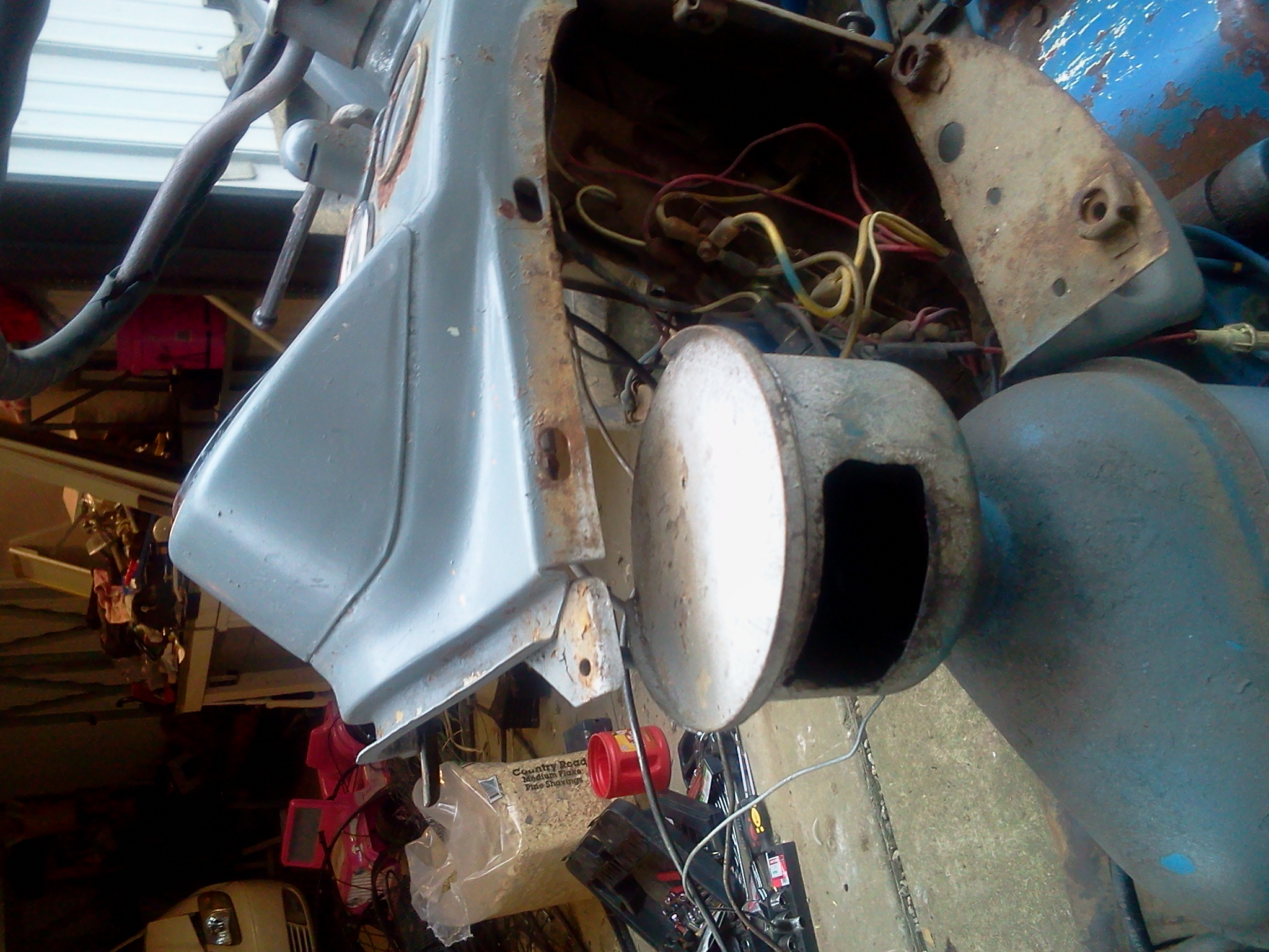

2, round hole thingy? post a pic.. not sure what you are talking about.
The round hole thingy. I'm guessing this is my air intake and there should be an air filter. There was an opening in the hood to access this. I just noticed yesterday when I was moving the hood that there may be a filter attached to that access cover - didn't look at it closely.

The filter is under that hole..:)
