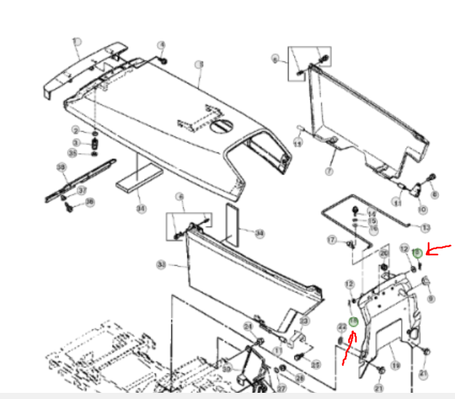

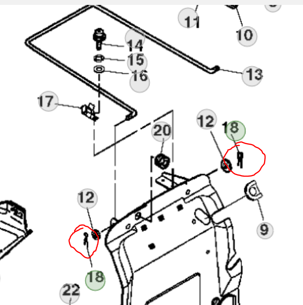

Aug 27, 2019 / Hood Removal JD 3005 #2 Zebrafive Super Member Joined Aug 5, 2010 Messages 5,647 Location South West MI Tractor John Deere 2030, John Deere 6415 It looks like you have to remove pins 18 from bar 13 Attachments 3005hood.PNG 153 KB · Views: 151 3005hood2.PNG 121.3 KB · Views: 105
