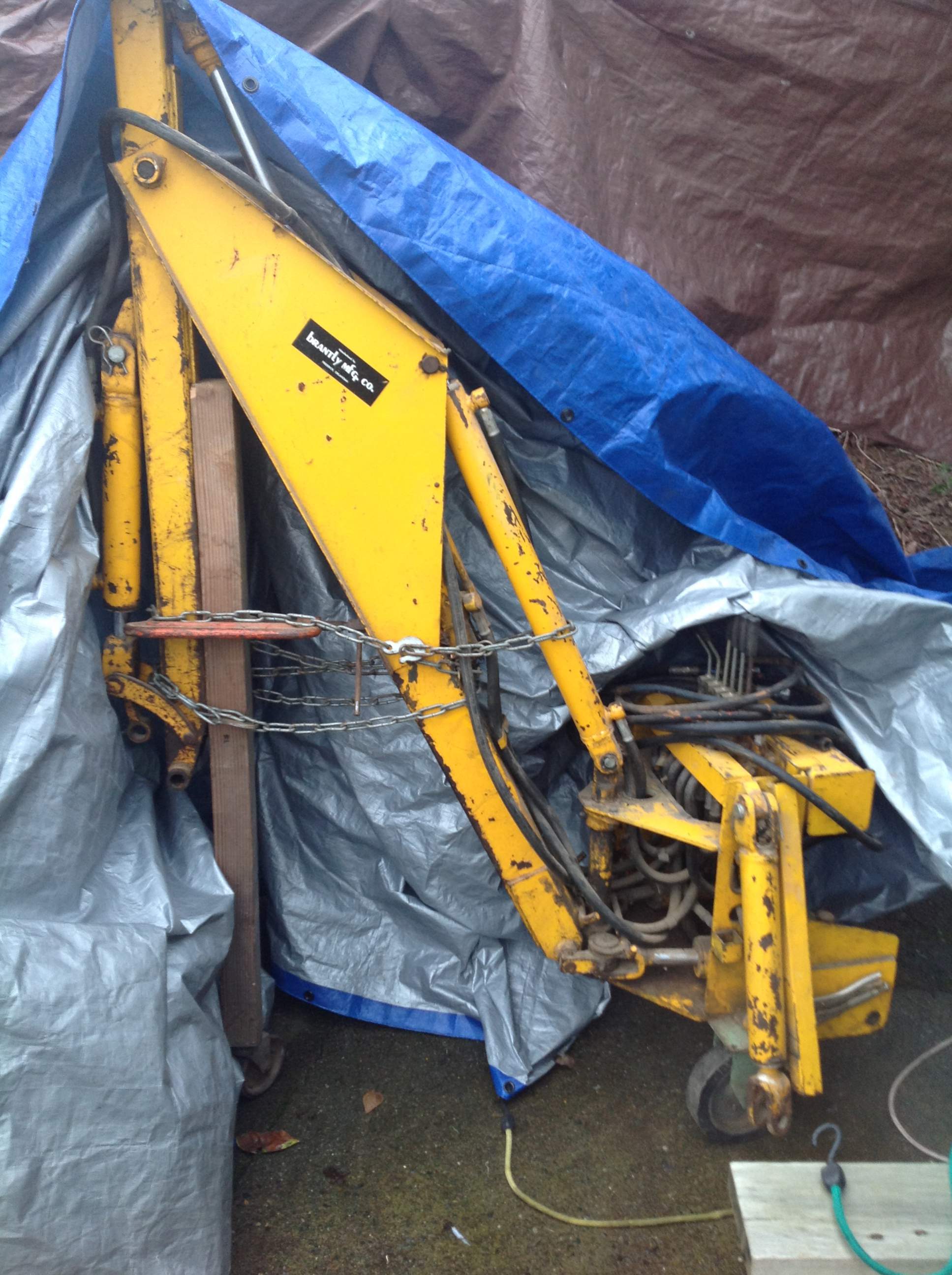

So I just picked up the following project/headache, it is an old Brantly backhoe (says model 330 MT, but I cannot find a thing on that model #) - looks to be pretty much the same thing as a Kubota 619 or 629 backhoe made for the B6000 & B 7100. It needs a fair amount of attention, but I first thought I should hook up the hydraulics to see how much it leaks - not if, but how much ;). It is old and I wouldn't be surprised if it hasn't seen action in 20 + years.

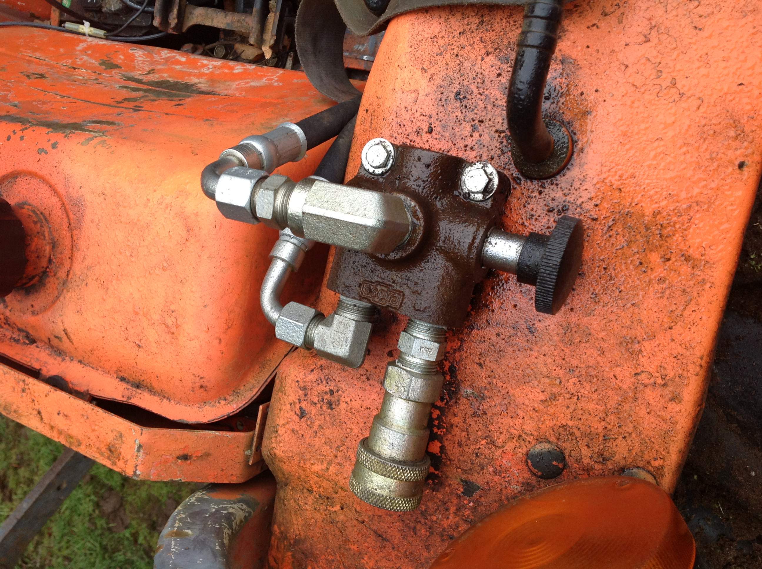

Originally it probably had a PTO pump, but no longer, and I don't have one. What I do have is an aftermarket diverter valve (I think it may be called a selector valve) on the rear of my tractor - see pic.
There is also a return line for the hydraulics on the other rear fender.
Any thoughts on the best way to test the BH (I am simply wanting to see cylinders extend/retract - absolutely no digging - it has no bucket). The best way means economical as well (so I cannot purchase a PTO pump/etc. to test).

Here is a picture of the BH
Thank you for any advice/insights you can give.

Yes, you can do as you have planned.
If your tractor can pumping 2 GPM at idle, in 30 sec, you will flow one gal of fluid through the BH.
You could install a 3000 psi hyd gage in a tee in the IN port of the BH valve and see some pressure as you check out the cyl.
The air will purge itself as you operate the cyl.
