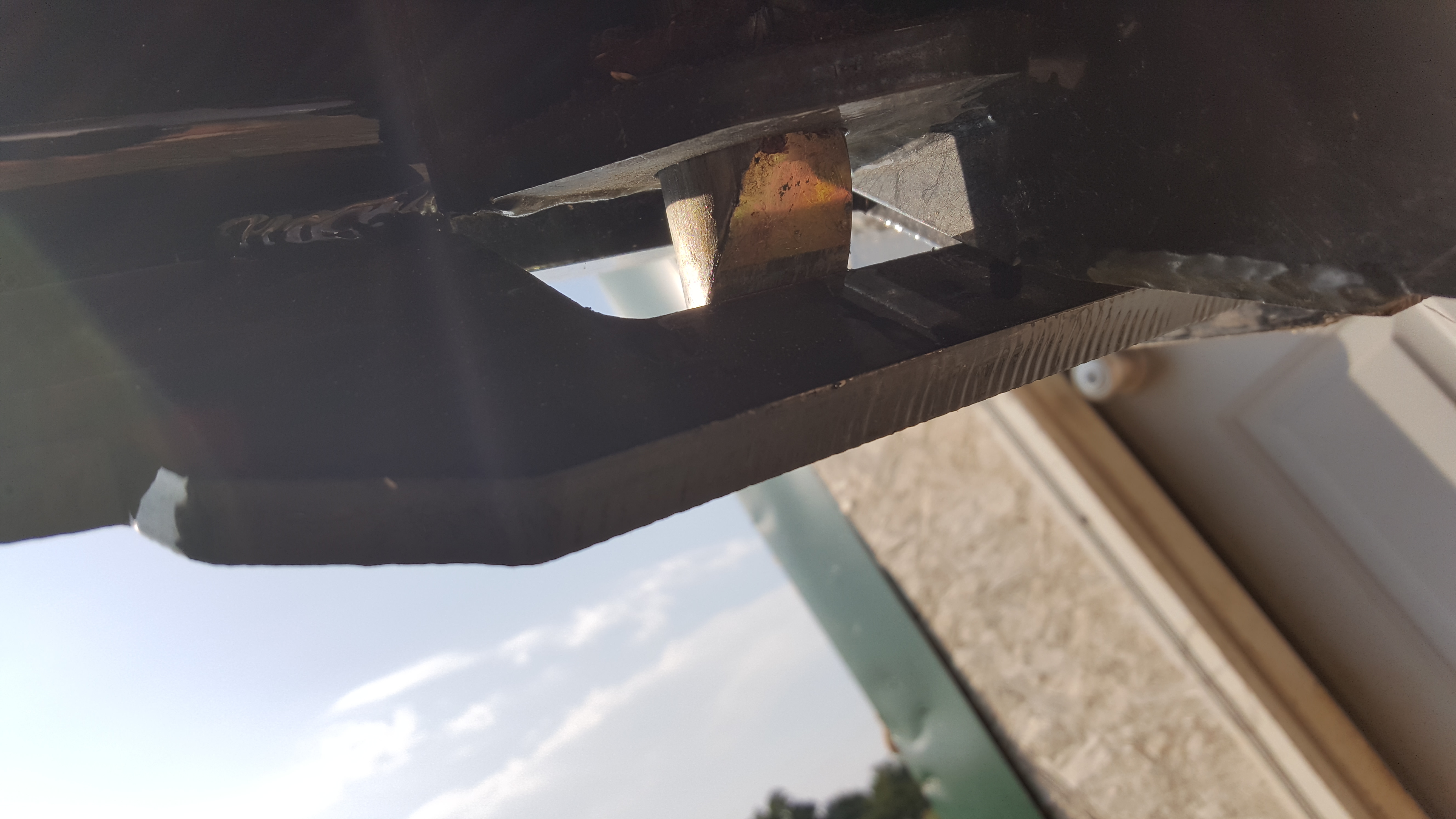

This is far as I can get them in so far, that's not all the way correct? I never looked when it was on the bucket to see how far they went down but I know the lever was farther down than it is now.
Need to keep working at it I guess?
I even tried standing on the handle and while it will move down some it is never enough to go all the way down, just comes back to where it was once I get off.

I'm thinking my pins are further in than those. Put the bucket back on and check to see how far your handles go down.

what concerns me is the lever itself, it's extremely easy to pull up in that position, where the pins could move up easy. It's like the springs aren't fully engaged or the lever cammed over or something. I may just need to take it back out of the barn and try to find some level ground and take it off and try reattaching it.

Ya, when mine goes all the way in you can feel the tension on the handles kinda release a bit but not until they are all the way down..

Okay I took a couple of pictures.

You may have the same problem I had when I bought my ssqa. The large bolt that the handle rides on was loose and was turning when I moved the handle, I had to put heavy duty thread locker on that bolt and install the bolt until it was snug for it work like it should.
/ Hooking up Attachments, Quick Connect #13
That's kind of hard to see in those pictures, a bad angle, but it looks like for sure the pins aren't dropping far enough down. I don't think that your SSQA lever is fully locking down. As others have said, you have to catch the attachment on the top channels and then roll the bucket back and maybe (carefully) kind of bounce things around a bit. There are issues with different attachments fitting various loader SSQAs, so maybe this is one of those? I know that there was a service bulletin for Kioti NXs late last year. I'd check with your local Kioti dealer if any of that could apply in your case.
