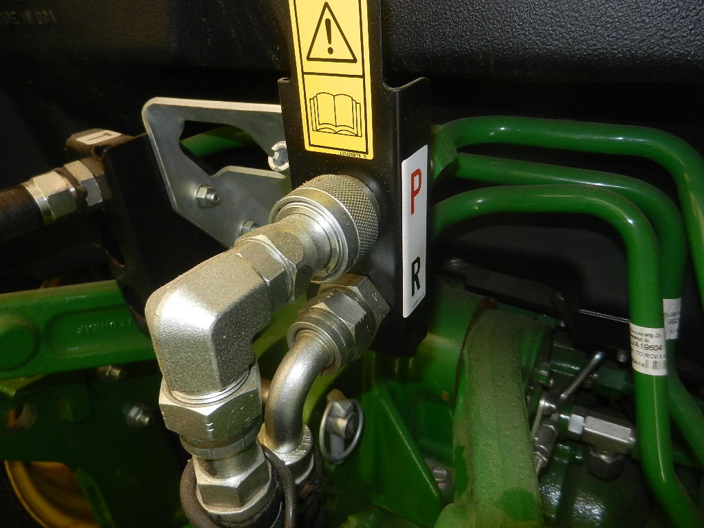

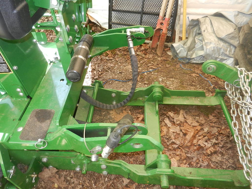

Here are some pictures. This is how machine is sitting this moment with BH unattached.
What he told me when he was trying to put it back together, is the current hose connects P and R together to make a loop. I think he said he unplugs on of those, connect it to one end of the backhoe hose and the other backhoe hose goes to "T" on the left side. (or something similar)
Evidently it is NOT as simple as just plugging BH into the ports because you have two hoses on BH and only one open port Port "T" is currently capped off.

Unplug short hose from P and let hang out of the way (put dust cap on it). Plug male BH hose into P, then female BH hose into T and you are done.
Interesting... he had taken one end of his "loop" hose and connected (I think) one of this backhoe lines to it rather than let it dangle.
I'll look into this tomorrow if it doesn't rain, thank you!!

The "loop" he disconnected is there to prevent accidental dead heading if he activates the power beyond or rear remote while the backhoe is not connected. The BH should be hooked up to the two ports that the loop was connected to. As noted earlier, doesn't hurt to hook it up the wrong way as controls will simply be reversed and you can fix that with a simple switch.
On my BH (Woods with subframe, not a JD) I need the hydraulics active in order to mount the BH. Need to be able to push down on outriggers and with bucket to line up the mounts.
The loop is there so the 3 point hitch rockshaft will operate. On the 4044 you use the 3 point hitch to lift the hoe into place & install the pins. As was stated above, the loop from R (Rockshaft) disconnected from P (power) & capped. The backhoe connects to P (power) & T (tank). The 3PH rockshaft will not operate when the backhoe is connected.

Looking at it yesterday with this thread education.... there is no way that the backhoe is going to plug into "T". It COULD plug into "R" and "P". The female plug on "T" is 1/2" deep and the male plug that goes into it is 1". You can literally feel the fittings clash metal to metal once that shoulder gets in there.
He noticed that there are different brands involved. That doesn't bother me (yet) as I would expect them to still be of the same design.
He's had it to the shop with a dash light problem about his hydraulics.... he brought up the idea/question yesterday wondering if maybe they swapped out the 1/2" fitting on "T" so they could do their stuff. I said I wouldn't expect so as they should have the correct tools or adapter (but I don't know that).
It looks like it WILL plug into "R" and "P" but as of now, there's nothing that is going to plug into "T"
