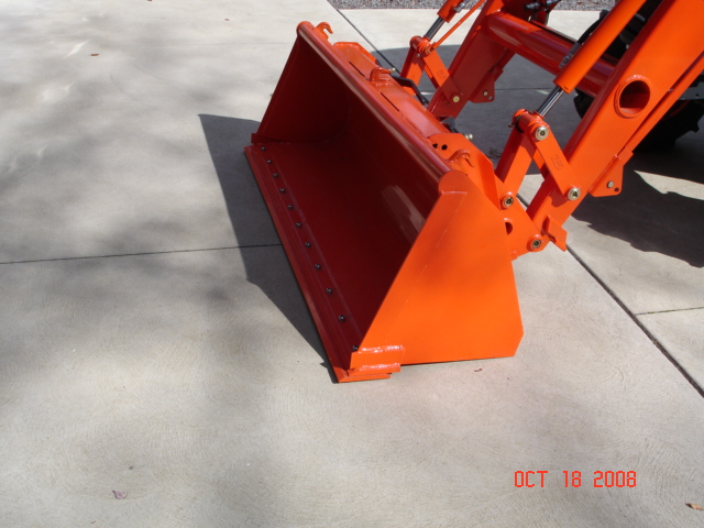

Here's some pictures of the install, including the keyhole grab links that I got from Bailey's:

I just put bolt on hooks on my bucket this afternoon - very similar to Damifino's installation. They are in line with the bucket cylinders (thanks kennyd). With a pair of "chain saddle grab links" (Google for image) it should be a very adaptable arrangement.
-Jim
I did the same thing, thanks for the chain saddle grab link idea :)
