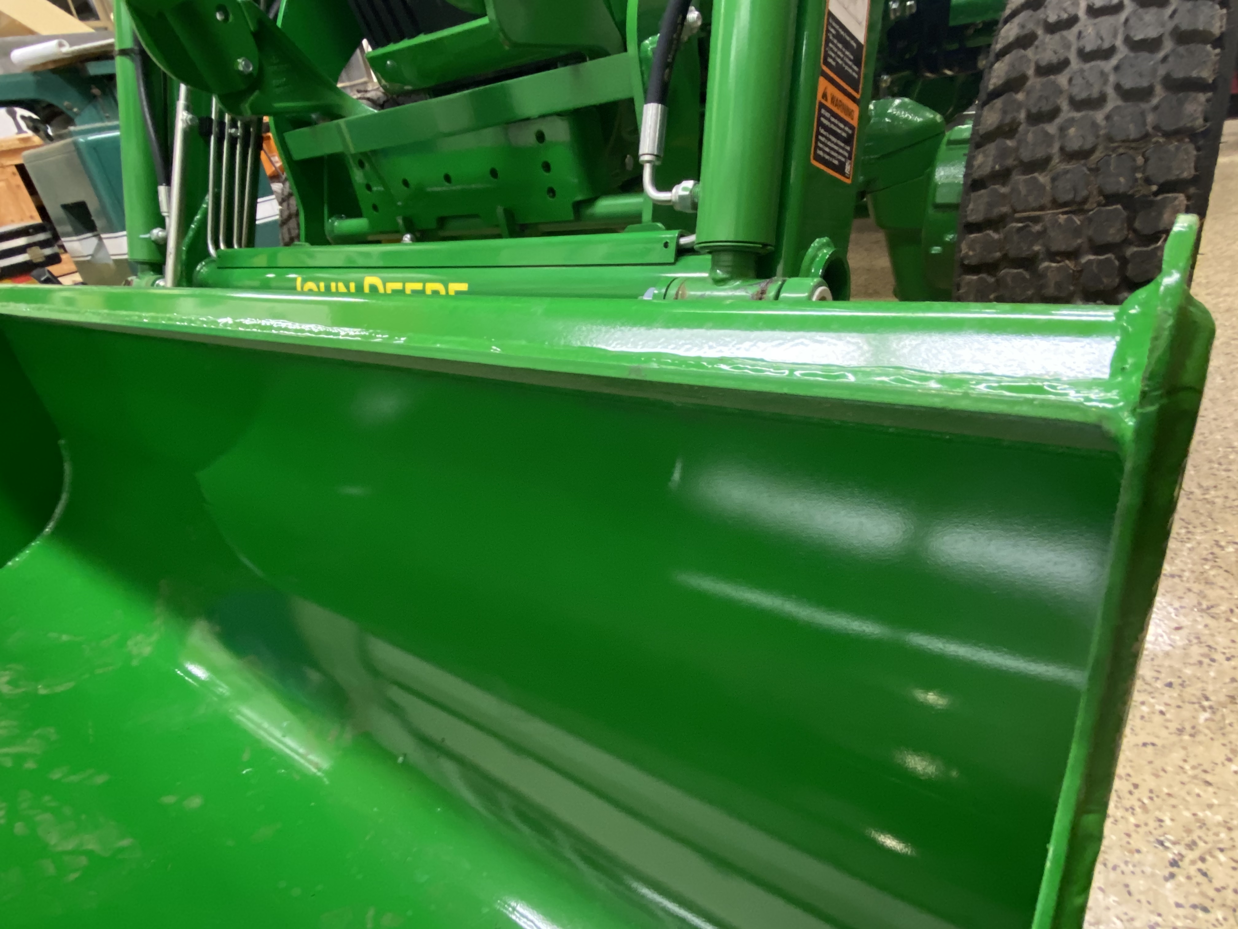

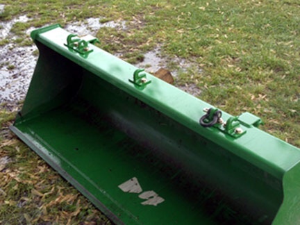

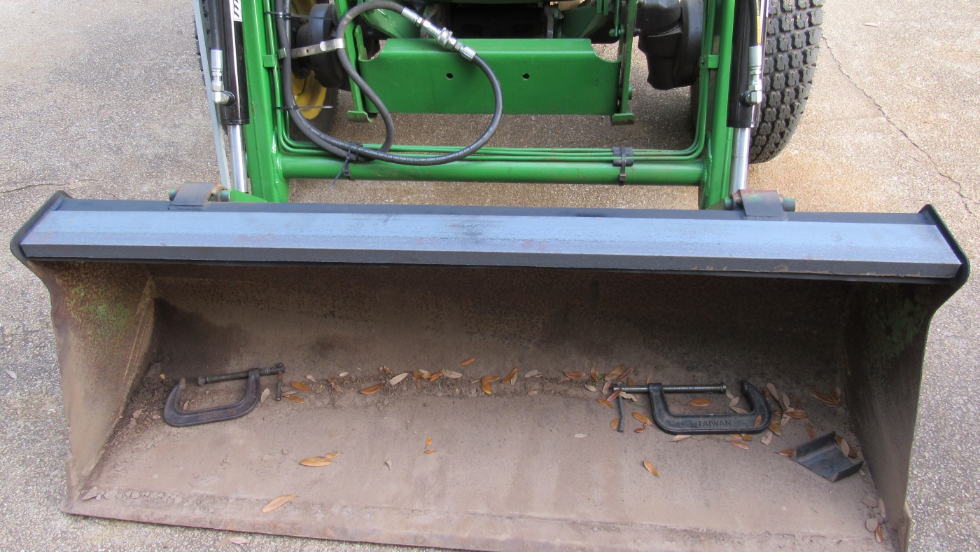

My old tractor had a chain grab hook welded atop the customized loader bucket, which I used quite a bit for skidding logs of trailers, lifting logs with tongs, etc. I’d like to install the same (maybe three of ‘em) on my new bucket, similar to this image I found online:

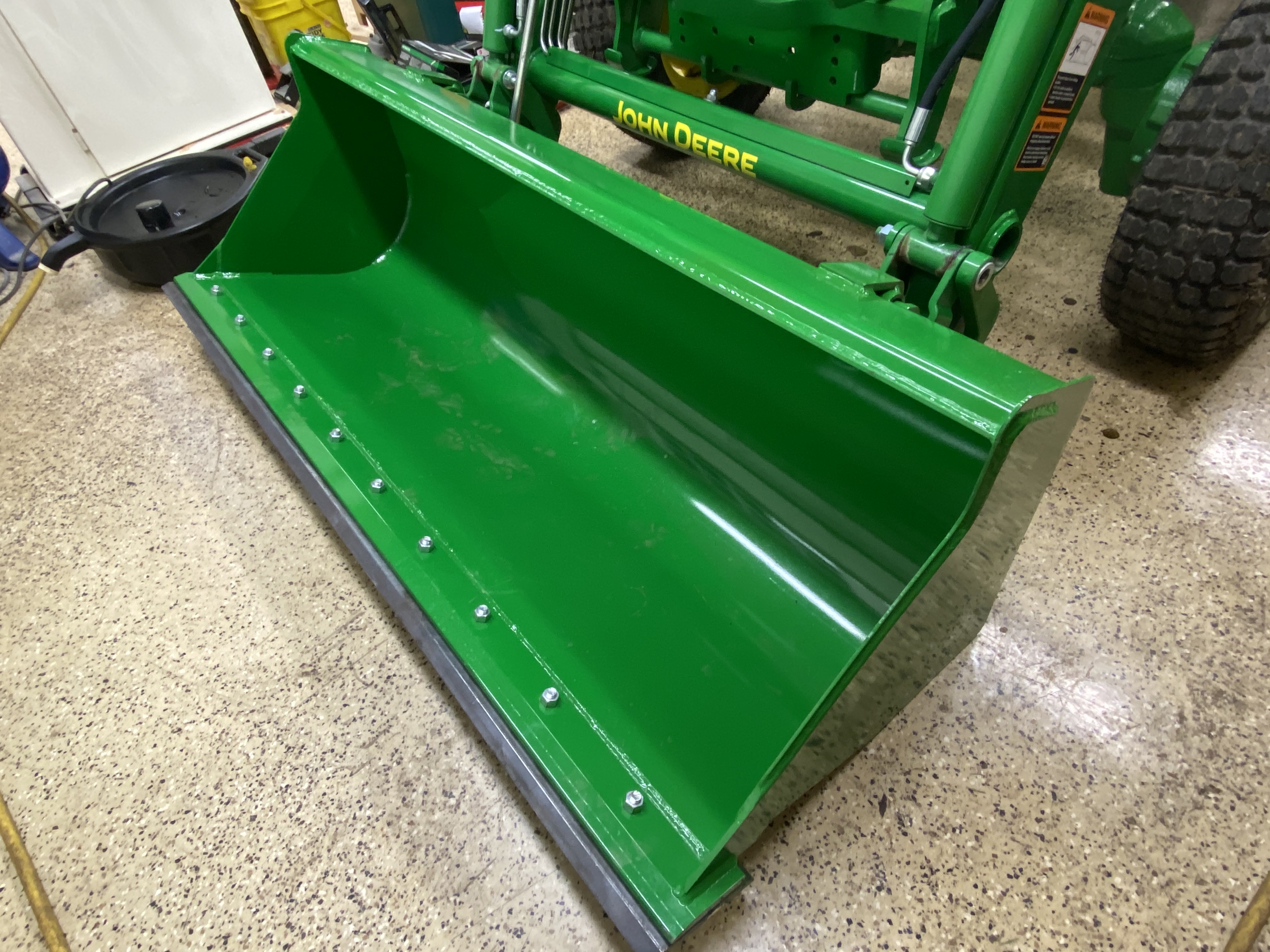

But the construction of this 61” heavy-duty bucket is a little strange to me. Deere seems to make their “HD” buckets by taking their standard flimsy buckets and welding an extra 1/8” plate under the top lip, to form a hollow channel across the top. Here’s some photos:
There doesn’t appear to be any evidence of any webbing or internal structure, it’s just a hollow channel formed by two 1/8” plates. So, if I were to use a bolt-on like shown in the stock image above, I think I’d just end up crushing or distorting the relatively thin 1/8” steel. Similarly, if I welded the hook directly to the top of the bucket, I think I’d bend the bucket under heavy use.

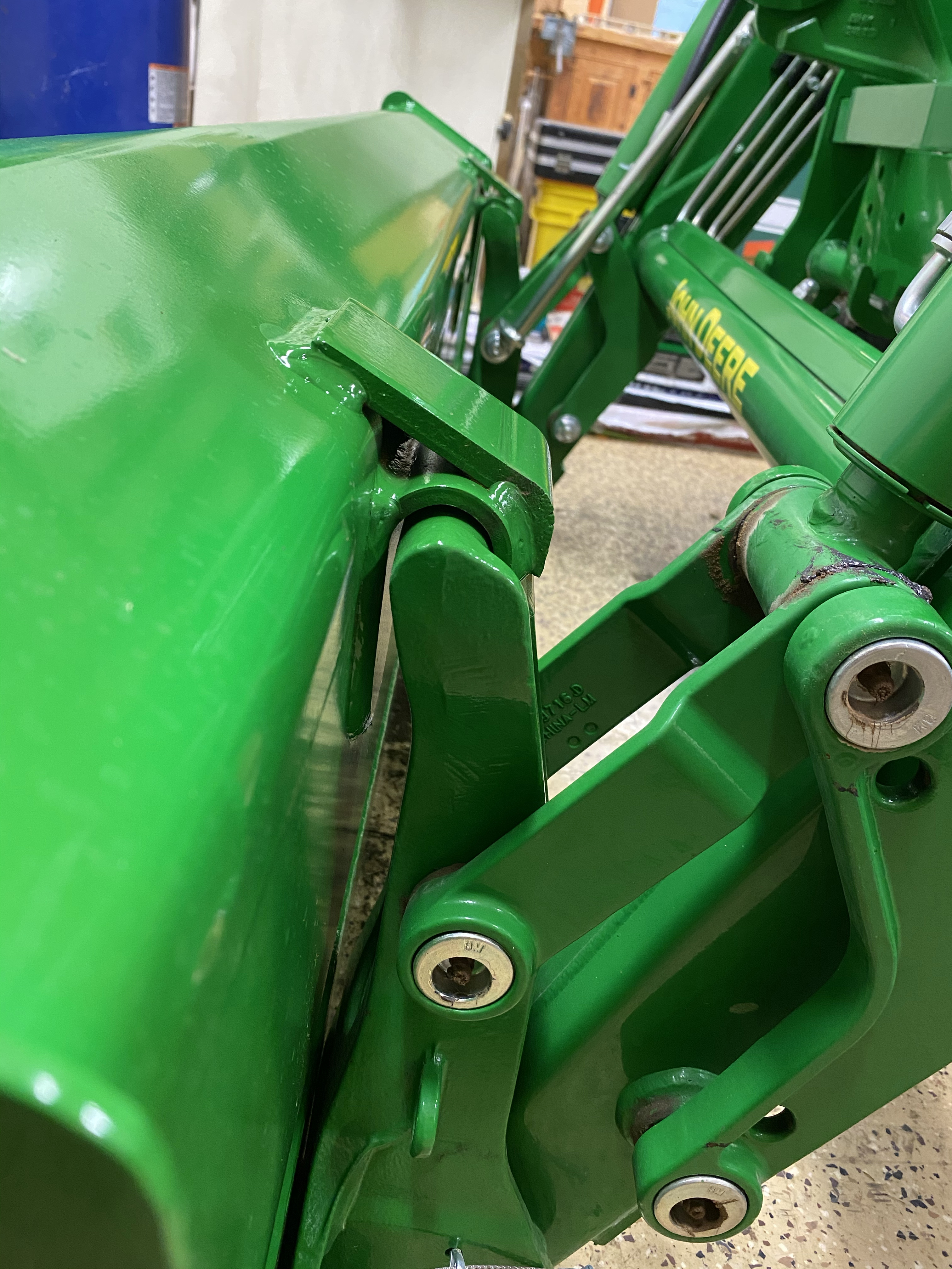

I’m thinking I could weld the hook to a plate, maybe 4” square x 1/4”, and weld that to the bucket. This should add substantial strength, lessening acute the force applied by the narrow foot of a weld-on grab hook to the thin steel of the bucket. The other option I considered is just welding it to the nice 1/4” thick tab at the top of the quick-attach part of the bucket:
Thoughts? Experiences? Opinions?
I’ve seen a lot of bolt-on options, and I’d be interested to hear from anyone who’s used one on a Deere HD bucket, but most I see are attached to their single-wall standard-duty buckets.

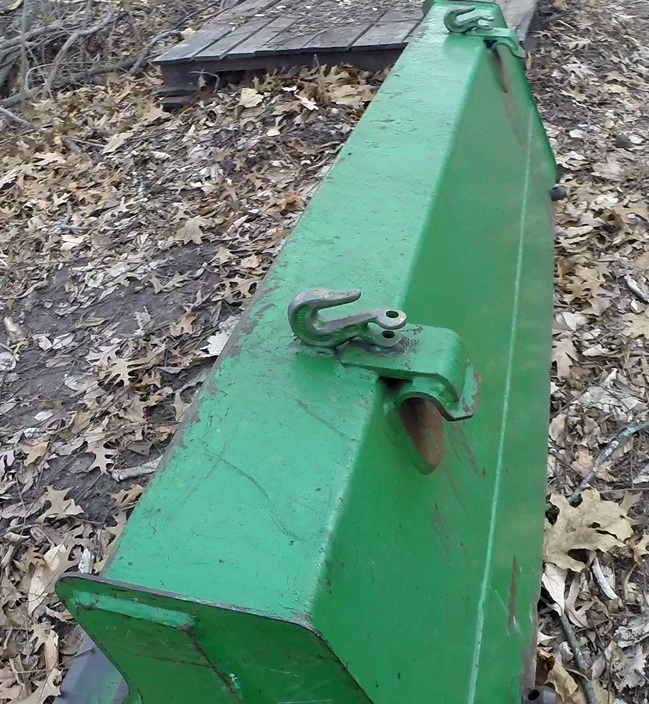

Just welded my hooks to that top bucket structure. Then don't compromise the integrity and strength of the bucket which you may need for the hooks to hold the load.
Hooks are very handy.. and use them often.

On my 61" JD bucket I took a 5/16"?? plate the width of the bucket and welded hooks like this picture except in the center I put a receiver tube for hitch balls or loops or hooks or whatever else goes in them. Works great.

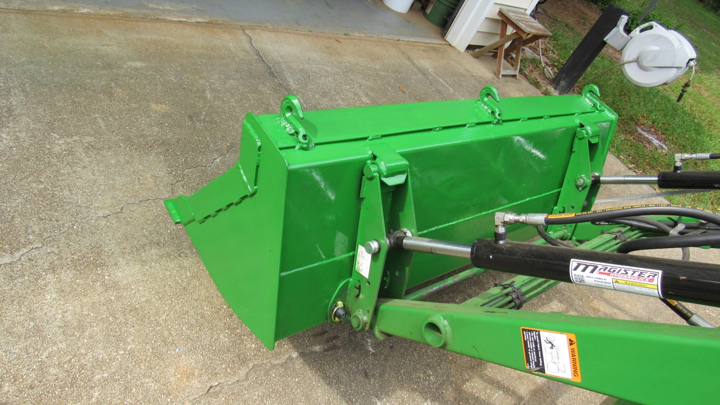

I bought the bolt on hooks from TSC. I picked them because they are bigger hooks so works with slings and not just chains. Titan makes a bolt on hook for chains that is not a slip hook.
Either way, drill your hole thru for the bolt, then drill an oversized hole in the top and make a crush sleeve. Weld the top in, and good to go.
I also added a ball to the center. Just welded on a reinforcement plate with a crush sleeve and bolted the ball right to the bucket.
I’m glad you posted this, as this is exactly what I was working out in my head, but hadn’t quite finalized the plan myself. I think this plan offers the best of both worlds, bolt-on convenience and flexibility, with the strength of tying the top and bottom of that plenum together that makes the top of the bucket. With some masking and care, I think I could probably even do this without even messing up any paint that will show beyond the bolt-on base, not that avoiding paint is my only goal.

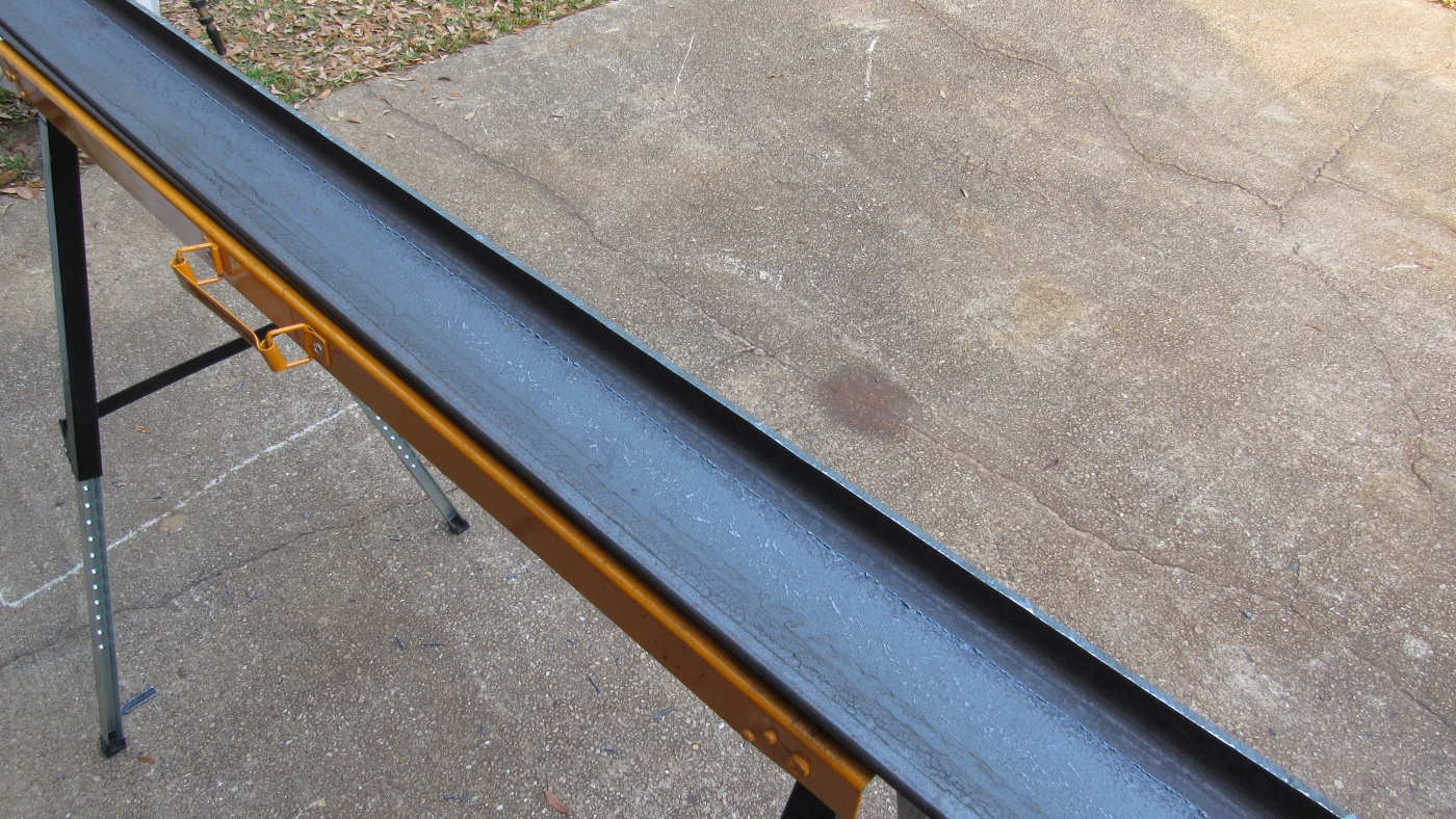

I converted my light duty bucket to heavy by welding 1/4" on top and sides. Then I cut one leg off some HF hooks and welded them on the top.
I had a 5' piece of 4x4x1/4" angle. I cut one leg off with a plasma cutter and left about 3/4" of the leg on.
I laid it across the top as shown here, clamped it down and welded it.
I used pieces of the leg I cut off to reinforce the sides like comes on the JD heavy duty bucket. Then welded on some forged HF hooks.

Took a pic of my welded hooks..
