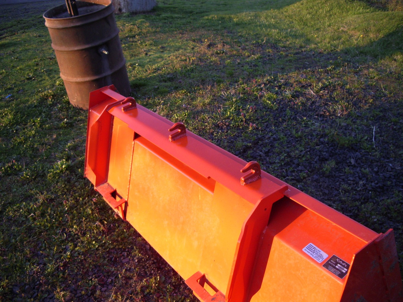

Where is the most useful place for some hooks.. I picked up three last night, figure on the bucket. Just looking for some opinions...
/ Hooks.. #2
Maybe place 3 hooks on the bucket...one on each end & one in middle...always good to have hook for the rear.

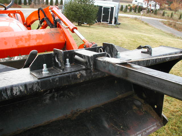

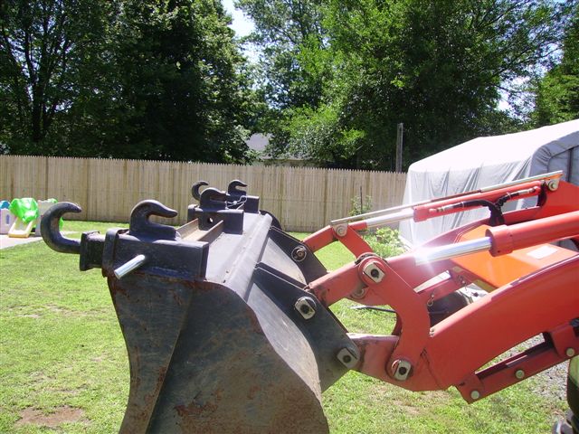

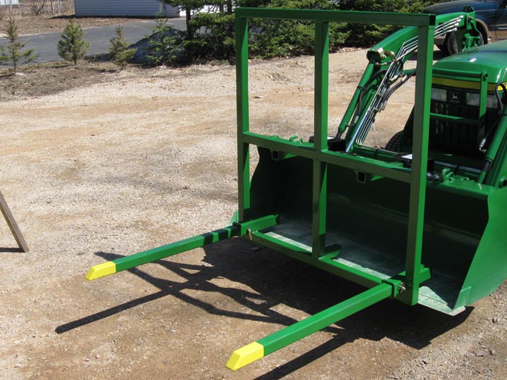

/ Hooks.. #8
I would suggest welding an additional 4 x 4 1/4 plate and welding the hooks to the plate. I believe that two hooks on the end, and a 2 in receiver on the center top, for those extras. Boom pole, hay spears, ball for moving trailers, etc. If you do a search for hooks, and receivers, through the post, there are lots of examples.

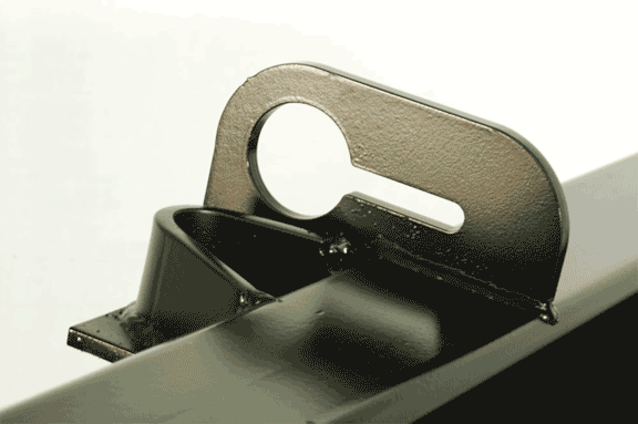

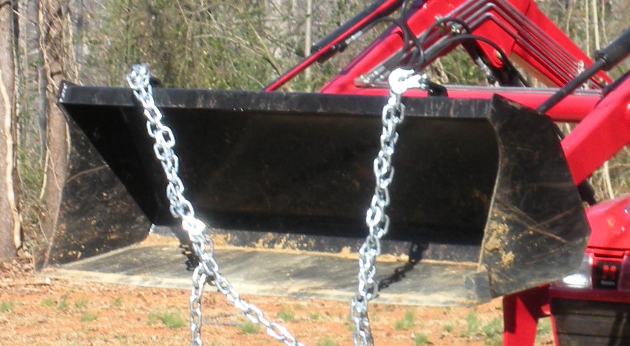

/ Hooks.. #9
Please do not weld on the outer edges of the bucket... Best placement for strength is inline with the loader arms. Placing at the outer edges could leave you vulnerable for uneven loads to twist your loader or bucket into an uneven position. See placement. We use a self-locking chain hook.

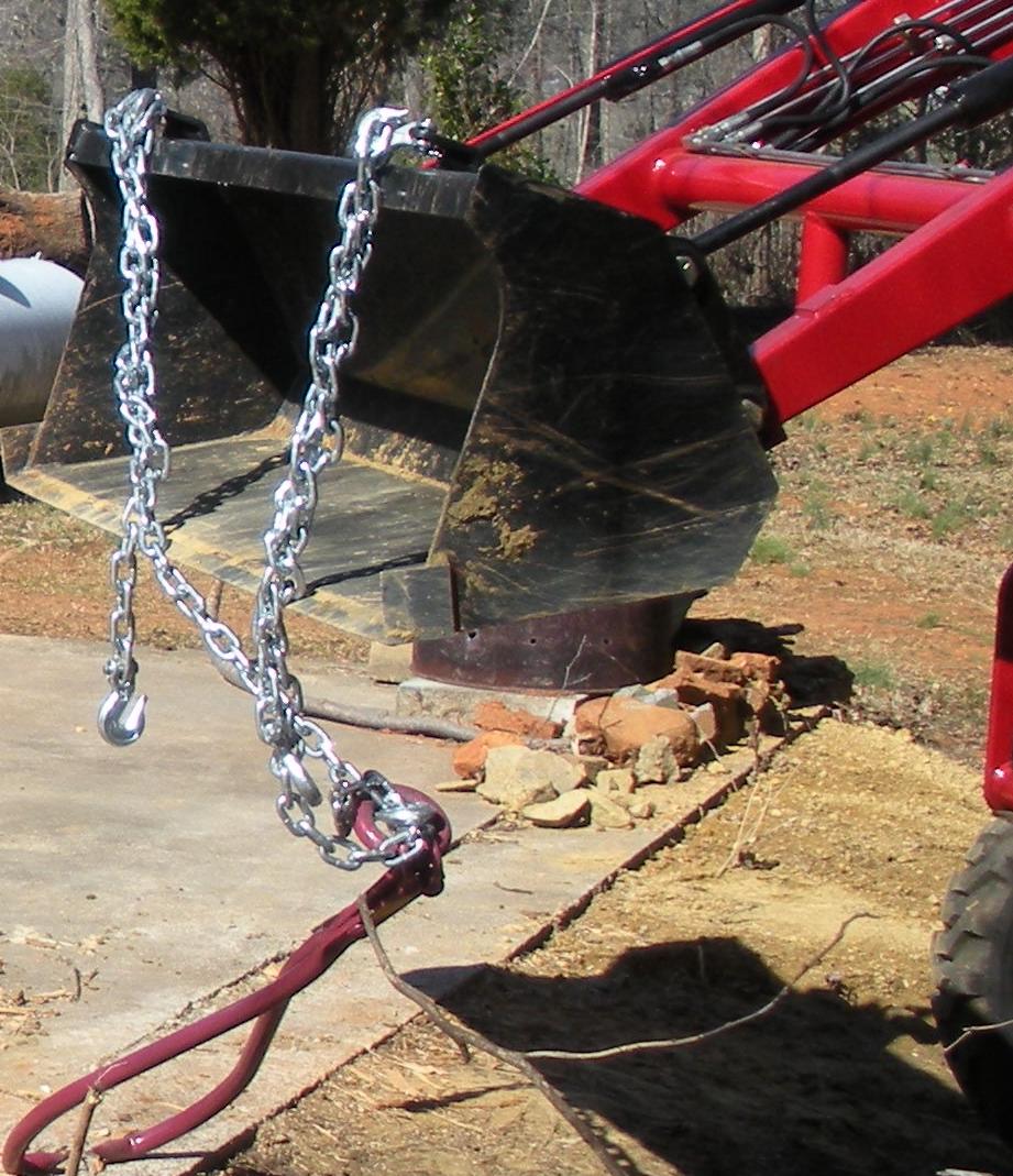

/ Hooks.. #10
I welded my hooks even with the arms. I made the hooks able to swivel. I was kind of worried at first that they may not be strong enough. But they have not let me down yet! These are not the best pictures but it's all I got right now.

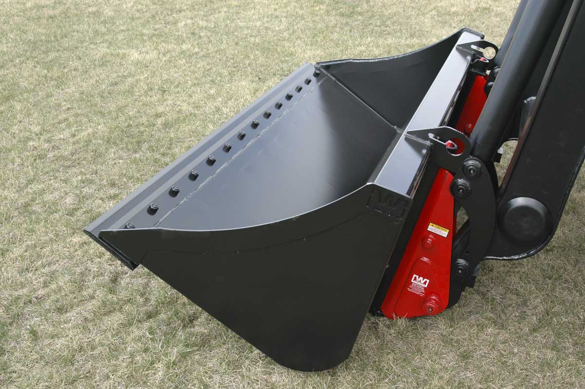

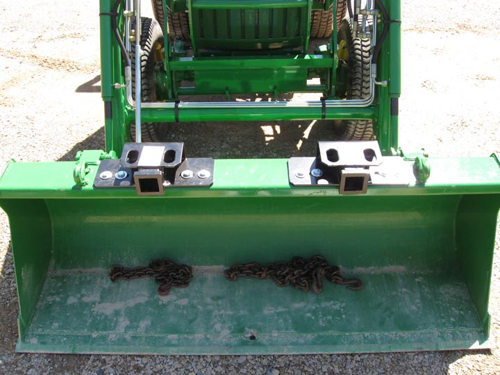

/ Hooks.. #12
I have two hooks, one inline with each arm. I also have two receivers for other attachments if needed.

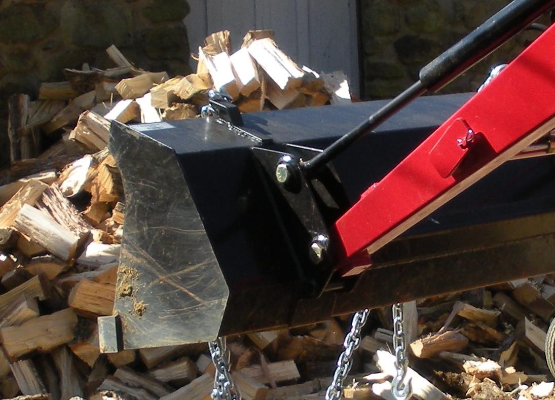

/ Hooks.. #13
I welded three on - one over each of the QA arm attachments and one in the middle.
