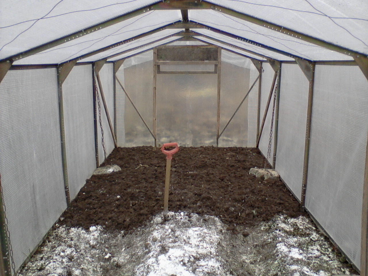

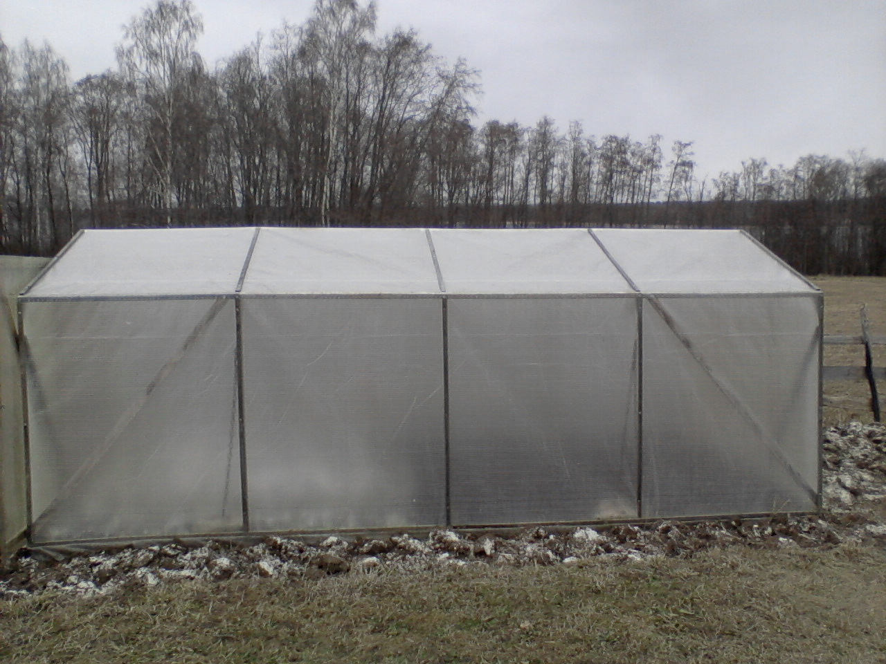

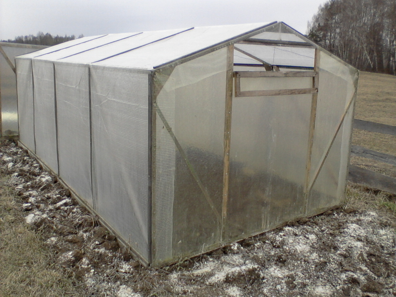

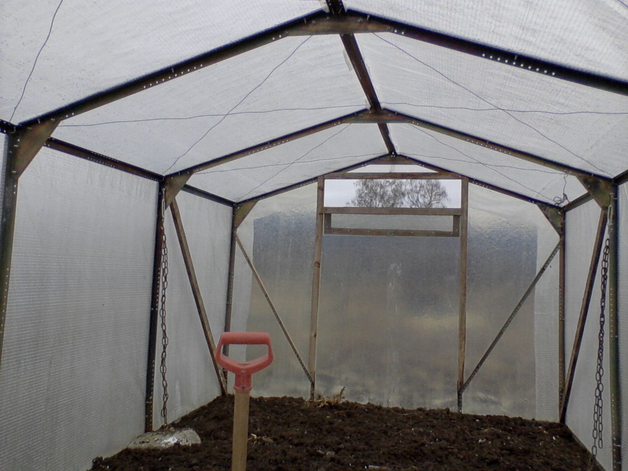

The idea of my next spring hoophouse project is, that it could be shifted to any place of the tilled soil. The weight will be so that 2 persons could lift it and easily carry to the place required.
This hoophouse will provide our family by greens.

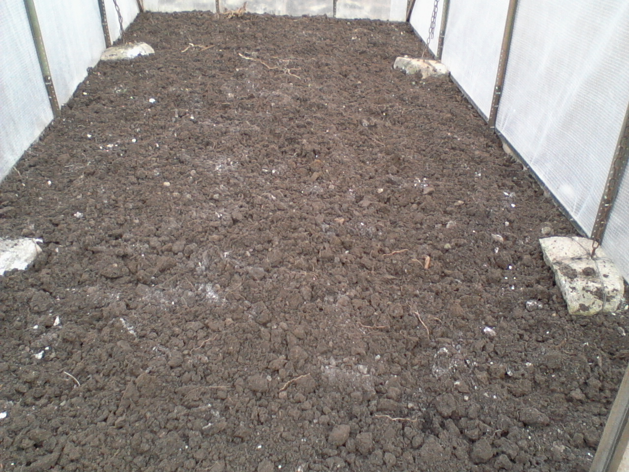

I probably had to share realization of the project last spring, right after it had been finished. But I thought strong wind or hurricane (sometimes we have the wind speeds up to 45-50 mph here) will bring the hoophouse away and there will be nothing to post a message about... :laughing: But thankfully that didn't happen. Our hoophouse survived and it is prepared now for the second season planting. Hope the four anchors (peaces of concrete fixed by chain inside a hoophouse) did their job to prevent the construction from being blown away. :D
Right now it is sowed a few kinds of greens inside and waiting for the tomatoes to be planted. The soil is warm comparing to the outside, where the ice is still available in the depth of 7-10". White sprinkle is the lime, which I have inserted into the soil. Green grass unavailability around the hoophouse shows the conditions at the open air are still not friendly enough. It's about 32F.

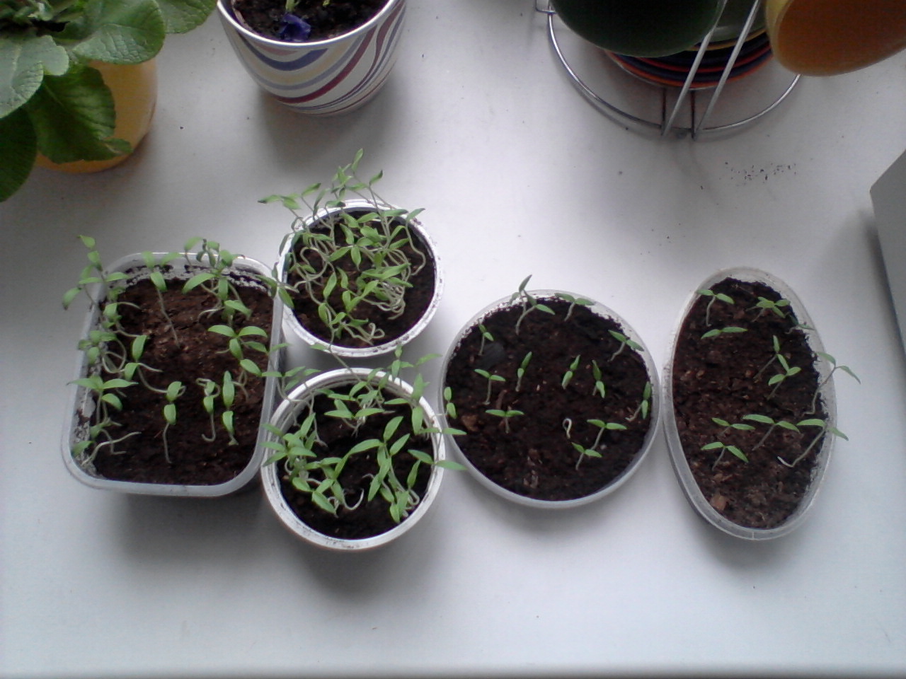

There are 5 kinds of tomato seedlings (shown in a pic) growing on a kitchen's windowsill currently. Their age is 6 days. Soon they'll be separated into individual pots. When they'll reach the height of about 1'-1.5', they'll be replanted into a hoophouse.
Can't wait to feel fresh taste of tomato ... :licking:
