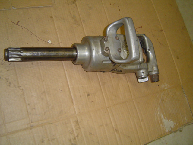

Got the 1 inch impact from a tire shop calling it quits. Useful for things like brush hog blade removal.

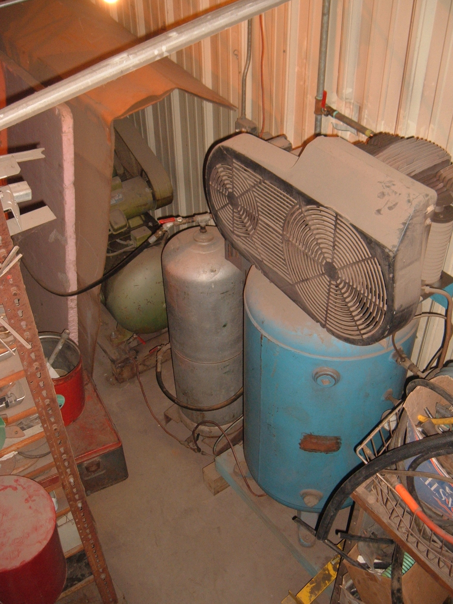

I have the pressure where it was set at factory, this is part of 2 stage design. Using the tanks
to deliver the volume. I can make 28 but keep it live from a comp makes 12, 3 hp, what they call a mechanics compressor. Big tank, off at 175, on at 130. The system will deliver as much as you wanna let out till it kicks on during this stage regardless of comp size. Makes about 1/2 what the tool needs as its running, tanks supply the rest.
