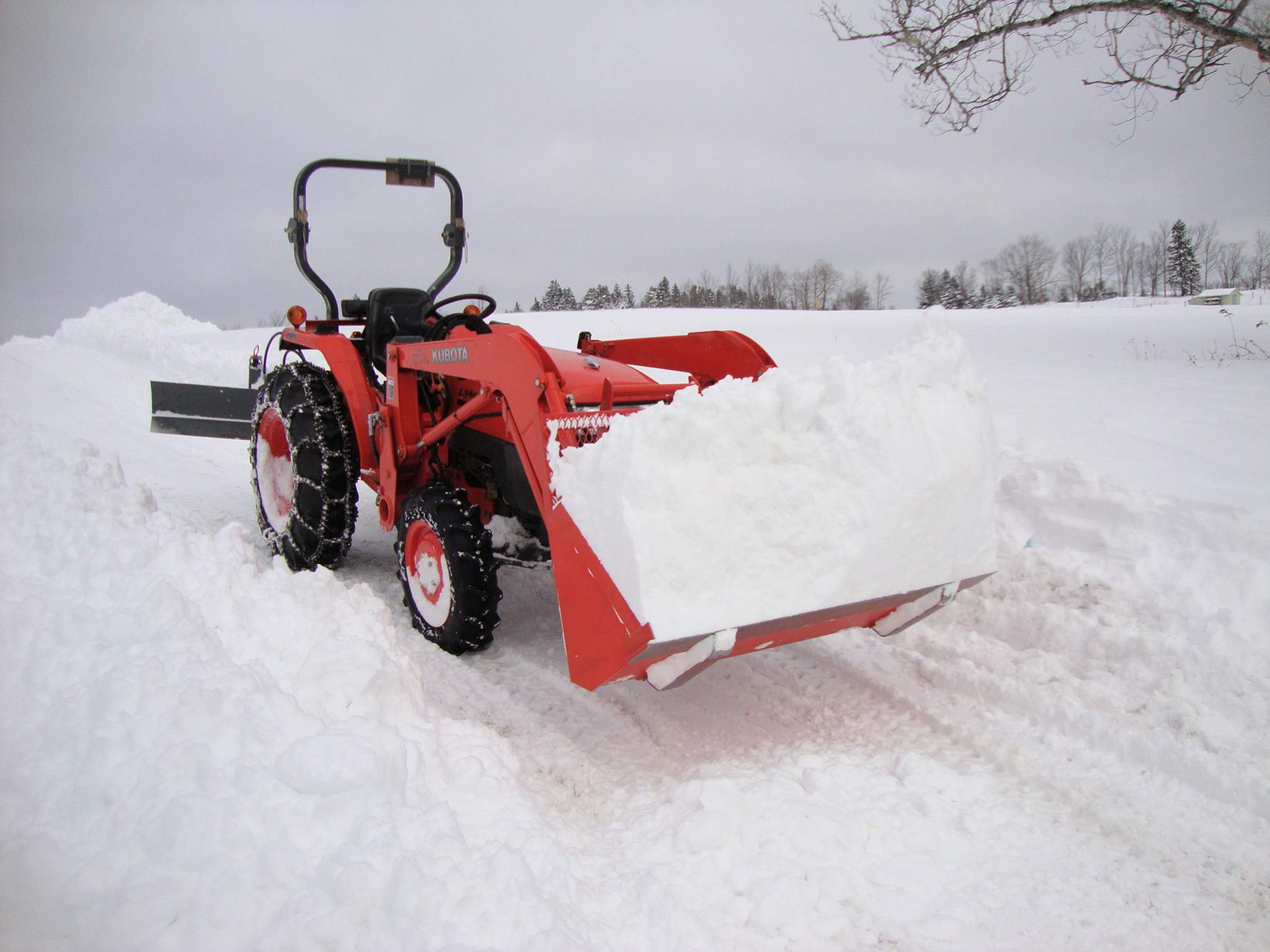

I think you'll do fine, although you may want to look at chains and something to keep the bucket off the ground if you need to use it. The rear blade will try to swing the tractor around if you angle it much in deep snow.
I find mine's ok for up to about 10 inches of snow, beyond that it calls for punching through with the bucket first.

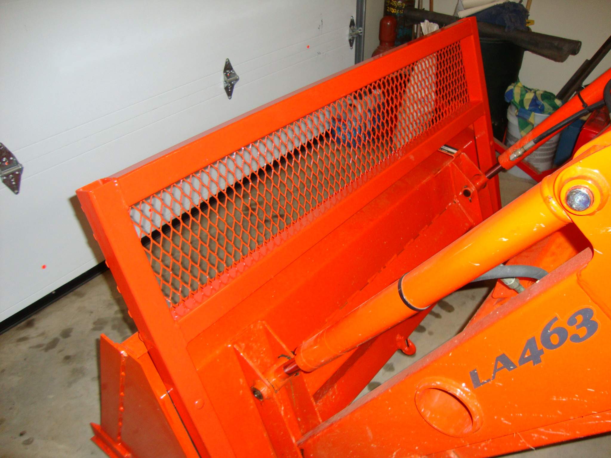

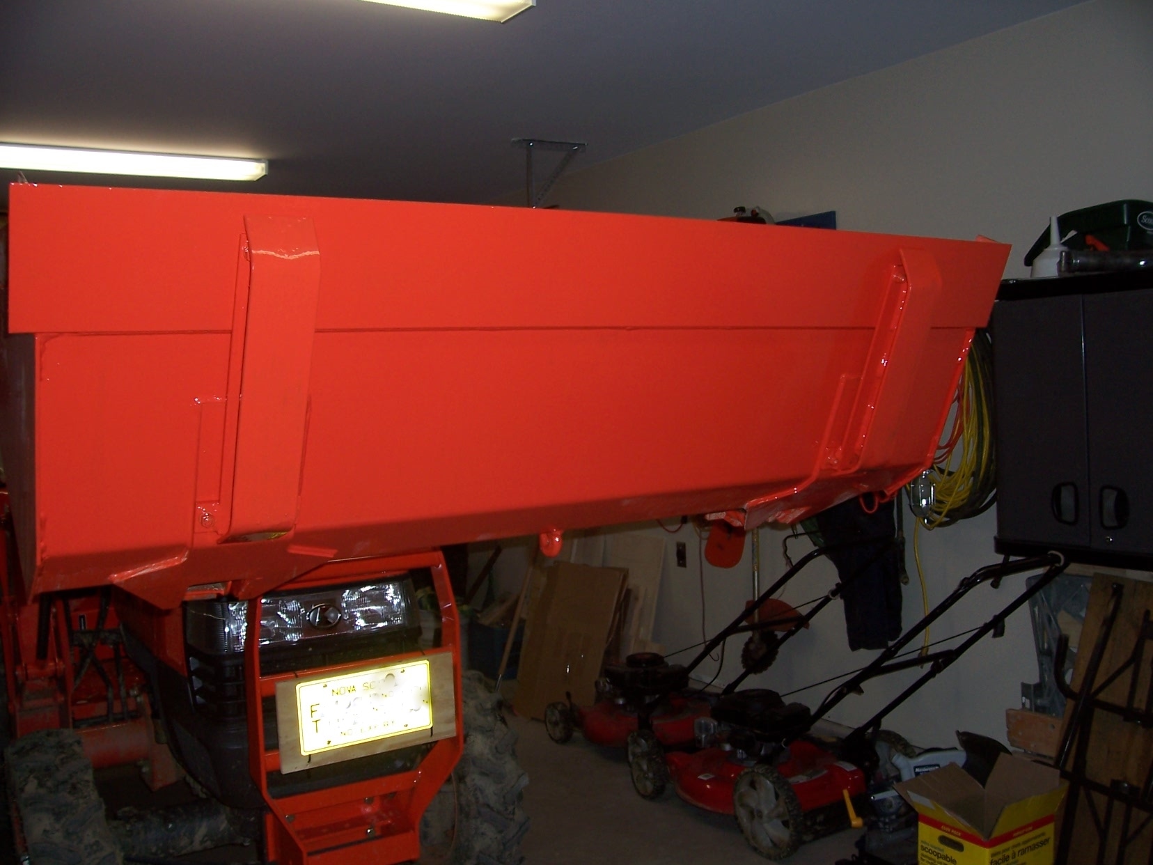

I built a screen to keep snow from spilling back over the bucket, and skids to keep the bucket from scooping any gravel.

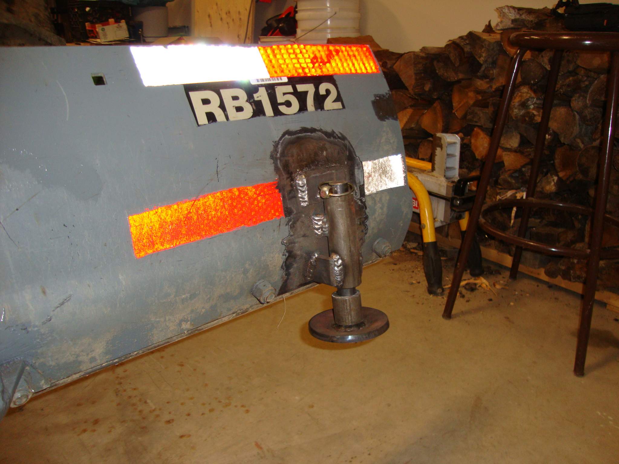

Chilly807, I just have to bug you about this again. :laughing: You paint your bucket after the modifications, ( which look great by the way) but you leave your rear blade primer grey. You really need to paint it either black (what the OEM color would be) or at least Kubota orange. ;)

You'll be glad to hear I repainted it yesterday for the winter season. It was worn off from a summer of moving rock and soil, and the first snow we had stuck pretty badly.
Oh, did I mention I found some more grey paint? ;)

OK, so why did you paint your bucket orange when you have all this grey paint? :laughing: At least you keep yours painted, mine is bare shiny steel right now, probably be some rust on it by this weekend. :(

My bucket gets pretty ratty over the summer months, the bottom was the same as yours until last weekend.
We get road salt over the winter months, it's pretty hard on bare metal. I try to get at least the thin parts covered up before snow flies, and the snow slides off of paint better too.
