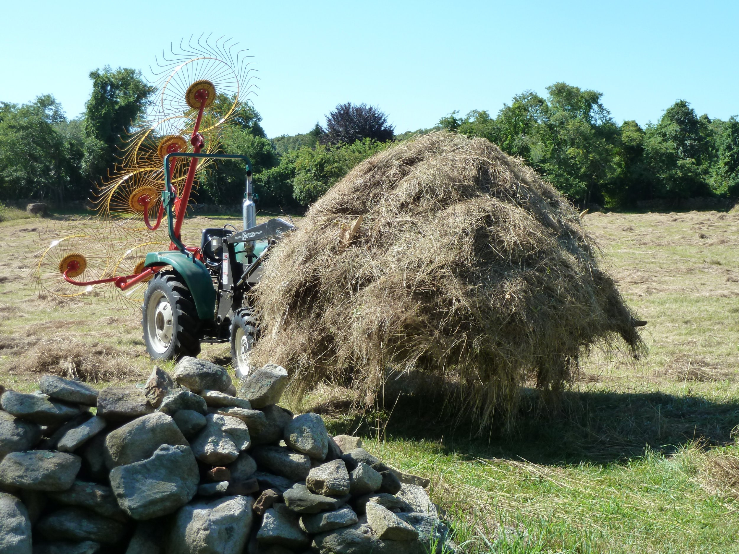

I use this rake, or one that looks like it:
I have used it to gather hay on a small scale. It pulls the hay on the ground to the right of the tractor into a straight row behind the tractor. I find I can do about three rows overlapping before the pile gets too big and the rake starts jumping. If on each pass I also come back in the other direction I can end up with six rows in one long pile. I don't have a grapple but I made a rake for the FEL that I can drive into the pile and then pick up a bunch and take it where I need it.
But it's slow work. Loose hay is really light. I might get 4,000 pounds per acre, which works out to 1.6 ounces per square foot. I ended up buying a 50-year-old Deere 24T baler for $900. It still makes four bales a minute so I can bale 4,000 lbs in about 20 minutes. Even if I'm not using the hay for hay it's the quickest way to get it out of the field.

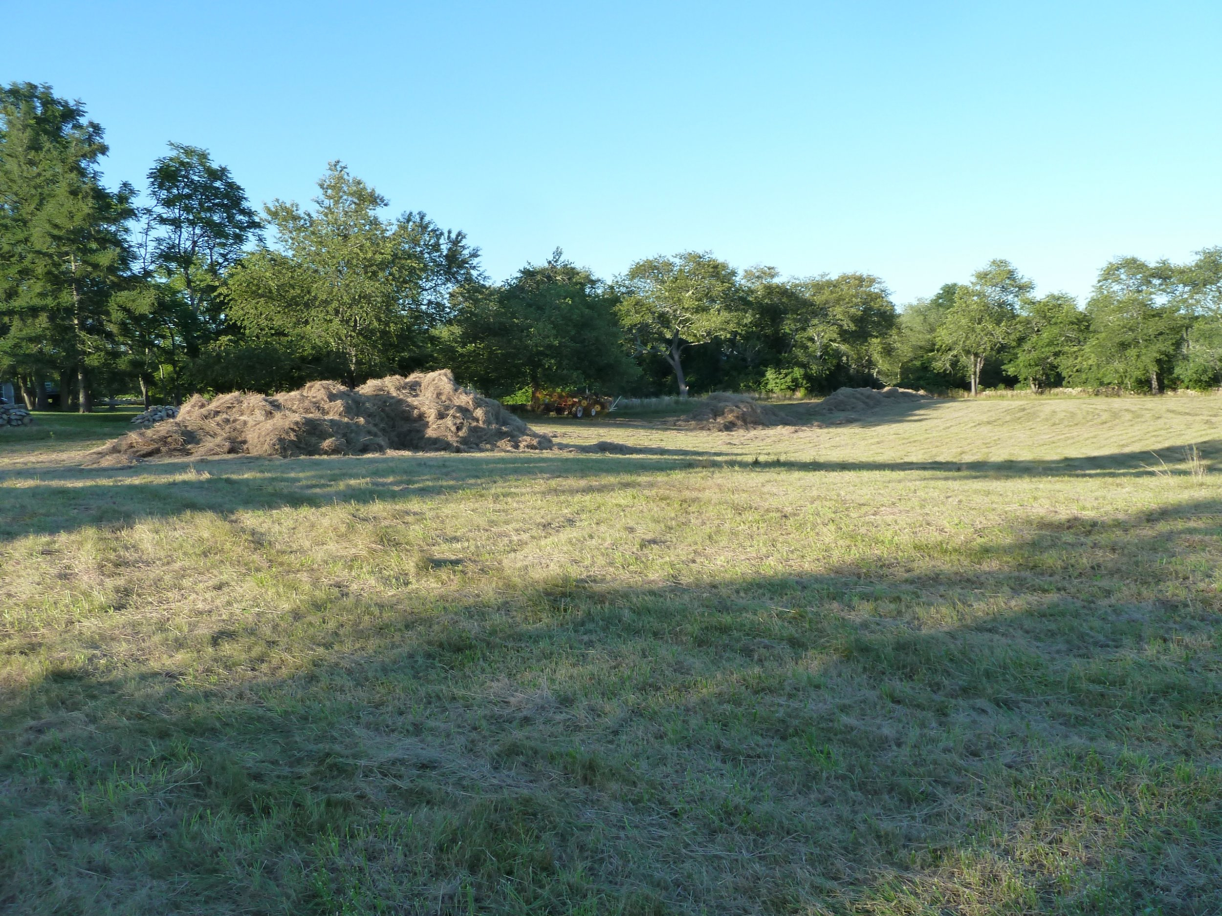

A couple of pictures. Here's a big pile of hay I made just by raking with the wheel rake. You can see from the field in the foreground that it does a pretty good job of picking it up.
Here's the hay rake on the FEL with a pretty good load. On the back is the wheel rake I use.
