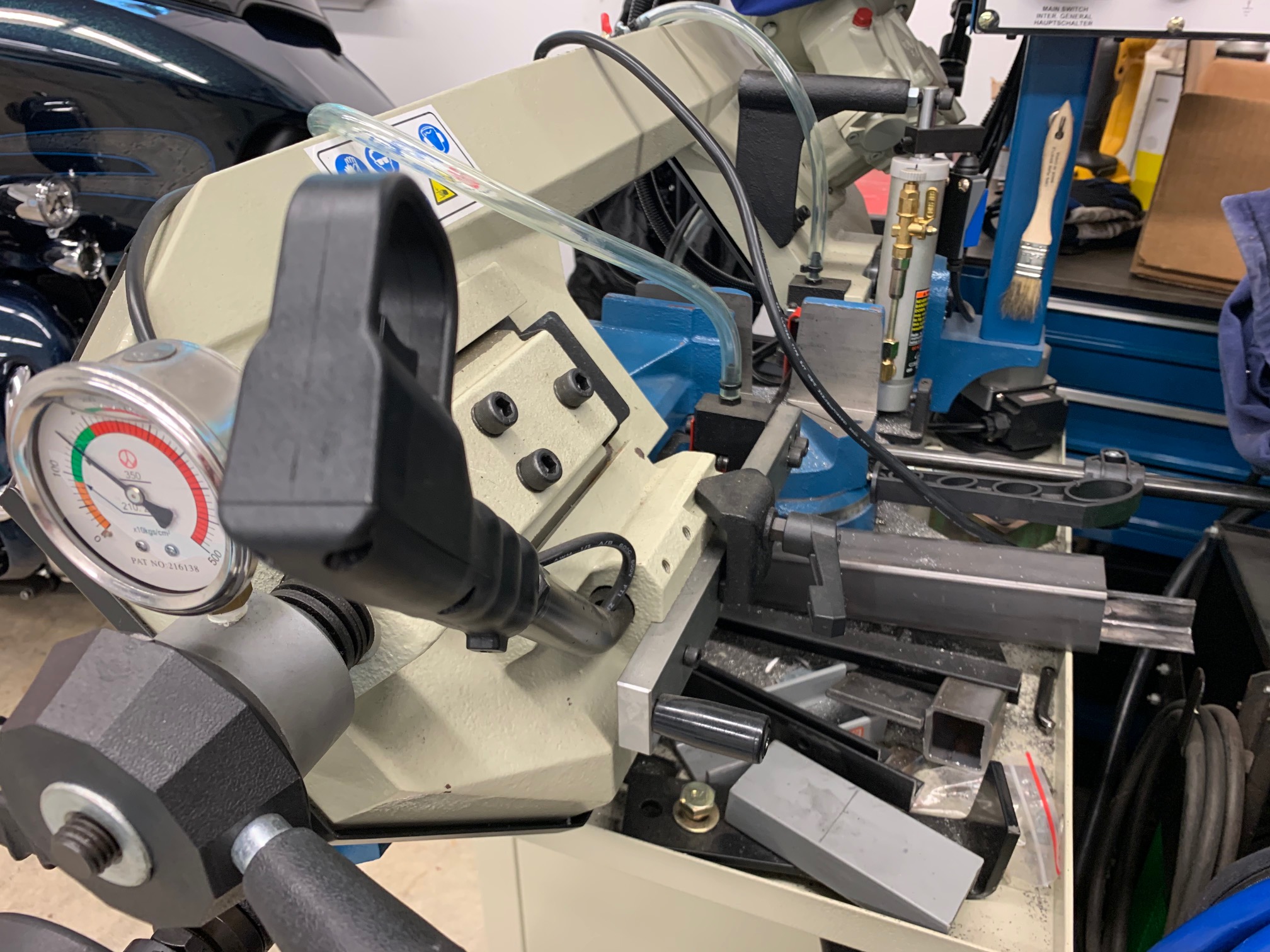

I upgraded to this almost two years ago, money well spent and I love it!
Horizontal Metal Bandsaw (BS-21M) | Baileigh Industrial
It is accurate out of the crate, does miters extremely well, super easy to use, love the fact that the vise never moves, and the variable speed is fantastic.
I wanted to expand on this some more.
I really wanted a stationary vise for ease of mitering-the stock is always in the same place so you can easily add infeed/outfeed tables, variable speed, and hopefully made in the USA when I was researching. I was looking hard at the Ellis 1200, real hard in fact, I like the wheels it had, and it was lighter then the BS-210, but is has a huge footprint and only has three speeds versus infinite speeds of the BS-210 (It uses a 3-phase miter and VFD drive for speed control). The accessories for the Ellis where pretty expensive too.

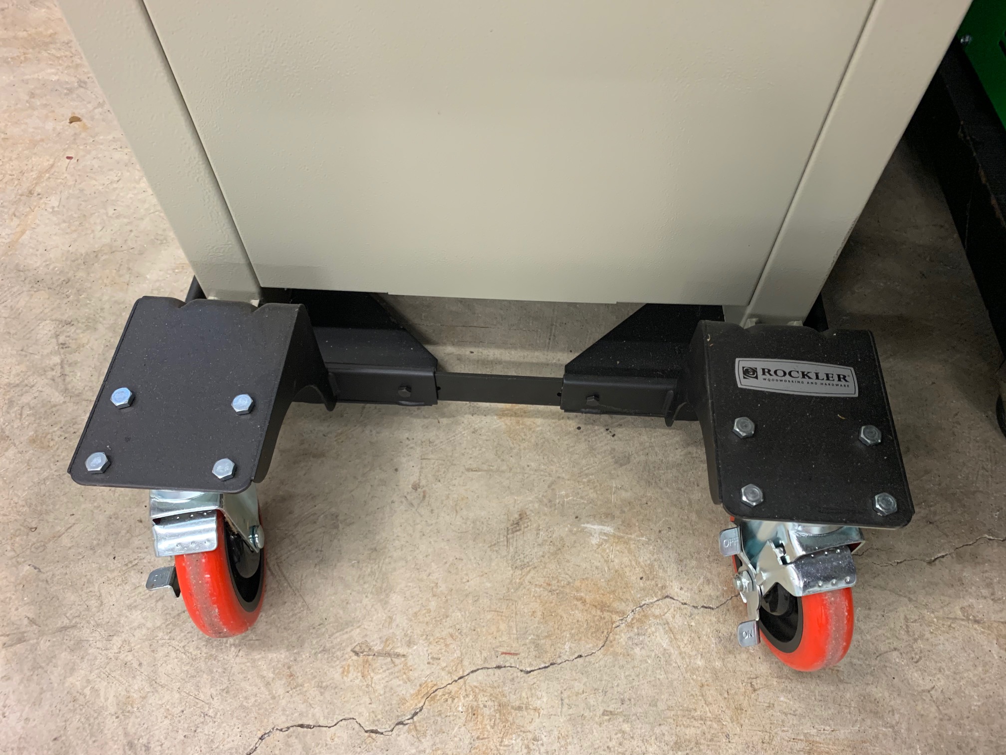

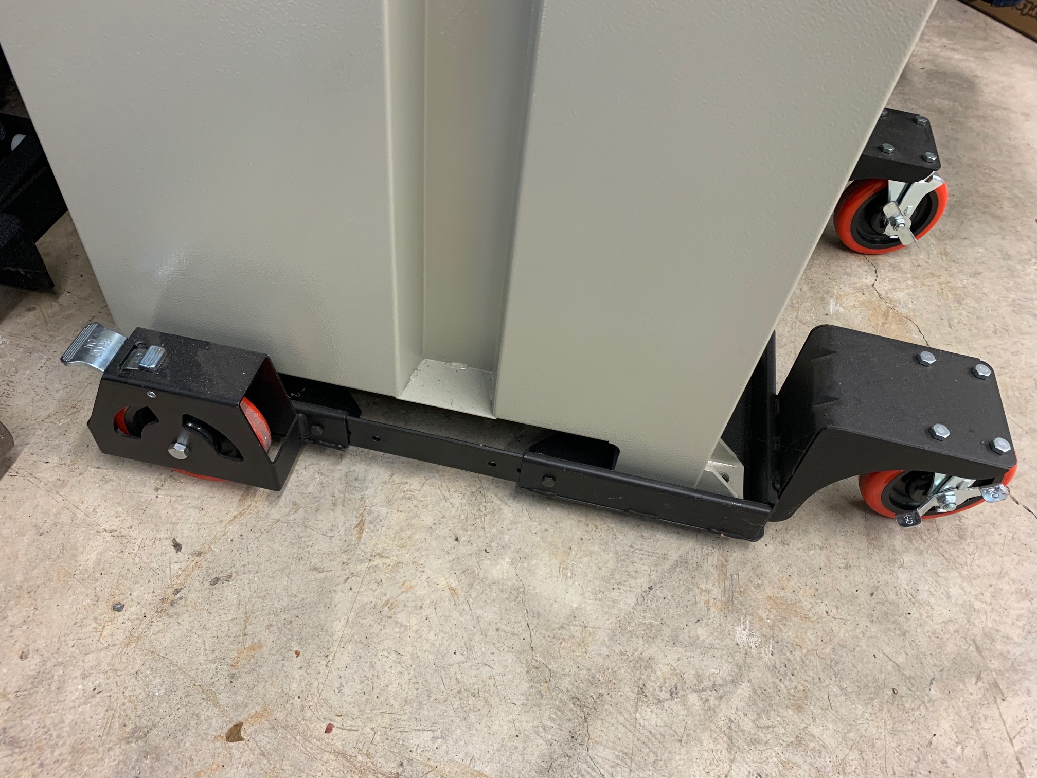

In the end I chose the smaller footprint and variable speed, then added a heavy duty mobile base from Rockler Woodworking. Other features I really like are the blade tension gauge, manual down feed handle as well as the cylinder controlled down feed with auto-off switch, adjustable stop and quick acting vise for repetitive cuts.
Baileigh had a 17.74% sale around July 4th when I bought it, that basically covered the shipping fees
The saw has a coolant pump system, but I run it dry to eliminate the mess and hassle, so what if I go through an extra blade or two in my lifetime LOL. I did have to open the control box and disconnect the pump wire since it has no switch, if I start using coolant I'll add a switch somewhere to control the pump. The one negative I have is that GFI circuits don't like it, I guess because of the VFD maybe, so I have to run a cord to a non-GFI protected outlet when I use it.
Hope this helps...

Good looking saw. Any negatives? How square are the cross cuts?

The saw was dead-nuts square out of the box, it even includes a measured test piece to show it was accurate. The only negatives I have was it trips my GFI outlets as I mentioned in the second post, and the included blade is marginal that I did not mention.

I would check or replace GFI beaker, quietly spoken in quite a few forums they are not all the are supposed to be....

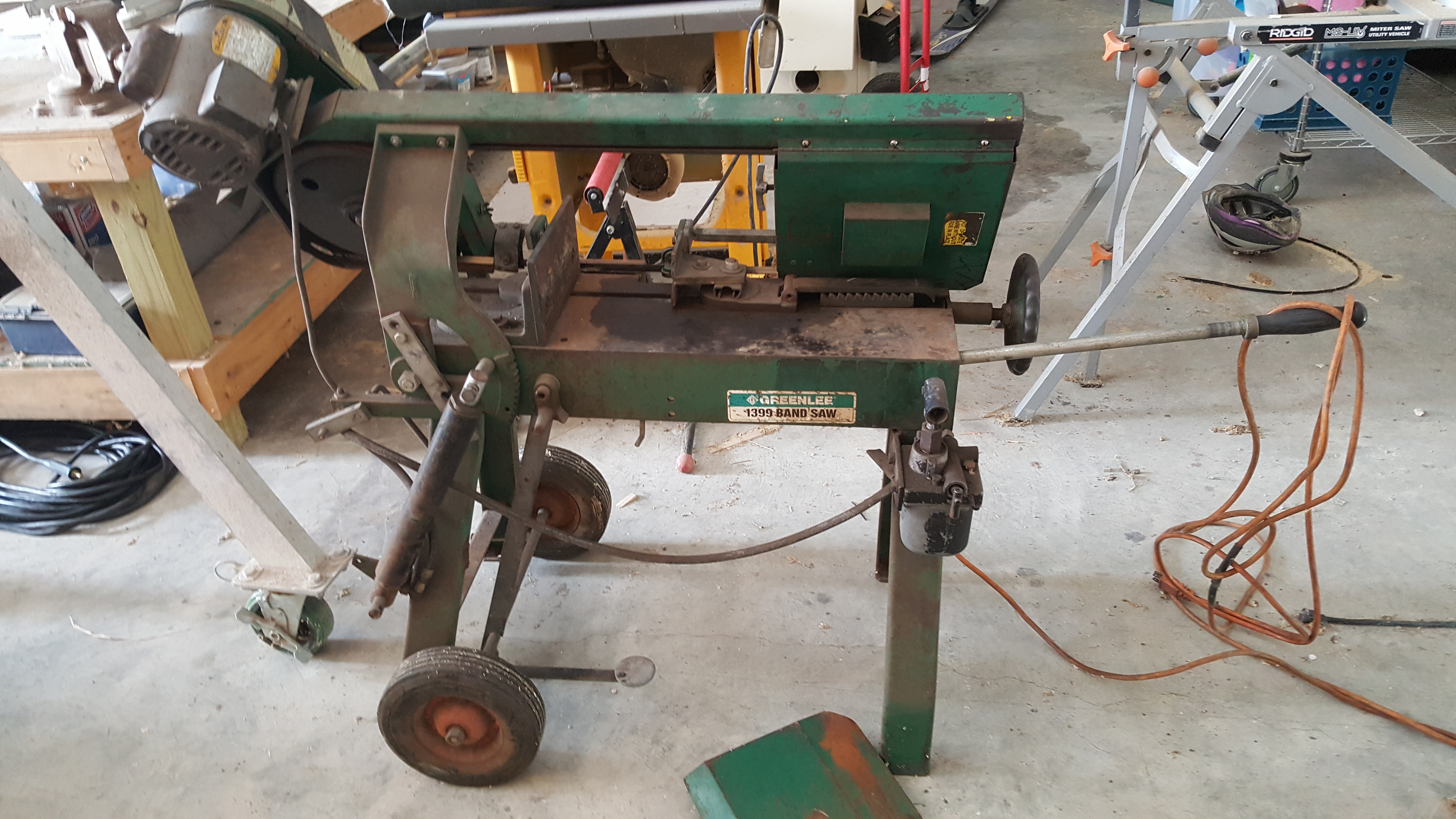

Just picked up a Clarke 7x12 off FB Market for $300. I wasn't planning to replace my old saw that died since I bought a plasma cutter but I figured this was too cheap to pass on.
It's made in China but looks much better built than my old 4x6 was.

most of these industrial units are designed to work in business shops, which do not require GFCI outlets. even service (old time gas stations) dont require GFCI as they give issues with alot of tools. I have not wired any industrial shops or service stations for at least 5 years, but i dont think the rules have changed..... at least where i live.
   / horizontal band saw #30
If the circuit has any outlets near a water source it is required to be GFCI. Doesn't matter if it's residential or industrial. That said most tool environments shouldn't be on a GFCI circuit. BUT my GFCI in my home originates in my garage of all places. It almost never trips.
