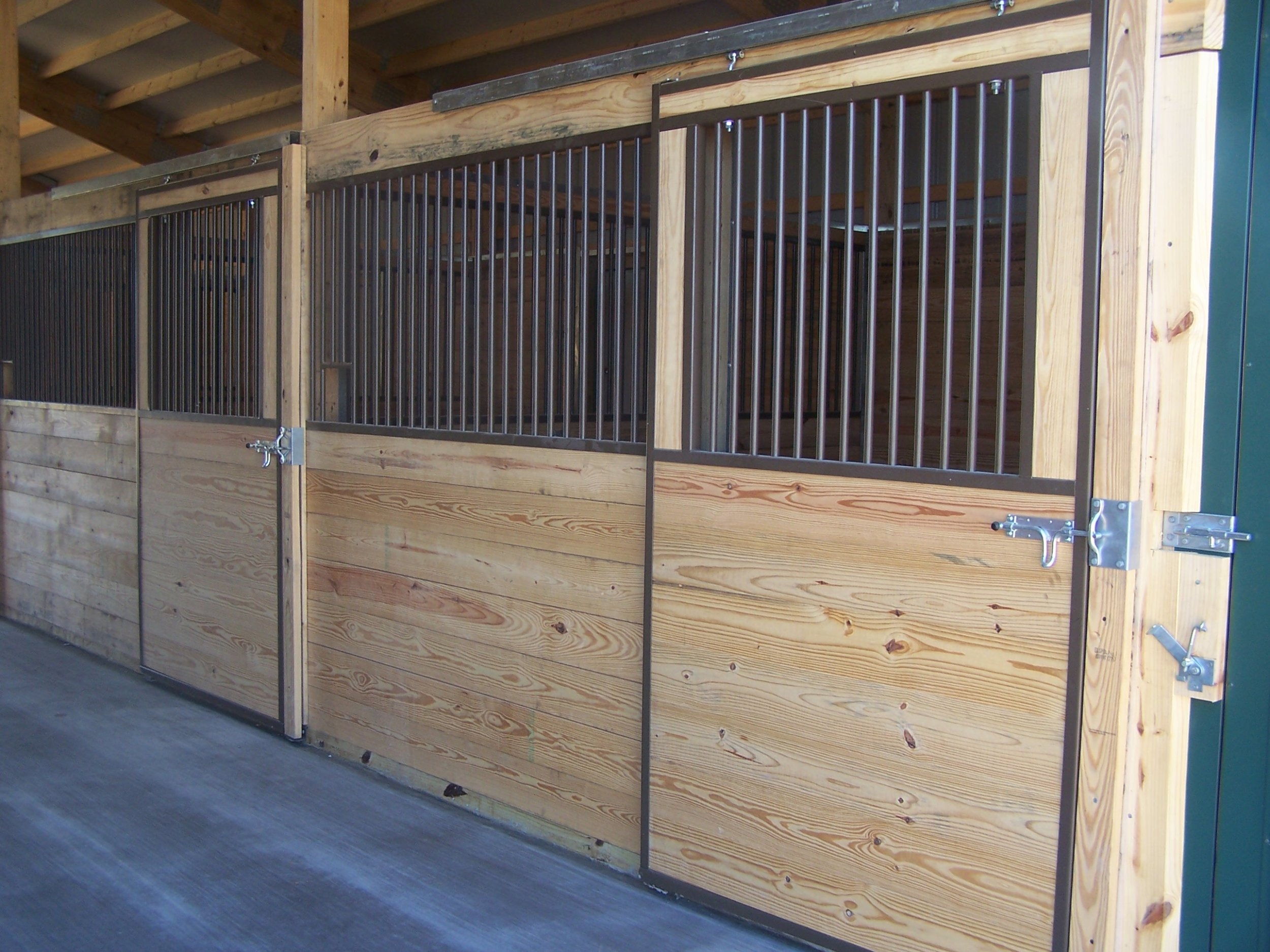

I understand it. Depends on what you do with your horses and how much you pay for them. English dressage horses can easily cost $50,000 to $100,000, so you protect your investment. Our stalls are 12' X 12' with 2 4' doors, one to the 12' aisle and one to the 1-acre paddock. Each has a threshold. They have crushed rock base with a layer of sand covering it, and then the stall is covered with a rubber mat. We put shavings on the mats. Every day you go in and clean the stall with a manure fork and muck bucket. If the shavings get low, you add more. The buckets get dumped into the manure spreader.
There is no way to use a tractor to clean stalls. And during cold or inclement weather the horses may be in the stall for days in a row.
