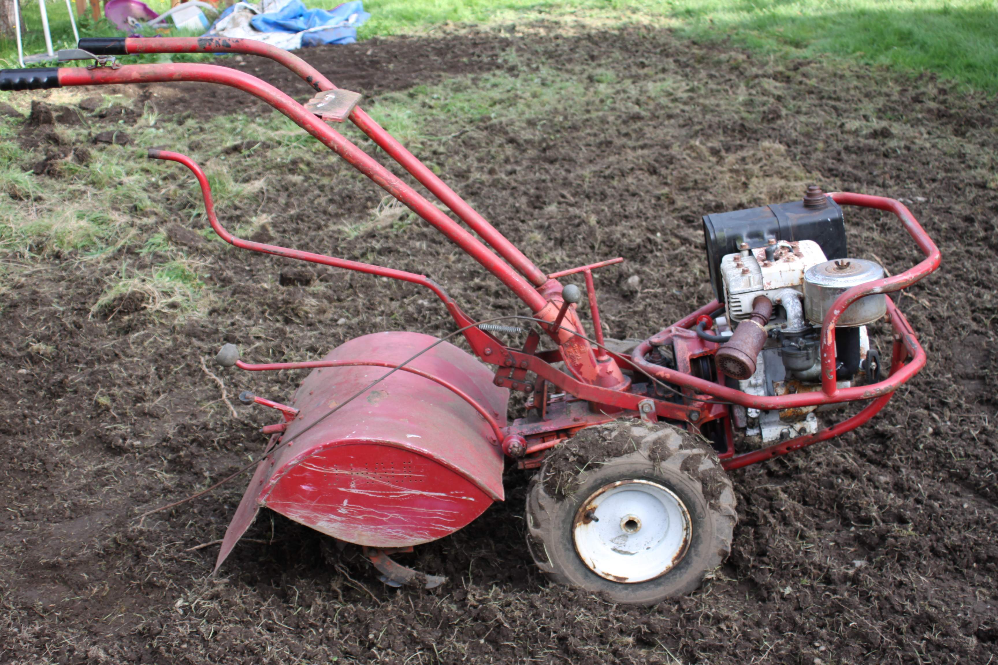

I am trying to get my tiller running well enough to use and have a couple of questions.
1. Why does it jump out of gear? It will hold for a while then when it gets into a bind it jumps out in low wheel speed. It will jump out in high wheel speed just going along the lawn moving from place to place.
2. Reverse won't work. The reverse wheel drops down but just barely enough to contact the drive wheel. There is wear on the side that faces the handles and no noticeable wear on the front side. Can this be adjusted and if so where can I get the info? Thanks

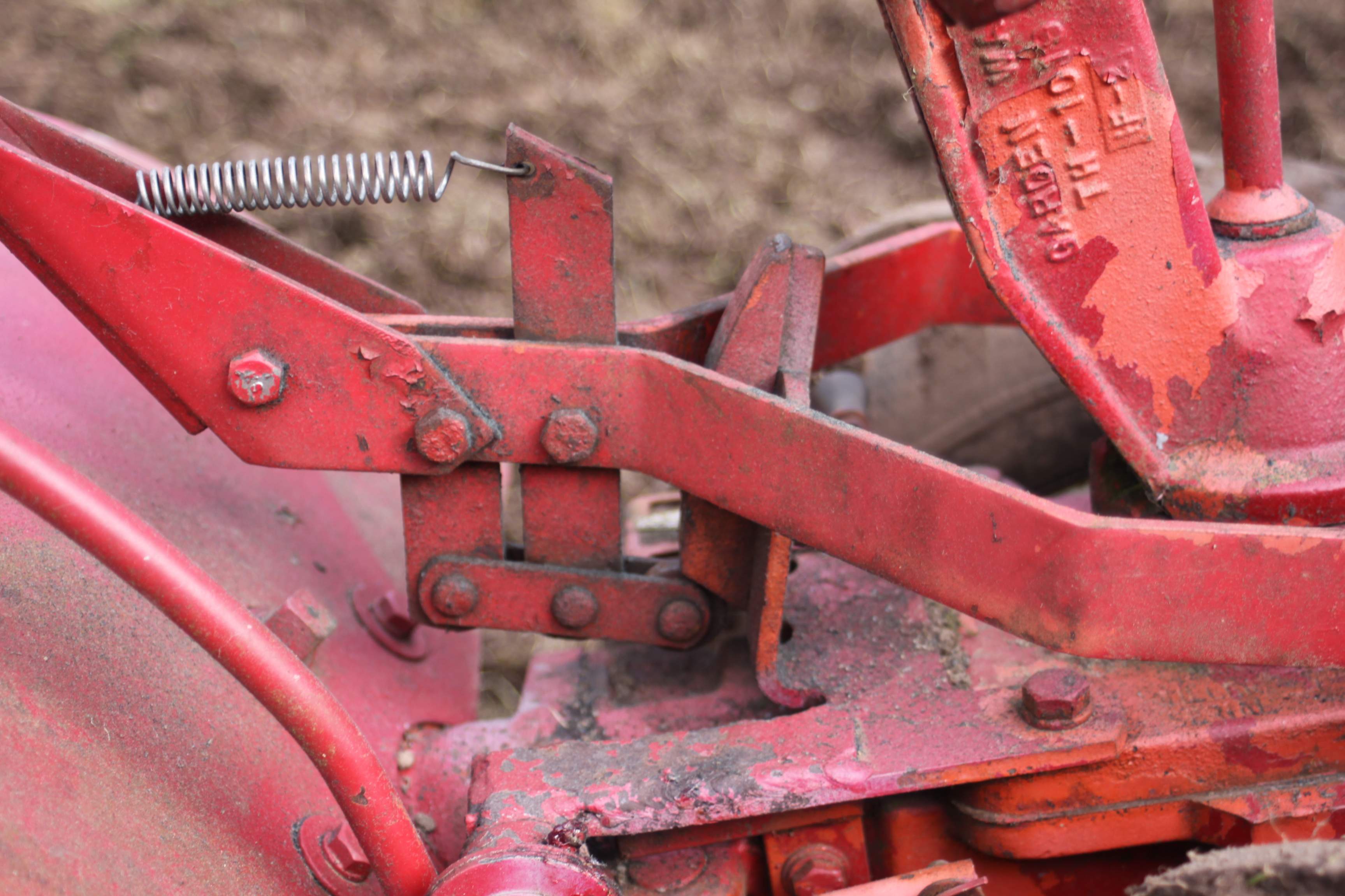

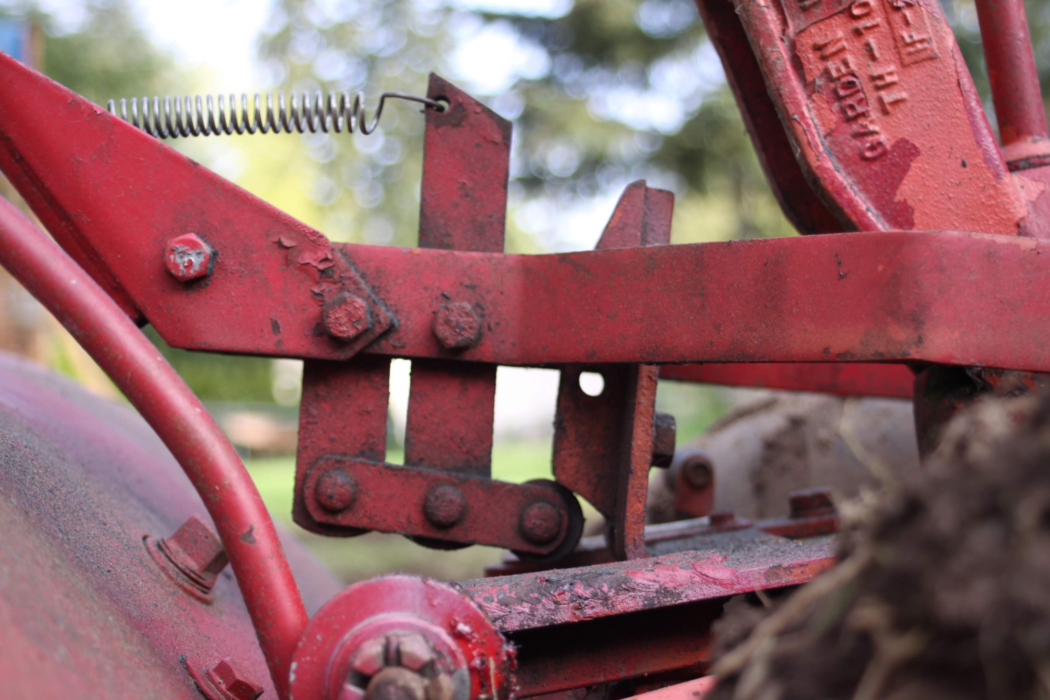

2manyrocks,
Can you post a picture of the linkage on your machine in forward so that I can compare to what mine looks like? I'll get a picture of mine.
TIA
   / Horse jumps out of gear #5
Here are the pix.

   / Horse jumps out of gear #6

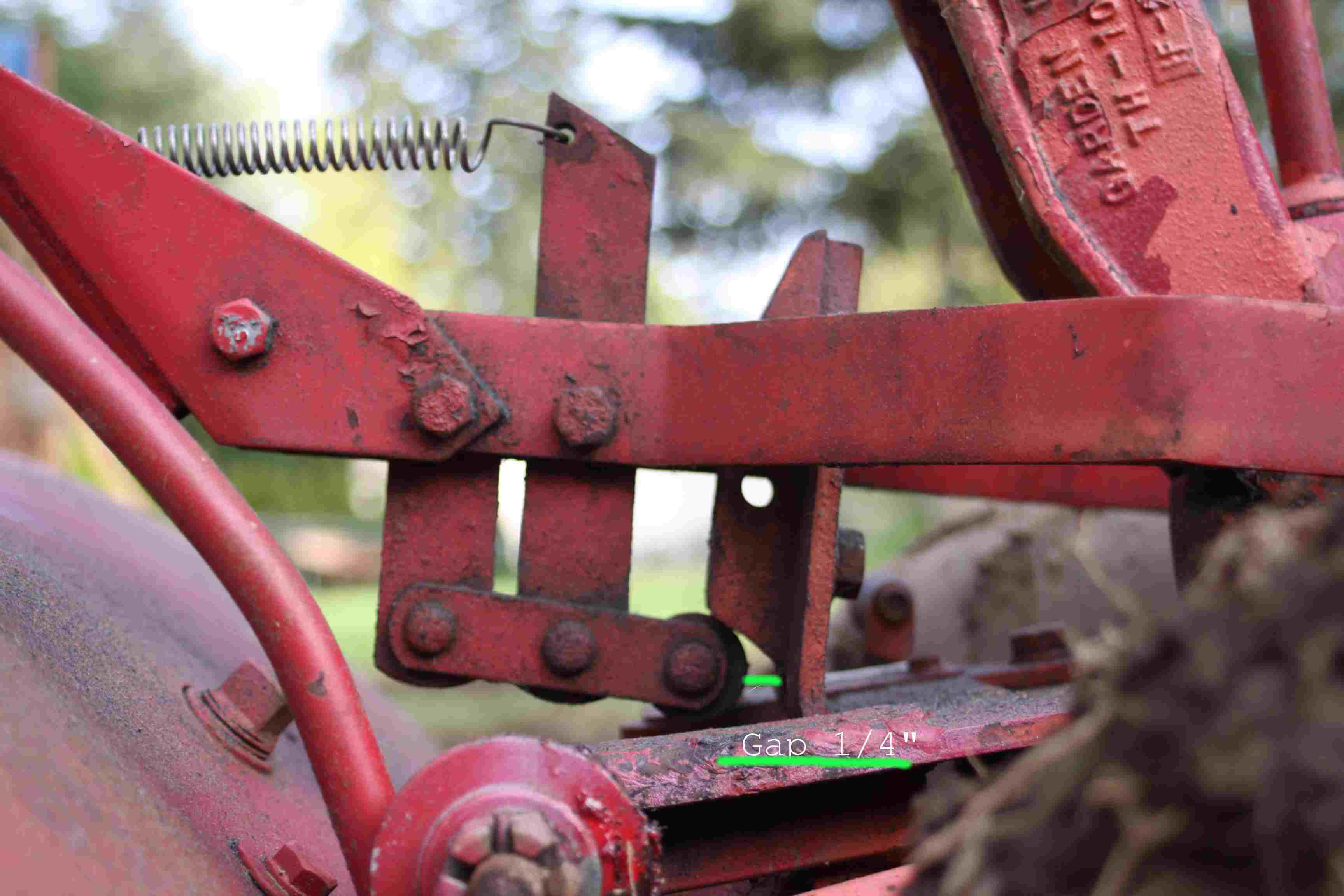

Sounds like the belt is slipping and that is burning up the belt.
According to the manual, the distance between the front edge of the roller and the face of the mounting bracket should be 1/4 inch. If less than 1/4 inch, the belt may be too loose and may slip. If the gap is more than 1/4 inch, the belt may be too tight and the lever may pop out of gear when you till.
The instructions also say to push down on the forward reverse lever as hard as you can increasing the belt tension while you tighten the mounting bolt. Then you are supposed to check the gap. If you just push the lever down without holding it, the adjustment will be off a bit as I recall.
A new belt will stretch in fairly short order and will have to be readjusted a couple of times until you break it in. It's supposed to be checked every 10 hours per the manual.
I suppose that if you got a belt that was the wrong length to start with, it could throw this off because the manual expects that the factory belt of the correct length will be used.
Please measure your gap and see if this helps at all.
The photo is the one you posted with a line drawn to show the place to measure. While you're at it, take your adjustment block off and look to see if the face is worn. As I look at your photo, I'm wondering if your adjustment block is worn.

The problem with looking at it is that I have nothing to use as a basis for comparing to. I was thinking that maybe the spring might be weak and not holding well. The picture I took was after the belt broke today and I was having my son hold it close to where it would be when adjusted.
I agree with the 1/4" measurement. My manual says 1/4" min and 5/16" max. I used two wrenches (1 which was a1/4" thick and 1 which was 5/16" thick to check spacing. I ordered the proper adjustment rod tonight along with a new spring and factory belt. I forgot to order a new throttle cable.

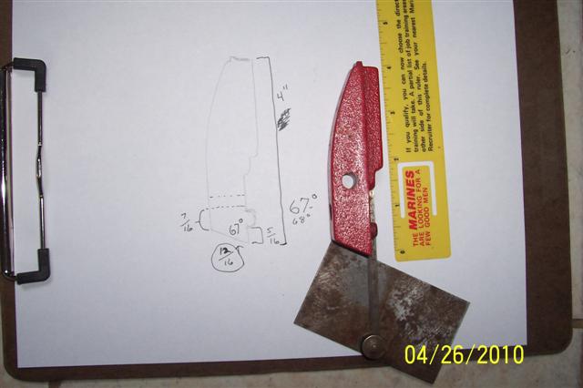

This is a picture of a new, unused adjustment block. I'm not so good at measuring parts so please take my measurements as approximate. On the face of the adjustment block it is roughly 7/16 inch from the edge of the mounting bolt hole to the end of the face. The angle of the face itself appears to be about 67-68 degrees. (I misplaced the protractor I normally use so I could be off a bit.)
The angle of your adjustment block in your picture looks like it is worn to me. If it is worn, that would mean you can't really adjust it to the proper tension until you replace the adjustment block.
The tension spring might have lost tension as you suggest or the roller assembly may be gunked up.
I apologize, but I was wrong about not being able to adjust the reverse disc. The disc is mounted in a fixed position, but you can adjust how it contacts the drive by making an adjustment to the neutral position. The neutral adjustment procedure is explained in the manual with three pages of instructions and photos explaining how to do it. The best thing would be to download the manual off the MTD site and look at those detailed instructions.

Thanks for the picture and description. I'll pull mine off and look it over well. I might just order a new one for the heck of it. I'll see how a new spring works first though as I've already ordered that.
