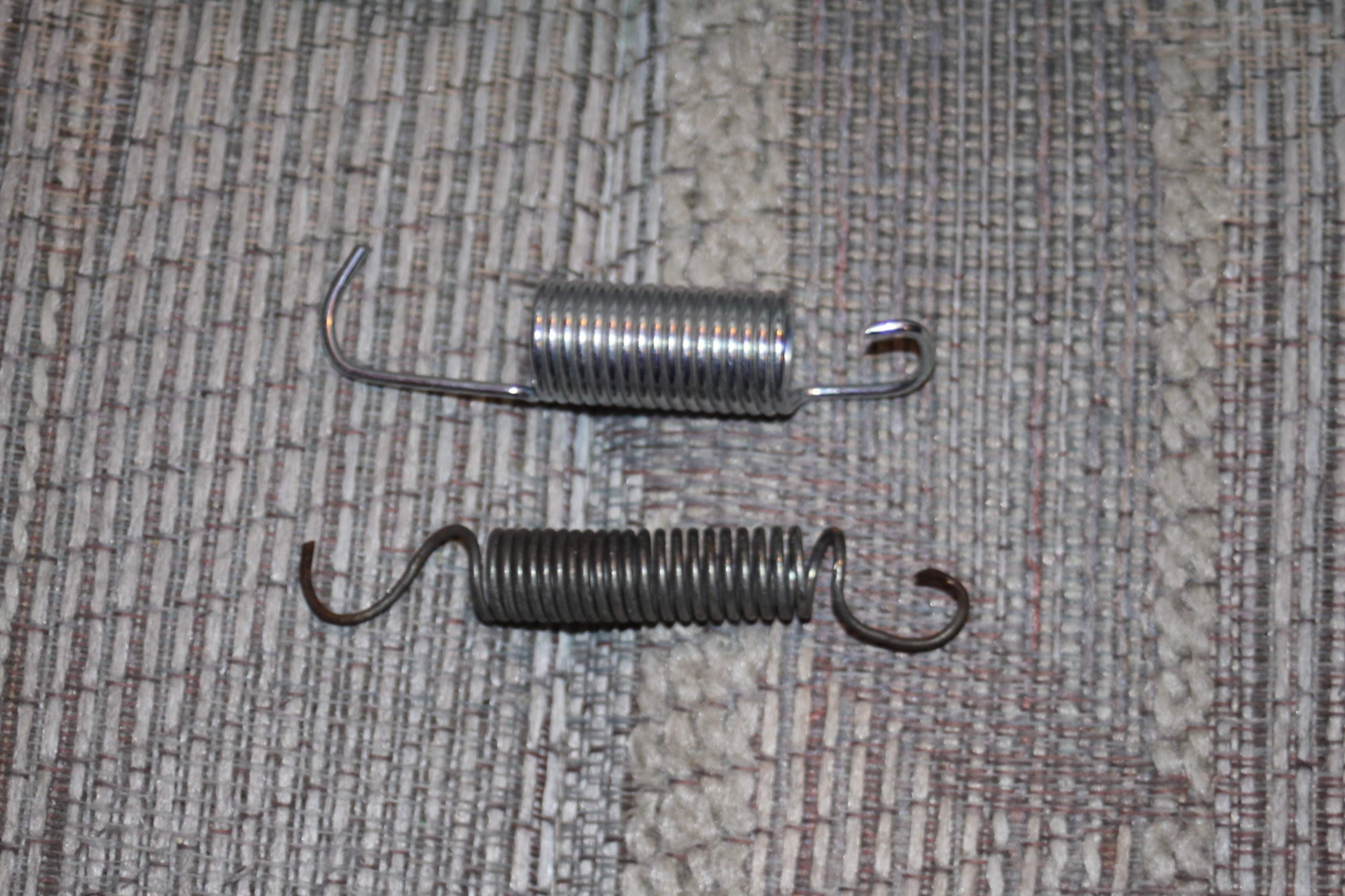

Another thought I just had is that I'm pretty sure that this is not the origional spring. The spring could very well end up being the problem. Should have my new parts by Friday. I picked up another belt today from NAPA. Took the Troy Built part number with me. This is definately not the same as the factory belt per NAPA, but they can order it. This belt will at least let me finish tilling the garden tonight so my wife will be happy and can plant.:thumbsup:

My parts arrived today. I think I found why mine doesn't stay in gear.

Finished plowing the garden with the wrong belt to keep the wife happy and been waiting on parts since last weekend. Got proper belt, adjustment tool, and proper spring. We'll see what those do. I can stretch the old spring by hand...no way with the new one. I still need to order a few parts, but they will have to wait a while.

I have also found on mine, after replacing the belts, if the belts are too tight, it will jump out of gear. The adjustment on these seems to be pretty sensitive. Too tight, jumps out of gear, too loose, slips...

For jumping out of gear tighten the nut on the hi/low shifter. This is a self locking nut and needs adjusting once in a while. On the right hand side of the tiller, horse model.
