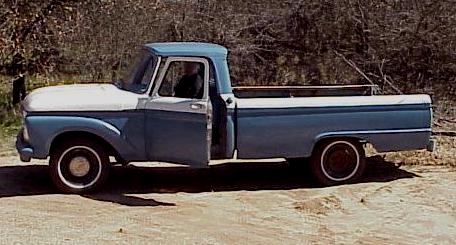

The gentleman at the river sand pit said: "Ya can have all ya want free if ya load er yer self OR for fer 5 bucks I can fire up that front loader". On a hot summer day out of the wallet comes a crisp flashy 5. This was back in my younger days before I knew about Squat O Meters.
OH My Gawd, I've hever had such a 3 mile ride at 12 mph in my life.:laughing:
