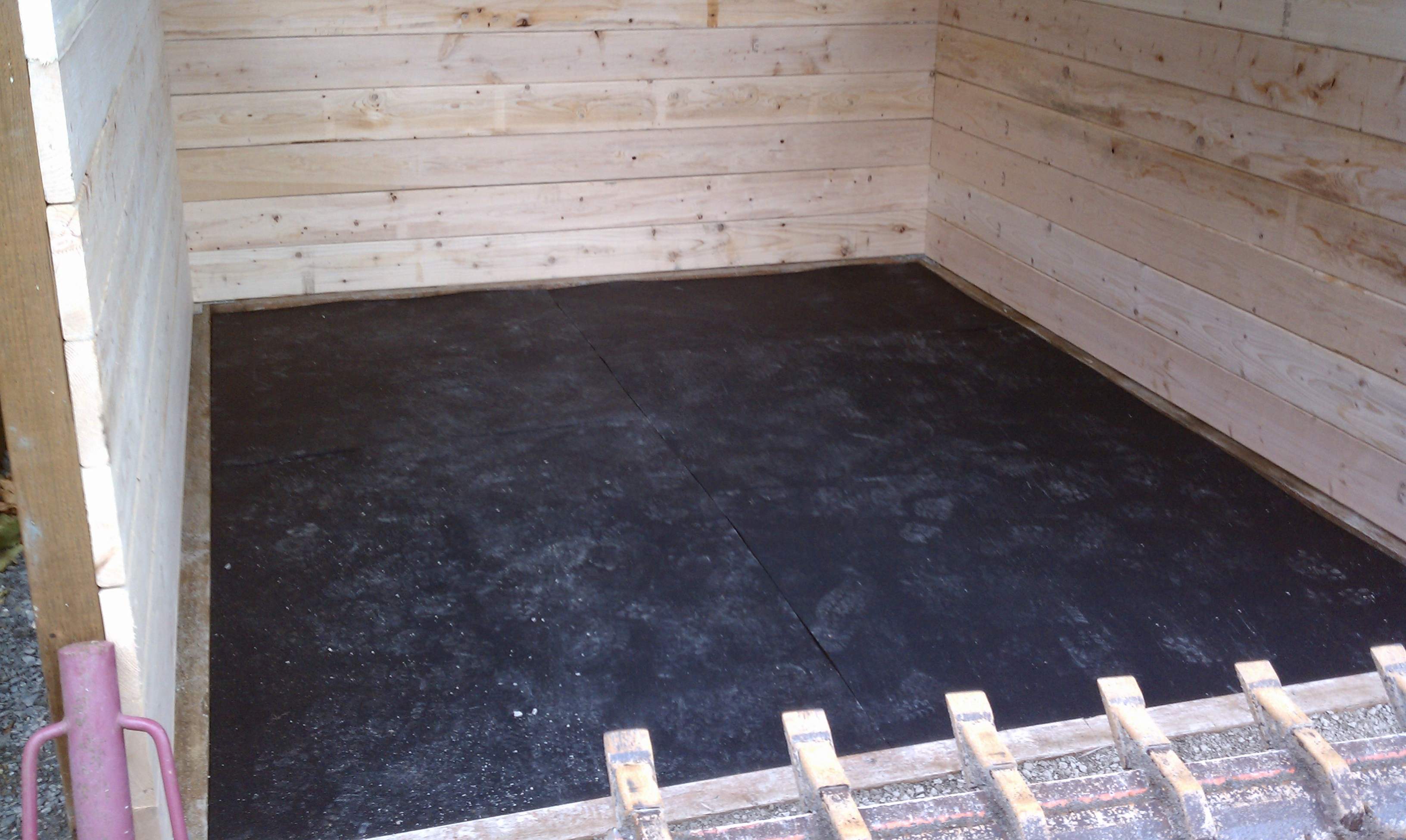

   / horse shelter #20

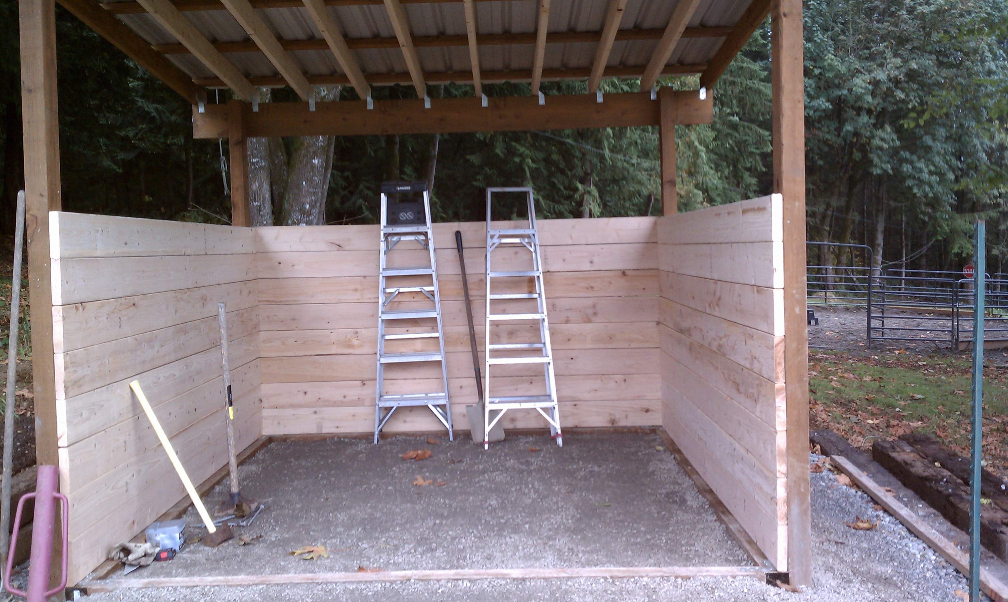

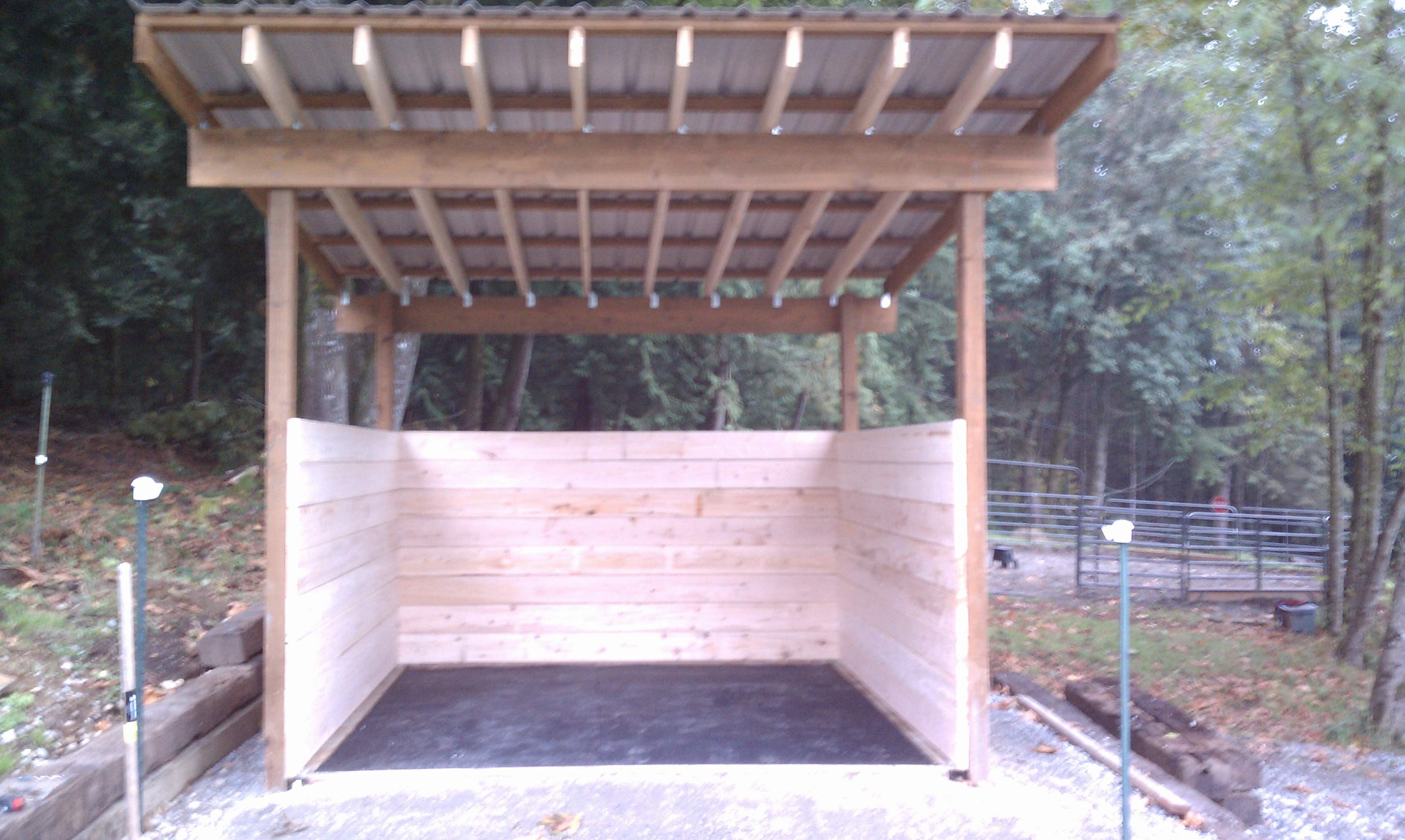

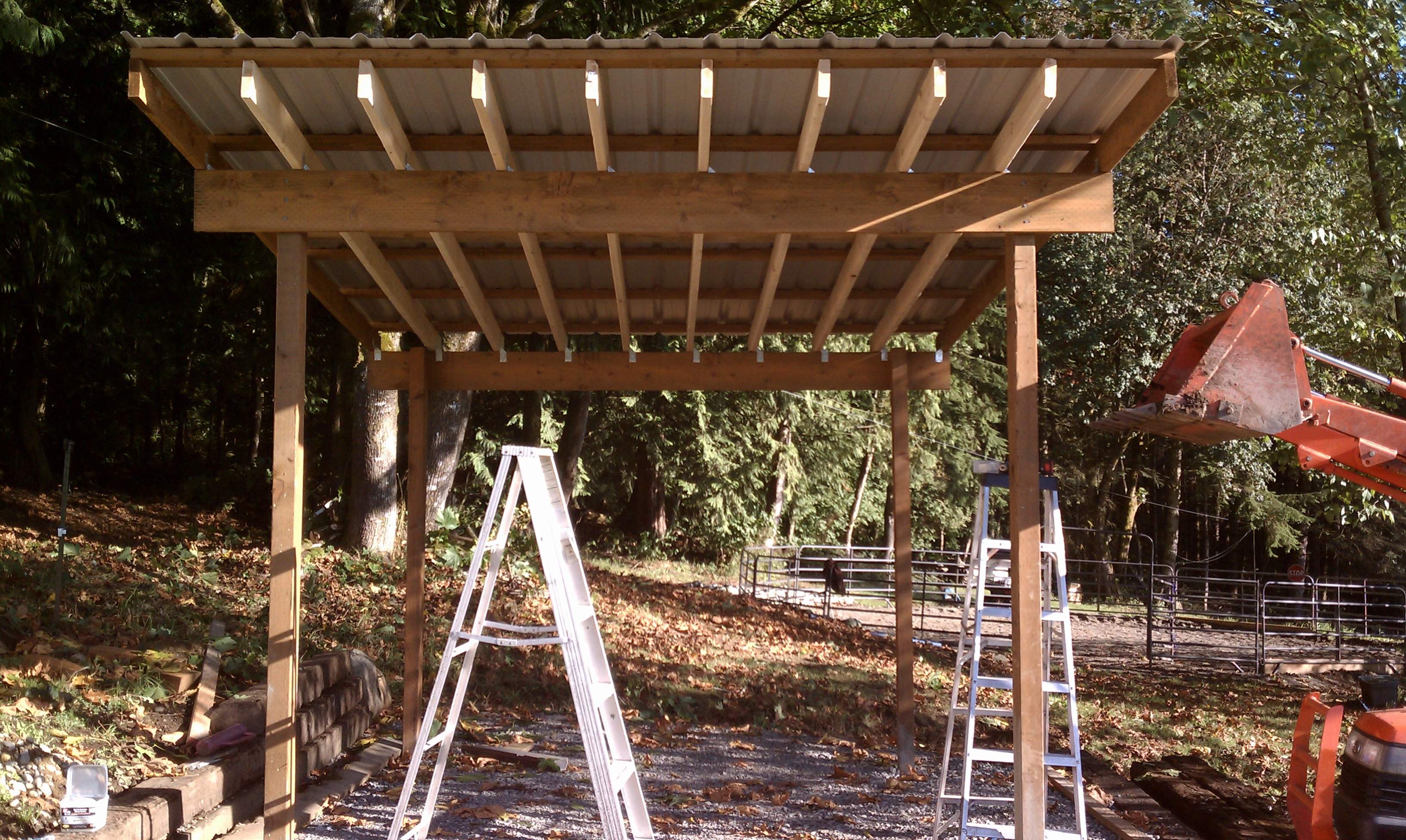

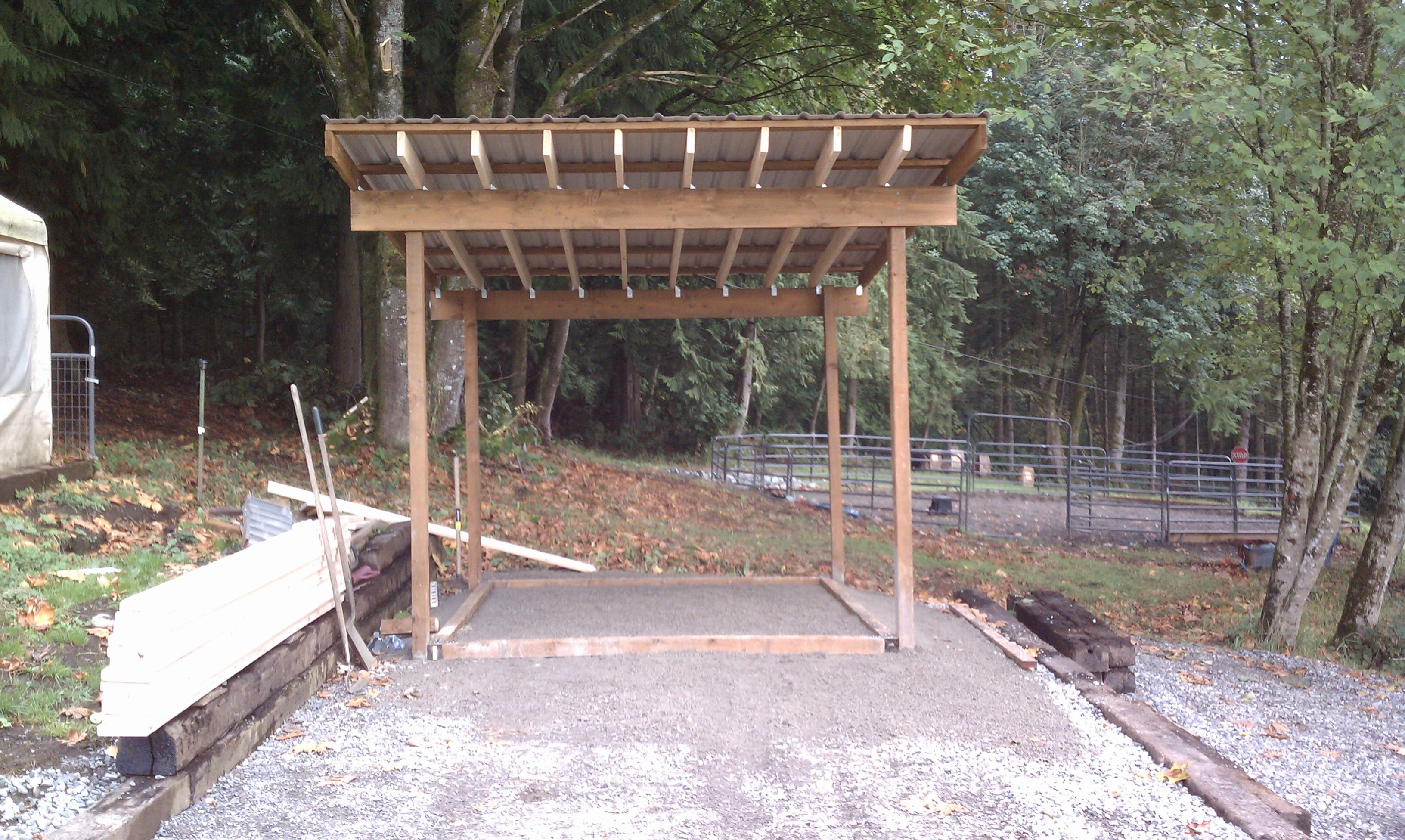

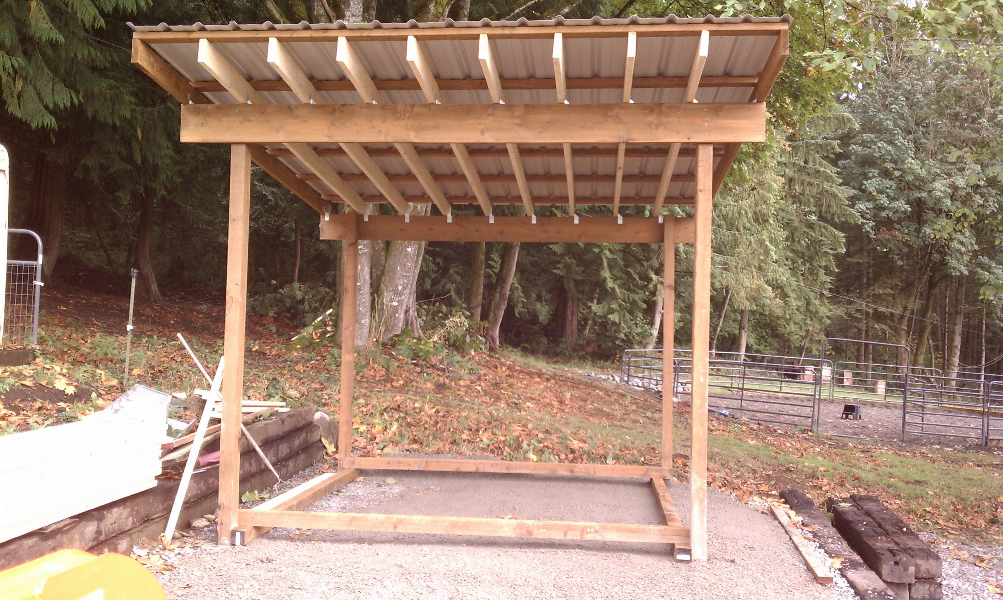

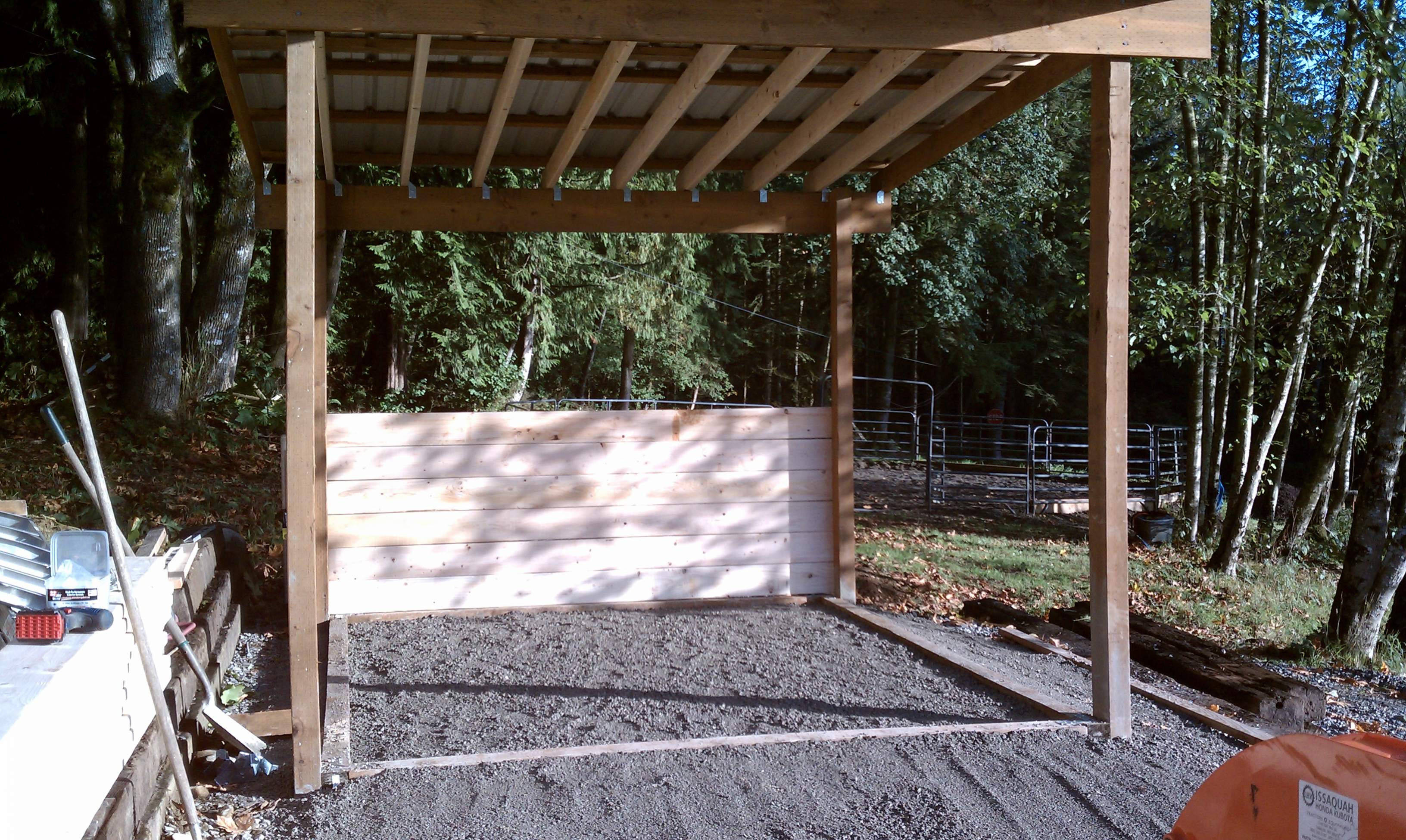

here are some pics of what i have so far, should i be concerned with the 2x10 header (spans 10') or is it strong enough? we don't get much snow here but will get up to 6-8" which will last a couple days. i plan to block underneath the header at the post for some vertical support. it's attached with 5" long 1/2" lags. the joists are 2x6 and are 15' long but the span is just over 11' and they are 16" OC.
Is that 6-8" of powder or wet? There is a big difference and the pitch on that roof isn't steep. Shallower than our porch roof from the looks of it. The carpenters built it with 2x10 rafters on 16" centers but the porch is only 5' deep. The porch is enclosed with 30" wide storm windows with 2x6 studs between each and the header is a double 2x10.
I would worry about trying to span 10' with a single 2x10 on a bearing side. As suggested by inveresk, add a second on the inside of the posts front and rear. They are cheap insurance :)
Our house was built about 100 years ago with REAL 2x6 joists on 24" centers :eek: The house is only 15' wide and there was a carrying beam half way across so they spanned < 7.5'. And the joists still sagged over time. They were jacked and sistered BOTH sides with 2x8 micro-lams (ceiling was already only 7'6"!) when we rehabbed it and still aren't totally level. The carpenters were worried about trying to take too much "decades old bend" out of old wood in a short period of time. If we hadn't wanted to save the the installed hardwood floor on the 2nd floor, they would have leveled the tops of the micros instead of matching the tops of the existing joists.
I realize there is a difference between a floor and a roof (with not much snow) and 16" vs 24" centers and yours are probably OK given your location but if you happen to get a dump some winter, I would suggest getting out a snow rake and pulling it off.
