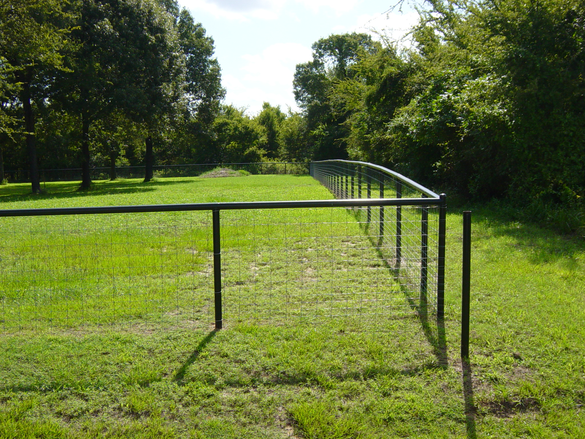

   / horses and goat fencing #27
This is who I used. Its been up for about 10 years.
staytuff dot com
Its sold by McCoys in Tyler.
